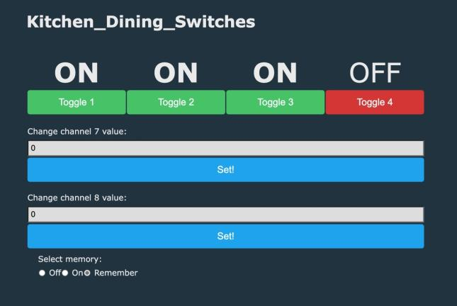

    This is of course a very basic approach. You can also put that setting on GUI.
    Here is a full autoexec.bat with memory setting mapped to GUI:

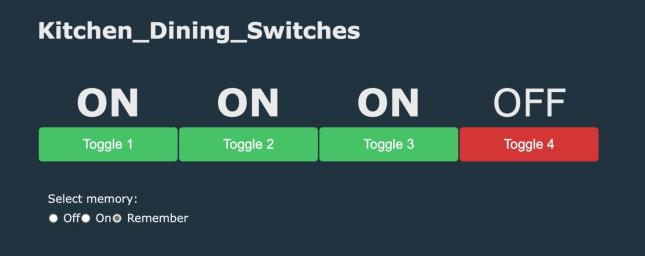

    The most important things happen here:
    linkTuyaMCUOutputToChannel 14 4 14
    setChannelType 14 OffOnRemember
    This maps dpID 14 of type enum (4) to channel 14 (so it's easier to remember), and also it sets the type of channel 14 to OffOnRemember so the correct widget is shown on OBK gui.
    Here is the result in OBK:
    Kitchen and dining switches with memory settings

Add delays so you do not overload the MCU with back-to-back writes during startup. The example waits 1 s before restore, then inserts 0.1 s between setChannel 1, 2, 3, and 4. That spacing reduces command bursts when OpenBeken pushes saved relay states to the TuyaMCU. Without those delays, the restore sequence can become less reliable on multi-channel devices because all writes arrive too quickly. [#20743842]
How do flash memory channels like $CH200, $CH201, and higher work in OpenBeken for saving relay states?
Flash memory channels start at $CH200, and OpenBeken saves them to flash when you write values there. The example uses $CH201, $CH202, $CH203, and $CH204 to keep the last states of relay channels 1–4. On boot, the script prints those values with echo and restores them back to active channels. The thread also notes that OpenBeken uses flash-write optimization, so one erase serves many write cycles. [#20743842]
What is an addEventHandler OnChannelChange script in OpenBeken, and how does it help save switch states automatically?
addEventHandler OnChannelChange is an OpenBeken event hook that runs a command whenever a channel changes value. In the example, channel 1 saves to $CH201, channel 2 to $CH202, channel 3 to $CH203, and channel 4 to $CH204. That means every relay change is stored automatically, so the next reboot can restore the latest known state from flash without manual intervention. [#20743842]
How can I make a TuyaMCU device always power on with all relays set to 1 instead of restoring the previous state?
Set each mapped relay channel to 1 during startup instead of reading saved flash values. The thread shows a direct sequence: setChannel 1 1, delay 0.1 s, setChannel 2 1, delay 0.1 s, then the same for channels 3 and 4. This forces all four relays to power on in the On state every boot. Use this method when you want a fixed startup state, not remembered state. [#20743842]
Why can MQTT or Home Assistant overwrite TuyaMCU state during testing, and how should I avoid that while configuring OpenBeken?
MQTT or Home Assistant can push their own retained or synchronized values back to the device and undo your test setting. The thread warns that MQTT and HA may overwrite TuyaMCU state if they are not configured correctly. During testing, disable MQTT first, then verify that your tuyaMcu_sendState command or startup script works as intended. This isolates the MCU behavior from automation-side state restoration. [#20743842]
Which autoexec.bat lines are needed to restore relay states from flash on reboot for a 4-channel TuyaMCU switch?
You need a restore block plus four save handlers. 1. After your channel mappings, add delay_s 1 and echo Restoring states: $CH201 $CH202 $CH203 $CH204. 2. Restore channels 1–4 from $CH201–$CH204 with 0.1 s delays. 3. Add four addEventHandler OnChannelChange lines that save each relay back into its flash channel. That combination recreates remembered startup on a 4-channel TuyaMCU switch. [#20743842]
How do I use TuyaMCUAnalyzer to capture UART communication from original Tuya firmware and identify the memory-status dpID?
Use TuyaMCUAnalyzer while the original Tuya firmware is still on the device, then toggle the memory option in the Tuya app and inspect the UART traffic. The thread recommends this method when you do not yet know whether a memory dpID exists. Watch for the datapoint that changes when you switch between Off, On, and Remember. That changing datapoint is the best candidate for the memory-status dpID. [#20743842]
What troubleshooting steps should I follow if my TuyaMCU device has no obvious memory dpID or the remembered state does not restore correctly in OpenBeken?
First, query the MCU state and look for a memory-style enum dpID. If none appears, switch to the OBK flash-restore script. Then verify four things: the TuyaMCU driver starts correctly, your relay dpIDs are mapped to the right channels, MQTT is disabled during tests, and restore writes include 0.1 s delays. If the device still fails, use a fixed startup script such as setChannel 1 1 through setChannel 4 1 to confirm that channel control itself works. [#20743842]
