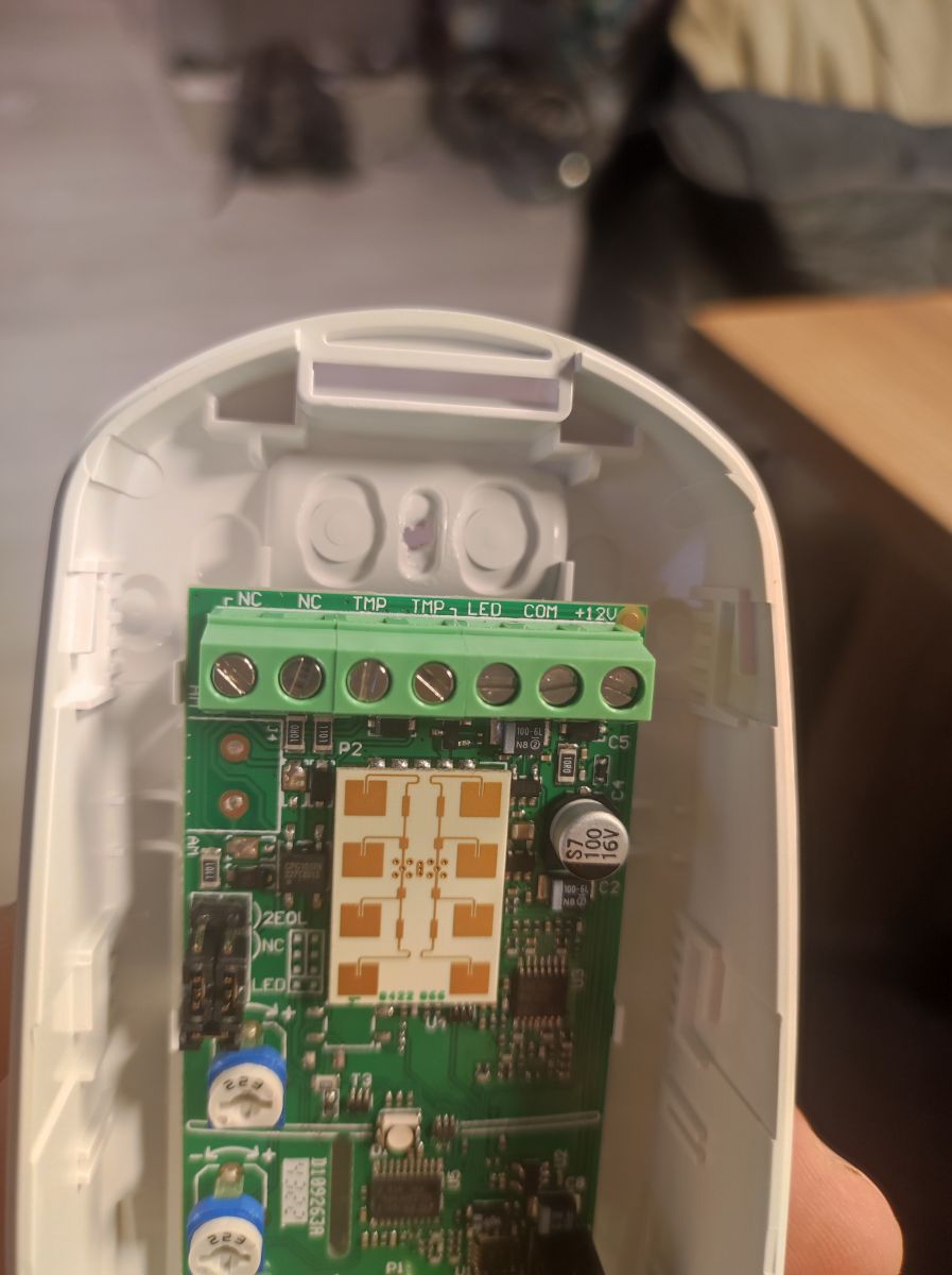

    How to connect the Satel SLIM DUAL PET detectors to the Grenton Smart Home System, the detectors are to activate the light in the hallway when motion is detected. I mean connecting without a control panel, which I don't need for anything.
    I am asking for a wiring diagram in the detector itself and where to plug in the cables in the Grenton modules.
    Which modules will I need or
    GRENTON - I/O MODULE?
    GRENTON - ANALOG IN/OUT?
    Greetings
    Need digital inputs and NC wiring for detector

    you need a module that has digital contact inputs, so as you wrote I/O module or Digital IN module, depending on how the rest of your needs look there.
    For me, the bigger quandary is how to strip the multi-pair cable that is used to connect the switchgear to a detector like UTP. How do you strip it in the switchgear so that one pair is connected to the 12V power supply and the other signal pair to the IO or Digital IN contact? On the detector side, NC, NC contacts and jumpers on NC not EOL - because that's how it needs to be wired, answering your question.

    Thanks for the reply, I've been away for a long time. As far as the cable is concerned, it won't be a problem as I have a YTDY 6x0.5 Bitner alarm cable attached. However, how do I plug in this detector?
    Interior of an alarm device showing connectors and a circuit board. .
    Can you show it to me in this photo?
    And one more question, what power supply should I use? Can it be any 12 volt one?
    Thanks and best regards
    #4 21396393
    pytonow
    Posts: 9
    One pair on NC NC and this to the Grenton digital input. And to the 12 volt and Com pins for 12 volt power and ground.
    Change the jumpers to NC as I think you have on EOL.
  • #5 21396415
    pldriversltd
    Posts: 55
    So one cable to NC, 2 cables to NC, then these two cables to one Grenton digital input, plus one cable to 12 volts to the power supply and one to - is the power supply any 12 volts or any particular parameters?
  • #6 21396523
    pytonow
    Posts: 9
    Power supply any 12 volts, there is consumption in milliamps. In Grenton I/O you have so that there is a common ground - G for the 4 digital inputs. That is, one NC to G in Grenton I/O, and the other, for example, to digital input 1, or the first free input of the 8.

    Ok thanks, I understand now, only the power supply is plugged into the 12+ connector and what is plugged into COM? Is the plus from the power supply plugged into 12+ and the - into COM sorry for asking such trivialities but I prefer to ask than damage :)
  • #8 21402173
    pytonow
    Posts: 9
    Yes COM is the ground from the 12V power supply.
