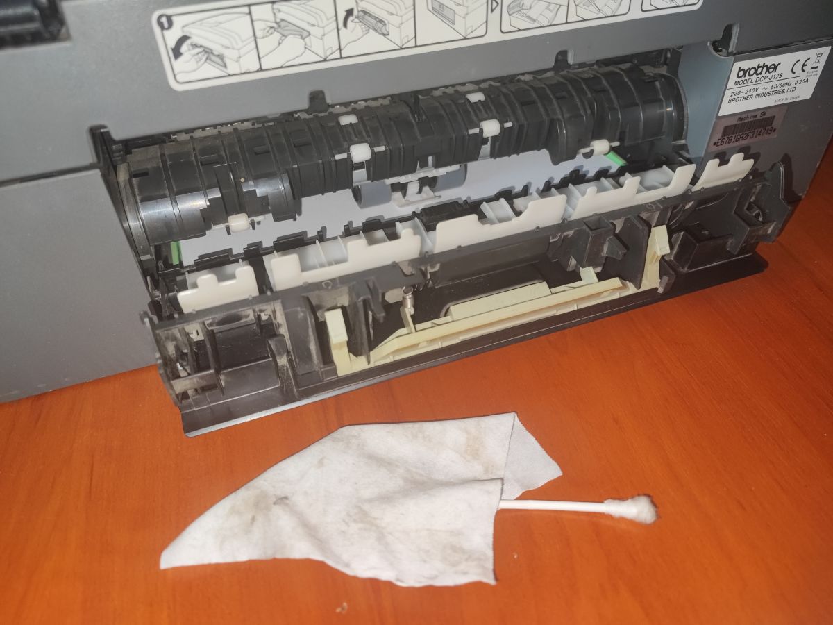

    Today we're tackling another piece of equipment from the electro junk. This time it's going to be a Brother printer, which strangely enough seems to be showing fairly full inks. In its current state it doesn't even take paper, but maybe there's something to fight for? Let's find out! I can announce straight away that there will be more than one problem here.

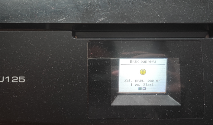

    Let's start with the lack of paper downloading. The printer indicates a jam, but after following the recommended steps nothing changes, and I don't see any leftover paper inside. It also alternately shows it missing:
    Brother printer display showing No paper message. .

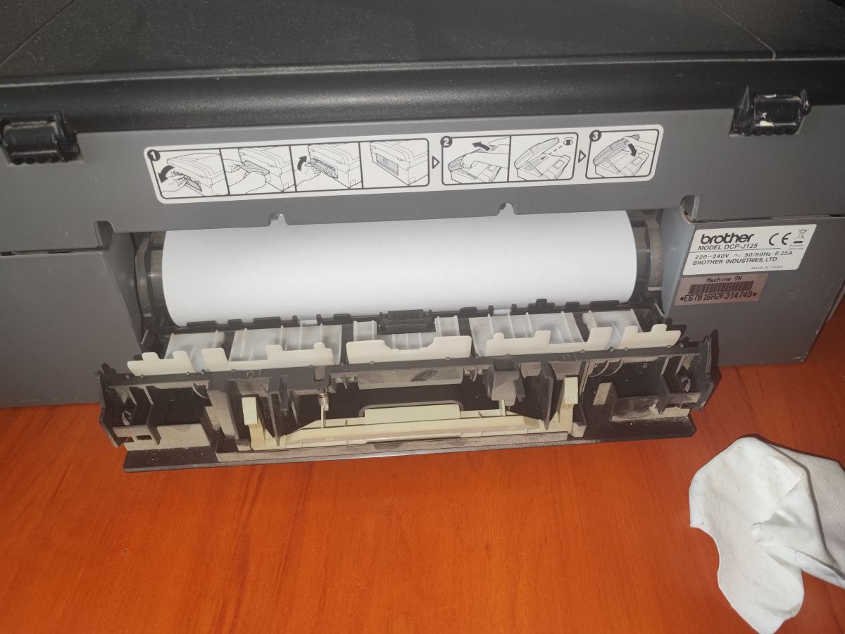

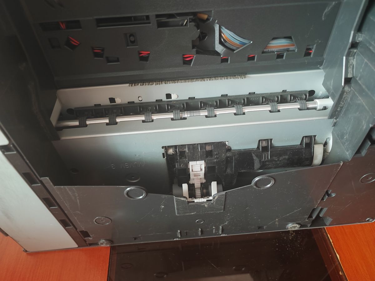

    This problem may simply mean that the interior needs to be cleaned:
    Inside view of Brother printer showing roller and paper guide mechanism. Interior of a Brother printer showing the paper feed mechanism and roller. .
    After a brief cleaning, it was possible to partially retrieve the paper:
    Front of Brother printer with paper tray open and a sheet of paper visible. .

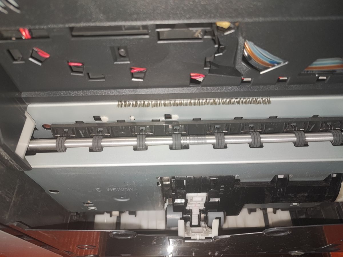

    Cleaning continues:
    Open Brother printer with visible internal mechanism, a cotton swab and a lint-free cloth lying nearby. .
    Pictured are a cotton bud and a dust-free wipe.

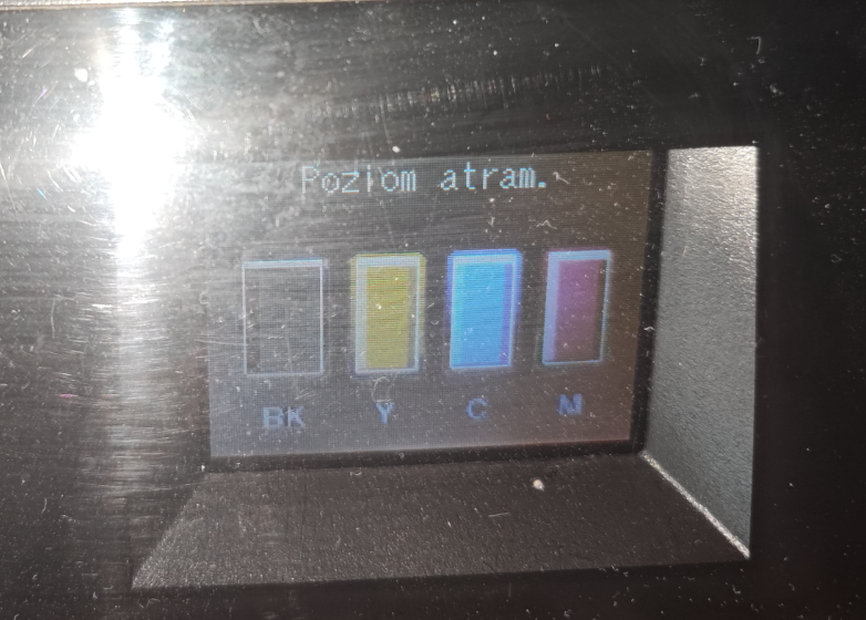

    As I wrote, the inks are almost full:
    View of ink levels on a Brother printer display. .

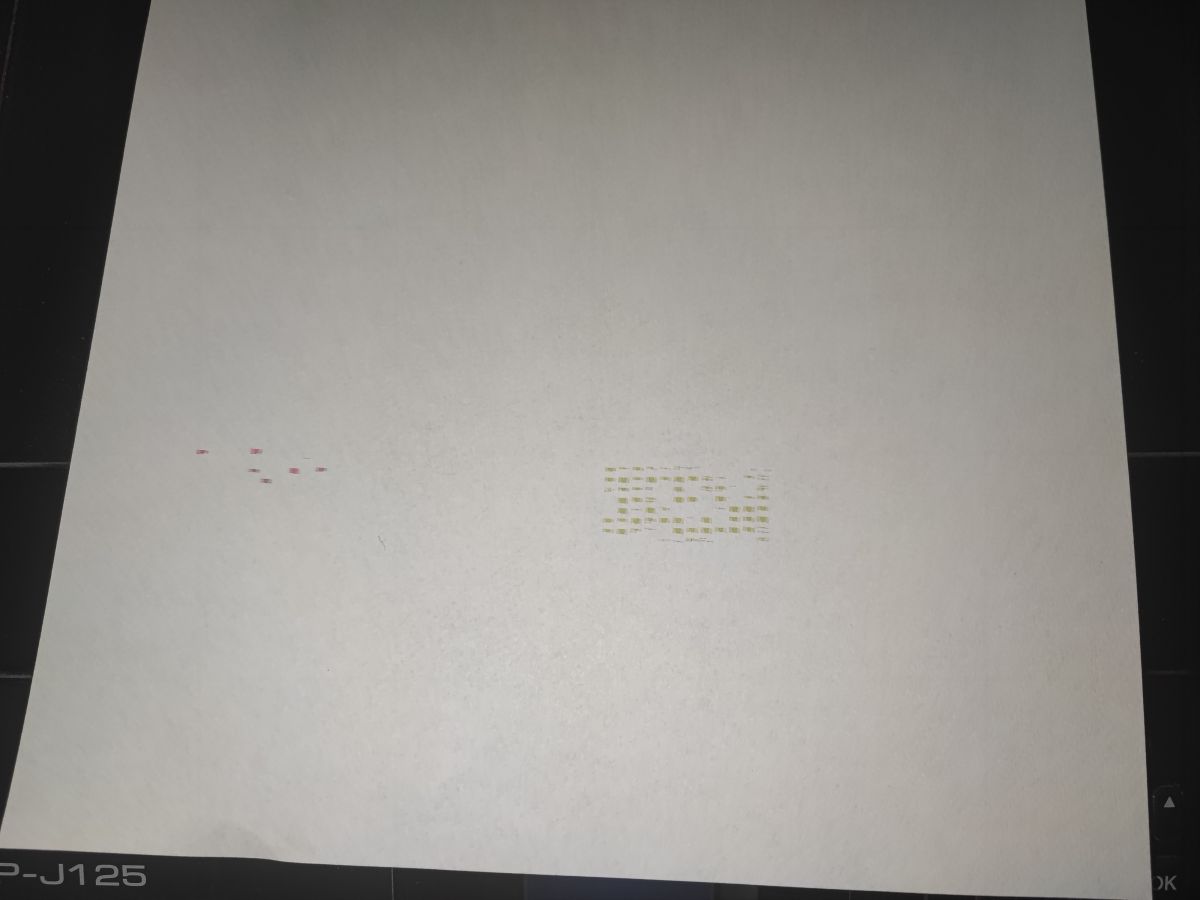

    Finally managed to run a test print, but can't see anything printing:
    Ink traces on paper from a Brother printer. .
    Well, apart from barely any marks.... ie there's another problem. Heads.
    You could let go of cleaning the heads, but that didn't do anything.

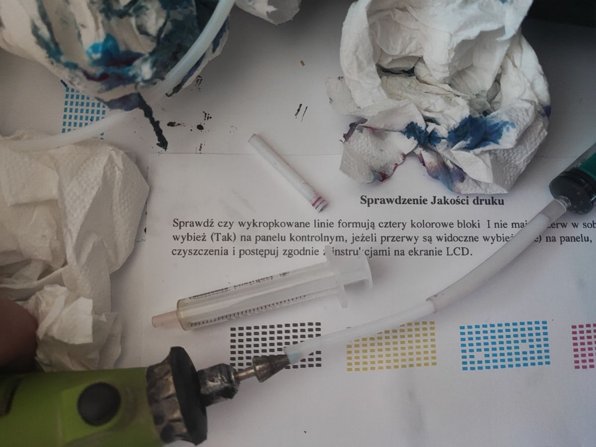

    You have to clean the manual heads. There are kits available for this on the web:
    Printer head cleaning kit with a bottle of fluid and a syringe. .
    I, however, did not have this kit, although I recommend using this type of proven solution as much as possible. I prepared the mixture myself by hand and a syringe with a matching tube. I adjusted the tube to the required size with a dremel....

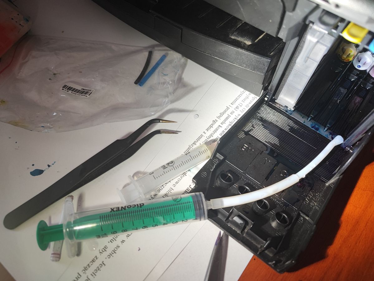

    On the table is a makeshift printer head cleaning kit composed of a green syringe, a tube, and a multi-tool. .
    This tube, by the way, is from my 3D printer, Ender 3 Pro, a filament guide.
    Set up like this allows me to pump a bit of cleaning fluid into the ink tube, and you can also draw in a bit of ink - just to clear the passage.
    Before the operation you release the head and leave it in the middle, once it's released you put a towel underneath it so you don't flood the printer with ink as a result of pushing through.
    Syringe connected to the internal mechanism of a Brother printer using a tube. .
    You have to be careful not to pump air in there! You have to keep an eye on the state of the syringe at all times; if the fluid runs out, you stop.
    Any excess fluid is removed so as not to cause a flood.

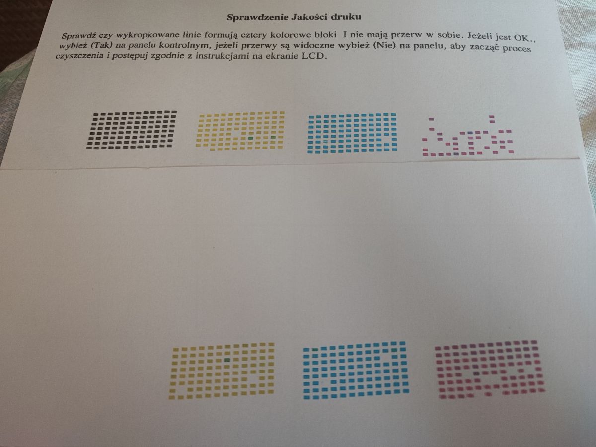

    Then you can still switch on the cleaning option from the printer itself from the menu, then this will help.
    After single and double cleaning:
    Print quality test page with colored blocks made of dotted lines. .
    After playing around for a while, the results are almost perfect:
    Test page with colorful blocks to check print quality. .
    I let the cleaning run a few more times and since then the printer has been printing correctly. I find it useful for soldering, e.g. I printed myself the WB2S pinout so I don't have to keep it open on the computer all the time.

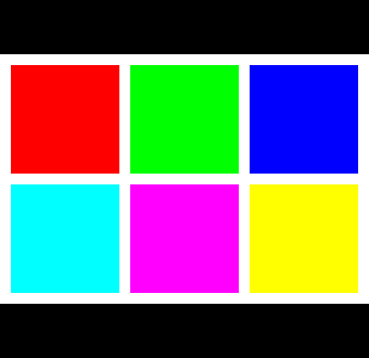

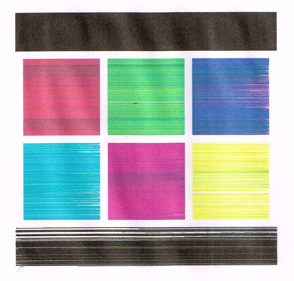

    I have a Brother MFC-J430W printer, which I use as just a scanner, as it has big problems with printing. For printing I have an HP LaserJet 1022, I hardly ever need colour printing, I use a photocopying service if I need to, and that's once every few years anyway, this fact speaks for itself.
    Initially, I decided to use the Brother MFC-J430W as a colour printer when needed and also to remember to do some small print using all colours once a week.
    Even the test page generates the same as the OP's, except that these grids are hole-punched. I once bought on All... a similar cleaning kit with a syringe. I ran the cleaning function on my printer a few times, which didn't help much, and after using the concoction it was supposedly better, the black was reasonably good (there were maybe one or two holes on the test page with the grille), and the colours were so-so, there were more holes. I used a total of two sets of ink cartridges just for repeated cleaning and testing, and still the end result was not satisfactory. Colour printing came out ragged, only black came out okay, but for black printing, I have an HP LaserJet 1022, which works fine, I replace the toner once every few years, and this printer, unlike inkjets, doesn't require regular use to keep it in good working order.
    Does my Brother MFC-J430W printer still have a chance of coming back to life? Maybe all I need to do is buy another cleaning kit? Which one? What to look at?
    I attach the original and printed image. I printed at 150dpi and scanned at 300dpi. It is rather difficult to accept the print quality obtained and this was just after cleaning, better prints could not be obtained.
    Six rectangles in primary colors: red, green, blue, cyan, magenta, and yellow. Test print from Brother MFC-J430W printer with uneven and broken colors. .

  • Brother print heads last longer than Epson or Canon
    #26 21247816
    cdtdsilva
    Posts: 173
    Rate: 15
    >>21237211
    I've always had problems with Epsons print heads eventually clogging and drying and heard the same about canon. Not so much with Brother. They seem to last forever. They can dry if the cartridge gets empty and air gets into the system, but not under regular use.
    HP used to have print heads on the cartridges, so that never happened. But I'm have no idea if that's still the case. We had one at work that failed with some error about the print head, but did last a good 6 years and was printing fine before. Possibly a ribbon cable failure?
  • #27 21248571
    MiroLord
    Level 26  
    Posts: 946
    Help: 83
    Rate: 172
    Epsons are not suitable for occasional printing due to the head design. It's worth ploughing through some A4 photos once a week, although on my L1800 the head didn't dry up after a 3-week outage while I was on holiday.
  • #28 21406914
    keseszel
    Level 26  
    Posts: 4106
    Help: 54
    Rate: 558
    I will add my "five cents" about printers. In Brother printers, the head fails quite often if they are disconnected from the mains and do not clean themselves. This is a subject I have also dealt with myself. I had a Brother.
The discussion centers on cleaning and restoring an old Brother inkjet printer retrieved from electronic waste, which shows full ink levels but fails to feed paper and indicates paper jams without visible obstructions. Common issues with inkjet printers include clogged print heads due to infrequent use and drying ink, especially if the printer is powered off and not regularly maintained. Several contributors highlight that Brother printers require regular use or continuous power connection to prevent head drying, as they perform automatic cleaning cycles when powered. Cleaning methods mentioned include manual cleaning with syringes and specialized cleaning fluids, though aggressive solvents can damage print head coatings. High-quality print mode can sometimes improve output by allowing better ink flow. Users report mixed success with cleaning kits and note that print heads may eventually fail, making replacement or purchasing a new printer more cost-effective. Laser printers, such as Ricoh and HP models, are recommended for home use due to their durability, low maintenance, and toner longevity, especially for black-and-white printing. Epson EcoTank models receive mixed reviews; while they offer refillable inks, their print heads can dry out if not used frequently. Compatibility issues with newer operating systems and firmware updates affecting third-party consumables are also noted. Overall, the consensus is that while old Brother inkjets can sometimes be revived with cleaning and maintenance, their longevity depends on usage patterns, and laser printers may offer a more reliable alternative for infrequent printing needs.
