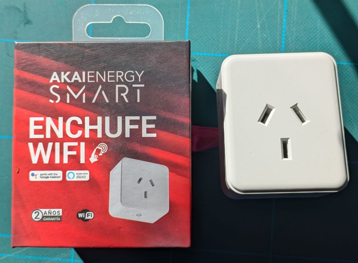

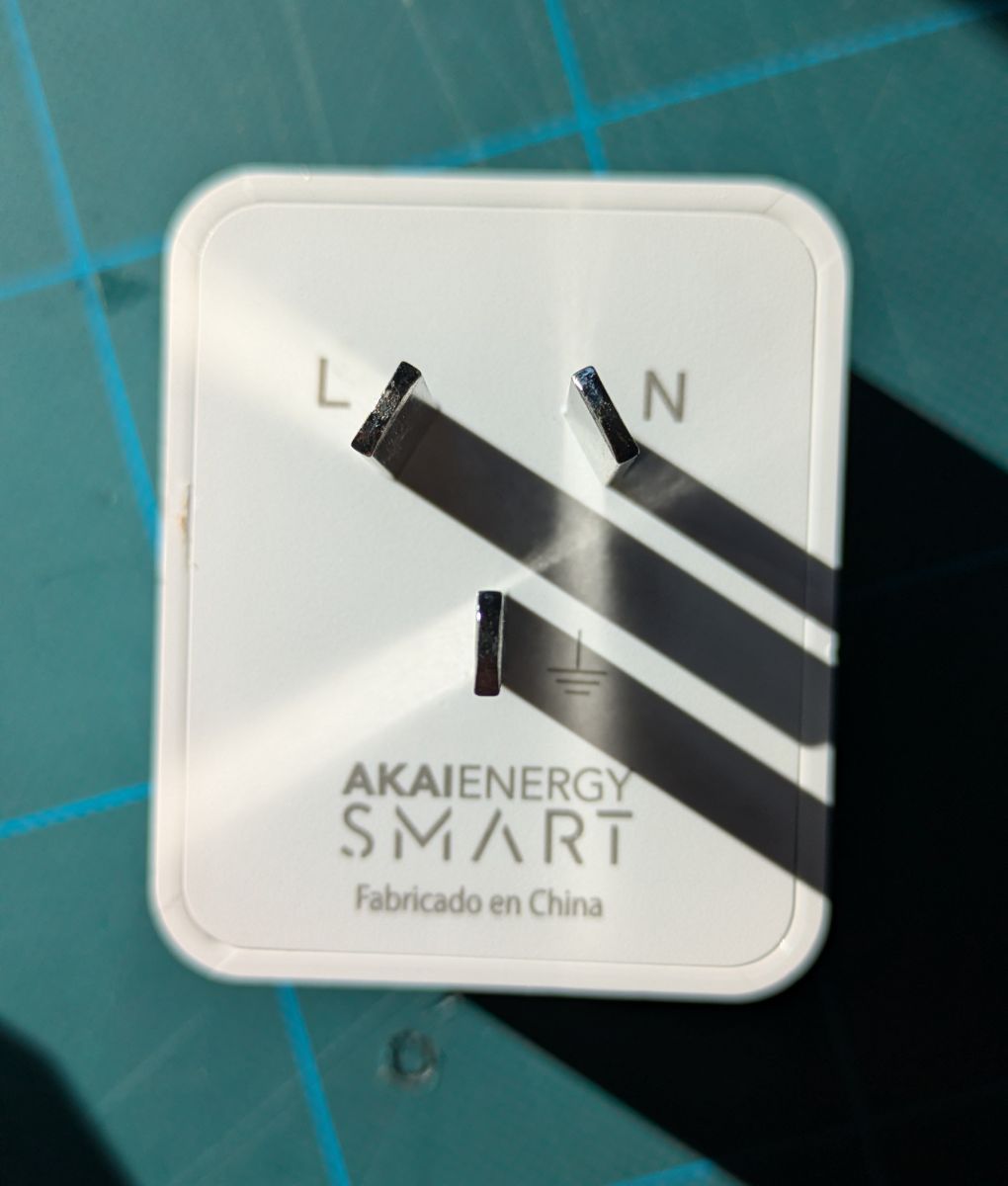

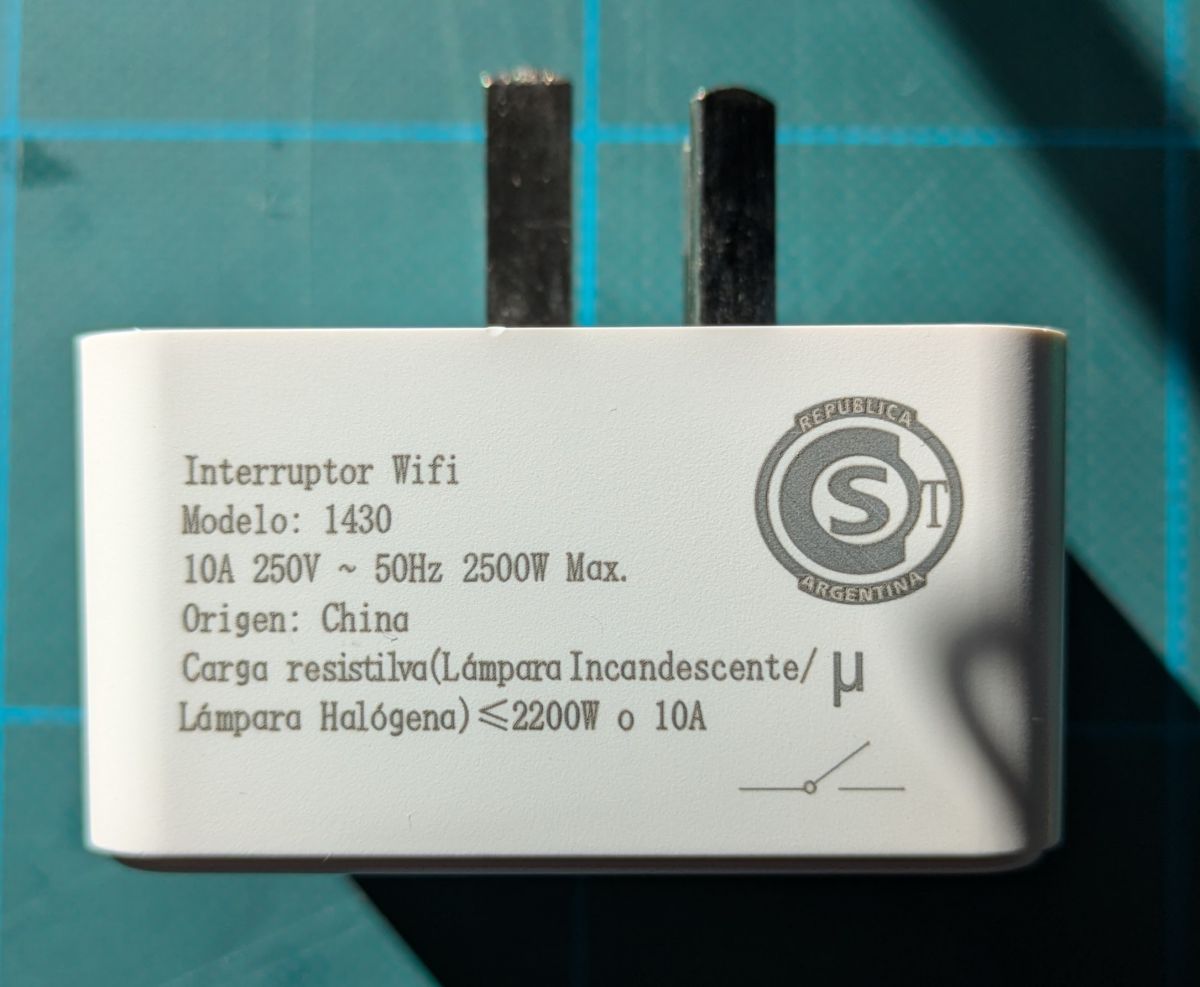

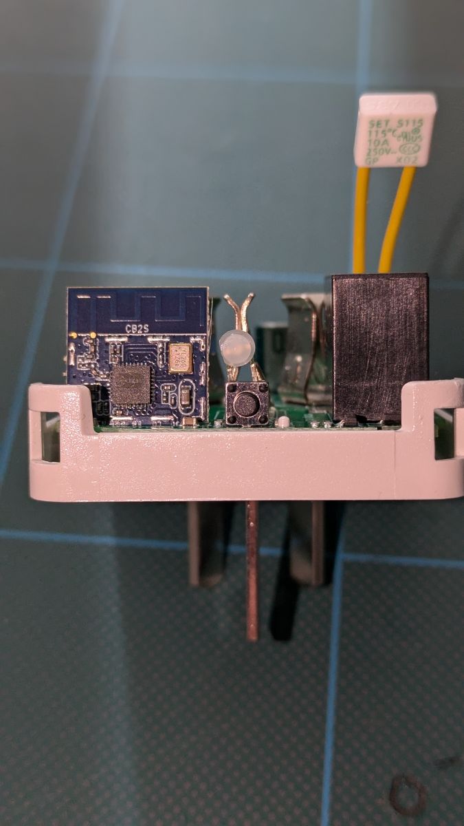

    My submission is for an Smart Plug bought on Mercado Libre Argentina with the BK7231N / CB2S chip. It's branded as Akai Energy Smart.
    Akai Energy Smart plug next to its box.

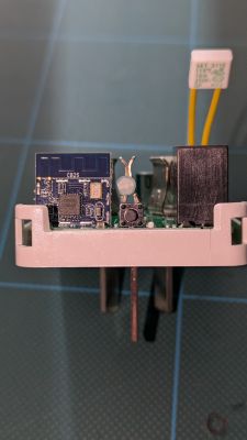

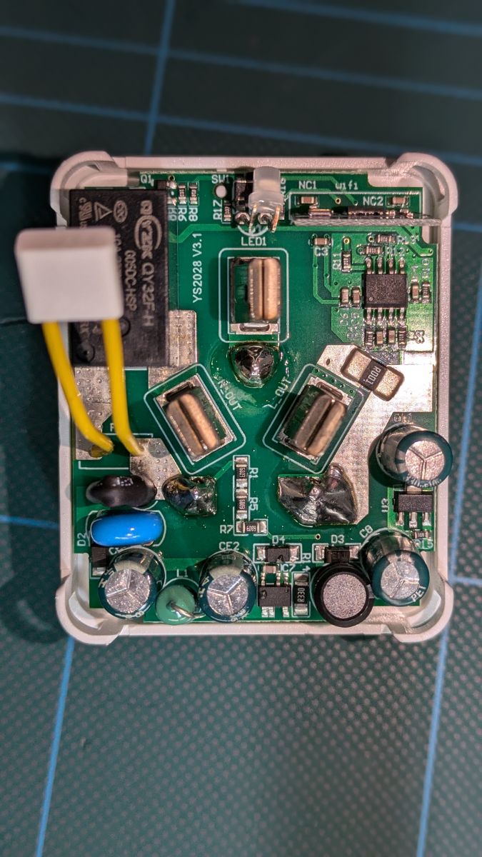

    Smart WiFi plug with label showing model and specifications. Close-up of an Akai Energy Smart plug with three metal prongs. Interior of Akai Energy Smart plug with CB2S module. Close-up of the opened interior of a smart plug with visible PCB and components. CB2S module with BK7231N chip on a green mat background.

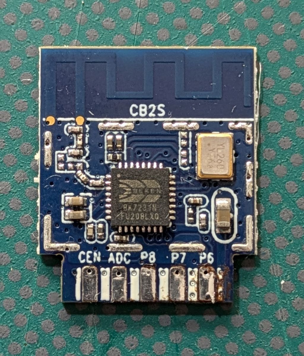

    The nice thing about it is that it's not glued, so it's quite easy to crack open (it does require some force though). I tried with tuya-cloudcutter but I failed to do the flashing. With some patience I was able to solder the cables for connecting it using UART and I flashed it successfully.
    - BL0937 SEL on P10
    - Button (channel 1) on P6
    - BL0937 VI on P26
    - WiFi LED on P7
    - BL0937 ELE on P24
    - Relay (channel 1) on P8
    Device seems to be using CB2S module, which is using BK7231N.

  • OBK config added for Akai Energy Smart plug
    #2 21172535
    Posts: 14755
    Rate: 12878
    Thank you for sharing, here is OBK config:
    I've added template to our list:
    https://github.com/OpenBekenIOT/webapp/commit/14046304288fecf1dc3ec0234cc497c504c6d7b6
