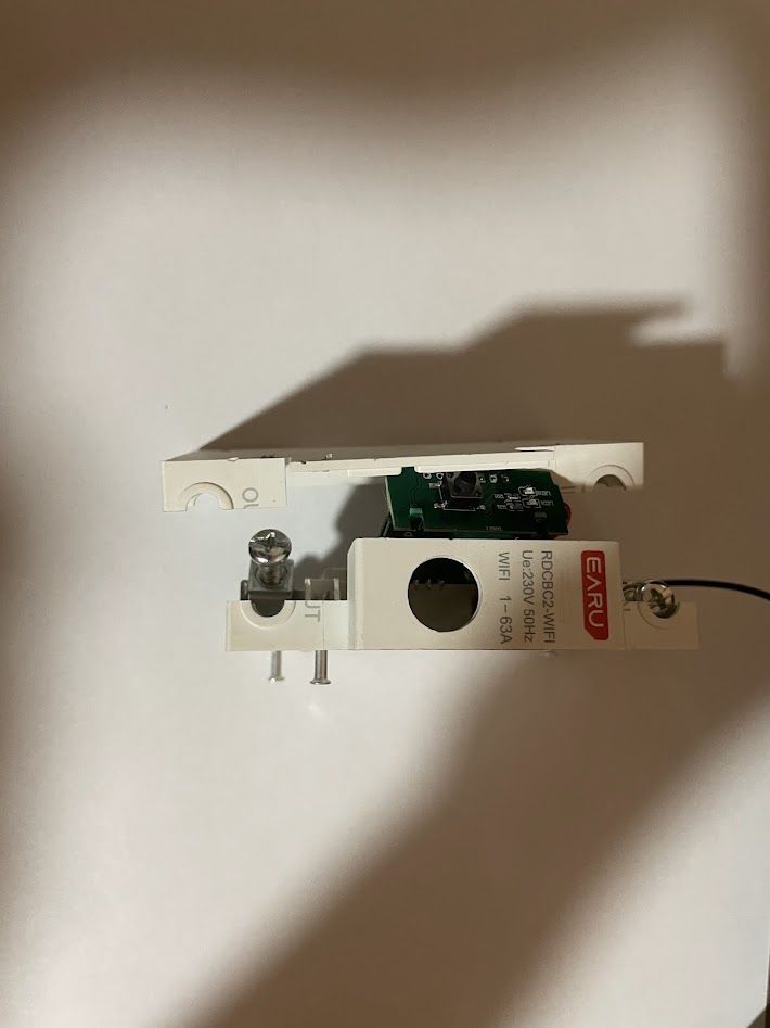

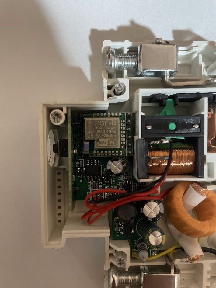

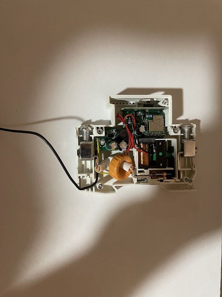

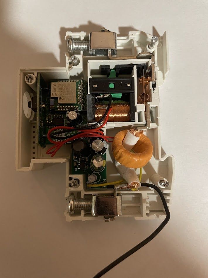

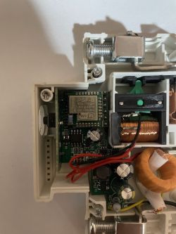

    I bought EARU RDCBC2-WIFI power meter from aliexpress
    https://www.aliexpress.com/item/1005003989276....order_list.order_list_main.29.1d041802a2uBvw
    Upon disassembling it (pretty difficult due to rivets holding it together) it appears that it uses a PSF-B module, so possibly based on ESP8285. The energy monitoring module appears to be cse7759b.
    Is there any support available for this (like tasmota or esphome) and maybe some templates/configurations?
    Below are photos of the device
    Photo of a disassembled EARU RDCBC2-WIFI power meter with exposed electronics. Interior of EARU RDCBC2-WIFI power meter showing PSF-B module. Image of the interior of the EARU RDCBC2-WIFI power meter after disassembly. Dismantled EARU RDCBC2-WIFI power meter with visible electronic components
