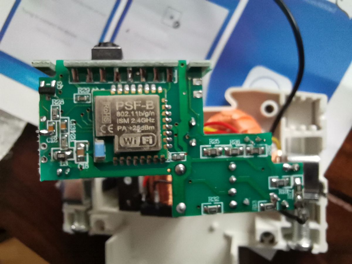

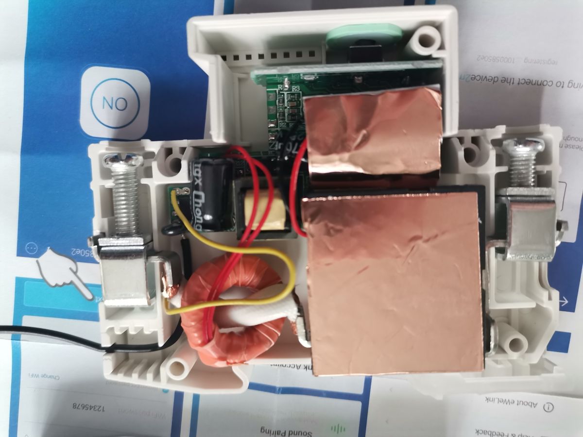

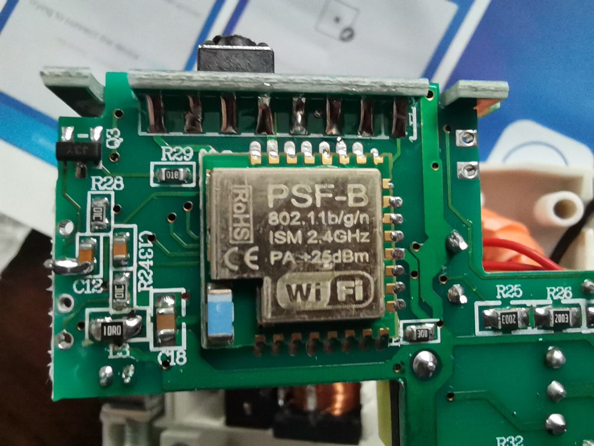

  • A strange WiFi DIN-mount circuit breaker uses a PFS-B main module with ESP8285, SC92F7351, and CSE7759 inside a single enclosure.
  • It appears to trip with an 8-bit MCU and a bistable relay instead of the usual automatic magnetic field coil trip mechanics.
  • The unit packs everything into a 19 mm DIN package.
  • It still leaves the circuitry unexplained, with more details promised after reverse-engineering the internal wiring.

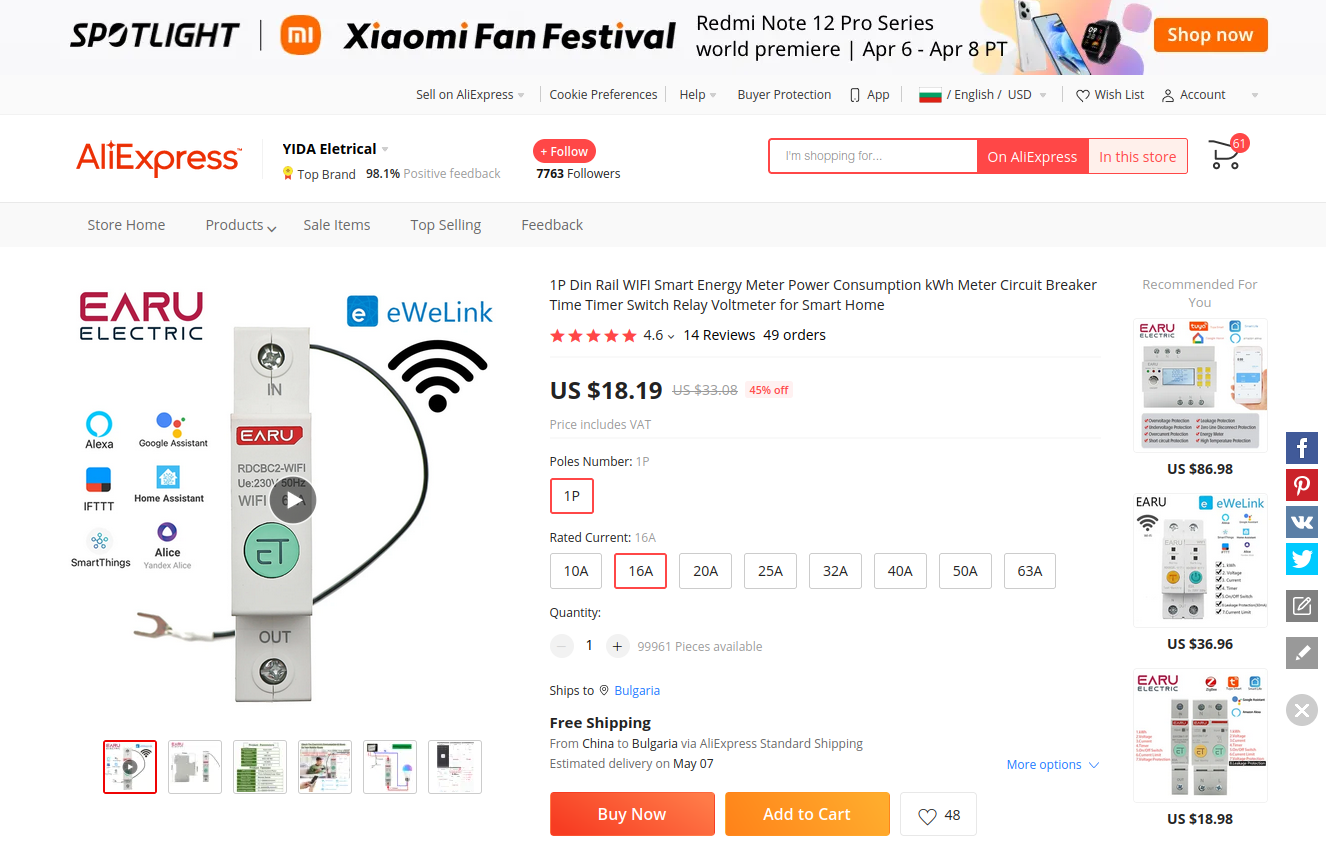

  • Bought from here:
    Link

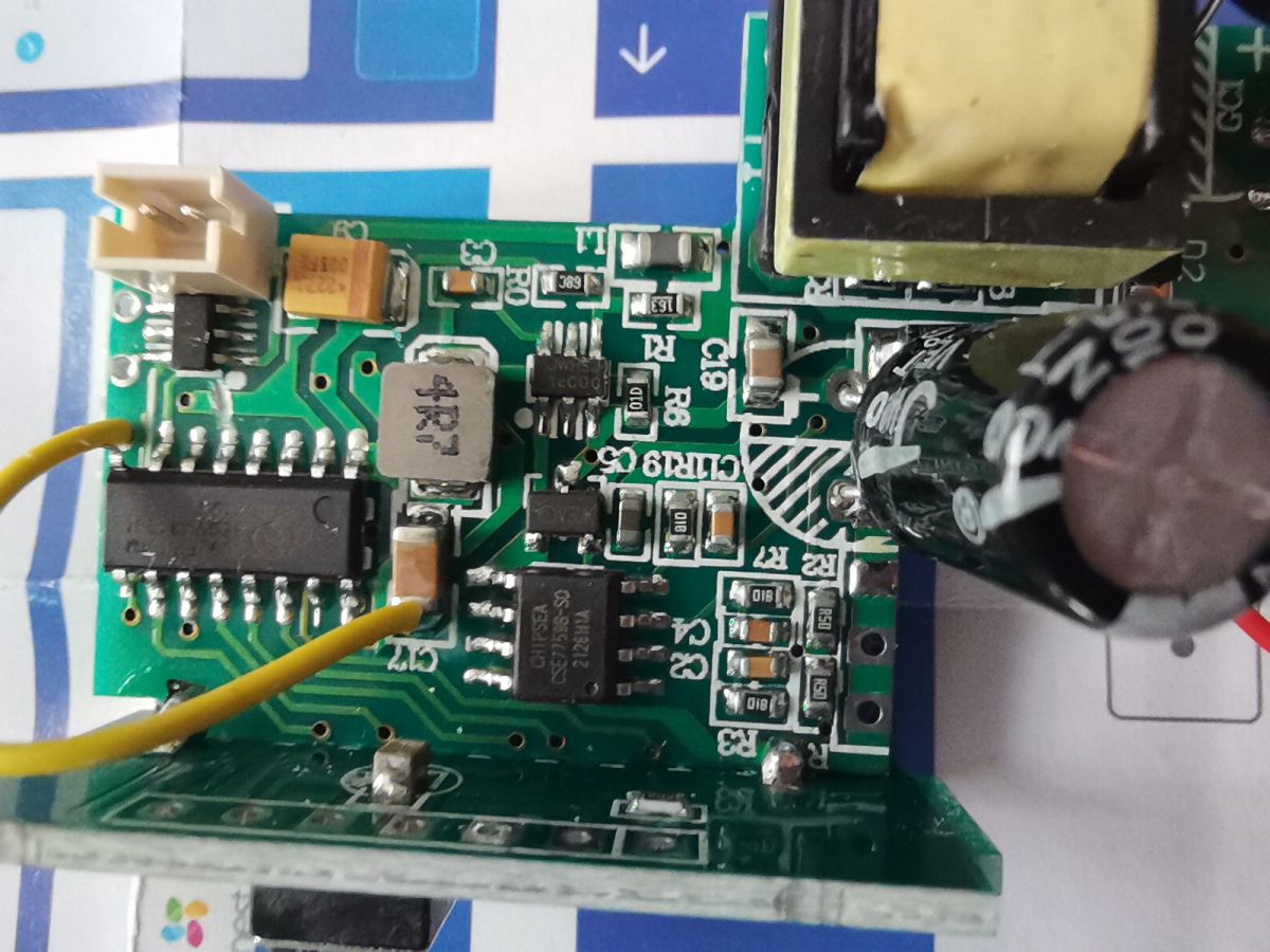

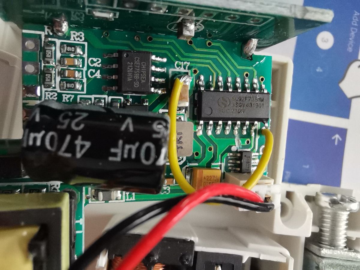

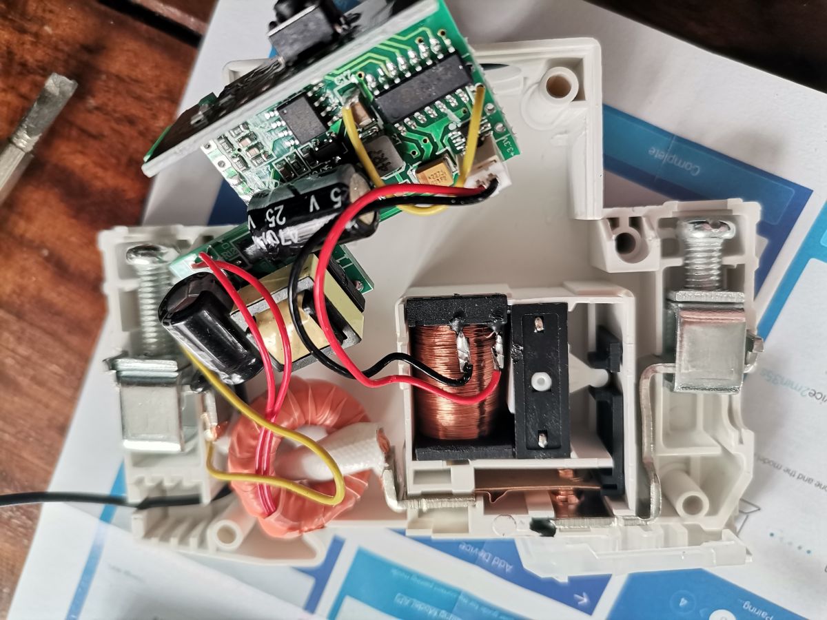

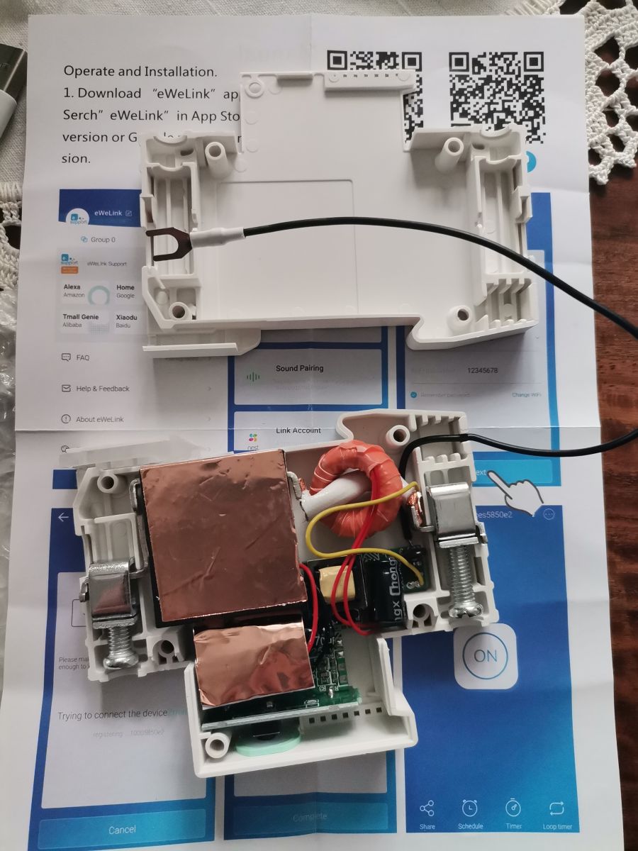

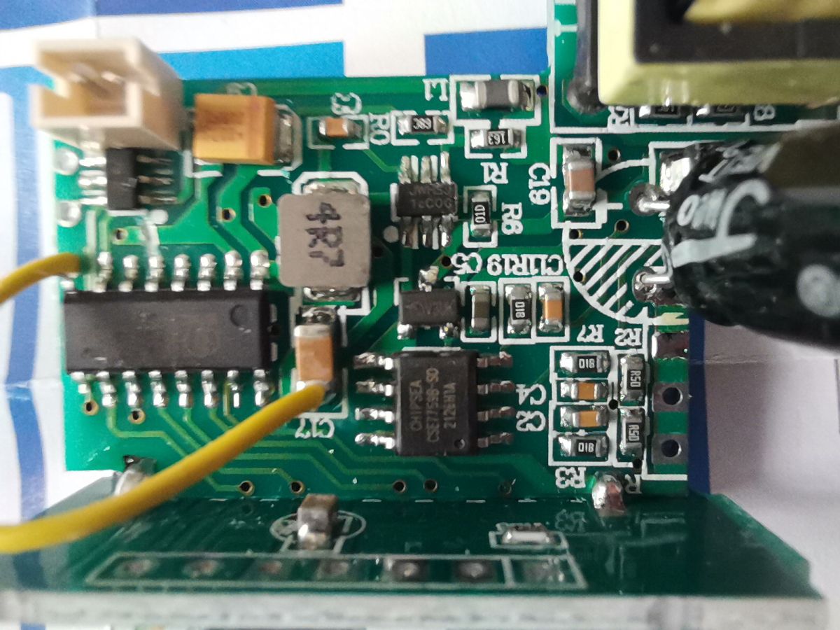

    Page screenshot:
    Unique WiFi DIN Mount Circuit Breaker with ESP8285, SC92F7351 & CSE7759: In-Depth Details

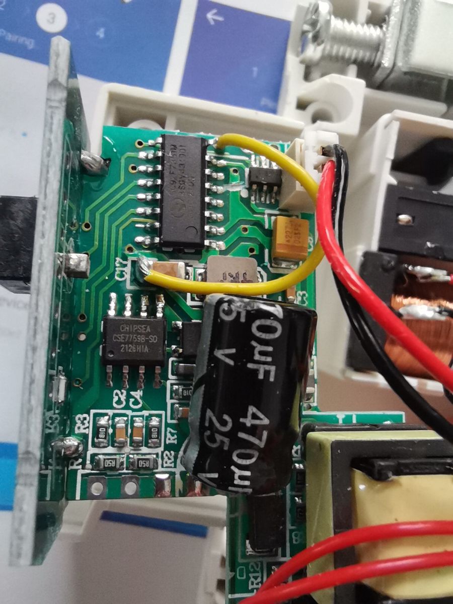

    Package contains strange circuit breaker, without automatic magnetic field coil trip mechanics. It seems to explore 8 bit MCU + bistable relay for trip. Main module is PFS-B containing ESP8285 CPU. Although there is powerfull 32 bit CPU there is additional 8 bit micro controller SC92F7351. I think this is to provide high reliability.
    Energy meter is CSE7759. All this is packed in 1 unit 19 mm DIN package.
    More details I'll post later when I manage to discover circuitry.
    Here are the images:

    Thank you, that's a very interesting teardown. I haven't been aware about the PSF-B module, but luckily pinout is already known:
    Right now I will add that this is most likely a TuyaMCU device. I would suggest doing a UART packet capture from RX/TX lines, but of course this has to be done with device disconnected from mains and powered in some kind of safe manner...

    hello,

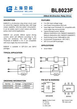

    anybody can identify transistors matrix in sot23-6 package, near relay socket, after some tests i have dead this transistor.
    thanks in advance
    Gintas
  • #5 20536253

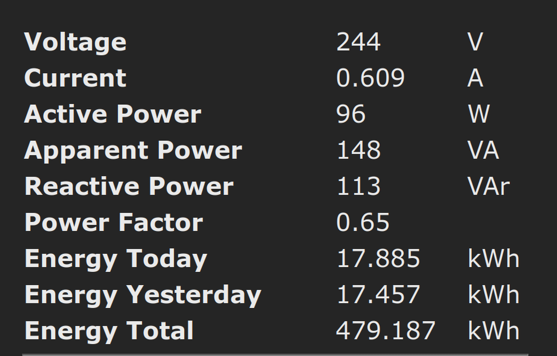

    Update:
    I managed to flash Tasmota.
    I just had to break CSE7759B connection to RX.
    Looks like it's working.
    Config: GPIO0 - Button 1, GPIO3 - CSE7766 Rx, GPIO12 - Relay 1, GPIO13 - LedLink
    Looks like SC92F7351 is controling relay and second red led, but it is connected directly to gpio12 of esp8255. No TuyaMcu protocol.

    What are the counter values displayed in Tasmota?
    Could you post some screenshots/logs please?
  • #9 21202375
    civic9
    Posts: 75
    Rate: 17
    >>21202346
    Displayed values of electrical energy parameters such as voltage, current, active power, apparent power, and others.

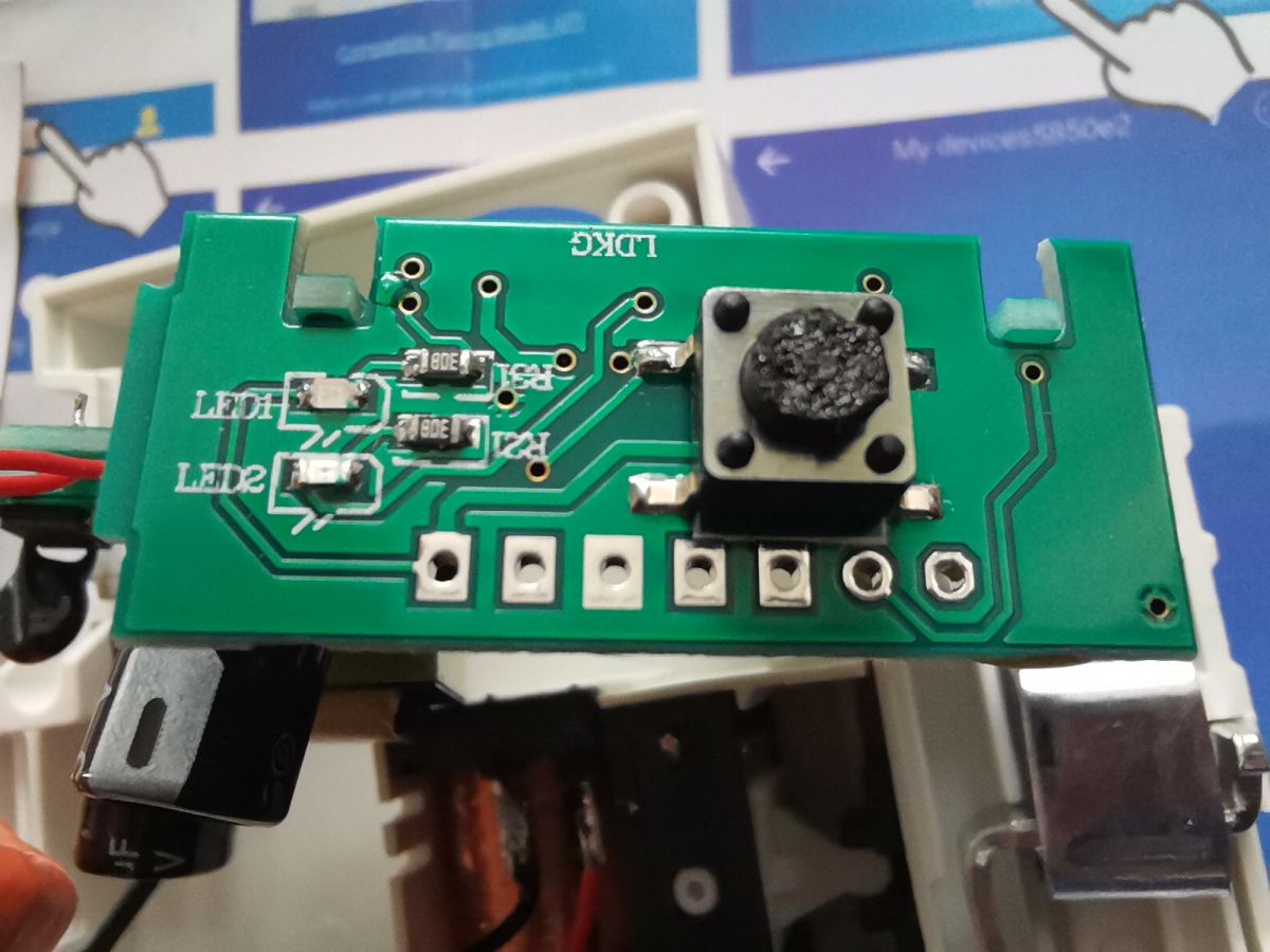

    >>21202806
    jkwim wrote:
    Was the opening of the device destructive?
    Rivets are used to hold two parts of an enclosure together. So dissasembling it is somewhat destructive. However, rivets can be drilled out quite easily and you can replace them with small screws afterward.
    I am not sure if it is safe to use a GPIO directly (without some form of extra separation) with another external device.

  • The relay-area SOT23-6 device is BL8023F, identified as a 300 mA bi-direction relay driver. [#20536190]
