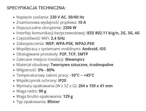

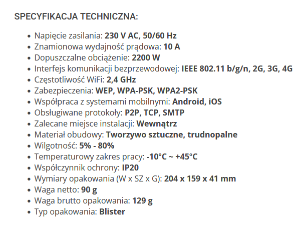

    Technical specifications of WS-03H1 module with sensor .

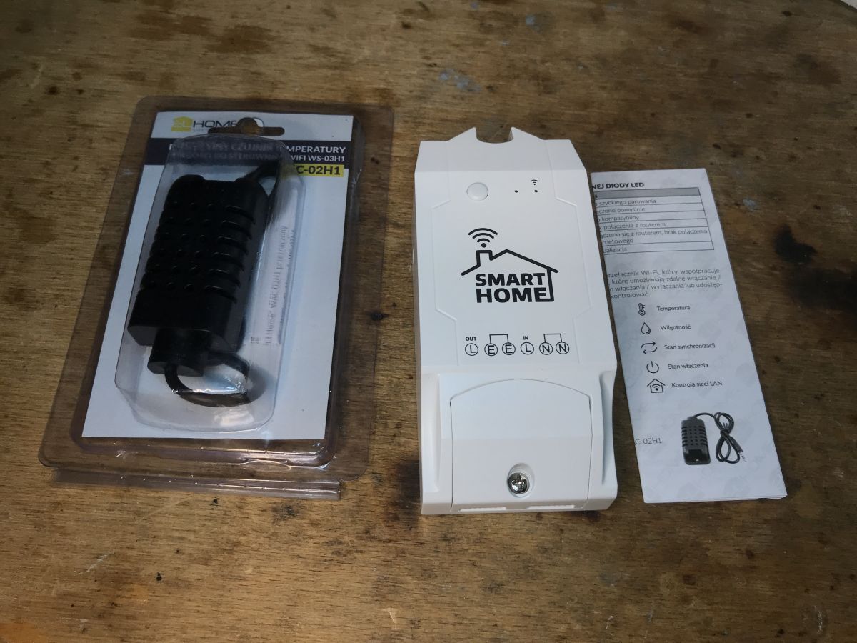

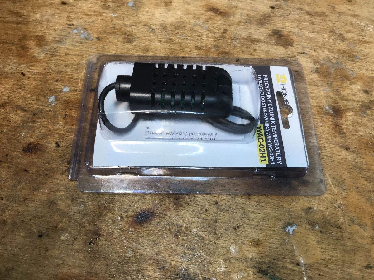

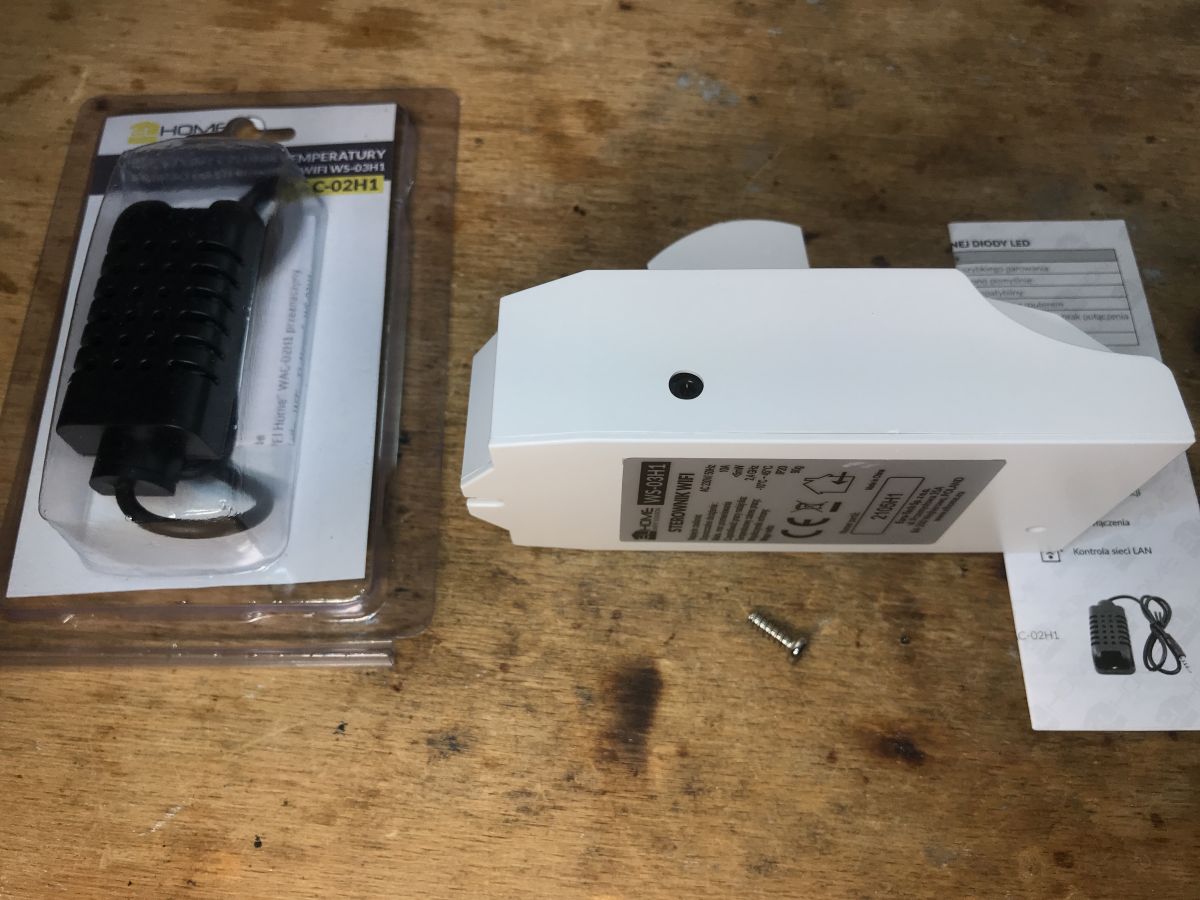

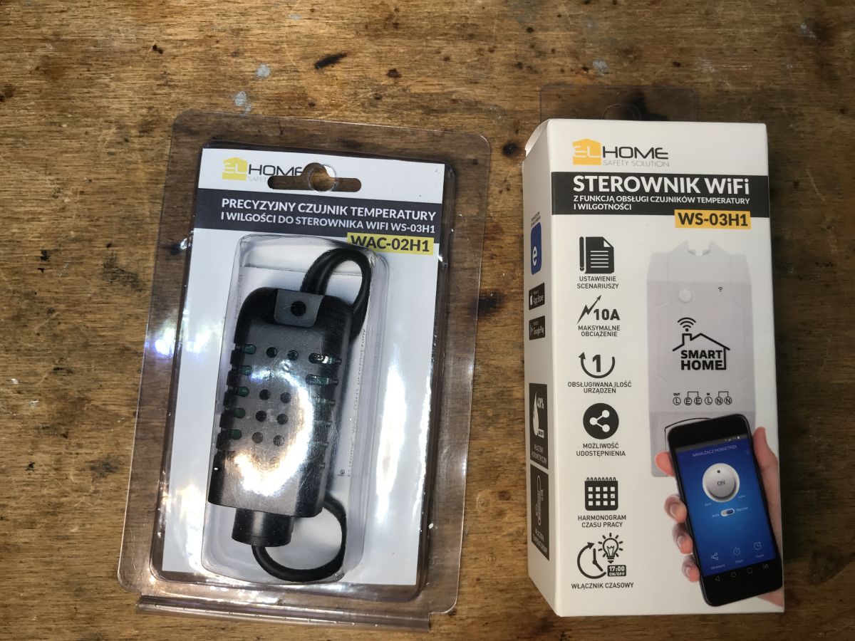

    We get a set like this:
    WS-03H1 elHome module set with WAC-02H1 temperature and humidity sensor. WS-03H1 elHome module set with WAC-02H1 sensor in packaging .
    The module has a jack socket on the side for the sensor:
    WS-03H1 elHome module and WAC-02H1 sensor on a wooden table .

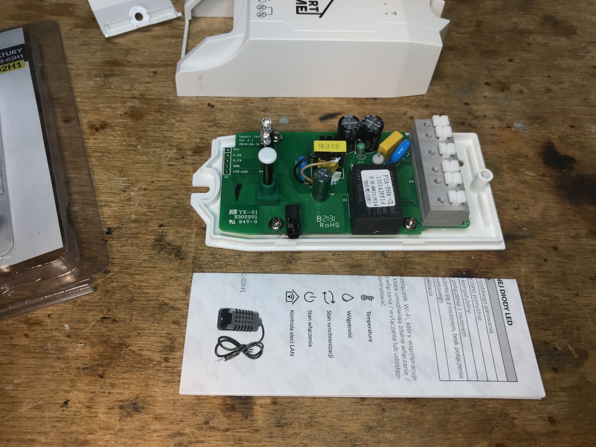

    Before dismantling I already had my suspicions, but only after removing the housing does everything become clear:
    PCB of the WS-03H1 module with electronic components and a relay. .
    This is simply a Sonoff TH10/16 repainted from the outside:
    WS-03H1 module with visible internal components. .

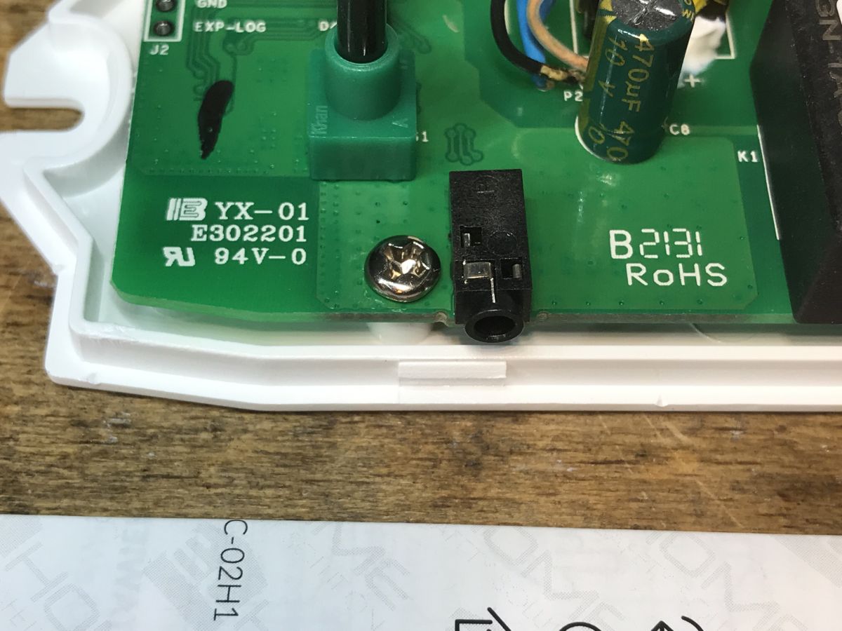

    Here is the connector for the sensor:
    Close-up of the WS-03H1 module's PCB with a jack socket. .

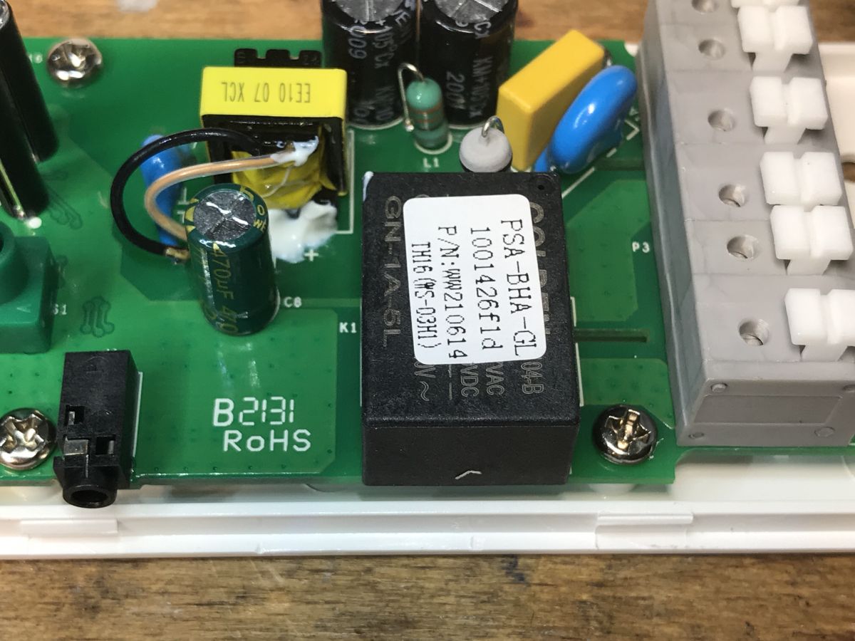

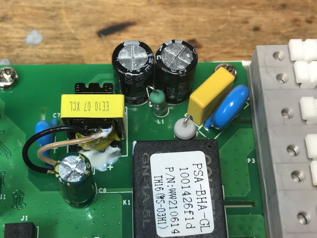

    Relay and in the background the power supply, by the way it's been a long time since I've seen a capacitor and varistor in a smart device, the quality here is quite good:
    Close-up of the interior of WS-03H1 module with visible electronic components. Photo of the interior of the WS-03H1 module showing a relay and jack socket. .

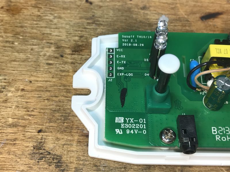

    There is also a programming connector - IO0 is missing, but IO0 is on the button.

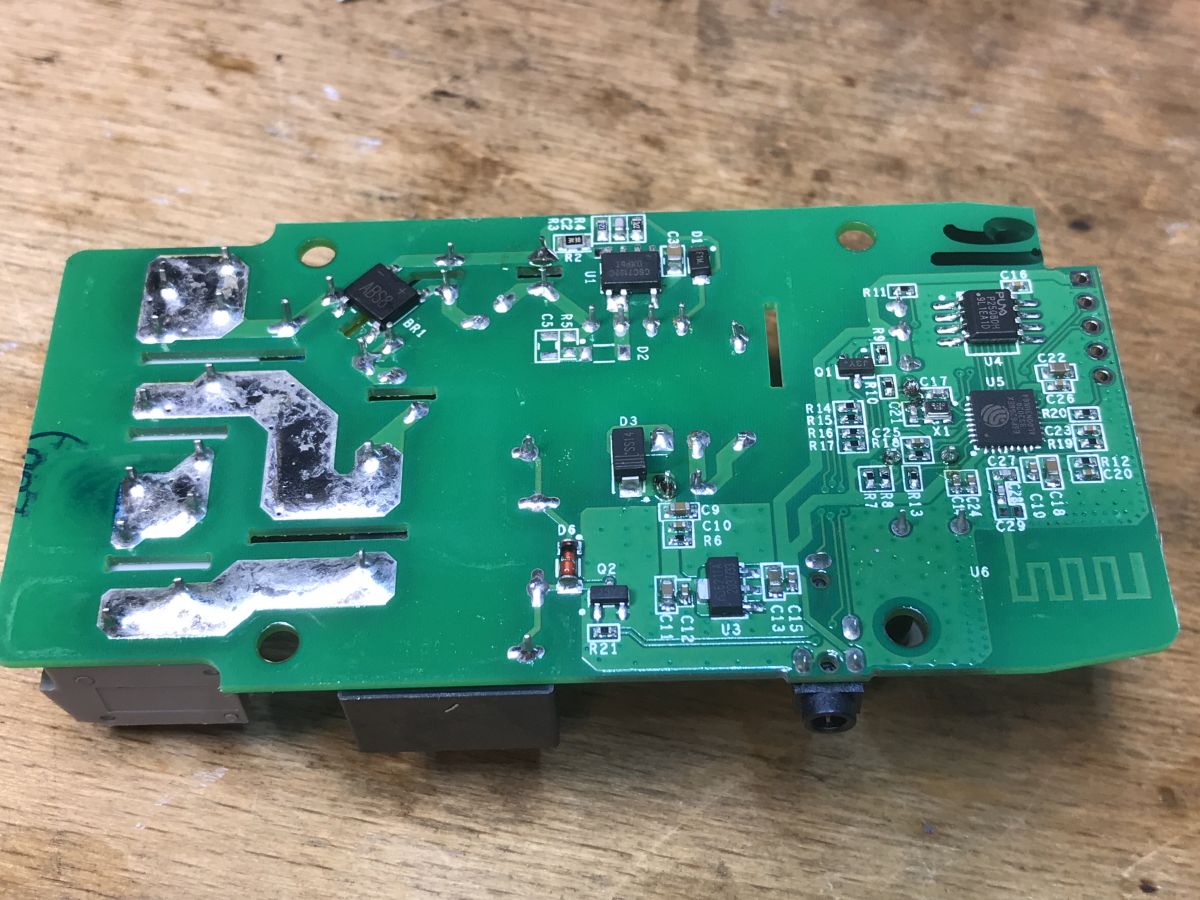

    Now the underside of the PCB:
    PCB board with electronic components of the WS-03H1 module. .

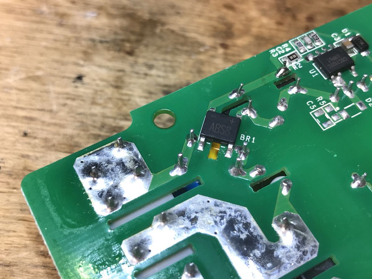

    Rectifier bridge:
    Close-up of internal components on the PCB of the WS-03H1 module. .

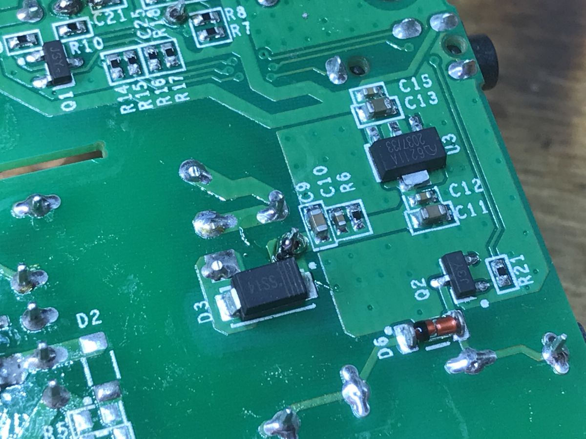

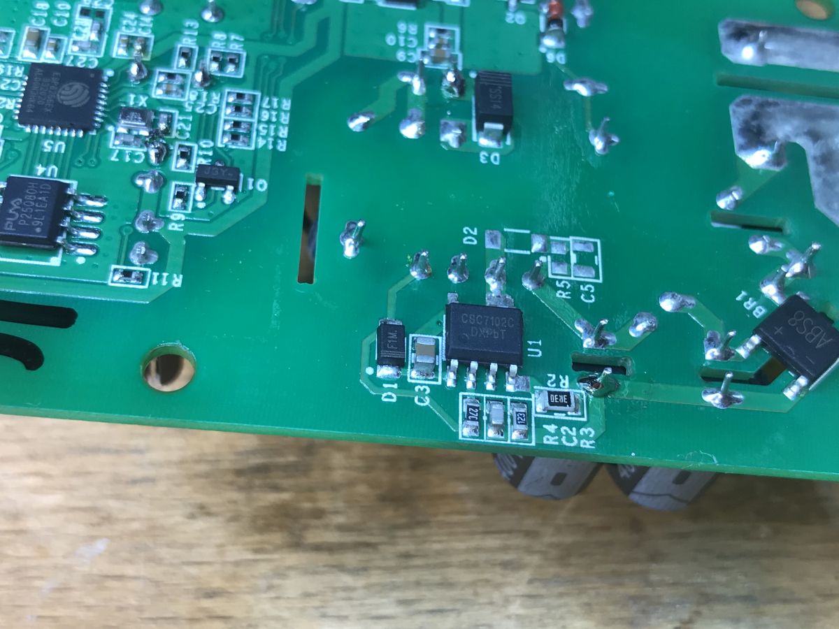

    The flyback converter here is based on the CSC7102C:
    WS-03H1 module circuit board with visible integrated circuits and CSC7102C converter .
    But it generates the voltage to power the relay. The ESP requires a slightly lower voltage, a stable 3.3V, wic there is also an extra LDO here:
    Close-up of the WS-03H1 module PCB with visible electronic components. .

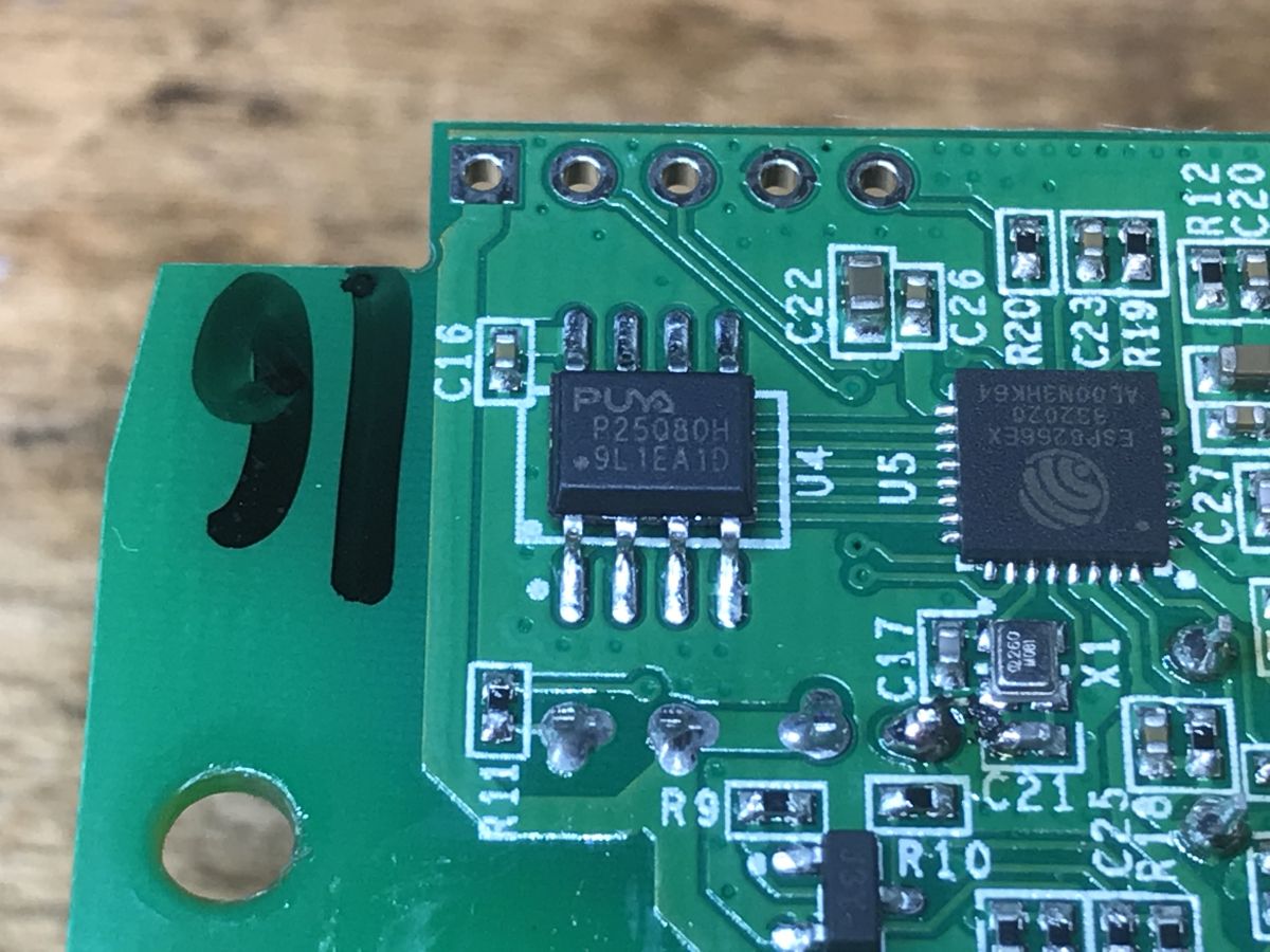

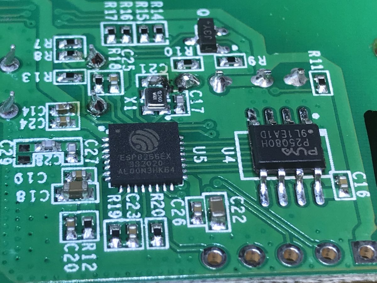

    And then there's the ESP itself - along with the SPI memory bone of course, the Puya P25Q80H, just 1MB.
    Close-up of a circuit board featuring the ESP8266EX chip and Puya P25Q80H SPI memory. Close-up of the WS-03H1 module PCB with visible components. .

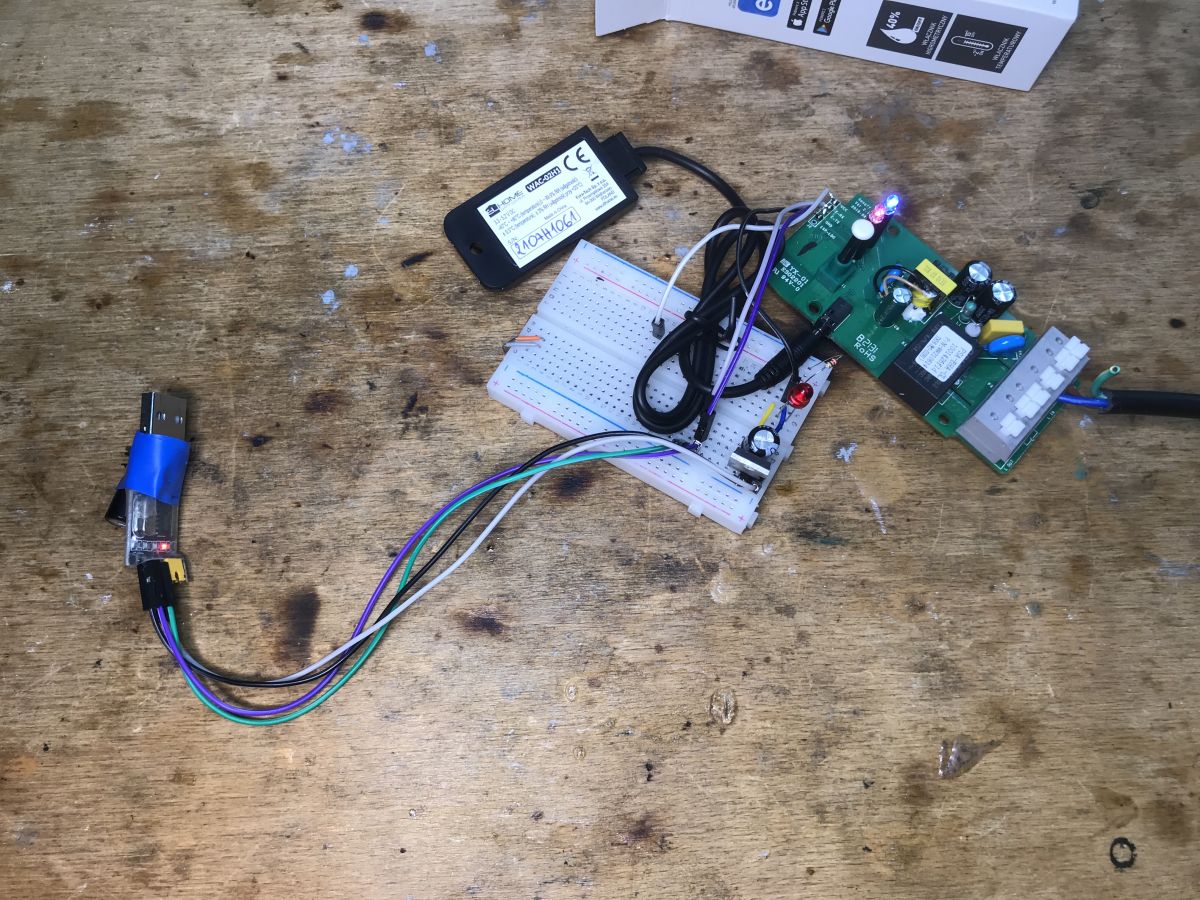

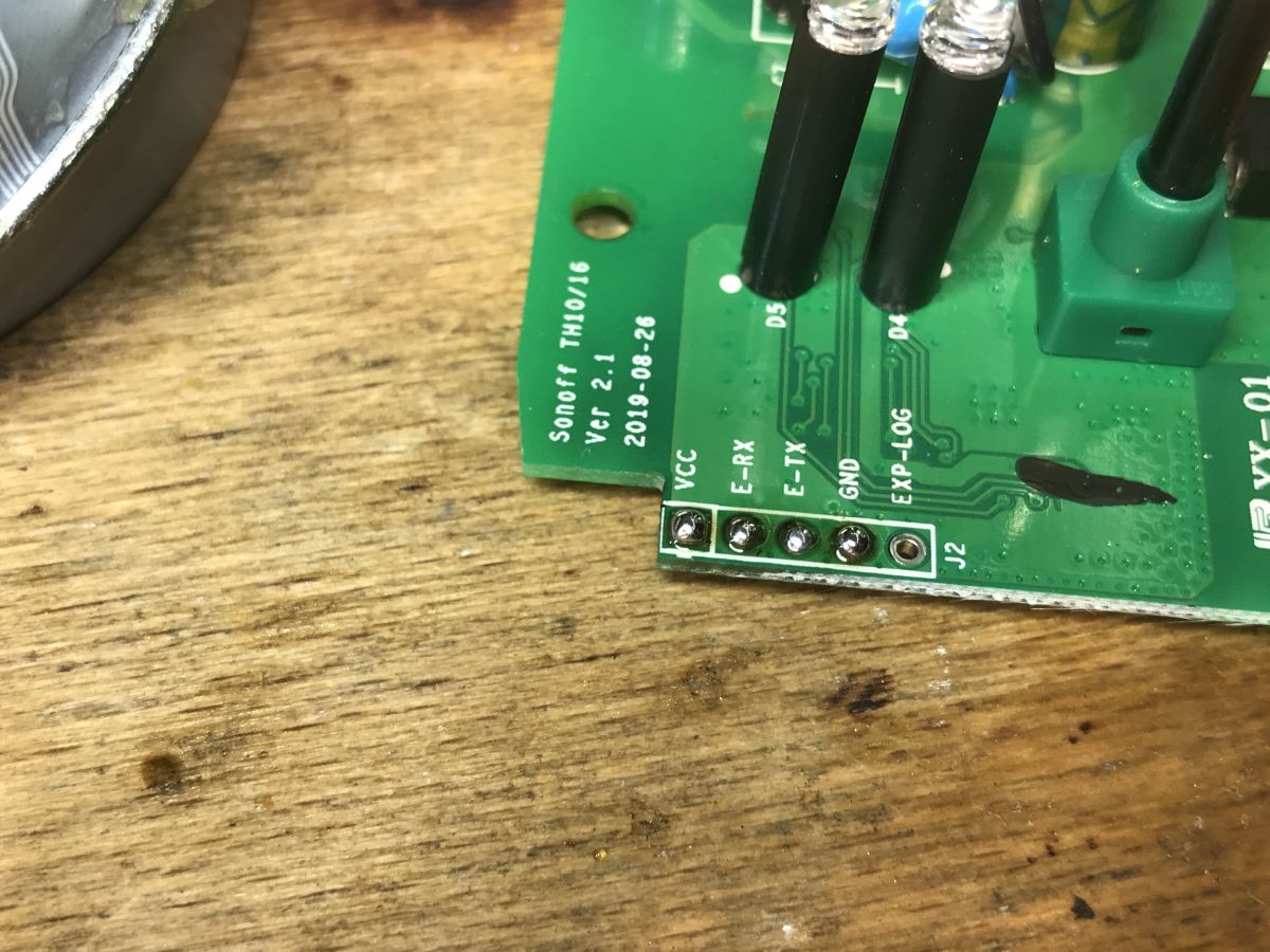

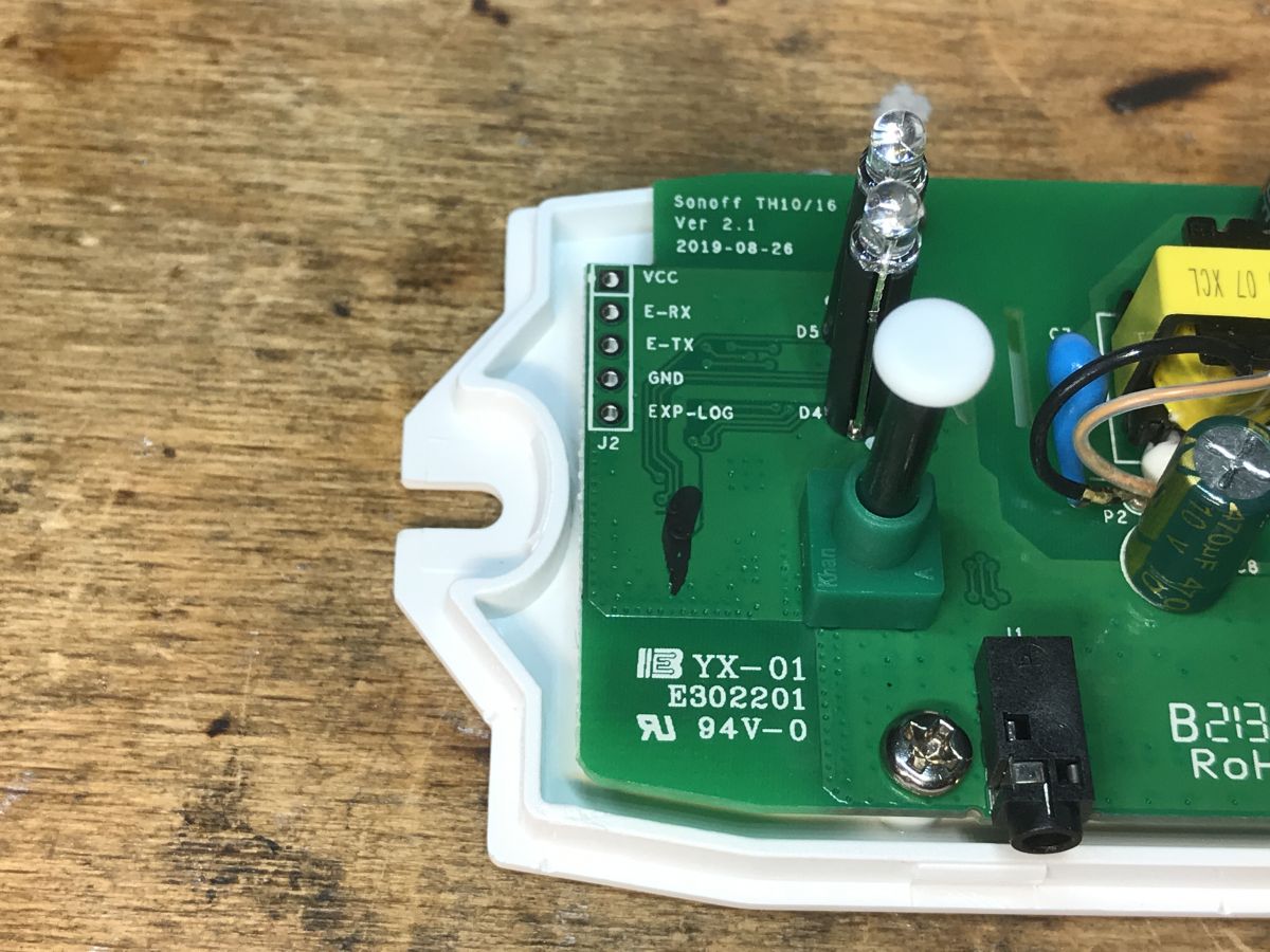

    Changing the WS-03H1 .

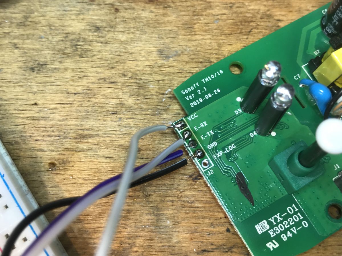

    We solder the four cables. We don't solder IO0 because it's led to the button. We only need to hold this button at the time of reboot.
    Close-up of Sonoff TH10/16 PCB board with connection ports. Close-up of Sonoff TH10/16 circuit board with visible connector labels and connected wires. The photo shows a disassembled electrical module with a breadboard and sensor connected by wires. .
    Then we can use esptool.py or Tasmota's online installer:
    How to install Tasmota easily - online installer tasmota.github.io/install via web browser .

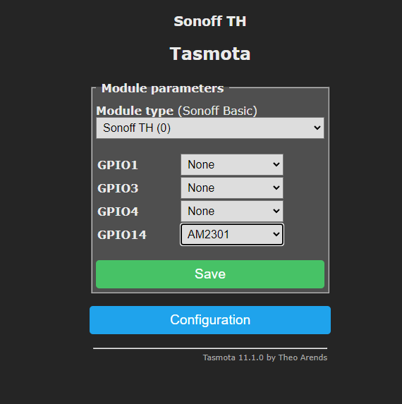

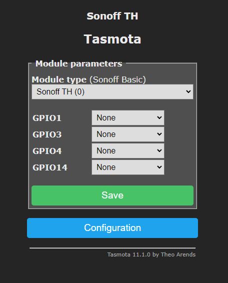

    What remains is to configure Tasmota.
    Fortunately, we already know it's a Sonoff TH10/16 clone, so the Blakadder website comes to the rescue:
    https://templates.blakadder.com/sonoff_TH.html
    Basic template:
    {"NAME":"Sonoff TH","GPIO":[17,255,0,255,255,0,0,0,21,56,255,0,0],"FLAG":0,"BASE":4}
    There we also have a list of known sensors for this model:
    - Sonoff Si7021 Temperature & Humidity Sensor
    - Sonoff AM2301 Temperature & Humidity Sensor
    - Sonoff DS18B20 Temperature Sensor
    - Sonoff AL560 5m Extension Cable
    Our sensor is located at IO14 , so we select a role for it as in the example below:
    Tasmota software configuration interface for Sonoff TH module. .
    Screenshot of the Tasmota interface showing the configuration for a Sonoff TH module. .
    After saving the settings and restarting, we should already be receiving measurements.

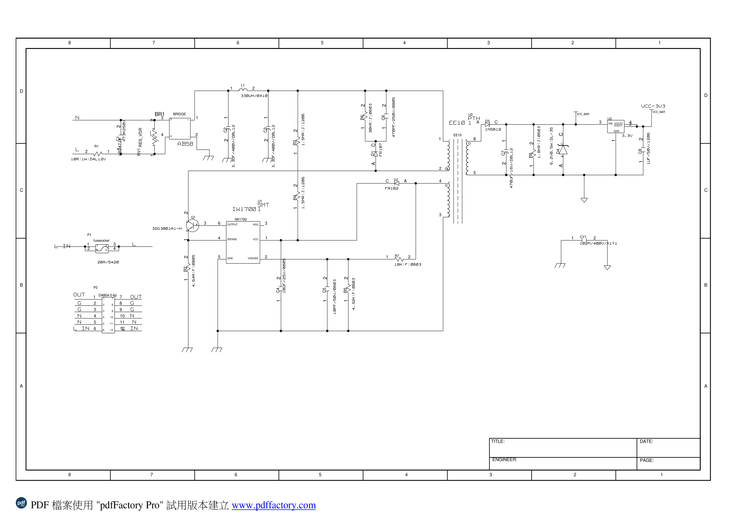

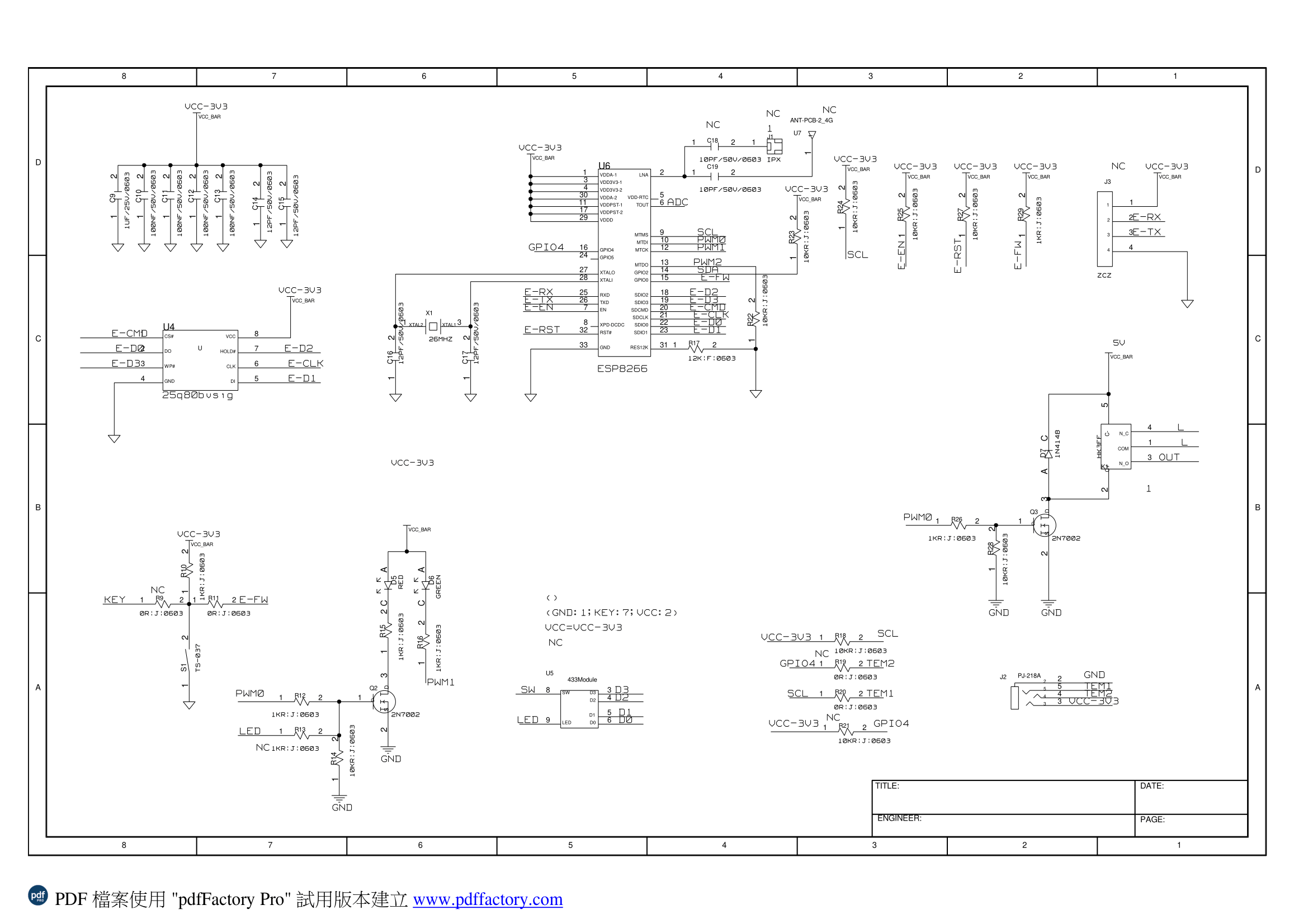

    Schemat WS-03H1 .
    This time exceptionally the product in question has a diagram available online:
    https://wiki.iteadstudio.com/Sonoff_TH_10/16
    Electrical schematic of WS-03H1 elHome module Electrical schematic of the WS-03H1 elHome module with sensor. .
    Only minor differences I can see here, e.g. the inverter in the schematic is an IW1700 and in mine it's a CSC7102C. Probably both circuits are very similar.

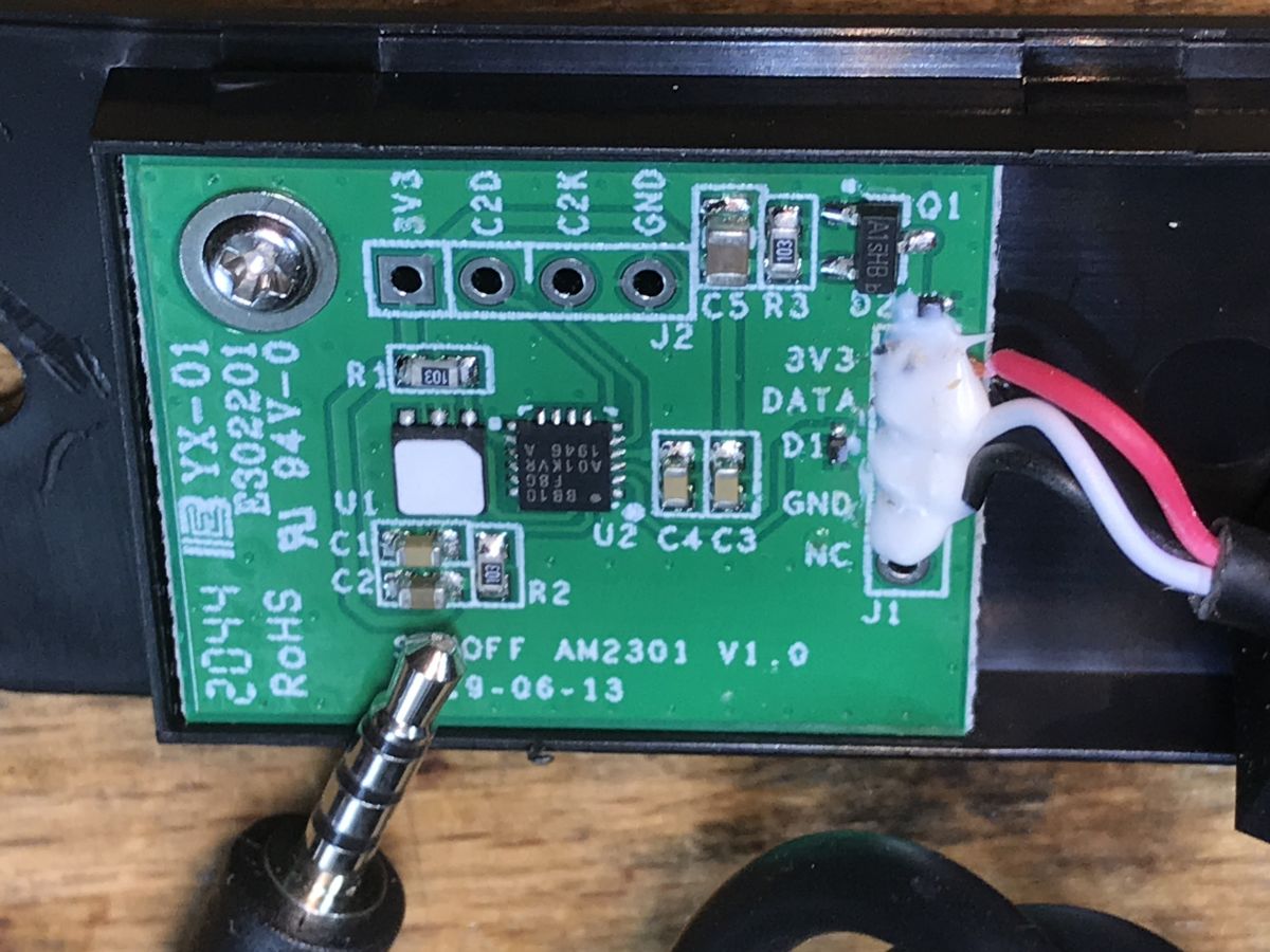

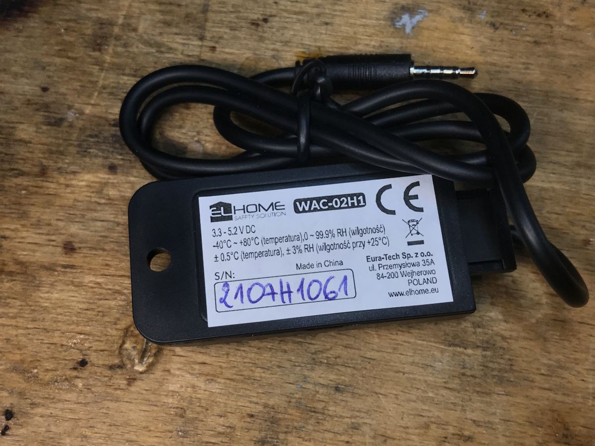

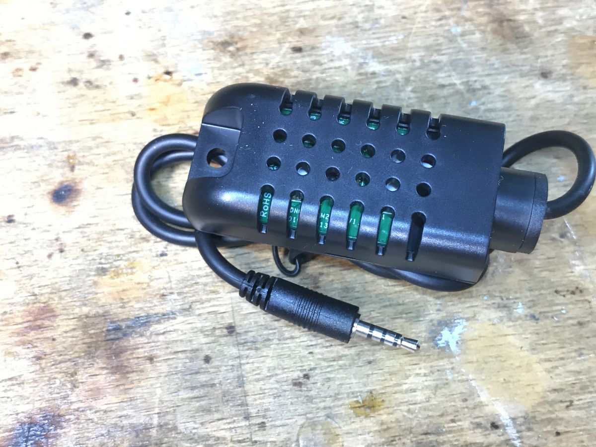

    Interior of sensor .

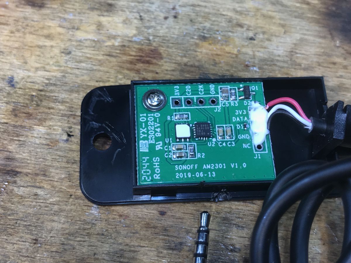

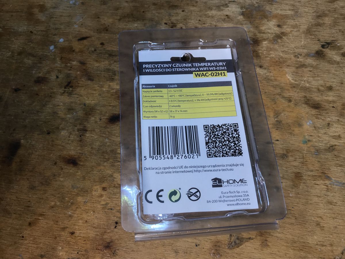

    Then let's see the inside of the WAC-02H1 sensor:
    WAC-02H1 temperature and humidity sensor in ElHome packaging. Label describing the WAC-02H1 temperature and humidity sensor. Label of the WAC-02H1 temperature and humidity sensor with technical specifications. elHome WAC-02H1 temperature and humidity sensor with label on wooden surface Temperature and humidity sensor WAC-02H1 with jack plug .

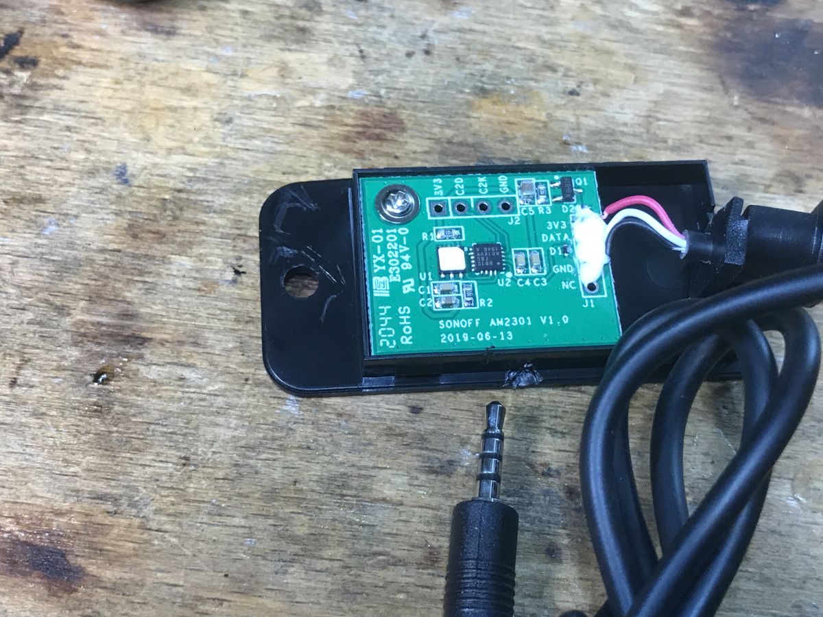

    After removing the casing:
    Close-up of the AM2301 temperature and humidity sensor PCB with a jack socket. Image of the interior of the AM2301 sensor on a wooden background. Interior of AM2301 temperature and humidity sensor showing the circuit board. .

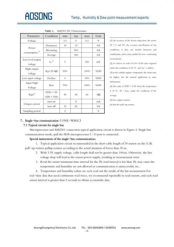

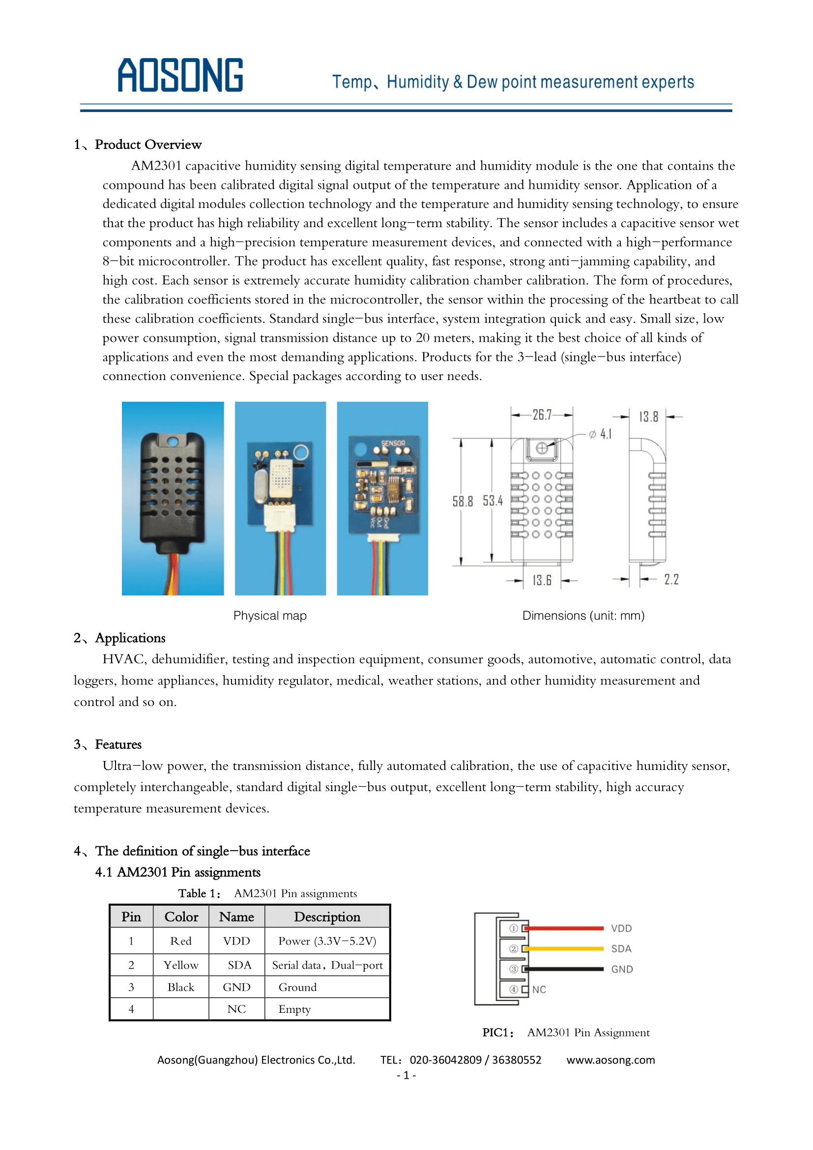

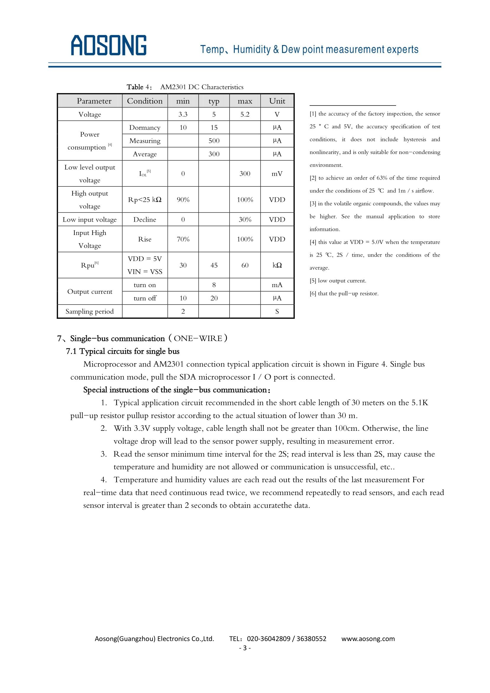

    Well again - full documentation is available online:
    https://wiki.iteadstudio.com/images/3/39/AM2301_Manual.pdf
    AM2301 temperature and humidity sensor specification Table with technical specifications of Aosong AM2301 sensor.
