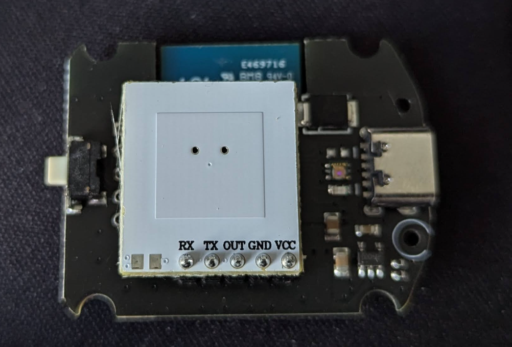

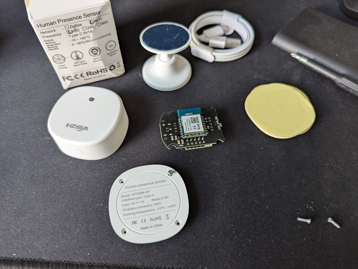

    I accidentally bought a WiFi rather than Zigbee human presence sensor - 5.8GHz microwave

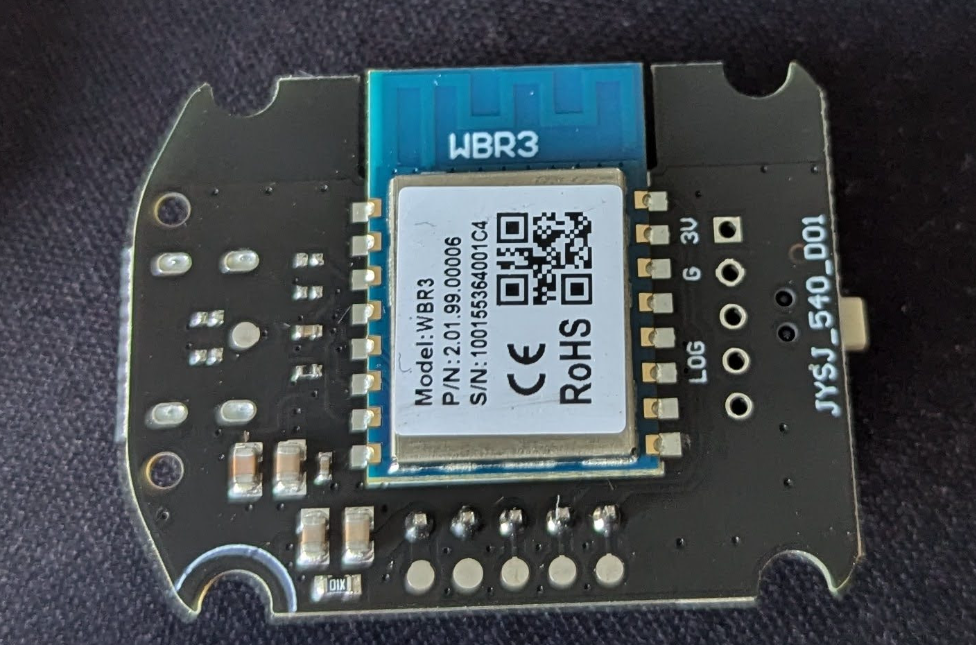

    Contains the WBR3 module
    Do we think this is flashable and supported with OpenBK?
    Board model number - JYSJ_540_D01
    WiFi human presence sensor with exposed circuit board and accessories on a table. Electronic module with WBR3 chip on JYSJ_540_D01 board. WiFi presence sensor module with RX, TX, OUT, GND, VCC labels.
  • #2 21376408
    Posts: 14649
    Help: 655
    Rate: 12660
    This is RTL8720CF . They are now flashable. See tutorial: WBR2, WBR3, WBRU, W701-VA2-CG pinout, datasheet, flashing for Home Assistant
