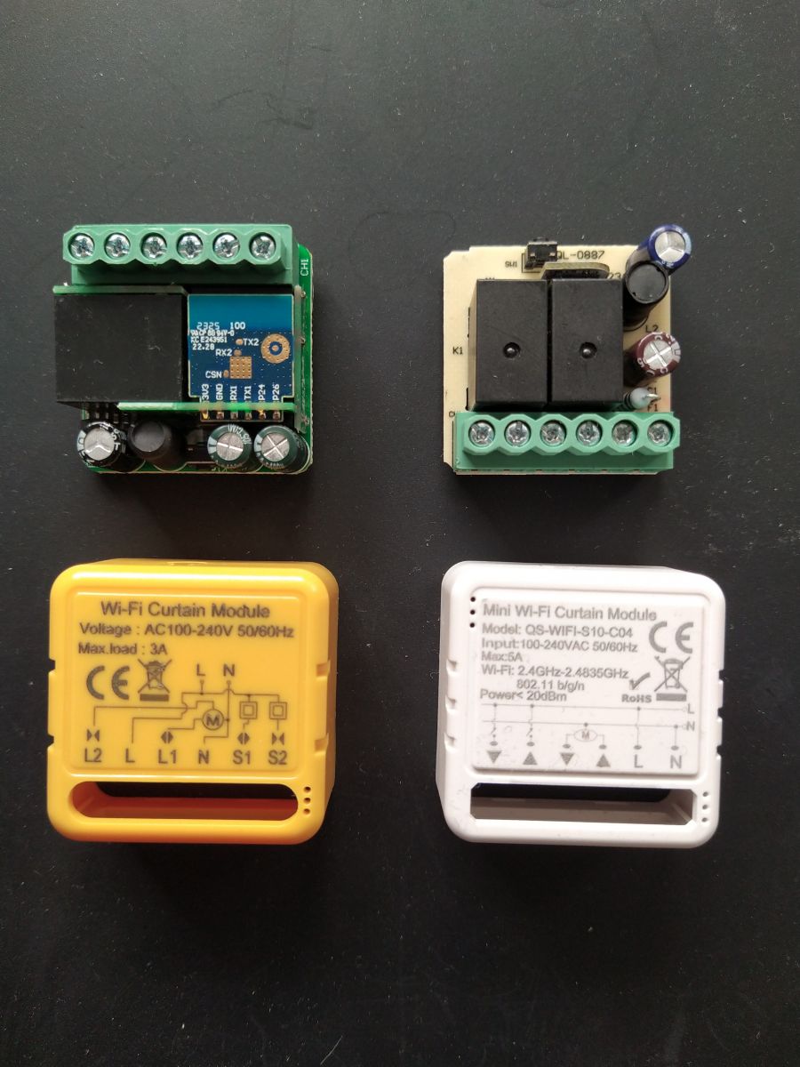

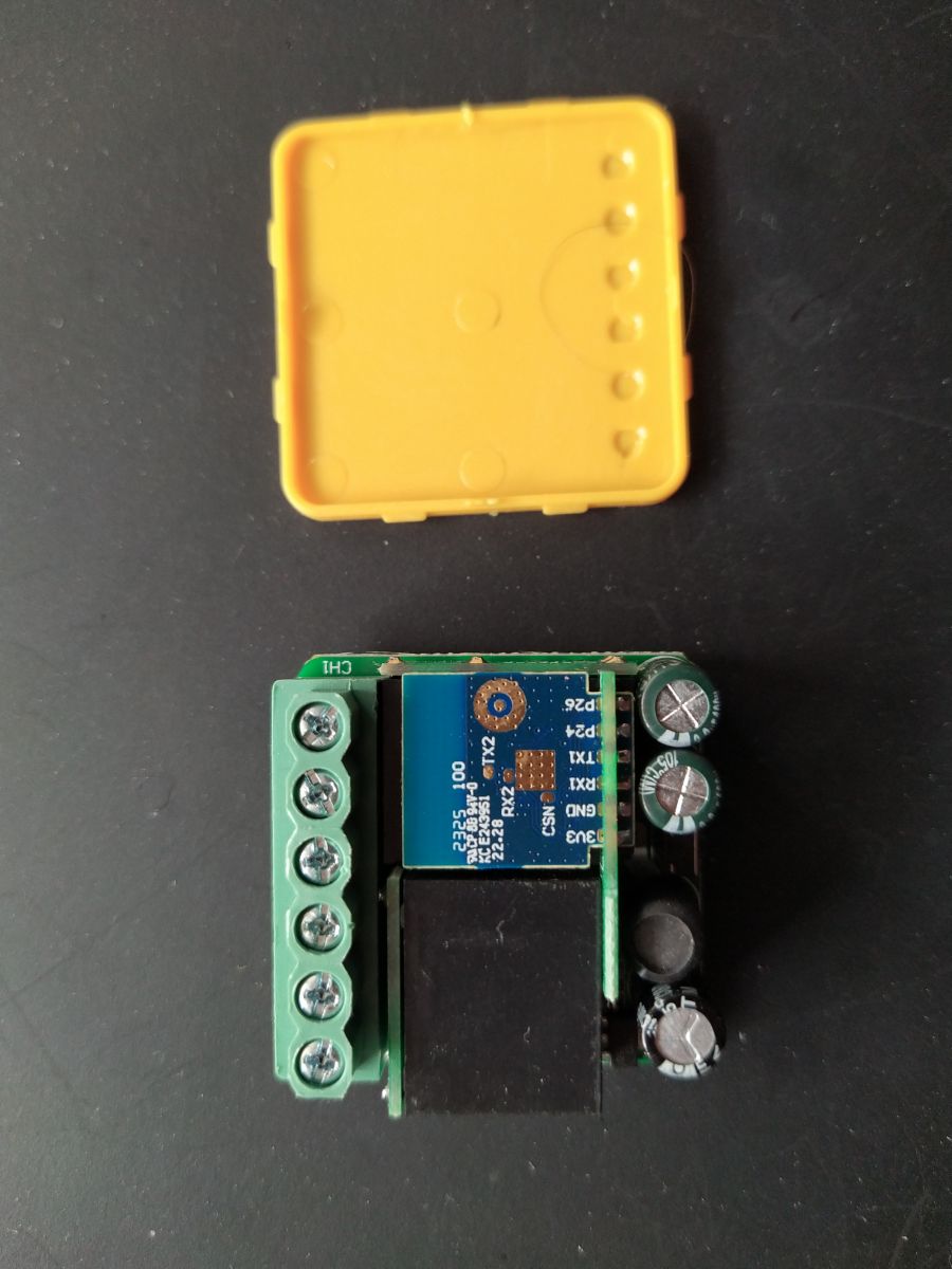

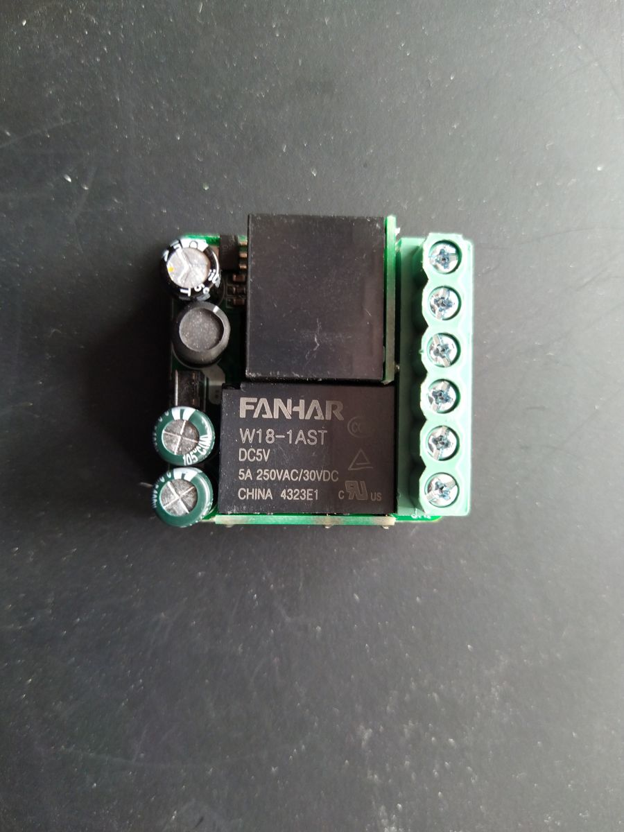

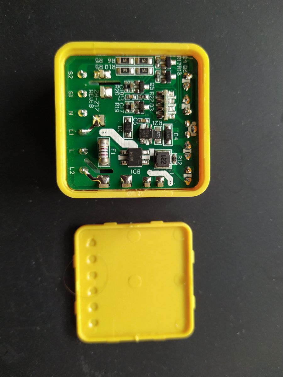

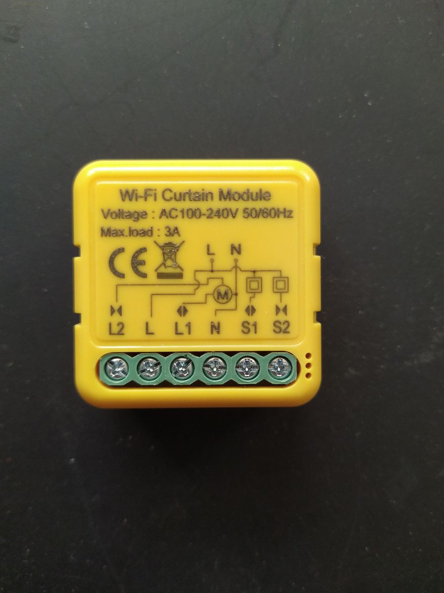

    Since there is absolutely no Model name: The board is marked ZH-Z17 Rev. B (on the bottom). On the side it's marked: ZH-Z17 Rev. A 🤷
    This Curtain Module is similar to 2CH WiFi Switch Module (clone) or QS-WIFI-S10-C04 which also uses the BK7231N

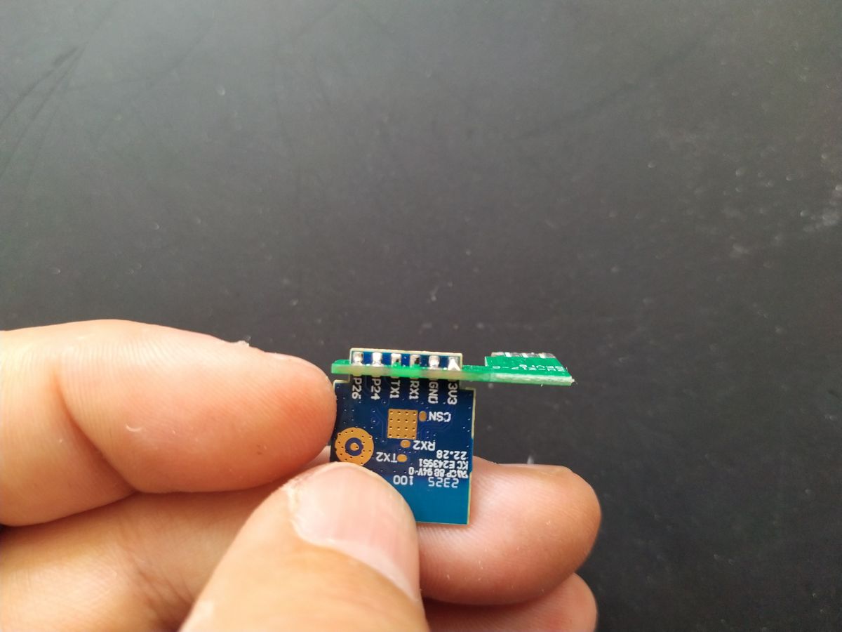

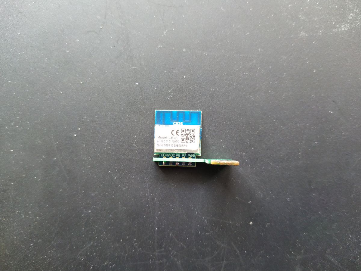

    PIN CB2S Board
    P6LED
    P7Relais L2
    P8internal switch button
    P23Relais L1
    P24Switch relais L1
    P26Switch relais L2
    GNDGND
    VCC3.3V
    TXnc
    RXnc
    I used the Itchiptool for communication, since its WAY better (than hiddownloader tool) when using Linux. The bus was not detected at 1st but as soon as I disconnected the board from 3.3V, put CEN to ground, started to flash and reconnected the board to 3.3V, the bus was detected and the flashing/backup started.

    Here in comparison the with the similar QS-WIFI-S10-C04
    Two Wi-Fi curtain modules and their enclosures on a black background.
    I find this modul better than the QS-WIFI-S10-C04 cause the Tuya modul can easily replaced by a ESP-02s which can run Tasmota alternativly (Which I find has better shutter support. This is important for not destroying your shutter motors. This i my top concern.).

    The whole modul will get quiet warm so i think it wont last for ever (e.g. the condensators/elkos are non ESR ones).
