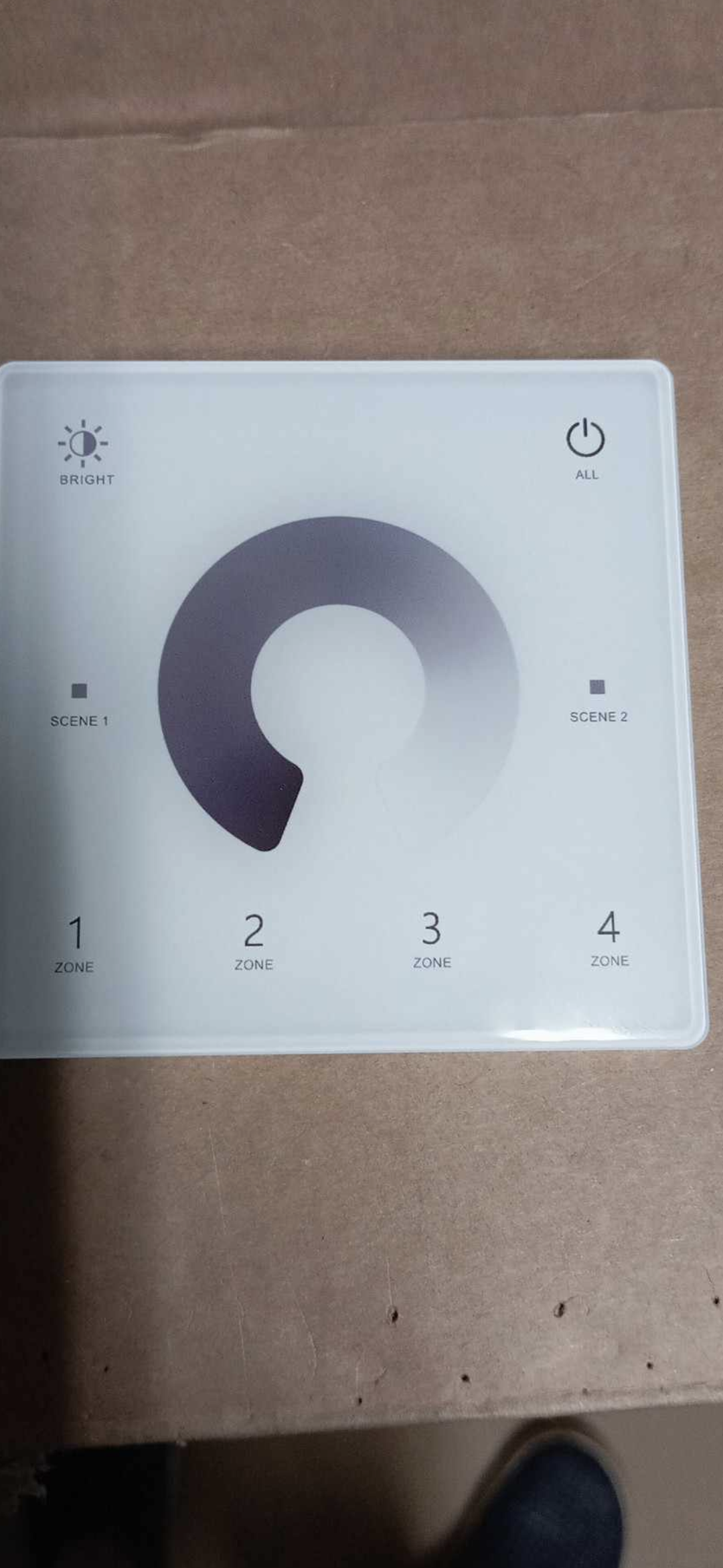

  • #5 21194192
    jahooo
    Level 19  
    Posts: 490
    Rate: 24
    Photo How to pair the SKYDANCE TW1-4 wireless panel for LED control? .
  • #6 21194209
    Posts: 14749
    Rate: 12856
    If it's a touch panel, what do you want to pair it with? With an LED controller? Then this LED controller must have this "match button". Earlier I wrote the other way around, but it looks like it is as I think now.

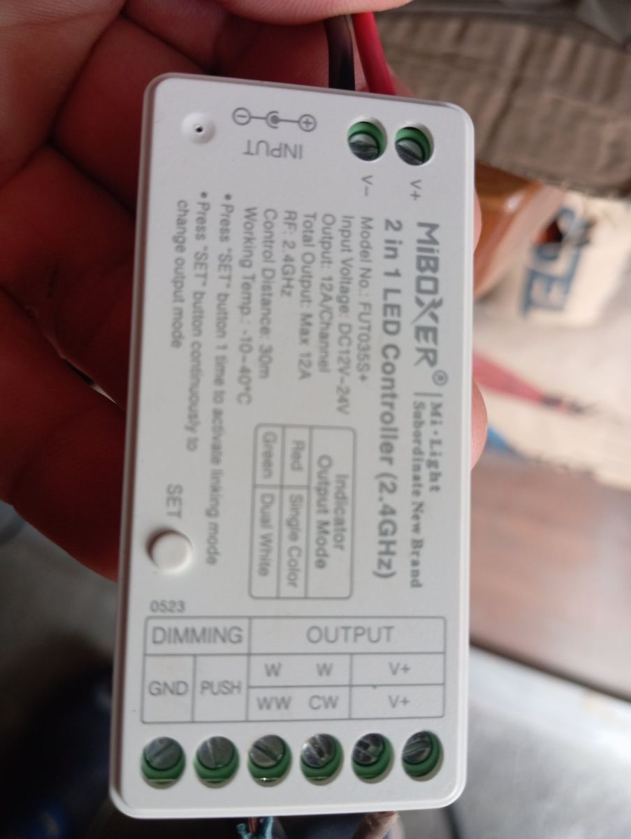

  • #7 21195065
    jahooo
    Level 19  
    Posts: 490
    Rate: 24
    My controller below. So could you write according to you what steps to follow to pair it
  • #8 21195072
    Posts: 14749
    Rate: 12856
    And this was bought as one set, as compatible with each other?
    If so, try as per the FUT035S+ LED controller ( 2.4g ) 2-in-1 instruction manual
    • miboxer_fut035s _instrukcja_pl.pdf (352.31 KB) You must be logged in to download this attachment.
