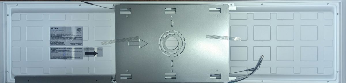

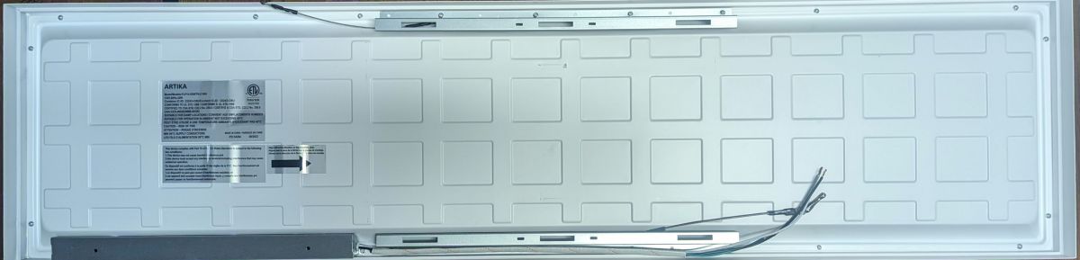

    First, the device will need to opened in order to access the chip.

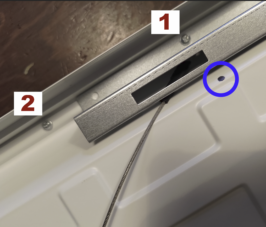

    Place the device face-down (light side down) so that the back screws and metal mounting plate are visible.
    Artika Skyshade LED panel with visible metal mounting.
    Slide off the mounting plate by pushing it against the direction of the arrow (leftward in the case of the above image)
    Next, remove all screws securing the housing, including those which hold the support-rails in place.
    Be careful not to strip anything.

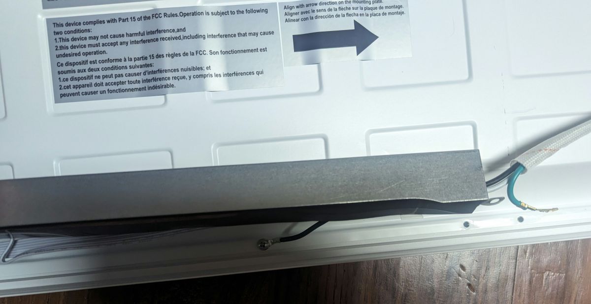

    Also be careful of the metal section in the lower-left to which the power cables connect. This contains various electronics components and has additional cables which feed into the inside of the unit
    Back side of the Artika Skyshade LED panel showing screws and a metal mounting plate.
    Once you have removed the screws on either side of the metal section, you will also need to lift it out a bit and then detach the grounding screw which is attached to the power cable
    Rear view of the Artika Skyshade LED panel with mounting instructions.
    With this done and all screws removed, you can place the support cables out of the way. Flip the inner housing of the unit around (being careful to support the metal section where the cables feed to the inside)

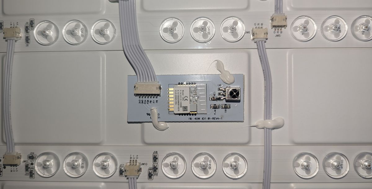

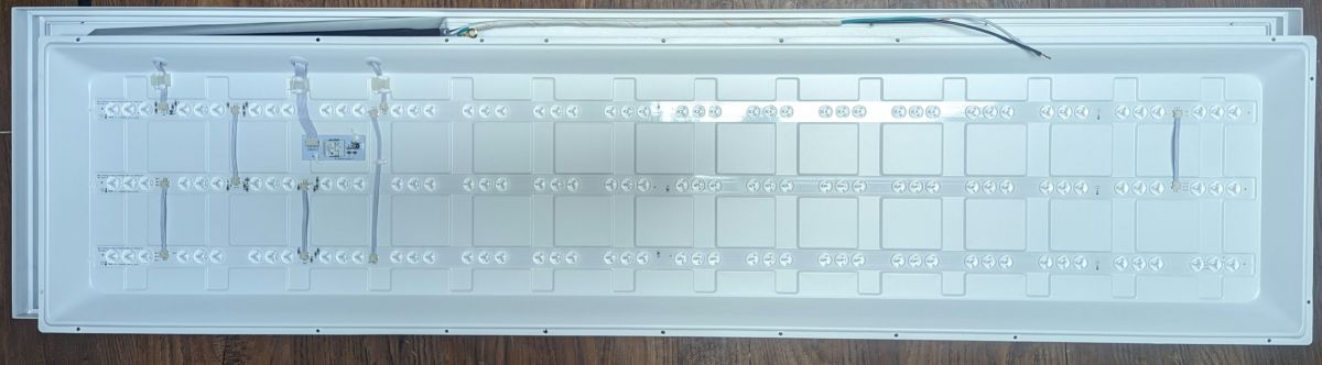

    On the inside, you should see the LED's with cables running into the various sections, as well as the main data+power cable running to the board containing the CBU chip
    Internal view of the Artika Skyshade LED panel showing LEDs and wiring.
    On the board, you will see:
    * a cable with connections laberlled 3v3,GND, P24, P26, P6, P7, P8
    * The CBU chip
    * An infrared sensor with some resistors
    Artika Skyshade LED panel with CBU chip and connections.

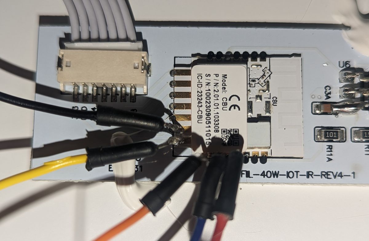

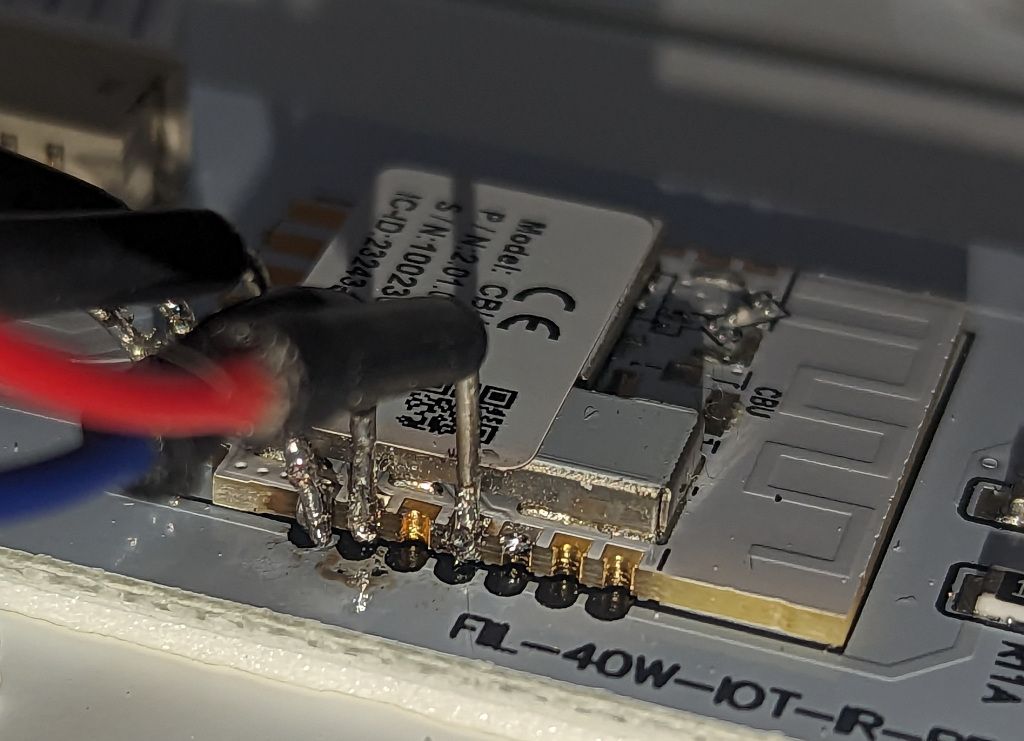

    In order to reprogram the chip, you will need to solder leads onto pins
    * 13 (PS-GRND)
    * 14 (PS-3v3)
    * 15 (TX1)
    * 16 (RX1)
    * 18 (CEN)
    Presumably you will be running these leads to a USB-TTL/UART adaptor. I have read of others having some issues with insufficient current on the 3.3v connector (and thus needing external power) but my own CP2102 adaptor seemed sufficient in this case.
    Attach leads to your chip as seen below
    PCB with soldered wires connected to the CBU chip.
    Close-up of a connected CBU chip in an LED panel.
    In my image
    * 13 (PS-GRND) = Black
    * 14 (PS-3v3) = Yellow
    * 15 (TX1) = Orange
    * 16 (RX1) = Blue
    * 18 (CEN) = RED (in the first picture, skip a pin from the RX connector to reach CEN)
    Also, please note that the "TX" connector would connect to the "RX" connection on your adaptor and vice-versa
    I also recommend using either a breadboard where you can easily short CEN to GRND or possible a button, as you will need to do this a few times during the flashing process
    With this in mind, connect the leads to your TTL/UART adaptor so that
    * GRND/Black = Ground
    * 3v3/Yellow = 3.3v
    * TX1/Orange = RX
    * RX1/Blue = TX
    * CEN = Initially unconnected, but easily able to short to ground

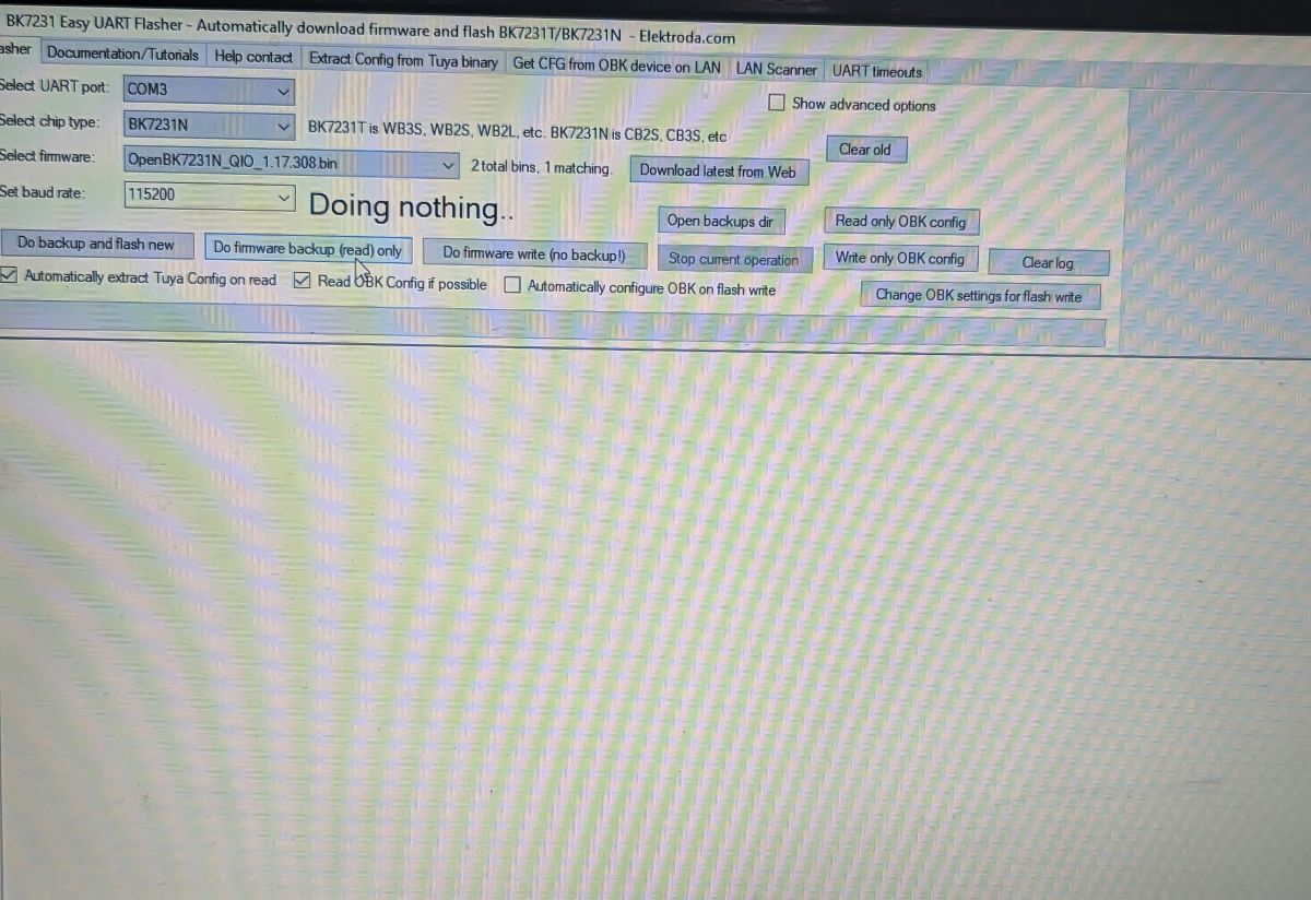

    Now fire up the "BK7231 Easy UART Flasher)
    Select the following:
    * UART port: [whatever COM your adaptor is connected to)
    * Chip Type: BK7231N
    * Firmware: Appropriate OpenBeken Firmware, I used OpenBK7231N_QIO_1.17.308 at the time
    * Baud rate: 115200 (you may go faster but I find this is a good medium for compatibility and less errors)
    BK7231 Easy UART Flasher screen with configuration options
    Now assuming everything is connected correctly try to "Do firmware backup (read) only". This will verify you've got a connection to the chip and dump the current firmware. Once you've hit the button in the software and entered a backup filename, briefly short the CEN pin on the chip to GRND in order to put reset the device into programming mode
    You should see progress details as the memory is read.
    Assuming that goes successfuly, next use "Do firmware write (no backup)" (this is assuming you already have a backup from the previous step and all went well). Short the CEN pin to GRND on the chip again
    The software should find the device, begin erasing sectors of the chip and then writing. When done, you should see a message
    "Writing file data to chip success"
    Your chip has now been reprogrammed. Short CEN to GRND one more time to reboot.

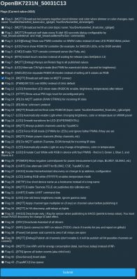

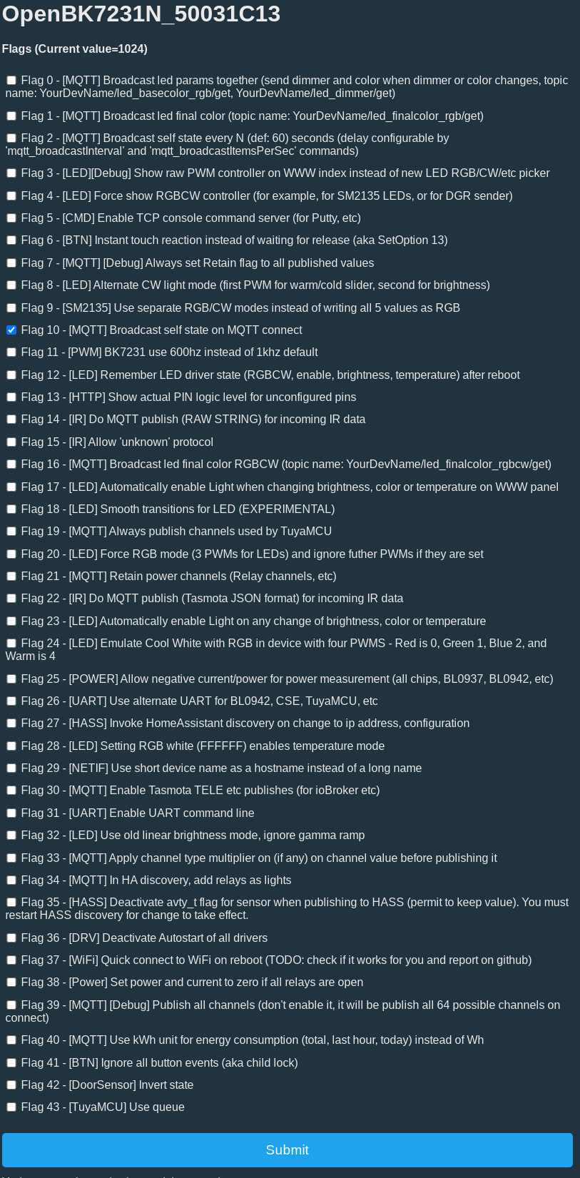

    Under Config->Configure General/Flags, set the following flags: 0, 1, 8, 10, 12, 16, 22, 28
    Artika Skyshade configuration screen with various flags and setting options.

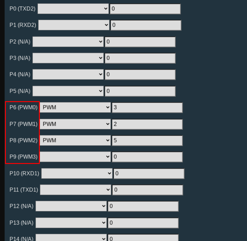

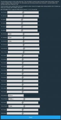

    Under Config->Configure Module
    * P6 (PWM0) = PWM 3
    * P7 (PWM1) = PWM 2
    * P8 (PWM2) = PWM 5
    * P23 (ADC3) = IRRecv
    * P24 (PWM4) = PWM_n 4
    * P26 (PWM5) = PWM 1
    Configuration interface for PWM settings on BK7231 chips.

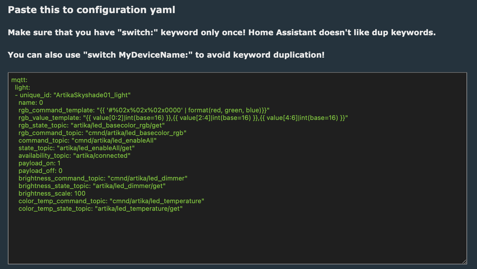

    If you are using HomeAssistant, then go to Config->Home Assistant Configuration: CLick "Start Home Assistant Discovery" and if your MQTT settings and networking etc are all correct the device should be found automatically

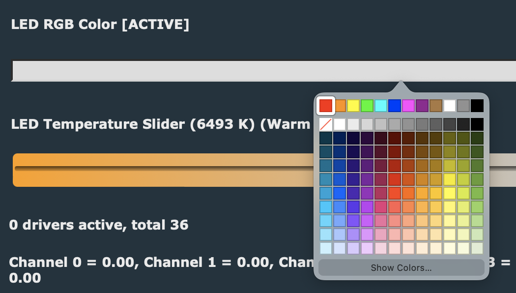

    I think you need to change some of the channels here:
    There is not much options because there is a limited number of PWMs on BK7231 chips, as you can see here:
    PWM channel configuration table for BK7231 chips.

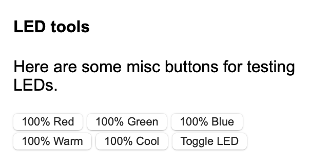

    So, you need to methodically experiment and check which color is missing or swapped.
    Alternatively, you can try use this method to extract PWM config. It works in most cases:
    This may be faster than guessing pins.

    Ok, but which channel is missing for you? Red? Green? Blue? Warm? Cool?
    Maybe temporarily enable this flag:
    3	[LED][Debug] Show raw PWM controller on WWW index instead of new LED RGB/CW/etc picker
    and check each of the channels?
  • #11 21017768
    VanMak
    Level 4  
    Posts: 6
    >>21017738
    I think I figured out the problem, and it wasn't with pin assignment. I was using this tool for testing colours:
    Color LED temperature slider and active RGB settings.
    And it produced yellow instead of red. When I used this tool however:
    Screenshot of an LED testing tool with a set of buttons for color adjustment.
    It works fine.
    EDIT: IR Receive does not work at this time however.
    Edit 2: RTFM - add autoexec.bat
    Added after 3 [hours] 8 [minutes]:
    Why, on the homeassistant configuration page, does it say to paste some text into configuration.yaml?
    Fragment of a YAML configuration file for Home Assistant with RGB LED settings.
    Does this add additional features I haven't realized I'm missing out on yet?
  • #12 21018053
    Posts: 14580
    Help: 654
    Rate: 12604
    I am glad to hear that the color issue is resolved! You can calibrate colors later if you think they do not match well.
    Regarding HA, this copy-paste method is obsolete. You can use automatic discovery now:

    I have now opened, reprogrammed, and reassembled three of these panels without any issues. A note about the reset pin - you can get away without soldering it, it works fairly well to just touch a ground to that pin during the process. You only need to do it once (during the test read) so it's not too onerous and saves one solder action.
    A couple assembly tips:
    1. There are two different sizes of screws holding the panel together, though they look very similar. Every screw that goes through a metal part (support bars or wire housing) or attaches a ground cable is a fatter screw (type 1 in photo). Every screw that passes only through the white reflector into the bezel is a smaller diameter (type 2 in photo). If you use the smaller screws in the larger holes, they won't grip (not a huge deal but I guess you could end up with a bad ground if you aren't careful). I disassembled all of the large screws first and separated them, then the small ones. Reassembly was in reverse order.
    2. It's easy to forget which screws the "safety cables" are attached to. I marked the screw location on each side with a small dot as a reminder (see circle in photo) and upon reassembly, it's easiest to install those safety cables screws before all the rest.
    (For reference, if you are looking at the back of the panel with the power on the lower left, the safety cable closest to you attaches on the third-from-right hole on the support bar. The safety cable on the far side connects on the second-from-left hole on the support bar.)
    Close-up of a panel with markings for different types of screws and a location for the safety cable.
