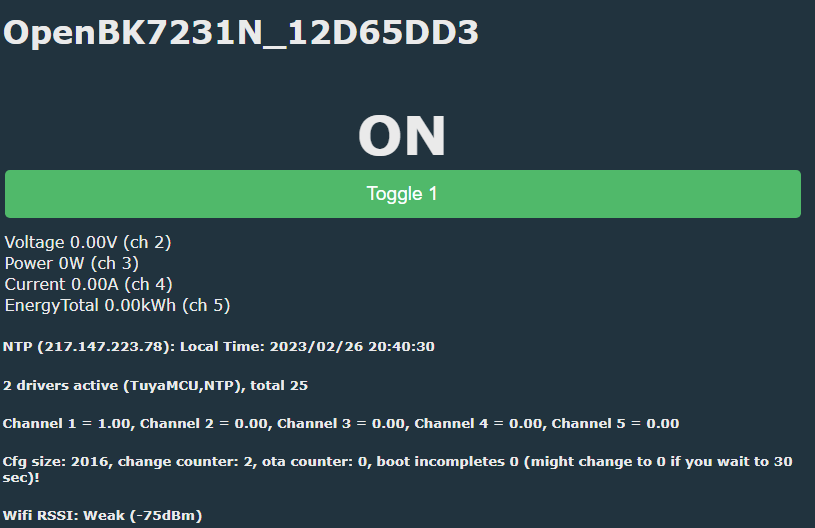

    Example of running autoexec.bat:
    xury wrote:
    I'll add some more logs:
    And my autoexec.bat:
    There's more.
    startDriver TuyaMCU
    startDriver NTP
    setChannelType 1 toggle
    setChannelLabel 1 "Relay"
    setChannelType 2 Voltage_div10
    setChannelType 3 Power
    setChannelType 4 Current_div1000
    setChannelType 5 EnergyTotal_kWh_div100
    setChannelType 6 toggle
    setChannelLabel 6 "Clear energy"
    setChannelType 7 toggle
    setChannelLabel 7 "Prepayment"
    setChannelType 8 toggle
    setChannelLabel 8 "Mute"
    setChannelType 9 toggle
    setChannelLabel 9 "Trip"
    setChannelType 10 TextField
    setChannelLabel 10 "Set OverVoltage"
    setChannelType 11 TextField
    setChannelLabel 11 "Set UnderVoltage"
    setChannelType 12 TextField
    setChannelLabel 12 "Set Current"
    setChannelType 13 TextField
    setChannelLabel 13 "Set Leakage"
    setChannelType 14 ReadOnly
    setChannelLabel 14 "ID "
    // link id 16 to channel 1
    linkTuyaMCUOutputToChannel 16 bool 1
    // link id 1 to channel 5
    linkTuyaMCUOutputToChannel 1 val 5
    // TAC2121C VoltageCurrentPower Packet
    // This will automatically set voltage, power and current
    linkTuyaMCUOutputToChannel 6 RAW_TAC2121C_VCP
    linkTuyaMCUOutputToChannel 12 bool 6
    linkTuyaMCUOutputToChannel 11 bool 7
    linkTuyaMCUOutputToChannel 105 bool 8
    linkTuyaMCUOutputToChannel 106 bool 9
    linkTuyaMCUOutputToChannel 101 2 10
    linkTuyaMCUOutputToChannel 102 2 11
    linkTuyaMCUOutputToChannel 103 2 12
    linkTuyaMCUOutputToChannel 104 2 13
    linkTuyaMCUOutputToChannel 19 3 14

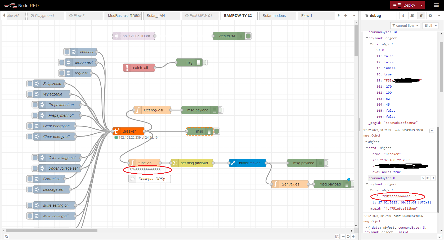

    In truth, I was able to read data locally from this device a long time ago using Node-red, but I would still prefer it to have nothing to do with TUYA - i.e. having to pull out ID and Key etc.
    After I worked out how to read the data locally myself, it turned out that someone had done a modification involving replacing the CB3S with an ESP32:
    https://community.home-assistant.io/t/eampdw-ty-63-wifi-chip-replacement/455667
    I'll admit that I haven't worked anything with this kind of CB3S chip yet and am green on the subject. I know that colleague kaczmarek has created an OpenBeken environment.
    Now the question: will there be access to the measurement data after changing FW to OpenBeken? That is voltage, current etc.

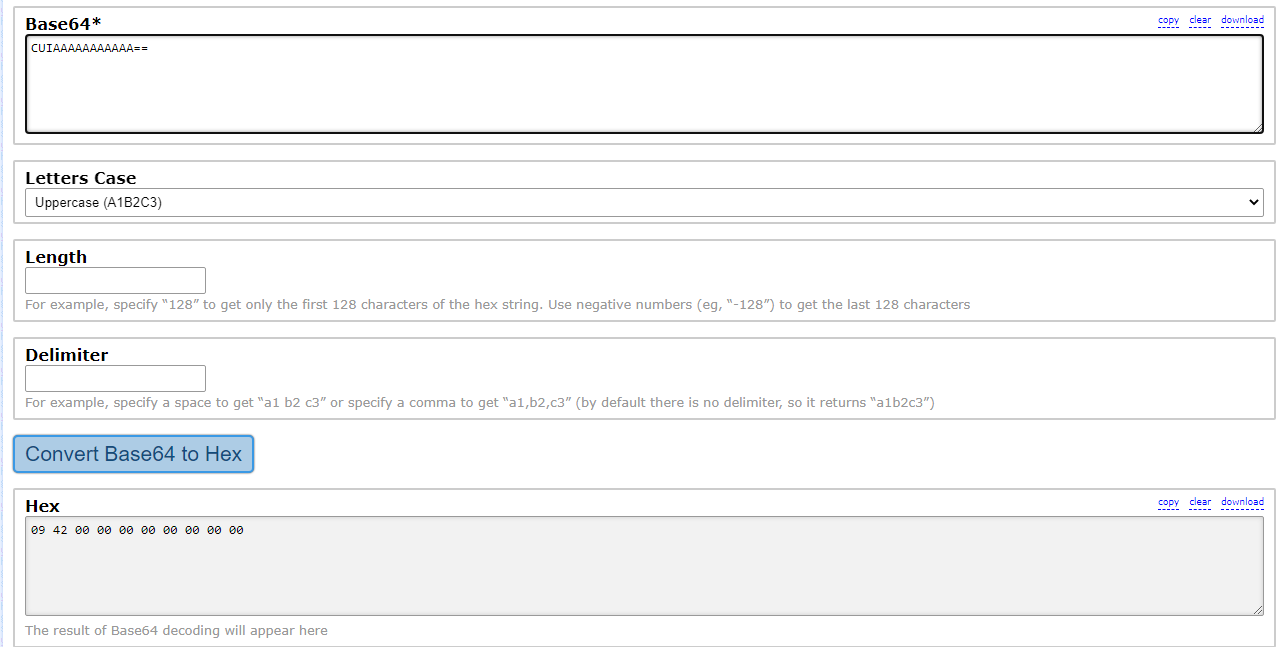

    Here are the DPSs that I was able to decipher:
    dps:
    1 - 10 = 0.1 kWh
    9
    11 prepayment tf
    12 clear energy t f
    13 balance energy integer
    14 charge records
    16 - on/off
    19 - ID
    101 - set OV
    102 - set UV
    103 - set current
    104 - set leakage
    105 - mute setting
    106 - trip setting

    Thanks for the information. I just managed to upload OpenBeken for the first time. I saved wifi data and autoexec.bat to start with. I'll put the device back together tonight and let you know what happens next. I had to desolder the CB3S chip for flashing.
    This is a job for about 30 minutes, maybe up to 60. The next pieces go faster, because not only do we have the configuration, but also the 2MB batch allows you to program the next pieces via WiFi (without soldering).
    How can you upload Openbeken without soldering? If you have dump flash from one, can you use it for others? I'm asking because in the case of, for example, Sonoff, you need to have the original backup.
    And one more question: In addition to reading the data of current, voltage, energy, power, etc., the device also offers settings for leakage current, overcurrent, overvoltage, etc. Does the autoexec.bat handle all this? Do you have to set it somewhere else? With a cursory check, OpenBeken has a "billion" of options :)

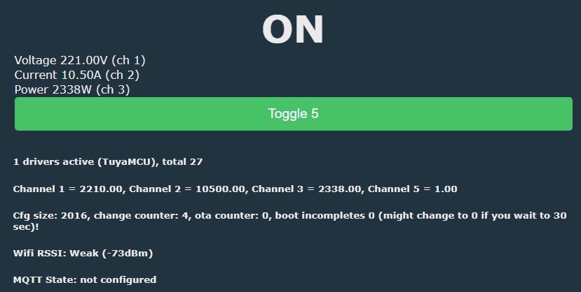

    OpenBeken is universally written, i.e. does not know what is in the variable. The autoexec.bat quoted earlier maps only dpID 6 to the special packet type (unfortunately) Voltage/Current/Power RAW_TAC2121C_VCP, it does nothing else.
    To get something more out of TuyaMCU, for example:
    104 - set leakage
    You need to map dpID 104 (knowing its Tuya type, from value - val rules) to a channel and then receive this channel in MQTT.
    startDriver TuyaMCU
    setChannelType 1 Voltage_div10
    setChannelType 2 Current_div1000
    setChannelType 4 TextField
    linkTuyaMCUOutputToChannel 104 val 4

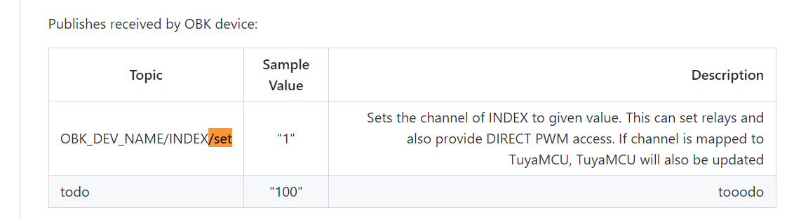

    TextField will also allow you to enter this value in the GUI. Then doing channel 4 set will also set dpID 104.
    In general, when you map something to a channel it all works for it, i.e.:
    - from MQTT set publish works (setting values from HA)
    - from the MQTT level get publish works (receiving changes from the device)
    - scripts work including setChannel 5 123 (channel setting)
    - change handlers work, e.g. addChangeHandler Channel5 > 40 echo Channel five has a high value!

    They're just not correct: They're always null:
    EAMPDW-TY63 Alternative Firmware: Access Measurement Data with OpenBeken via TuyaMCU
    My flow in Nodered was doing $base64decode(payload)
    and then:
    Code: Javascript
    Unfortunately, I can't translate it to OpenBeken
    in the log i have:

    This is my flow with nodered which reads values from dp id 6 and sets all other values:

    Yes relay works. Does it matter which channel I assign to?
    Current setup:
    startDriver TuyaMCU
    startDriver NTP
    // linkTuyaMCUOutputToChannel dpId varType channelID
    // map dpid16 to channel6, var type 1 (boolean)
    linkTuyaMCUOutputToChannel 16 1 6
    log level 6

    I do not know if it matters, because perhaps base64 decoding is already implemented in the Tuya standard, but for me on NR it looks like this:
    And e.g. decoding base64 I get:
    09 42 means voltage, i.e. 237.0V - there are still zeros, because the current did not flow or there was no leakage current.
    As I wrote, I don't know if it matters, but that's exactly what dpid 6 returns to me

    Very good job finding out that this system needs "encouragement" though, I'll have to analyze why this is happening. Anyway, you can always send any data to the UART from the script level, so there is no problem either.
    I don't know anything about base64, I haven't done projects on LocalTuya, and TuyaMCU doesn't have it - the data is normally given as integers. As I wrote, I would leave NodeRed alone for now.
    This is what you are looking for:
    nfo:TuyaMCU:TUYAMCU received: 55 AA 03 07 00 0E 06 00 00 0A 09 4C 00 00 00 00 00 00 00 00 7C
    Info:TuyaMCU:TuyaMCU_ProcessIncoming[ver=3]: processing command 7 (State) with 21 bytes
    Info:TuyaMCU:TuyaMCU_ParseStateMessage: processing dpId 6, dataType 0-DP_TYPE_RAW and 10 data bytes
    I also analyzed this packet and saw that it has an extra two bytes on the back (its length is "10 data bytes") and I'm not talking about a checksum here.
    I added including this, only now you need to update Obk to the latest version from now, that is to at least 1.15.510.

    Yes, I even noticed on Nodered that TuyaMCU does not send anything via dpId 6 when the relay is not turned on.
    In addition, the command uartSendHex 55AA000300010407 must also be sent - this probably tells the MCU that CB3S is connected to the network.
    So to sum up, for the voltage, current, power and leakage data to be sent, the relay (dpId 16) and (probably, because I haven't figured out the frame yet) dpId 3 must be turned on.
    There are 10 bytes, because probably similar to what I read from NR, we have 2 bytes - voltage value / 10, 3 bytes - current value / 1000, 3 bytes - power value and 2 bytes - leakage current value, so-called. leakage current
    This device works as protection against too high and too low voltage, as an overcurrent fuse and as a kind of RCD with adjustable leakage current in mA, and also with a controlled relay.
    Even through dpId 1 there is a kWh reading and through the other listed viewing / setting values
    dpId 19 is some ID number, probably for the cloud
    dpId 9 - I didn't figure it out, when it reads it has a value of 0
    there is still a bool prepayment unless you can set how much energy you can use. I have to check it on the Tuya application, because it was about a year ago when I played with it and left it due to the inconvenience of removing the keys. OpenBeken saves the day - I avoid all kinds of clouds as much as possible.

    I don't know if I'm doing it right:
    info:TuyaMCU:TUYAMCU received: 55 AA 03 07 00 0E 06 00 00 0A 09 4C 00 00 00 00 00 00 00 00 7C
    Where the read data begins 09 4C - voltage
    the next 00 00 00 is the current value
    next 00 00 00 power value
    and the last 00 00 - the value of the leakage current
    7C - checksum
    55AA - header
    03 - protocol version
    07 - command
    00 0E data length
    06 -dpId
    00 00 0A - I don't know??
    then data and CRC at the end
    Added after 5 [hours] 45 [minutes]:
    Almost a success. :)

    Gdzie odczytane dane zaczynają się 09 4C - napięcie
    kolejne 00 00 00 to wartość prądu
    kolejne 00 00 00 wartość mocy
    i ostatnie 00 00 - wartość prądu upływu
    7C - suma kontrolna
    At the moment the configuration we have does not read the current leakage value, do you need to add it?

    I will check this wifistate 4 feature and let you know. At the moment I added three uartSendHex, which I looked at in the Tasmota template somewhere and it works. I send via addRepeatingEvent every 10 seconds. I'm satisfied already, but I'll check if it doesn't get better.
    The only thing I don't quite understand is how to send a value via MQTT to change value to the mapped channel
    For example, I want to change the value in dpId 101 assigned, for example, to channel 4 via MQTT and I can't read from the documentation what the topic should be.
    And to receive the changes listen:
    OBK_DEV_NAME/CHANNEL_INDEX/get
    Replace only CHANNEL_INDEX with a number.
    To request an update send an empty payload to:
    You can also use MQTT commands to control:
    cmnd/OBK_DEV_NAME/
    o payload command arguments. So, for example:
    cmnd/OBK_DEV_NAME/setChannel
    about payload
    will set channel 1 to 25.
    Not all channels are automatically published by the device, you may need to enable publishing all in flags.
