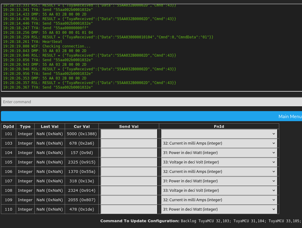

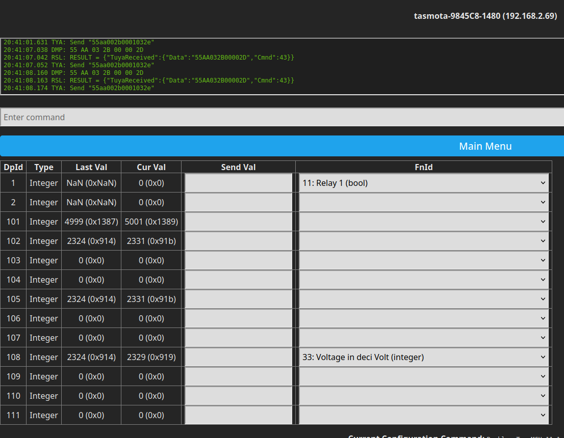

    this is the tasmota tuya dpld
    Tasmota user interface with DP data and configuration.
    102, 105, 108 seems clearly to be voltage with /10 divider. 101 is frequency with /100 divider. 1 is not a relay cause there is no relay onboard.
    for current and thus power i have to create a special wiring.....maybe tomorrow.
    my tasmota discussion is here and a related discussion here
  • Suggests multiple Voltage_div10 channels in OpenBeken

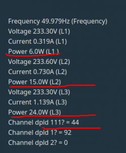

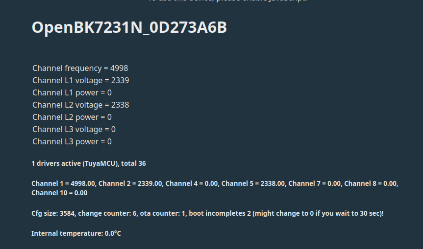

    1st i checked the correct dplds
    Interface showing measurement data and logs in text format.
    i had only 1 phase for testing.

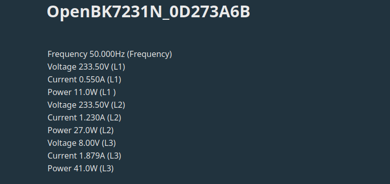

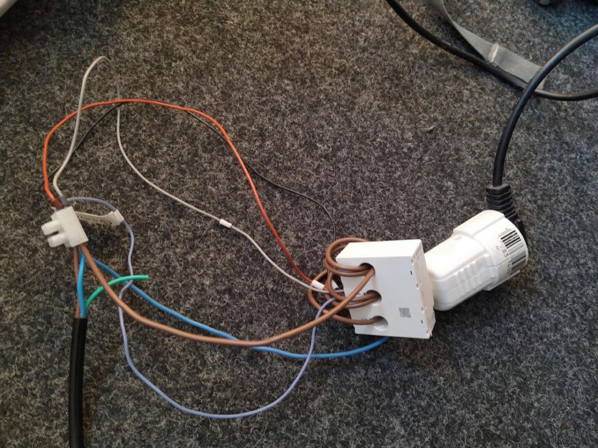

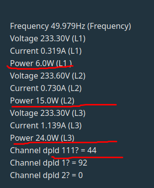

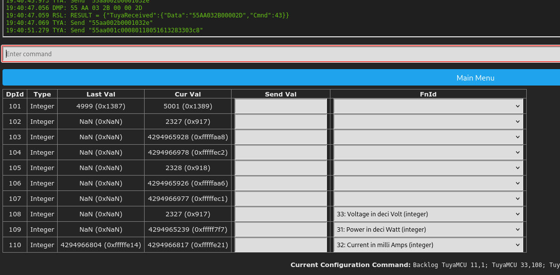

    so i did the wiring so that the current doubles while passing L1(x), L2(y), L3(z). and thus also power does. now identification was easy and is like shown on the picture. lowest value is x, highest is z
    Close-up of an electrical wiring setup with wires connected to an adapter.
    it's also able to do negative flow:
    Program interface with a table of values and commands for device configuration.

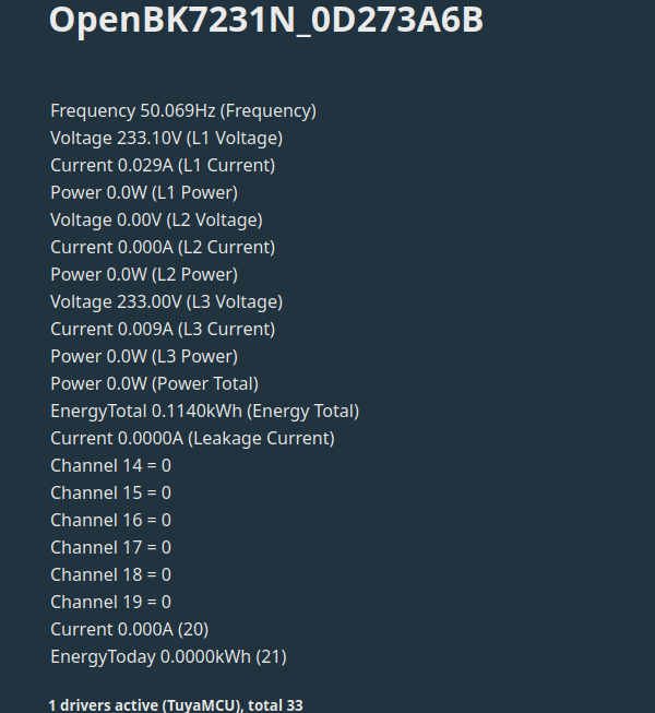

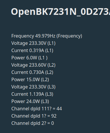

    here we are
    len 15
    Info:TuyaMCU:ParseState: id 105 type 2-val len 4
    Info:TuyaMCU:ParseState: int32 2342
    Info:GEN:CHANNEL_Set channel 2 has changed to 2342 (flags 0)
    Info:MQTT:Channel has changed! Publishing 2342 to channel 2
    Info:TuyaMCU:Received: 55 AA 03 07 00 08 6A 02 00 04 00 00 05 62 E8

  • #14 21094828
    Posts: 14770
    Rate: 12913
    There are hardcoded channel types for that, but we could just script them manually as well to just forward data to Home Assistant.
    Are the values themselves shown correctly?

    Screenshot showing diagnostic data of the device OpenBK7231N_0D273A6B, indicating no voltage on channel L3.
    L3 voltage is missing...but gut be a faulty cable connection. no current cause there is nothing attached right now.

    very cool! that's easy!
    Screenshot displaying measurement data from the OpenBK7231N_0D273A6B module, showing frequency, voltages, currents, and power for different power lines.
    voltage L3 has a bug though. But current/power L3 are correct! Got it.....dpld typo.
    what's left : dpld 1, 2, 111. any idea what they are used to?
  • #18 21095134
    Posts: 14770
    Rate: 12913
    Do we know what are the meaning of dpID 1, 2 and 111? Didn't you map 111 as voltage?
    // L3 voltage
    setChannelLabel 8 "L3 voltage"
    setChannelType 8 ReadOnly
    linkTuyaMCUOutputToChannel 111 val 8
    Or are you referring to the fact that it is showing 8V?

    111 was wrong. voltage is 108.
    moved the current autoexec.bat config to the 1st post.
    Screenshot with data on voltage, current, and power from various channels.
    maybe energy total, energy today? would make sense

    Posts: 14770
    Rate: 12913

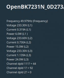

    So 111 is just a sum of those powers:
    Screenshot of electrical parameters readings with highlighted power values.
    6+15+24 seems to be 45 and not 44 but maybe it's due to the rounding...

  • L2 voltage datapoint appears in logs but not UI
    #28 21102601
    vincenzoernst1
    Posts: 100
    Rate: 7
    i see a problem with displaying all 3 voltages correctly. currently L2 voltage doest show.
    Screenshot of OpenBK7231N interface showing electrical measurements, including voltage readings for phases L1, L2 (0V), and L3.
    but dpld 108 (voltage L2) shows correlty up in the logs:
    Info:TuyaMCU:ProcessIncoming: (test for S09 calendar/IR device) received TUYA_CMD_NETWORK_STATUS 0x2B
    Info:TuyaMCU:Received: 55 AA 03 00 00 01 01 04
    Info:TuyaMCU:ProcessIncoming[v=3]: cmd 0 (Hearbeat) len 8
    Info:TuyaMCU:Received: 55 AA 03 07 00 08 6F 02 00 04 00 00 00 00 86
    Info:TuyaMCU:ProcessIncoming[v=3]: cmd 7 (State) len 15
    Info:TuyaMCU:ParseState: id 111 type 2-val len 4
    Info:TuyaMCU:ParseState: int32 0
    Info:TuyaMCU:Received: 55 AA 03 07 00 08 66 02 00 04 00 00 09 1C A2
    Info:TuyaMCU:ParseState: id 102 type 2-val len 4
    Info:TuyaMCU:ParseState: int32 2332
    Info:TuyaMCU:Received: 55 AA 03 07 00 08 67 02 00 04 00 00 00 00 7E
    Info:TuyaMCU:ParseState: id 103 type 2-val len 4
    Info:TuyaMCU:Received: 55 AA 03 07 00 08 68 02 00 04 00 00 00 00 7F
    Info:TuyaMCU:ParseState: id 104 type 2-val len 4
    Info:TuyaMCU:Received: 55 AA 03 07 00 08 69 02 00 04 00 00 09 1C A5
    Info:TuyaMCU:Received: 55 AA 03 07 00 08 6A 02 00 04 00 00 00 01 82
    Info:TuyaMCU:ParseState: id 106 type 2-val len 4
    Info:TuyaMCU:ParseState: int32 1
    Info:TuyaMCU:Received: 55 AA 03 07 00 08 6B 02 00 04 00 00 00 00 82
    Info:TuyaMCU:ParseState: id 107 type 2-val len 4
    Info:TuyaMCU:Received: 55 AA 03 07 00 08 6C 02 00 04 00 00 09 1C A8
    [b]Info:TuyaMCU:ParseState: id 108 type 2-val len 4
    Info:TuyaMCU:ParseState: int32 2332[/b]
    Info:TuyaMCU:Received: 55 AA 03 07 00 08 6D 02 00 04 00 00 00 03 87
    Info:TuyaMCU:ParseState: id 109 type 2-val len 4
    Info:TuyaMCU:ParseState: int32 3
    Info:TuyaMCU:Received: 55 AA 03 07 00 08 6E 02 00 04 00 00 00 00 85
    Info:TuyaMCU:ParseState: id 110 type 2-val len 4
    Info:TuyaMCU:Received: 55 AA 03 07 00 08 65 02 00 04 00 00 13 8E 1D
    Info:TuyaMCU:ParseState: id 101 type 2-val len 4
    Info:TuyaMCU:ParseState: int32 5006
    Info:TuyaMCU:Received: 55 AA 03 07 00 08 6C 02 00 04 00 00 09 1D A9
    Info:TuyaMCU:ParseState: int32 2333[/b]
    Info:TuyaMCU:Received: 55 AA 03 07 00 08 01 02 00 04 00 00 00 72 8A
    Info:TuyaMCU:ParseState: id 1 type 2-val len 4
    Info:TuyaMCU:ParseState: int32 114
    Info:TuyaMCU:Received: 55 AA 03 07 00 08 02 02 00 04 00 00 00 00 19
    Info:TuyaMCU:ParseState: id 2 type 2-val len 4
    Info:TuyaMCU:Received: 55 AA 03 07 00 0C 06 00 00 08 09 1D 00 00 00 00 00 00 49
    Info:TuyaMCU:ProcessIncoming[v=3]: cmd 7 (State) len 19
    Info:TuyaMCU:ParseState: id 6 type 0-raw len 8
    Info:TuyaMCU:Received: 55 AA 03 07 00 0C 07 00 00 08 09 1C 00 00 00 00 00 00 49
    Info:TuyaMCU:ParseState: id 7 type 0-raw len 8
    Info:TuyaMCU:Received: 55 AA 03 07 00 0C 08 00 00 08 09 1C 00 00 00 00 00 00 4A
    Info:TuyaMCU:ParseState: id 8 type 0-raw len 8
    Info:TuyaMCU:Received: 55 AA 03 07 00 08 0F 02 00 04 00 00 00 00 26
    Info:TuyaMCU:ParseState: id 15 type 2-val len 4
    autoexec is set to:
    // L2 voltage
    setChannelLabel 5 "L2 Voltage"
    setChannelType 5 Voltage_div10
    linkTuyaMCUOutputToChannel 108 val 5
    doublechecked autoexec for wrong config. i also saw L1 voltage missing while L2 votage was ok. dont know whats going on....?
  • #29 21102669
    Posts: 14770
    Rate: 12913
    maybe you've mapped something else to channel 5 as well, save config and reboot whole device
  • No change after saving TuyaMCU channel mapping
    #30 21102679
    vincenzoernst1
    Posts: 100
    Rate: 7
    nope. double checked that. was also my 1st thought.
    see:
    startDriver TuyaMCU
    // Frequency
    setChannelLabel 1 "Frequency"
    setChannelType 1 Frequency_div100
    linkTuyaMCUOutputToChannel 101 val 1
    // L1 voltage
    setChannelLabel 2 "L1 Voltage"
    setChannelType 2 Voltage_div10
    linkTuyaMCUOutputToChannel 105 val 2
    // L1 Current
    setChannelLabel 3 "L1 Current"
    setChannelType 3 Current_div100
    linkTuyaMCUOutputToChannel 103 val 3
    // L1 Power
    setChannelLabel 4 "L1 Power"
    setChannelType 4 Power
    linkTuyaMCUOutputToChannel 104 val 4
    // L2 voltage
    // L2 Current
    setChannelLabel 6 "L2 Current"
    setChannelType 6 Current_div100
    linkTuyaMCUOutputToChannel 106 val 6
    // L2 power
    setChannelLabel 7 "L2 Power"
    setChannelType 7 Power
    linkTuyaMCUOutputToChannel 107 val 7
    // L3 Voltage
    setChannelLabel 8 "L3 Voltage"
    setChannelType 8 Voltage_div10
    linkTuyaMCUOutputToChannel 108 val 8
    // L3 Current
    setChannelLabel 9 "L3 Current"
    setChannelType 9 Current_div100
    linkTuyaMCUOutputToChannel 109 val 9
    // L3 Power
    setChannelLabel 10 "L3 Power"
    setChannelType 10 Power
    linkTuyaMCUOutputToChannel 110 val 10
    // Power Total
    setChannelLabel 11 "Power Total"
    setChannelType 11 Power
    linkTuyaMCUOutputToChannel 111 val 11
    // Energy Total
    setChannelLabel 12 "Energy Total"
    setChannelType 12 EnergyTotal_kWh_div1000
    linkTuyaMCUOutputToChannel 1 val 12
    // Leakage Current
    setChannelLabel 13 "Leakage Current"
    setChannelType 13 Current_div1000
    linkTuyaMCUOutputToChannel 15 val 13
    did save config and rebooted...no change
