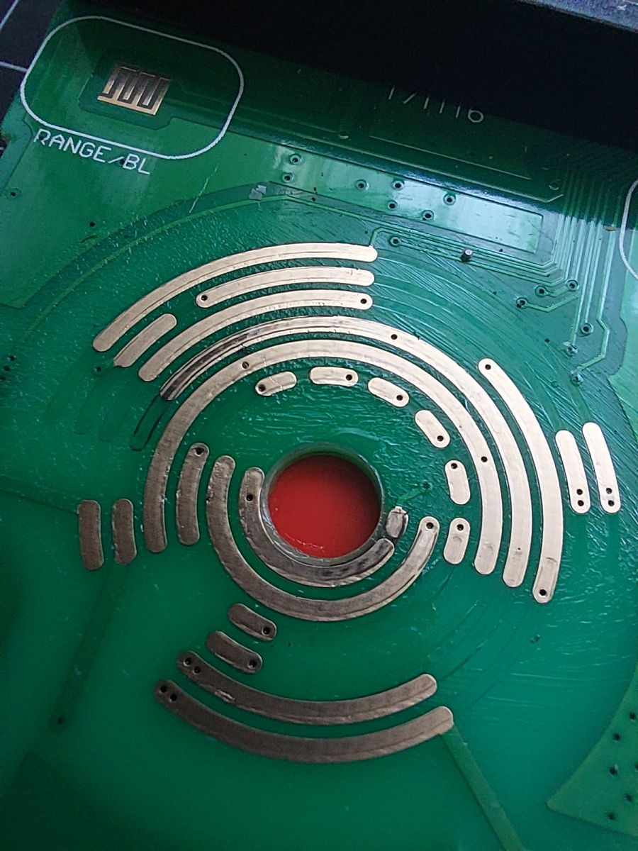

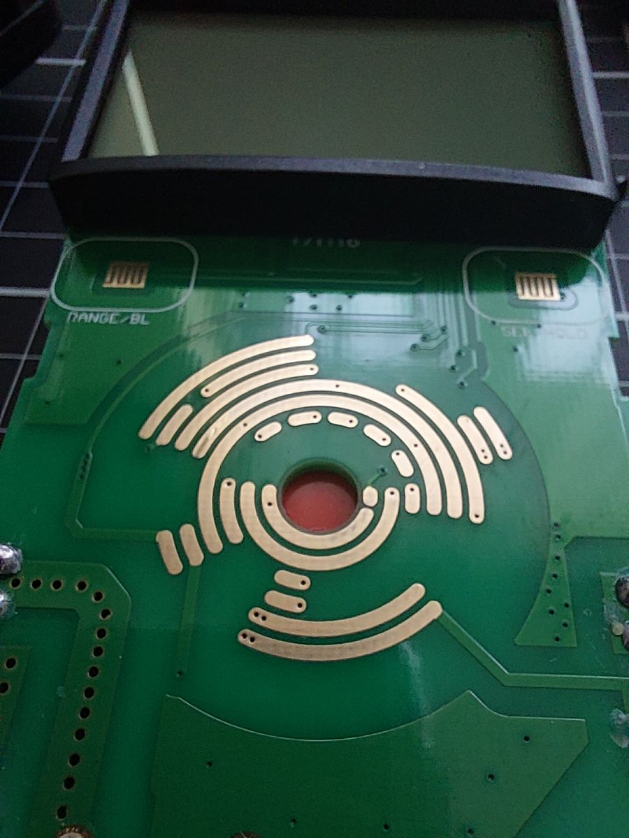

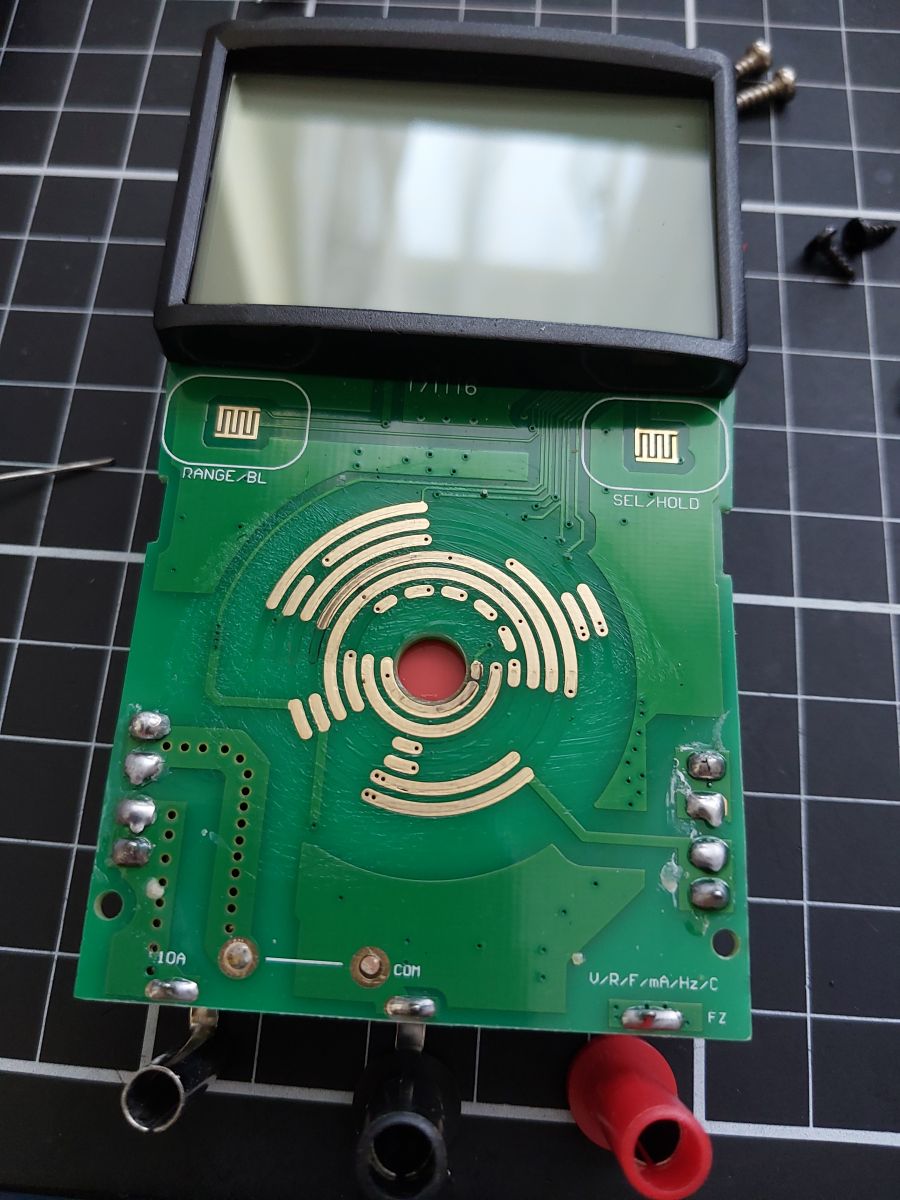

    Today I will give a description of a simple repair of this multimeter. The equipment is popular enough that maybe someone less familiar with the subject will find this description useful and save his instrument ;)
    The meter on the ohmmeter range indicated all sorts of silly things, e.g. a 100 ohm resistor was identified as being up to several tens of kiloohms. Without the probes plugged in, it was also able to display some nonsense, and when the probes were short-circuited, instead of zero the display could show several hundred ohms or even more.
    The first suspects were the batteries. I bought the meter in the first half of 2021 and it has been running on the same set of batteries ever since, and I use it the most out of all the meters I own. However, the cells turned out to be in pretty good shape, I even swapped them for new ones just to be sure, but it didn't do anything.
    What I observed later, normal readings could be restored (but not always) by switching between ranges a few times. So the main suspect became the switch. To get to it the meter has to be disassembled, after dismantling the casing and removing the board we have this view:
    Inside view of a disassembled multimeter showing PCB and switch tracks. .
    You can see the switch tracks, they appear to be gold plated.
    If you look closely you can see the oily ooze on the board:
    Close-up of a multimeter circuit board showing switch traces. Image of gold-plated tracks in a multimeter switch after cleaning. .
    This is probably grease that leaked from the switch and got on the PCB.

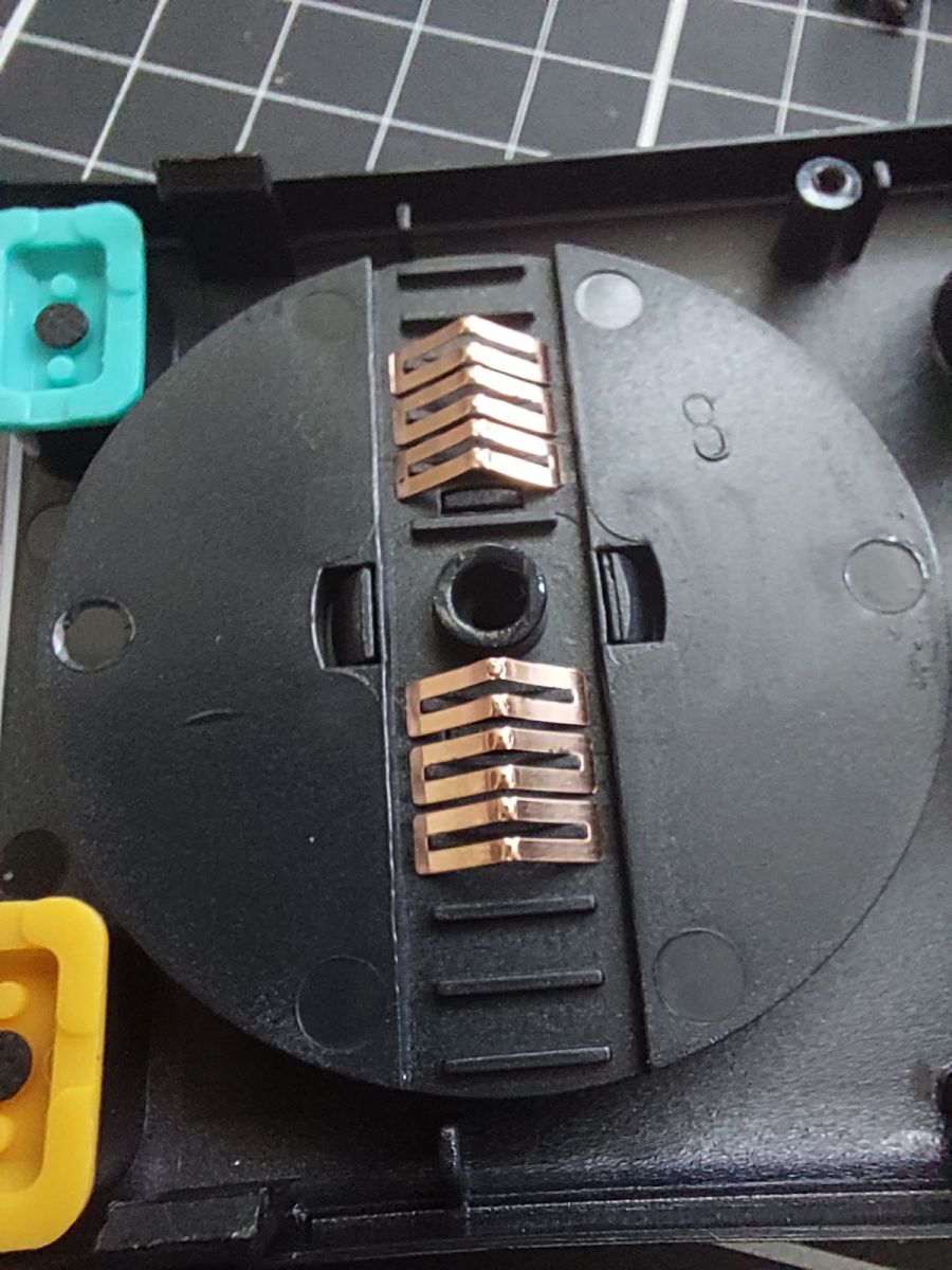

    The part with the knob on the underside:
    Close-up of the multimeter switch interior after cleaning. .
    Here the contacts look OK, however I also washed them just in case.

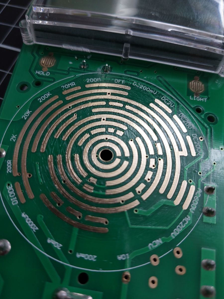

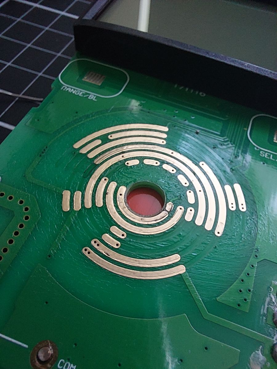

    The switch tracks after cleaning:
    Close-up of a PCB with visible gold-plated traces. .

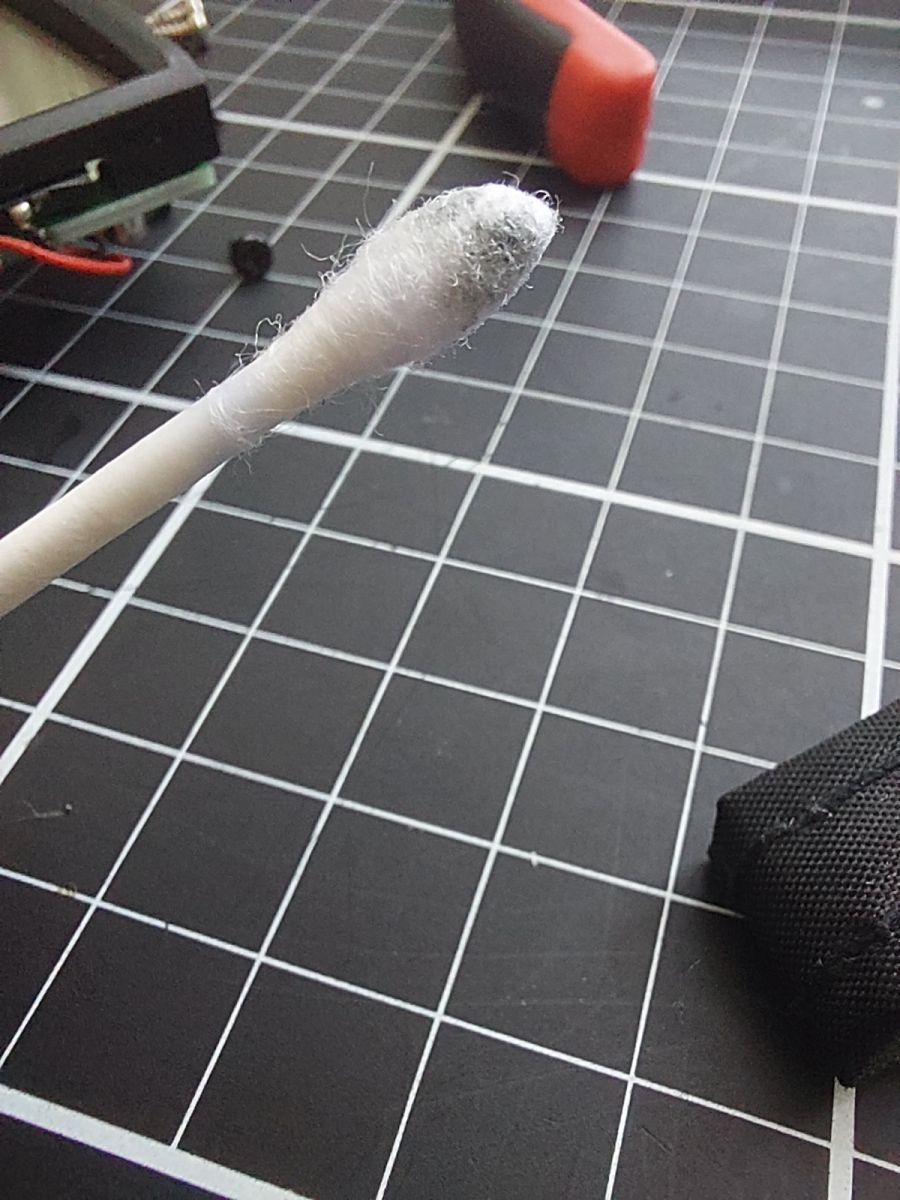

    You can see a huge difference, clean was not there:
    A cotton swab with dirt on the tip against a workbench background. .

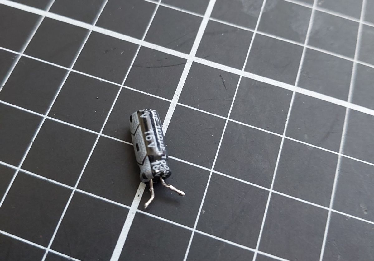

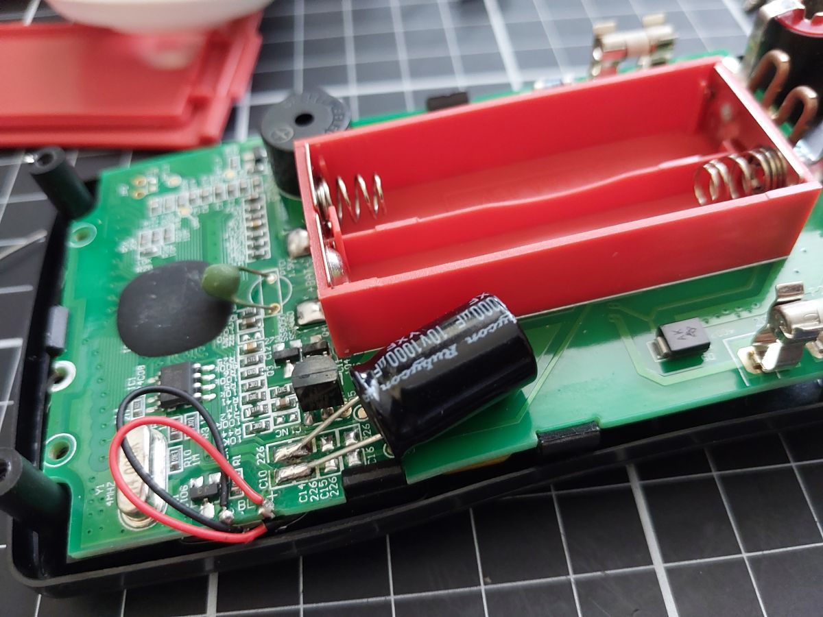

    Taking advantage of the fact that I had the meter open I also replaced the original 100uF electrolyte on the meter supply with a 1000uF:
    Electrolytic capacitor 10V 100μF lying on a grid mat. View of an open multimeter showing the interior with PCB and replaced capacitor. .
    This is one of the recommended modifications for this meter, you can read more here: https://www.elektroda.pl/rtvforum/topic3713925.html#18825243

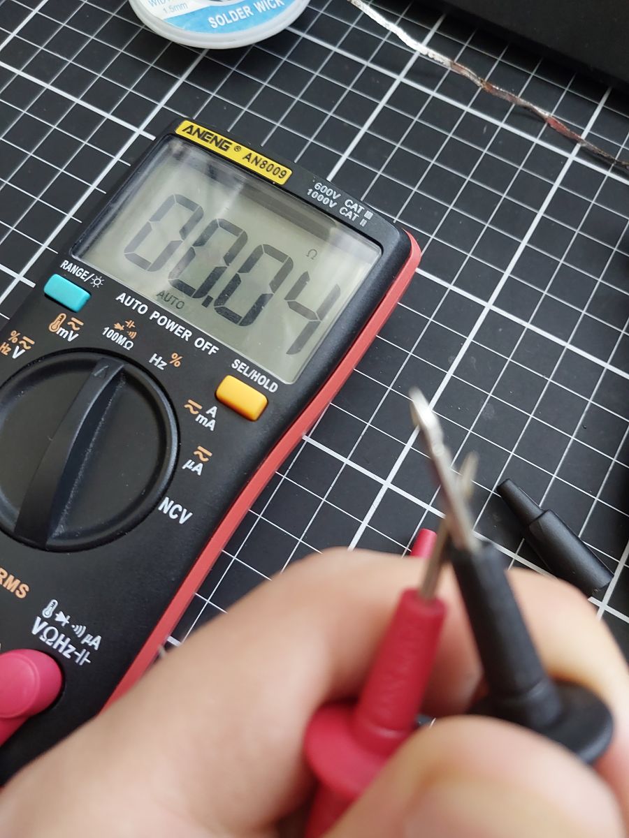

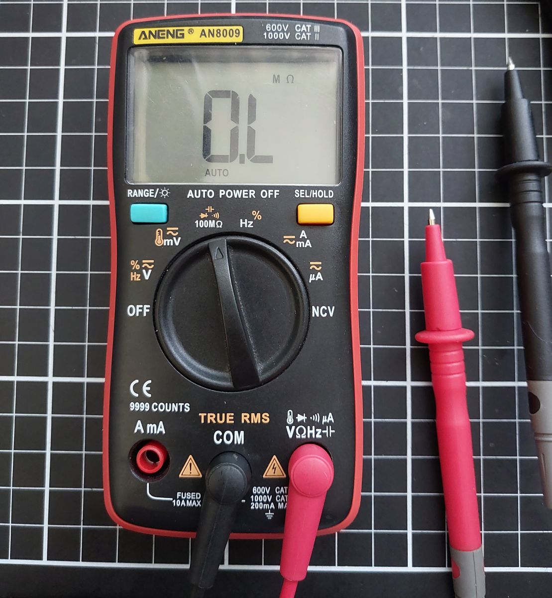

    Well, and now the most important thing: Was the repair successful, does the meter indicate as it should? Time to check!
    ANENG AN8009 multimeter with display showing 0.004 ohms, with probes in hand. .
    It worked and the readings returned to correct :D .
    The whole repair took me ~ half an hour, cost 0zł ;) .

  • Silicone grease on switch contacts suggested as cause
    #2 21210553
    NegativeFeedback
    Posts: 322
    Rate: 109
    Olkus wrote:
    [url=https://
    A.
    This grease is probably silicone grease, which is used to lubricate the contact area so that the contacts do not degrade quickly, due to the poor quality of the pcb and copper plating, so I would suggest disassembling again and lubricating there.
    The grease does not degrade the contact, I sometimes grease old instruments that have deteriorated after many years of use, I have been using these for many years, I have never had a problem with the contacts because of this.
  • Grease was worsening the ohmmeter contact issue
    #3 21210559
    Olkus
    Level 32  
    Posts: 3922
    Help: 132
    Rate: 918
    NegativeFeedback wrote:
    Grease does not deteriorate the contact, I sometimes grease old instruments in this way that have deteriorated after many years of use, I have been using these for many years, I have never had a problem with the contacts because of this.
    Well in this case it was making it worse. The ohmmeter was going crazy before and now it works normally, so I guess there was something not quite right with the grease?
    Greetings,
    A.
  • Dirty grease may be causing contact leakage
    #4 21210879
    waldi_8601
    Posts: 132
    Rate: 29
    I don't think the grease itself is the problem, I've usually seen clear grease used for such purposes, its purpose is rather to reduce friction, mechanical wear of the contacts/PCB.
    Here on the PCB you can clearly see the grease is dirty, maybe some micro filings, corrosion, so it could start to conduct current to some extent, spread it connects the contact fields and the meter in such a situation could start to malfunction.
  • Dirty insulating grease likely caused switch leakage
    #5 21210963
    Olkus
    Level 32  
    Posts: 3922
    Help: 132
    Rate: 918
    Here on the PCB you can clearly see the grease is dirty, maybe some micro filings, corrosion, so it could start to conduct current to some extent, smeared connects the contact fields and the meter in such a situation could start to malfunction.
    Basically such a grease, in this case probably silicone, is an insulator. If it gets between the contacts of the switch and the copper fields on the PCB then things like this can happen.
    Well, and the aforementioned dirt certainly made things worse too.
    Regards,
    A.

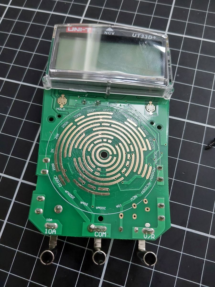

    To dispel doubts I looked at another meter - UNI-T UT33D+, the grease is:
    Disassembled UNI-T UT33D+ multimeter showing the circuit board. Image of a multimeter interior showing a dusty printed circuit board. .
    So it looks like dirt was the culprit, or this grease was somehow left and started to conduct after some time.
    I'll have to buy silicone grease in that case, as I don't currently have any and give it a bit to this Anenga.
    Switch tracks after cleaning:
    And brag about what you cleaned so beautifully with?
    Chemistry or just a decent stick?

    sq3evp wrote:
    Are you bragging about what you cleaned so beautifully with?
    IPA :) .

    Often a sore point is mangy wires. I generally make my own,try to give good, expensive banks, the wire I used to give in insulation, 1.5mm sq or 1mm, secured with Distal and hot glue or butaprene. Meter wires are the last fall they add, miracle not headphone wires. But still I often get strange measurements. Gold plated contacts don't get protected, the grease is actually supposed to improve the feed rate because the fields are rubbing out, I have some older bullseye meters.
  • Grease on gold-plated contacts questioned
    #28 21222170
    Olkus
    Level 32  
    Posts: 3922
    Help: 132
    Rate: 918
    keseszel wrote:
    Frequently the problem is scabby wires. I generally make my own,try to give good, expensive banks, wire I used to give in insulation, 1.5mm sq or 1mm, secured with Distal and hot glue or butaprene. Meter wires are the last fall they add, miracle not headphone wires. But still, I often get strange measurements.
    In this case it wasn't the wires that were the problem, I checked that at the outset.
    keseszel wrote:
    Golden contacts don't get protected, the grease is actually supposed to improve the feed rate, because the fields are rubbing out, I have some older bull gauges.
    So if the contacts are gold plated we don't give grease as some have written before?
    Greetings,
    A.
  • #29 21222339
    keseszel
    Level 26  
    Posts: 4104
    Help: 54
    Rate: 558
    Olkus wrote:
    So if the contacts are gold plated we don't give grease, as some have written before?
    That's how I remembered it from the old days. But I remember the Isostats strewn about. I would give but would get an idea of what lubricants would be advisable these days. No matter what you do it will still be fine. You don't buy a meter for life ;-) .
  • Silicone grease suggested for switch lubrication
    #30 21222483
    Olkus
    Level 32  
    Posts: 3922
    Help: 132
    Rate: 918
    keseszel wrote:
    This is how I remembered from the old days. But I do remember the Isostats strewn about. I would give but would get an idea of what lubricants would be advisable these days. No matter what you do it will still be fine. You don't buy a meter for life .
    Now it's probably silicone grease that would be most advisable. I leave it without for now, you are right , that you do not buy a meter for life :) Especially since the one from the topic is not very expensive, and in case of emergency I have other ;) .
    Regards,
    A.
