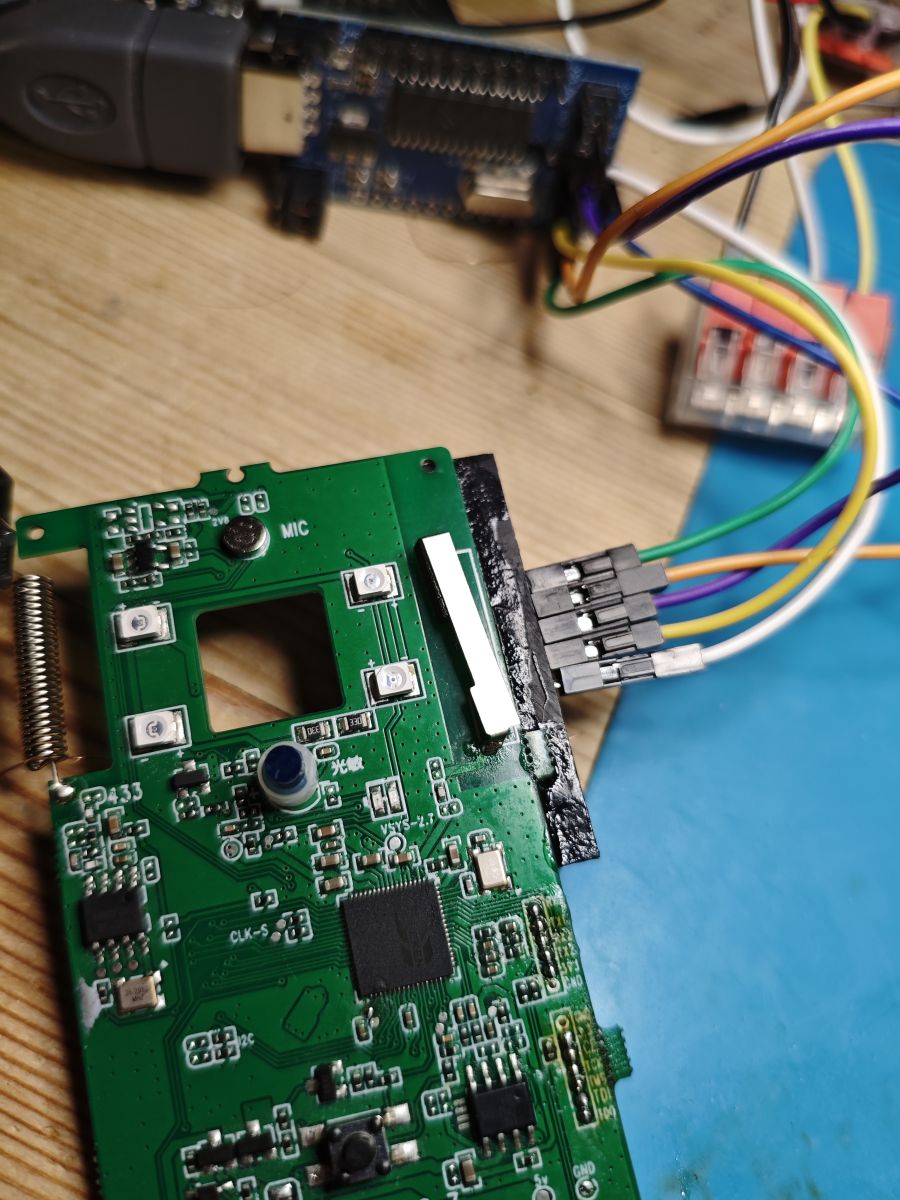

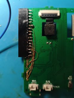

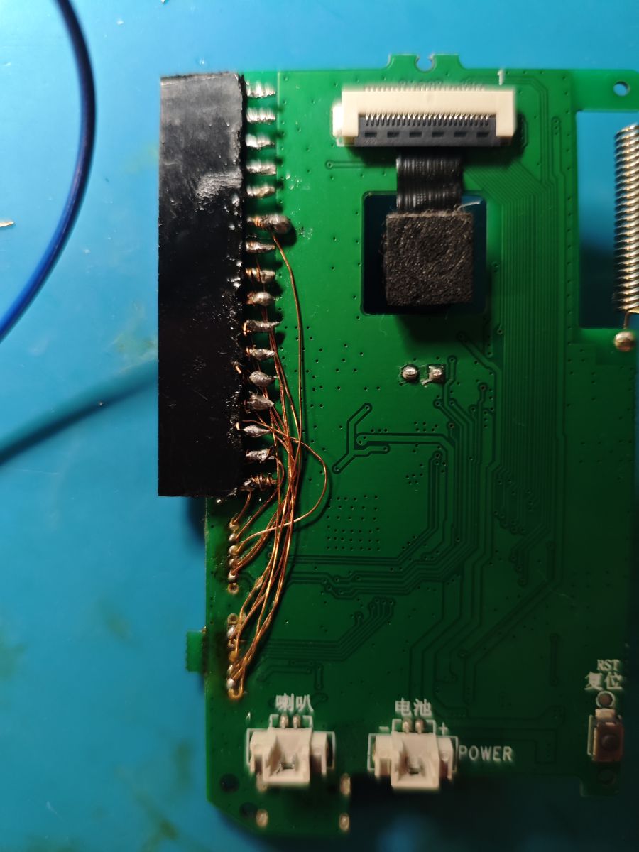

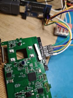

    yes. more GPIOs could be done probably but it's OK for now. it looks a bit messy inside. Hoping the enamel holds on these wires. there are no shorts (at the moment)

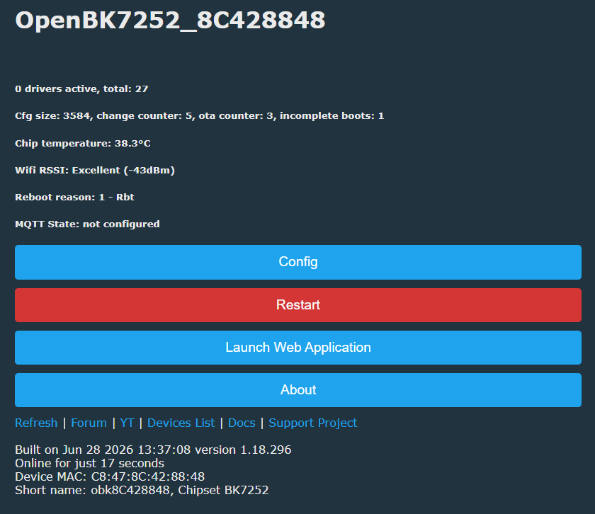

    I seem to have a working OTA Tuya BK7252U variant using a tweaked RT-Thread
    BK7251_1.0.15
    bootloader - the one used in unencrypted OpenBK7252.
    The SDK RT-Thread BK7252 bootloader can validate and copy a normal BK7252 .rbl from the download slot into the app slot, but on Tuya-encrypted BK7252U it was writing that app payload as-is, which would fail expected crc after writing, then it would go into an OTA boot loop. The app slot must be written using the Tuya coeff-key transform. Stock RT-Thread bl doesn't have that ability.
    to achieve:
    Found the OTA copy helper in the v1.0.15 bootloader.
    Redirected two calls that wrote decoded firmware to fal_partition_write.
    Added a tiny wrapper, 180 bytes of Thumb code.
    The wrapper pads the final chunk to 32 bytes with 0xff, applies the Tuya coeff encryption per 32-bit word using the real encrypt_n algorithm, then calls the original fal_partition_write in Thumb state.
    Repacked the patched bootloader into the QIO using the Beken 32+2 CRC layout.
    https://github.com/openshwprojects/OpenBK7231...divadiow:OpenBK7231T_App:tuyabk7252u?expand=1
    The Tuya A9 is single-slot and the Tuya coeff
    510fb093 a3cbeadc 5993a17e c7adeb03
    is present but the non-Tuya OpenBK7252 works on it, so I guess it would need a hacky approach too.
    The bootloaders in the Tuya SDKs all seem to be for the ping-pong A/B style OTA.
    OpenBK7252_Tuya_QIO_tuyabk7252u_49d58b7bd019.bin -> OTA OpenBK7252_1.18.296.rbl -> OTA OpenBK7252_tuyabk7252u_8cf566e7382b.rbl -> OTA OpenBK7252_1.18.296.rbl
