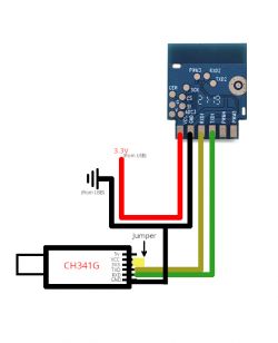

    All right, so I've tried to get my CH341B to work in my Linux machine and to output things on /dev/ttyUSBx, I didn't succeed.
    Thankfully I bought some CH340G USB to TTL which just arrived today, but I might do something wrong, I don't get any serial output.
    So, I read that BK7231T module was outputting things at 115200 baud, as for the rest I don't know if I select the right parameters.
    I tried it again in minicom 115200 8N1, but I have nothing. Maybe my wiring is still incorrect?
    Connection diagram between BK7231T module and CH341G USB to TTL converter.
  • #12 21230748
    Posts: 5214
    Help: 448
    Rate: 917
    your CH341A needs to share a ground with the external power source.
    Connection diagram for CH341A with an external power source.
  • #13 21231028
    Ienien77
    Posts: 6
    >>21230748 and sadly it doesn't work either, though maybe now my wiring is at least correct...
  • #14 21231139
    Posts: 14760
    Rate: 12887
    I have never managed to flash with 3.3V from USB to UART converter. I often flash like:
    https://www.youtube.com/playlist?list=PLzbXEc2ebpH0CZDbczAXT94BuSGrd_GoM
    Connection diagram of a USB to UART converter with a 3.3V and 5V power module.
