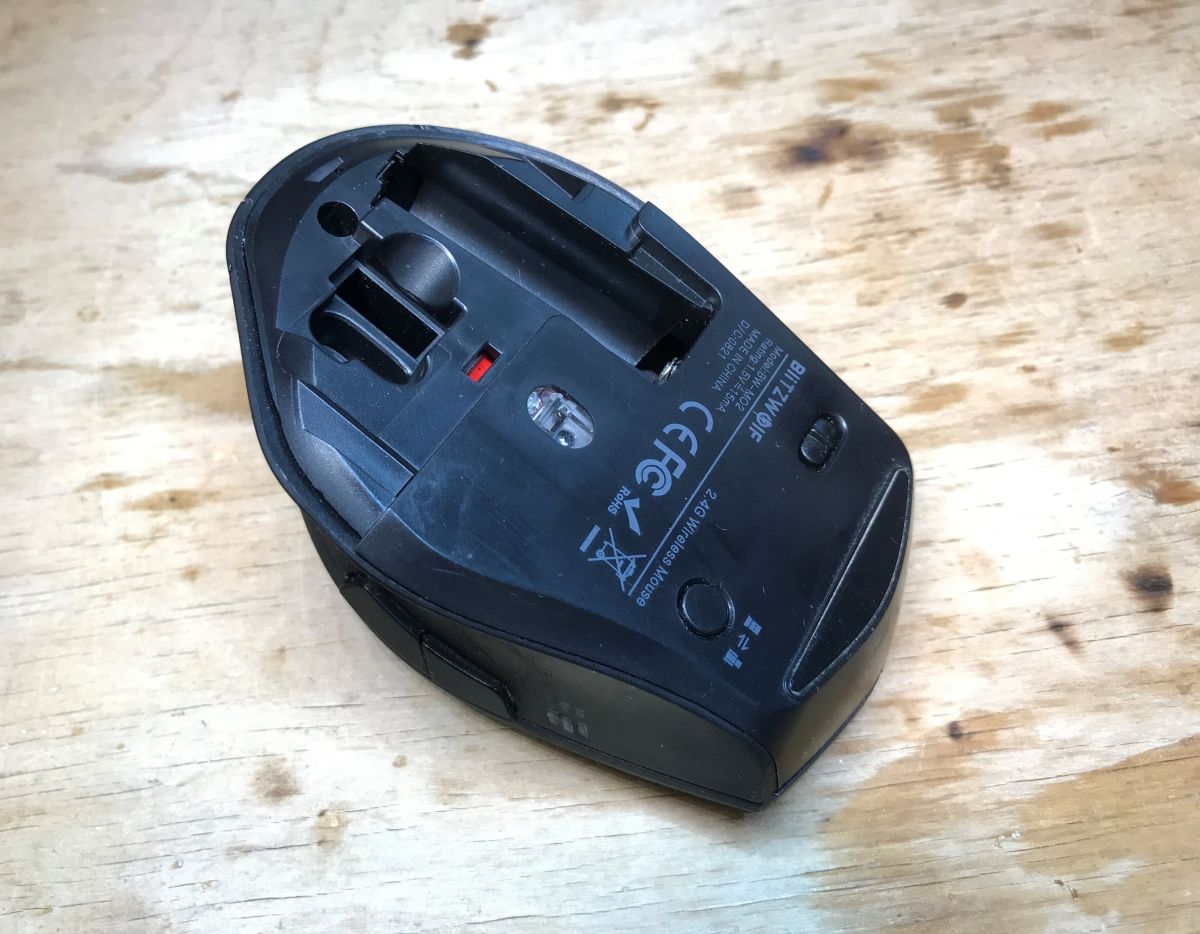

    There is only one screw on the bottom, on the other side holds the catch:
    Bottom of the BW-MO2 wireless mouse on a wooden surface.

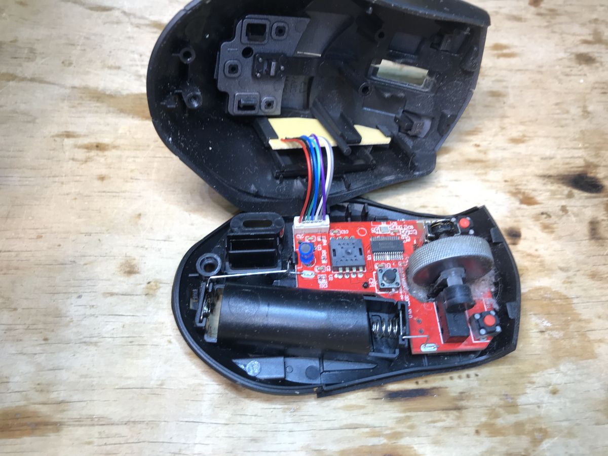

    This is how you get inside:
    Interior of the BW-MO2 mouse showing the circuit board and mechanical components.

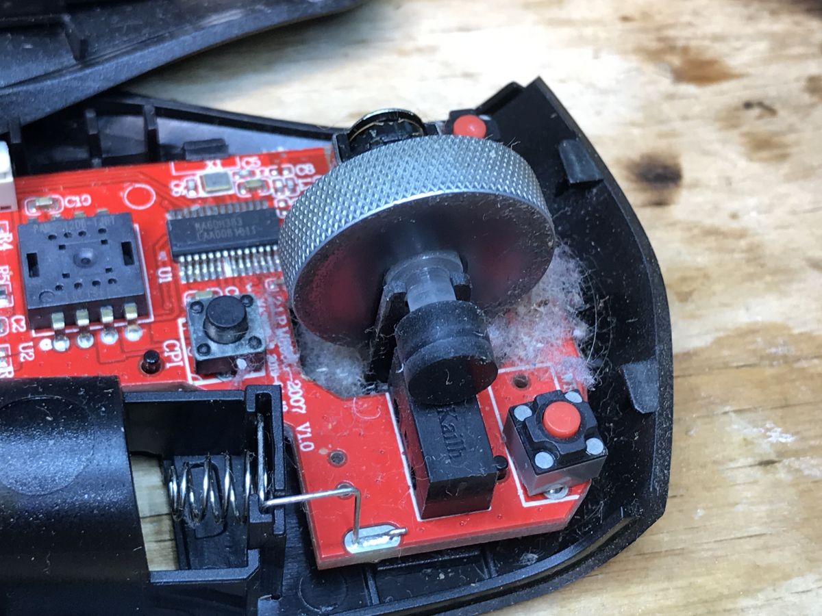

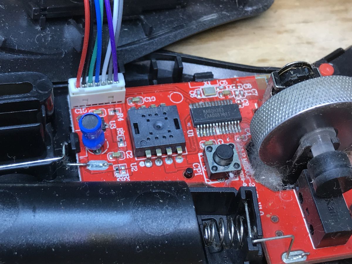

    Beyond the dust pulled in by the mouse wheel, we also see the laser sensor and the main mouse controller: MA60H383
    Interior of BW-MO2 mouse with visible dust and electronic components. Interior of a BW-MO2 wireless mouse covered in dust.

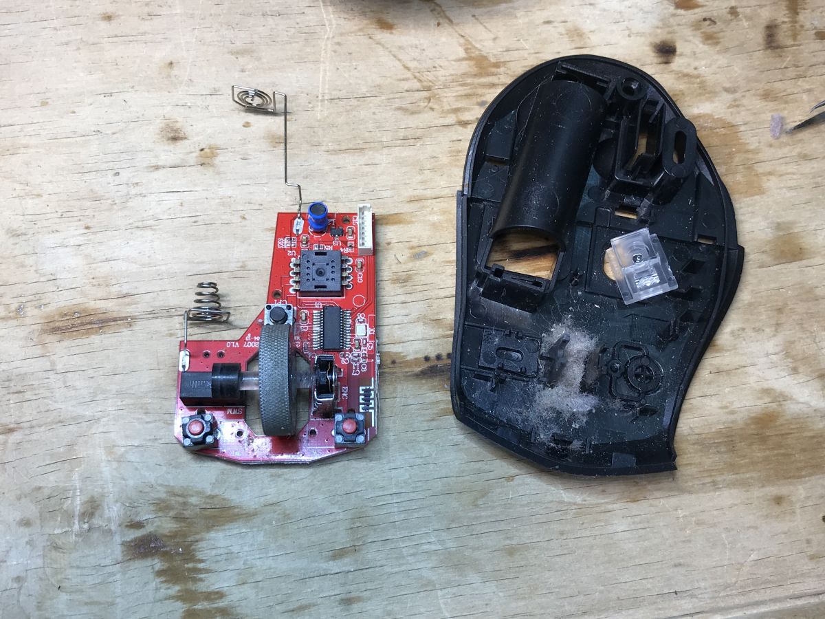

    The board is held in place only by clips, and can be levered:
    Disassembled BW-MO2 mouse showing interior and electronic components.

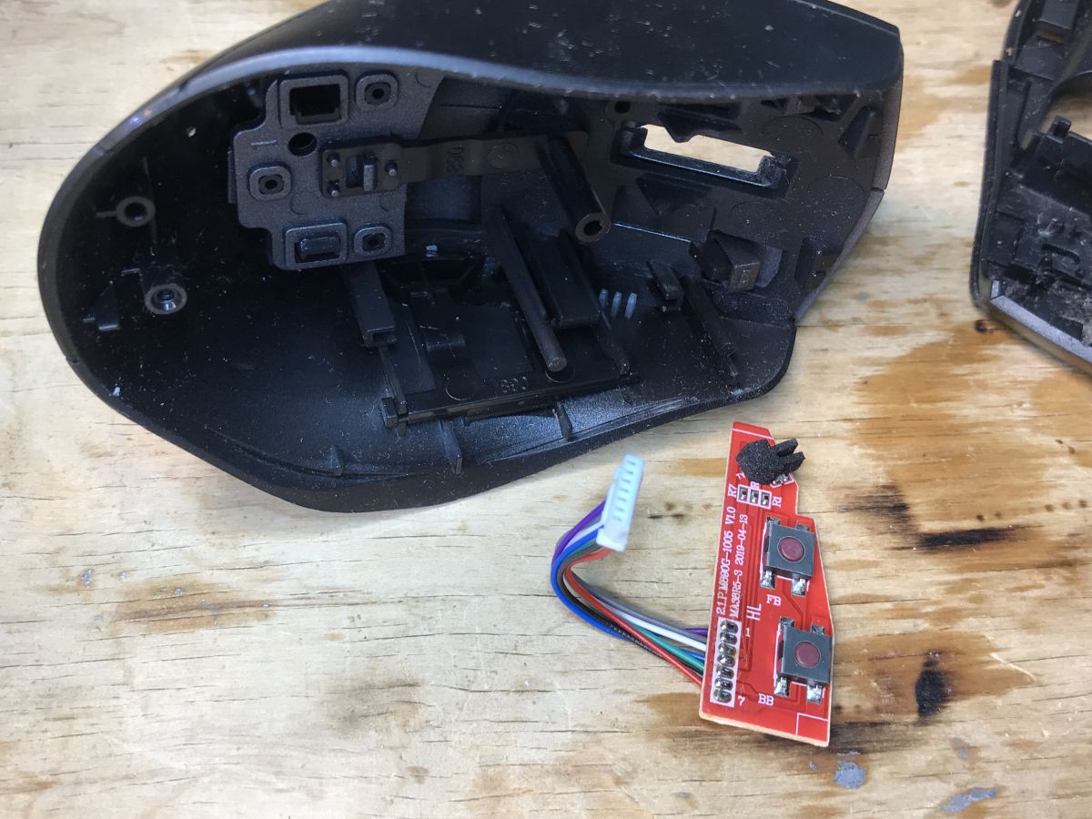

    Similarly with the side buttons:
    Interior of the BW-MO2 wireless mouse with a circuit board and casing on a table.

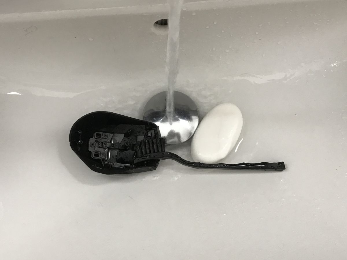

    I separated the plastic and cleaned it decently:
    Interior of the BW-MO2 mouse being cleaned under running water in a sink.

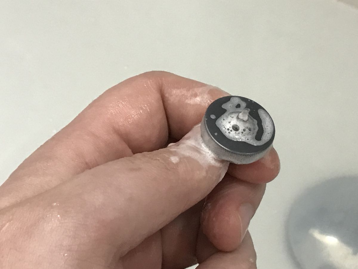

    The wheel was also very dirty:
    Close-up of the scroll wheel from the BW-MO2 mouse with visible dust particles.
    But it was also washed:
    Cleaning the wheel of the BW-MO2 mouse.

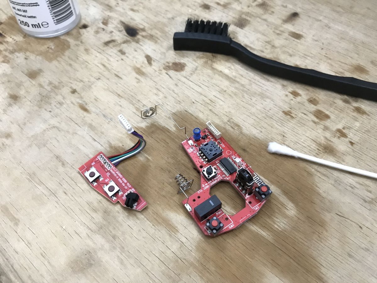

    PCB I washed with IPA alcohol:
    Interior of the BW-MO2 mouse with disassembled components on a table.

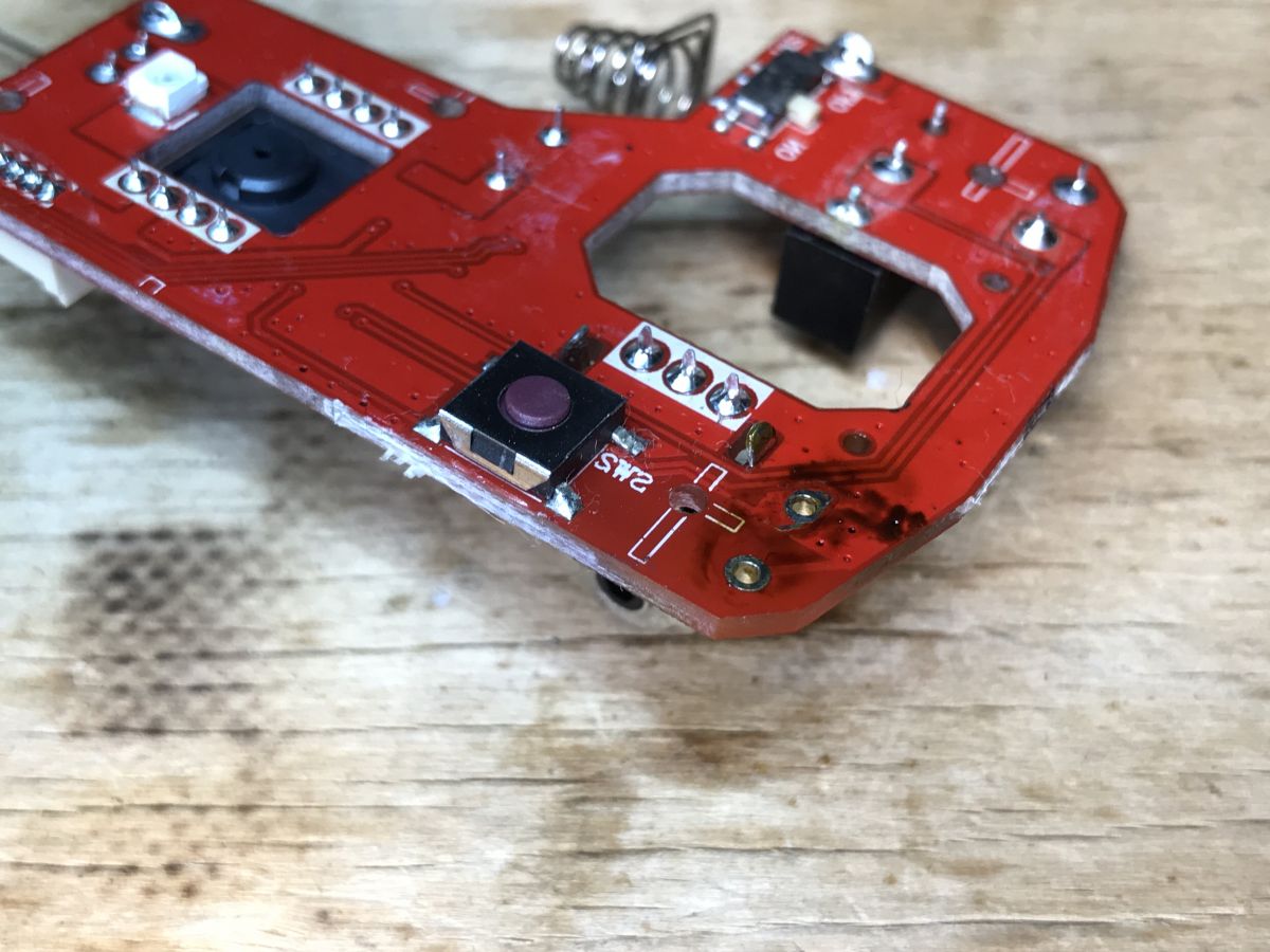

    Unfortunately, the left mouse button continued to respond once in 3 attempts. I decided to replace it:
    Circuit board from inside the BW-MO2 mouse on a wooden background
    I didn't have such a button (or a matching one), and the mouse was needed "right away" so I cut the footrest out of plastic and soldered what I had:
    Close-up of the BW-MO2 mouse circuit board with a replaced button.
    After one fix and a few resizing, it worked. The mouse works like new.
