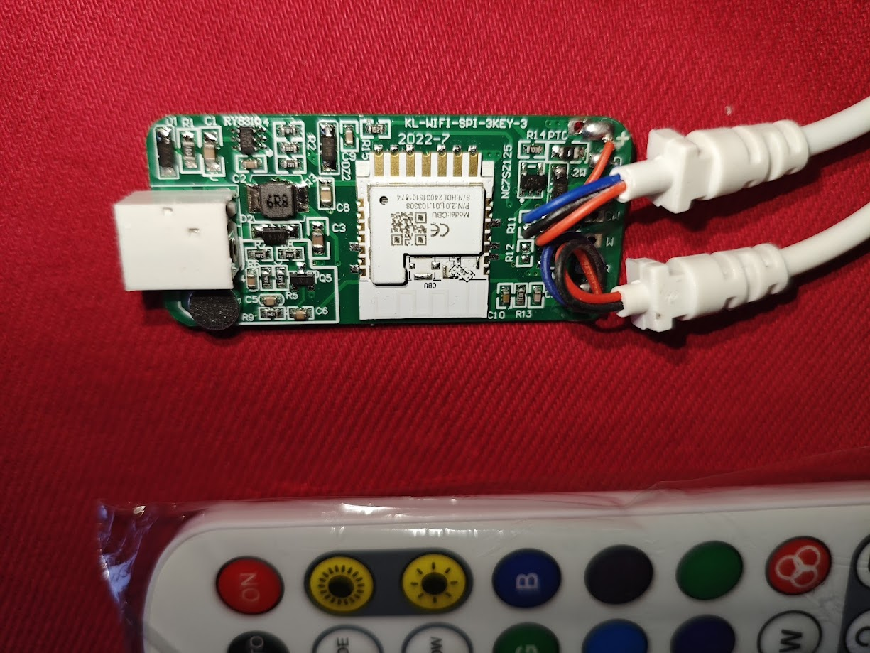

    I grabbed this from Ali curious about what might be inside. I'm also keen to test out the new OBK individually-addressable LED support and the pixel animations in this PR https://github.com/openshwprojects/OpenBK7231T_App/pull/1205
    More on OpenBeken's WS2812B support here https://www.elektroda.com/rtvforum/topic4036716.html
    Tuya 12V/24V WiFi LED controller for WS2811 3-pin LED strip.
    The listing mentions WS2811 and the connector looks like a standard 3-pin male SPI LED strip type.
    3-pin LED cable with male and female connectors.

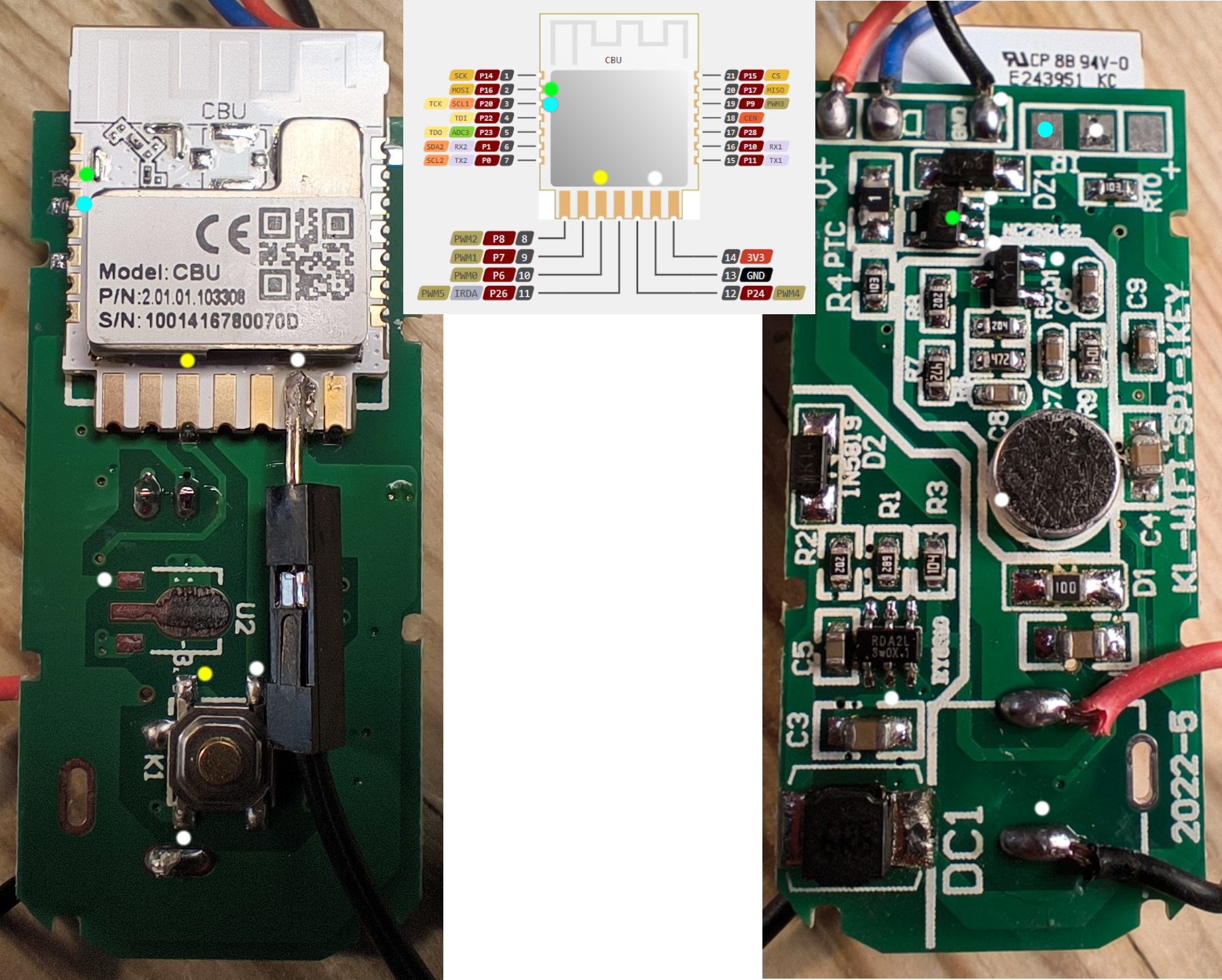

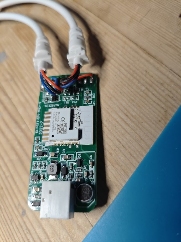

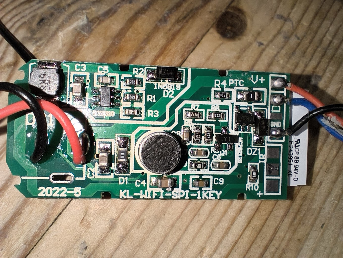

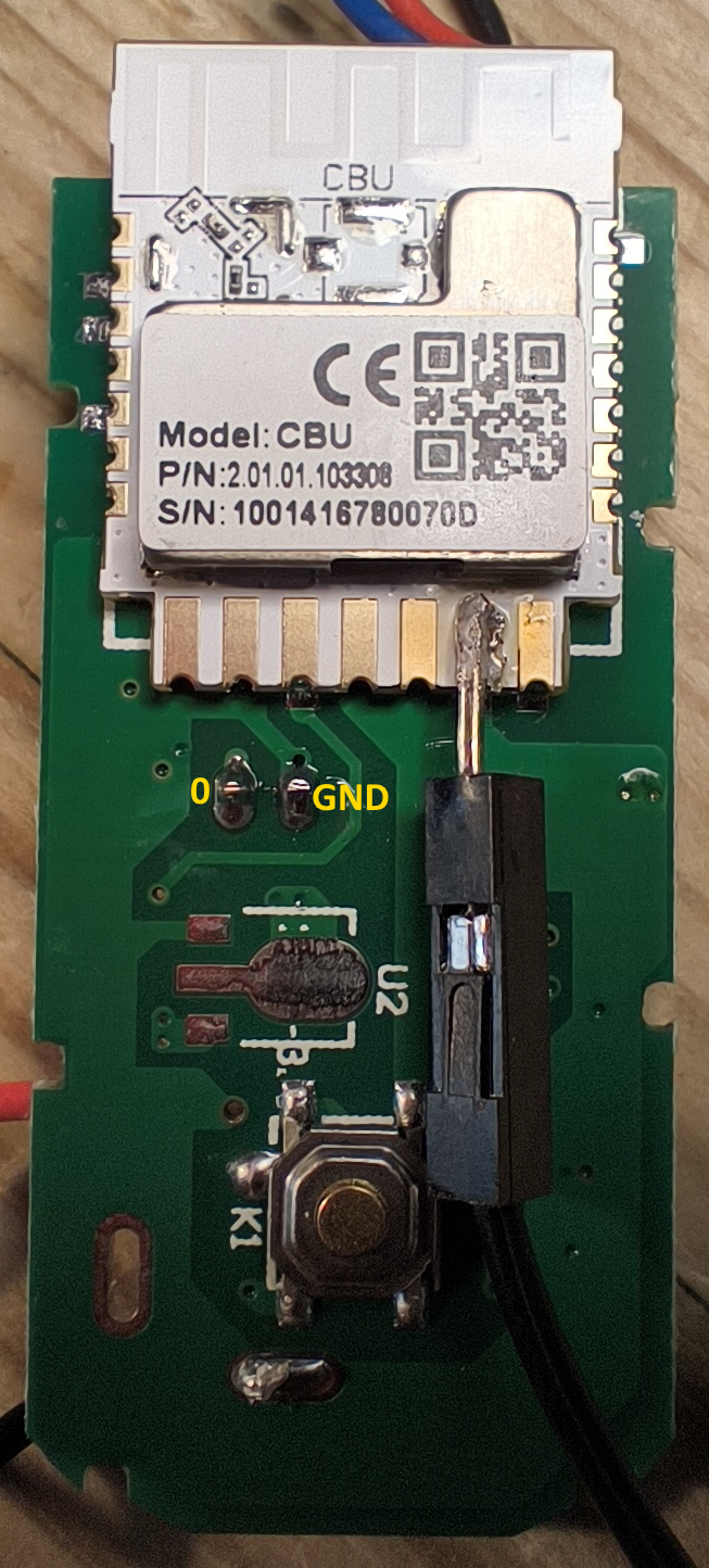

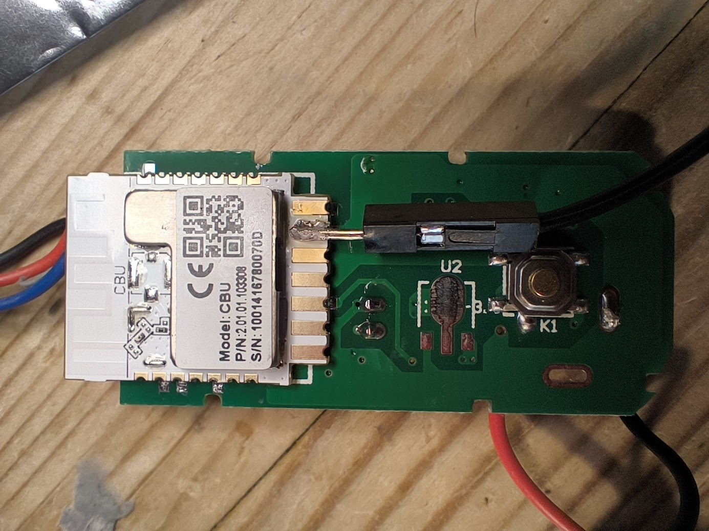

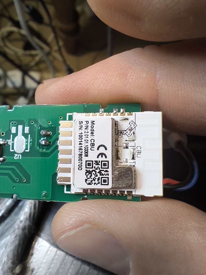

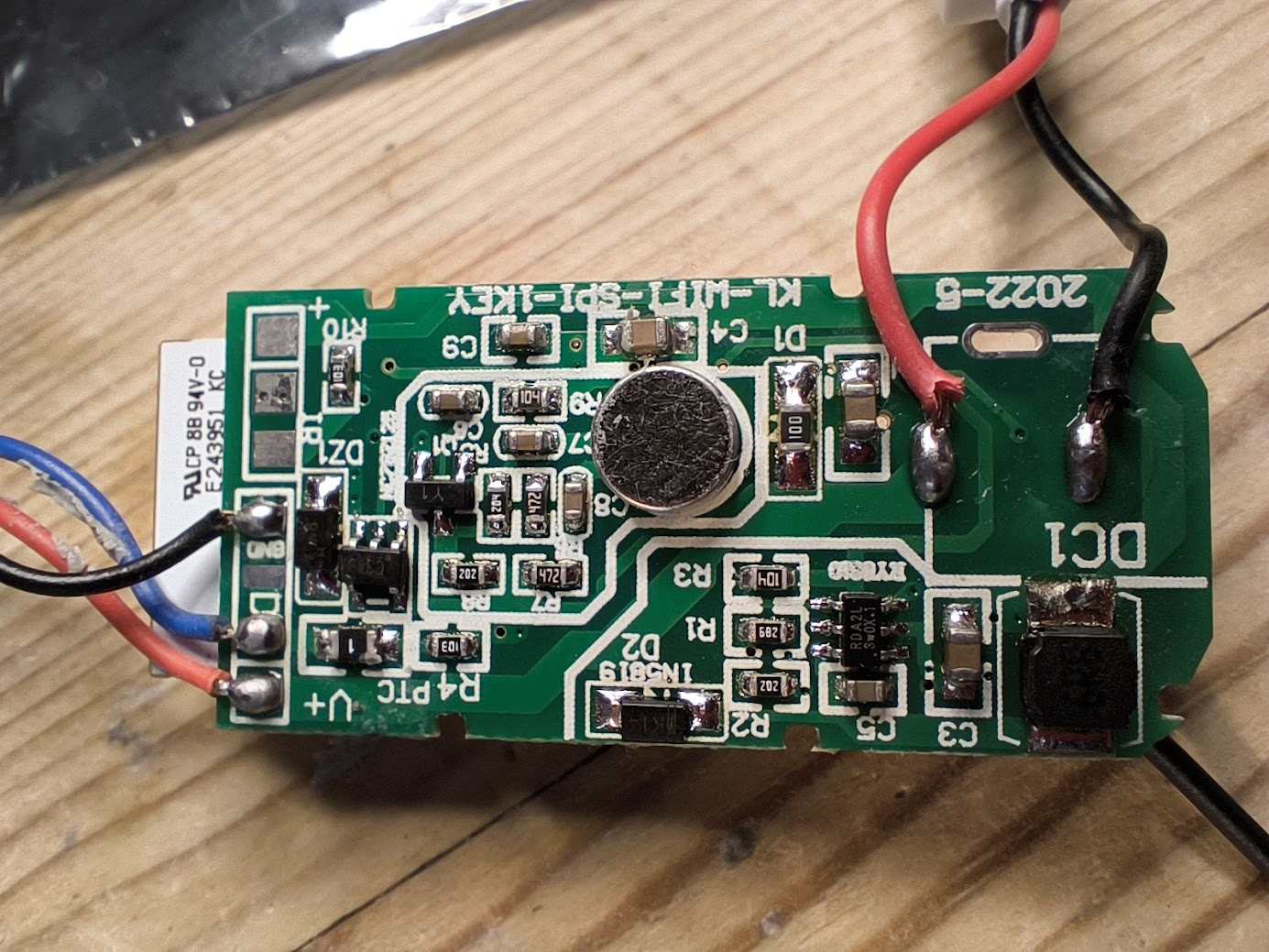

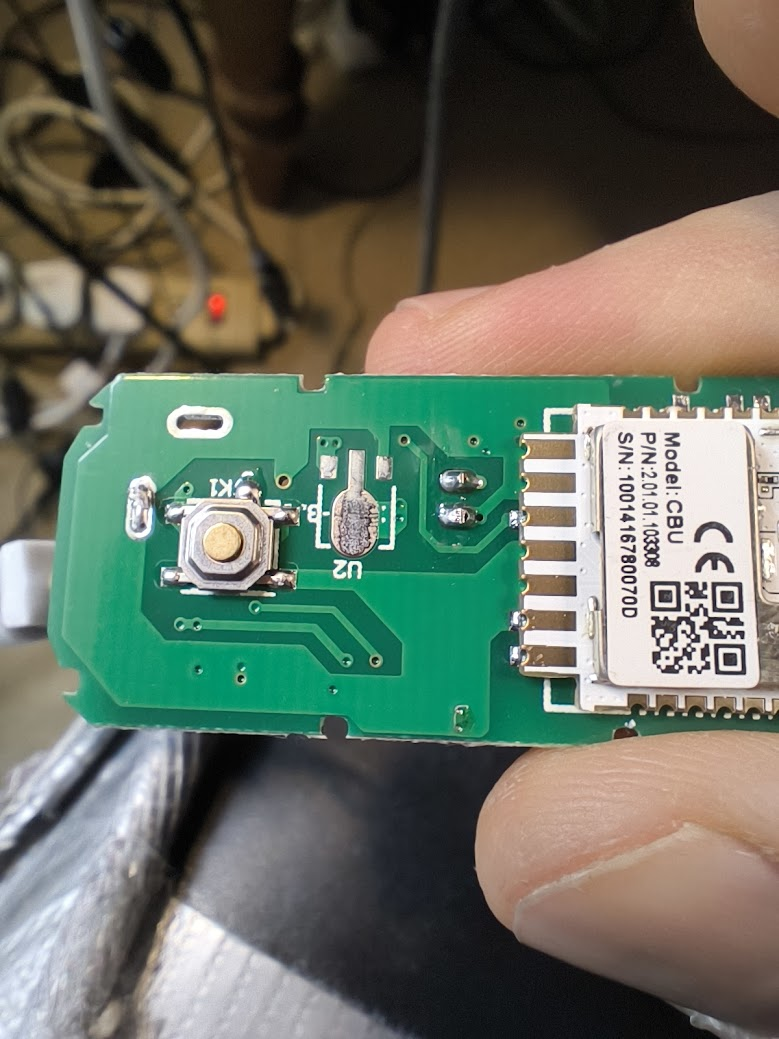

    Surely it'll be a CBU using P16 for MOSI to drive the data line? Yes. it is. After popping the bottom of the unit up, which was easy, we see the main PCB, complete with microphone, which I hadn't clocked was mentioned on the product page
    CBU module on a circuit board with label and QR code Circuit board with a button and a module labeled Model: CBU. Circuit board with CBU module, button, and connected cable. Image of a circuit board of an electronic device with a microphone and various components. View of a circuit board with electronic components, mainly resistors, capacitors, and a microphone. Photo of a circuit board with various electronic components in the background. View of a WiFi LED controller with the cover removed, showing the circuit board with various components.
    Although I have other devices with a CBU that could be adapted, this unit seems especially suited, being already designed for SPI LED support. The one down-side is that the VCC on the output connector is 12V for WS2811.
    Conveniently the device has a push button and unused IR DATA, VCC and GND. All 3 are connected. IR to P20. This should make adding an IR send/receiver easy I believe. Eg
    I have spare IR components from other LED controllers
    Electronic modules connected with wires on a dark surface
    Also, you could remove the microphone, which is currently of no use within OBK, to replace with something else. Another button?
    I traced as much as I could for the main module pads, those that were visibly soldered anyway. There'll be more GND and VCC that I did not check for,
    Close-up of a circuit board with a CBU module and a microphone.
    It seems the missing component pads in the U2 space do not trace anywhere except for GND. I'm not sure what this shaped space could be used for.

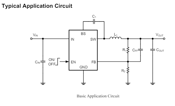

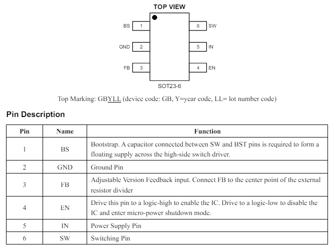

    That 6-pin chip labelled RDA2L 3 <something> 0x.1 I think is a Rychip RY8310 (going by the silkscreen on the PCB anyway) or clone. This looks to be what converts the 12-24v to 3.3v for the CBU module. Datasheet attached.
    Typical application circuit diagram
    SOT23-6 IC diagram with pin functions description.
    Moving on, here is the factory fw boot log
    and a firmware dump attached. Although firmware version 1.0.18 is in the Cloudcutter known patched list, that appears to be for a different device. There are two 1.0.18 LSC LED strip controllers exploitable https://github.com/tuya-cloudcutter/tuya-clou...mmit/29b3a33750d5ca5cd3a59028ba4ad1ac48fc9724
    Easy UART Flasher extracts this information

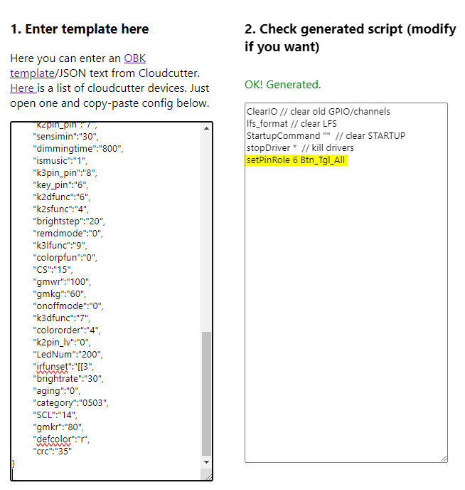

    Template import of the json will only set the button on P6 which doesn't seem to be listed in the extracted pins
    JSON configuration for OBK with generated script for LED control.
    I assume the same firmware was used on devices with more features, those with infra-red for example.

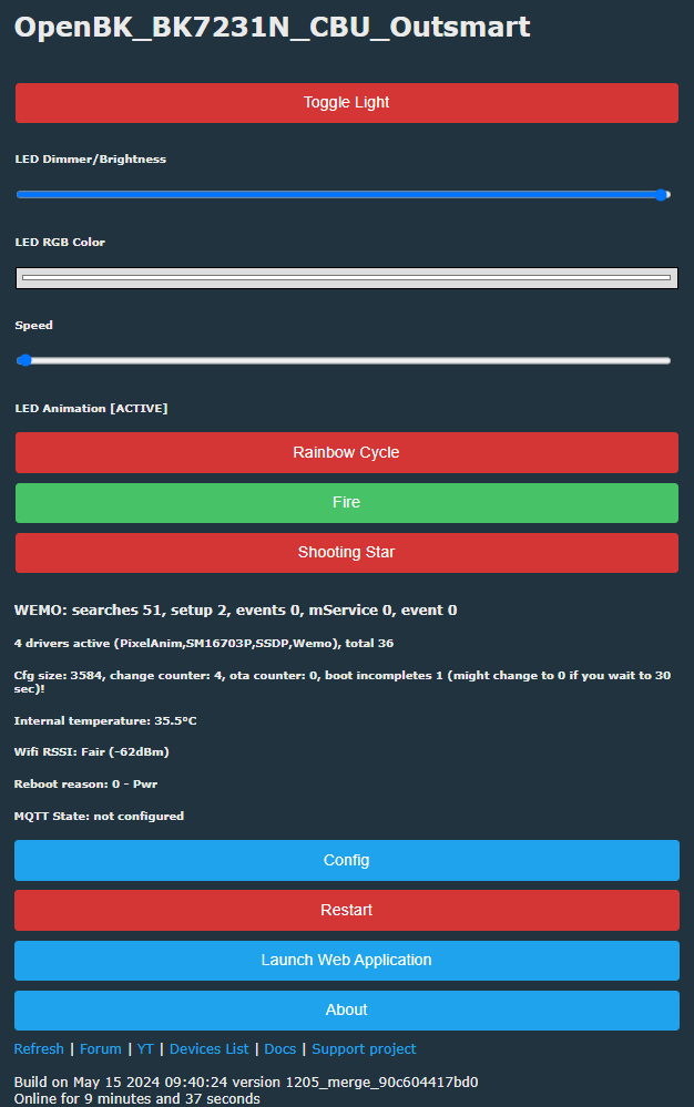

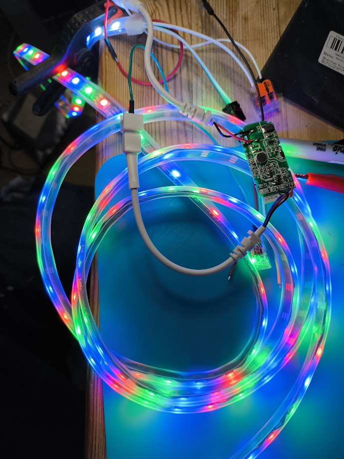

    After flashing with the latest OpenBeken BK7231N firmware I hooked up my 120 LED WS2812B strip to the DIN (data) pin of the connector on the controller (green cable), 5V external PSU to red power injection cable of LED strip, white power injection ground to the ground of my PSU. And lastly the ground from the CBU module to the other grounds to create a common ground. The CBU will be powered by 12v mains-powered AC/DC adaptor with barrel connector for now.
    With both powered and this in the autoexec.bat (Full-strip RGB sample taken from guide linked above). The second value on "setChannel 5 120" being the number of LEDs in my strip.
    We get:
    LED strip with animation effect connected to a controller on a wooden surface.
    which is cool.

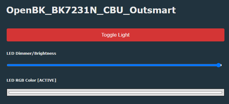

    These pull ~1A at full brightness. This can be reduced with the dimmer slider in the web GUI
    OpenBK graphical interface with a toggle light button and a brightness slider.
    More recently some animations have been added. These can be tried by flashing the build from this pull request https://github.com/openshwprojects/OpenBK7231T_App/pull/1205
    with an autoexec of
    Code: Tcl
    The GUI will look like this
    OpenBK user interface for LED control
    and your strip will do this with one of the animations
    Like my exploration of this device, I understand the PixelAnim driver will develop yet further in due course.
    I look forward to playing with whatever's next!

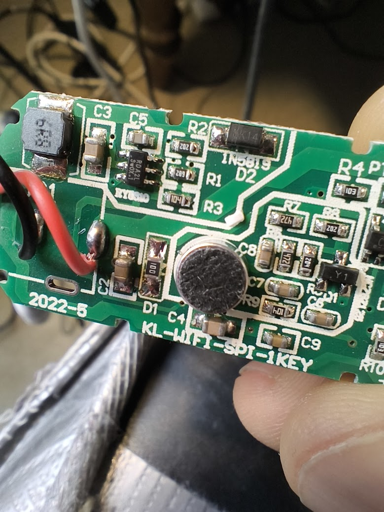

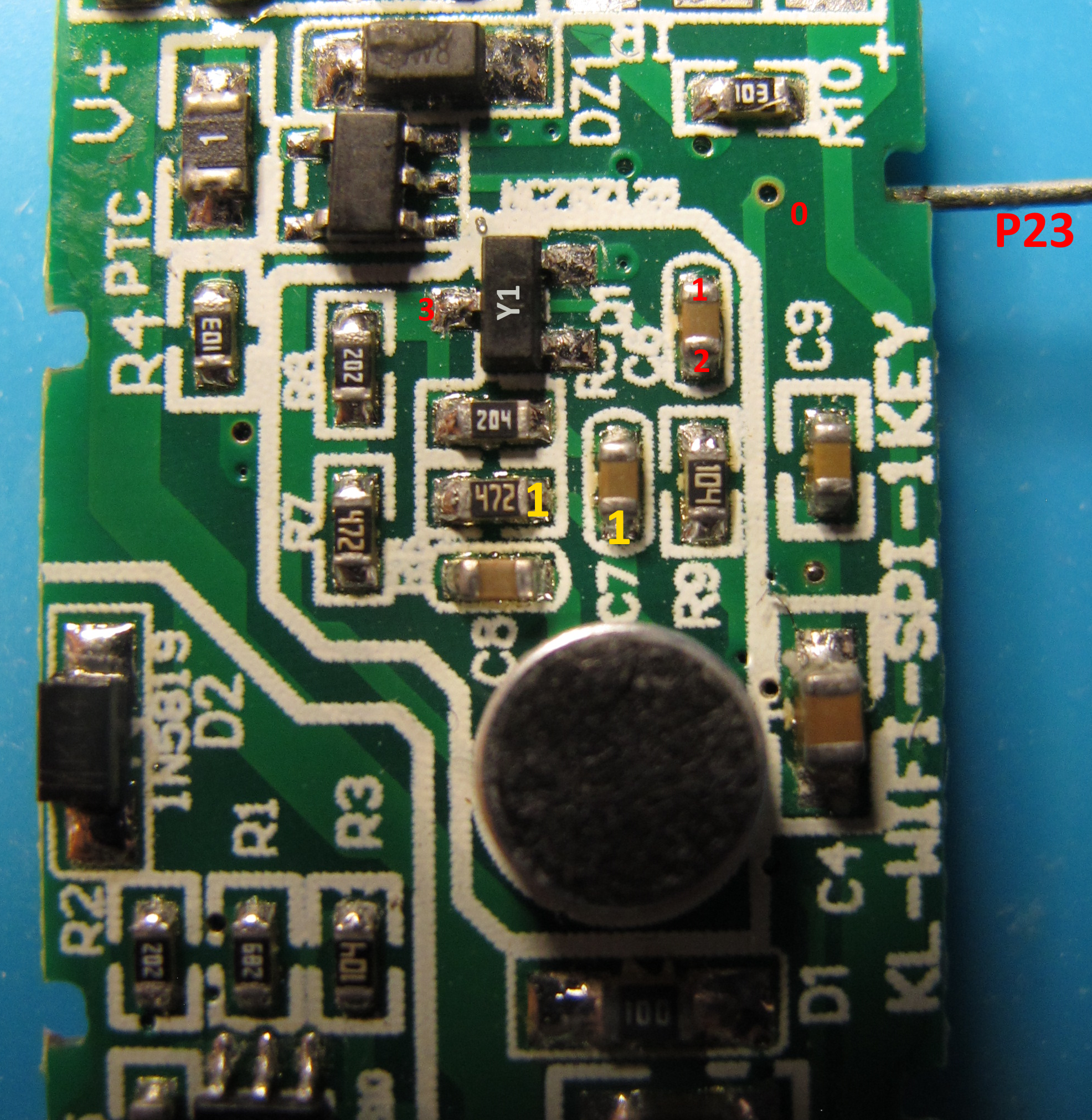

    @divadiow
    How is that microphone connected?? We worked on somewhat similar device that used the mic to turn smart LED"s into something like a VU meter.
  • #3 21099261
    Posts: 5220
    Help: 449
    Rate: 918
    Well, I assume off P23 but I wasn't able to get continuity from anything but ground on the mic outer shield. I guess the pin is underneath and definitely not accessible. No corresponding legs on the underside either.
    I can trace more in earnest tomorrow. Is it likely to come straight off P23 or will there be components in its path?
  • #4 21099270
    DeDaMrAz
    Posts: 621
    Help: 34
    Rate: 130
    I assume it is probably over some bias resistor network but will be interested how it looks and works. Please post your findings.
    The interesting thing is how is it implemented in the original FW and how can we use it.
    Thanks.
  • P23 traces to red 0 and network area
    #5 21099332
    Posts: 5220
    Help: 449
    Rate: 918

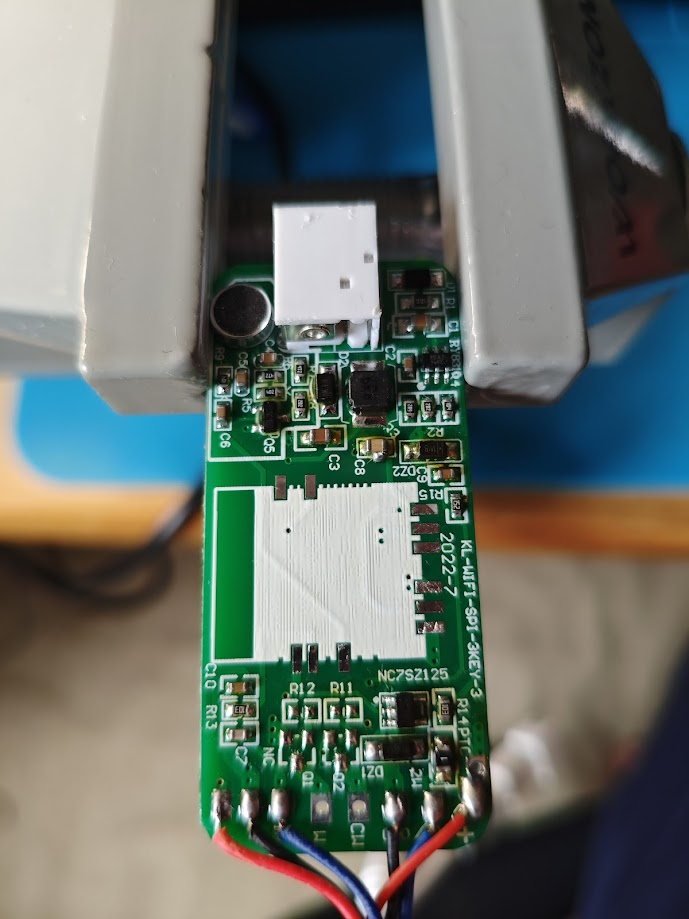

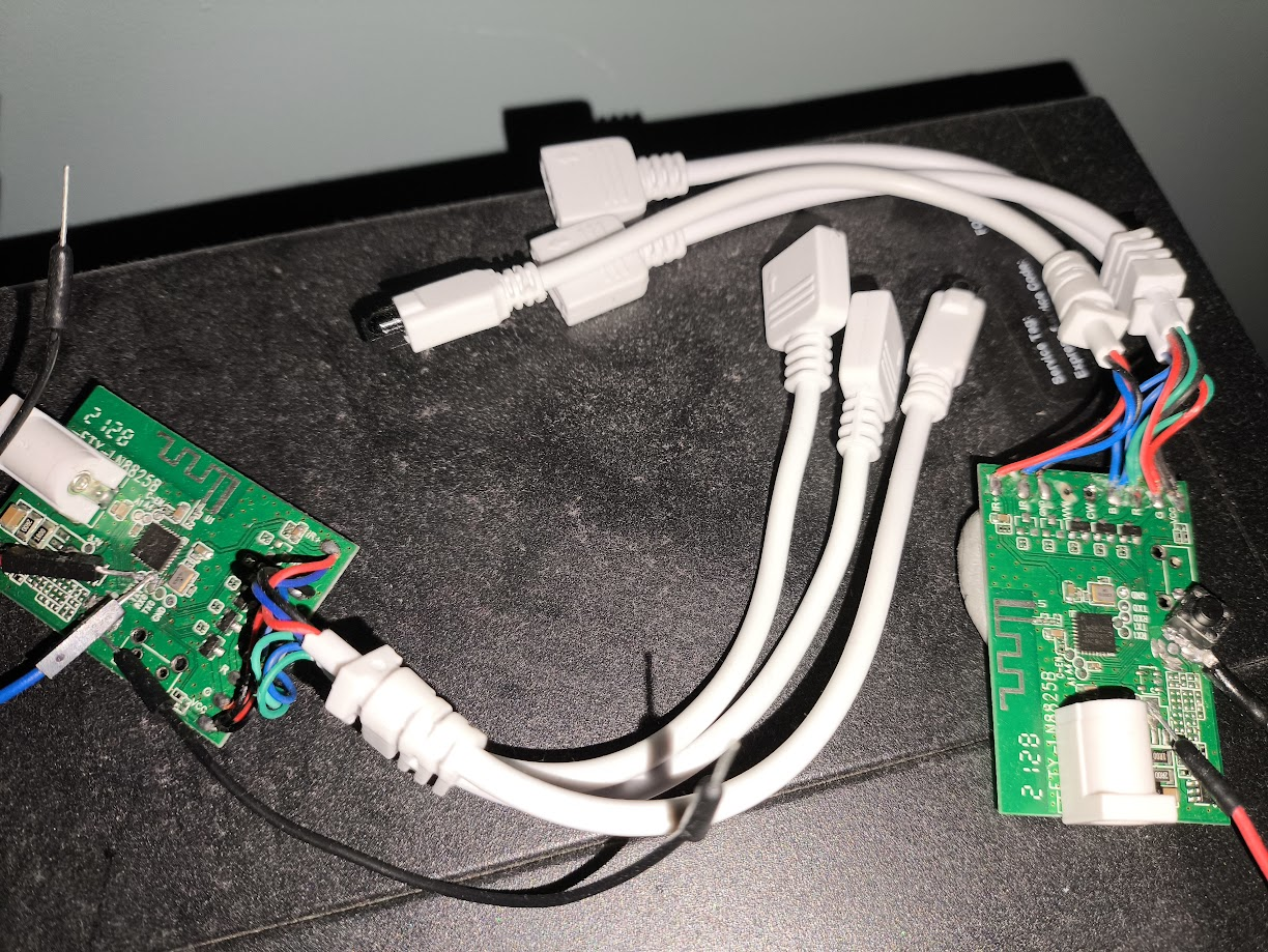

    so P23 immediately goes through to red 0 on the underside then onwards to the network in the fenced mic area 1, 2, 3 ...
    Cool little Outsmart/Tuya RGBIC LED controller perfect for OpenBeken PixelAnim WS2812B control [CBU]
    and sorry, yes, the mic clearly does have legs on the underside. back outwards from the mic in yellow starting 0
    Added after 11 [minutes]:
    I've just remembered this device which already has IR, a CBU and a mic and outputs 5V
    https://www.elektroda.com/rtvforum/topic4026945.html

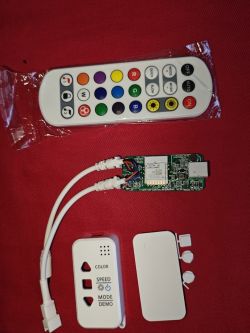

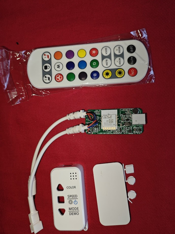

    another device that might be even more appealing https://www.aliexpress.com/item/1005006712164515.html
    Tuya set with RGBIC LED controller and remote.
    CBU, mic, 3 buttons, IR, remote. but sadly still 12V
    Close-up of a circuit board with two white cables, a microphone, and electronic components. Circuit board with three buttons on a wooden table LED controller on a red fabric background with wires and a remote control. Remote control, LED controller, and casing parts on a red background.

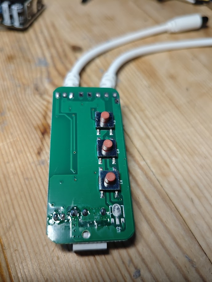

    template for first device
    API response calls this model:
    catchy
    https://github.com/OpenBekenIOT/webapp/pull/1...mits/7e1c38aa23f195e70ce2b0813a7a4f3d04e1b4c3
    White LED controller with one large button and two connection cables.
    EDIT ADDITION. CBU removed
    Close-up of a circuit board with a microphone and USB connector.

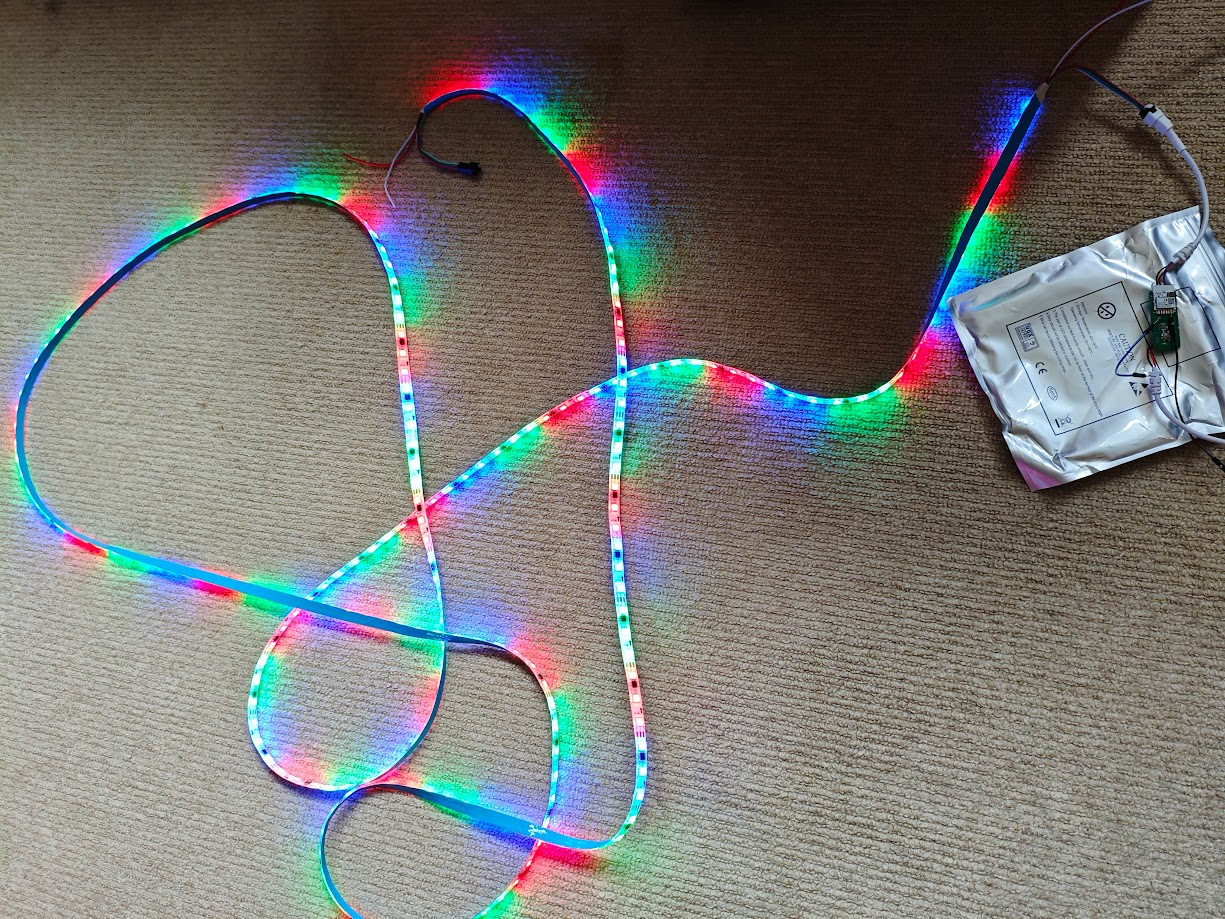

    just took delivery of a 4M 60 LED per metre 12v WS2811 strip.
    I know the timings are slightly different to WS2812B so expected the colour picker to get the wrong colours (it does), but the anims are kinda OK. If you didn't know any different, you may not notice.
    This static pic is this autoexec
    WS2811 LED strip glowing in rainbow colors, lying on a carpet with packaging and electronics.
    even though 120 LEDs is set all 240 light up on this WS2811
    and the rainbow animation

  • #19 21303792
    christianalexzappa
    I'm stuck! I have flashed and set the config to Outsmart (IR version) but I can't for the life of me get the LEDs to light up. I'm a noob and don't know where to go next from here.
  • #20 21303830
    Posts: 5220
    Help: 449
    Rate: 918
    what's in your autoexec.bat file currently?
  • #21 21308044
    christianalexzappa
    >>21303830
    I tried some of the ones mentioned above. But TBH I’m not sure I did things right. I did end up with a color picker on the main page but the strips did not light up.
    I’m using ws2812b 84 per meter
  • #22 21308242

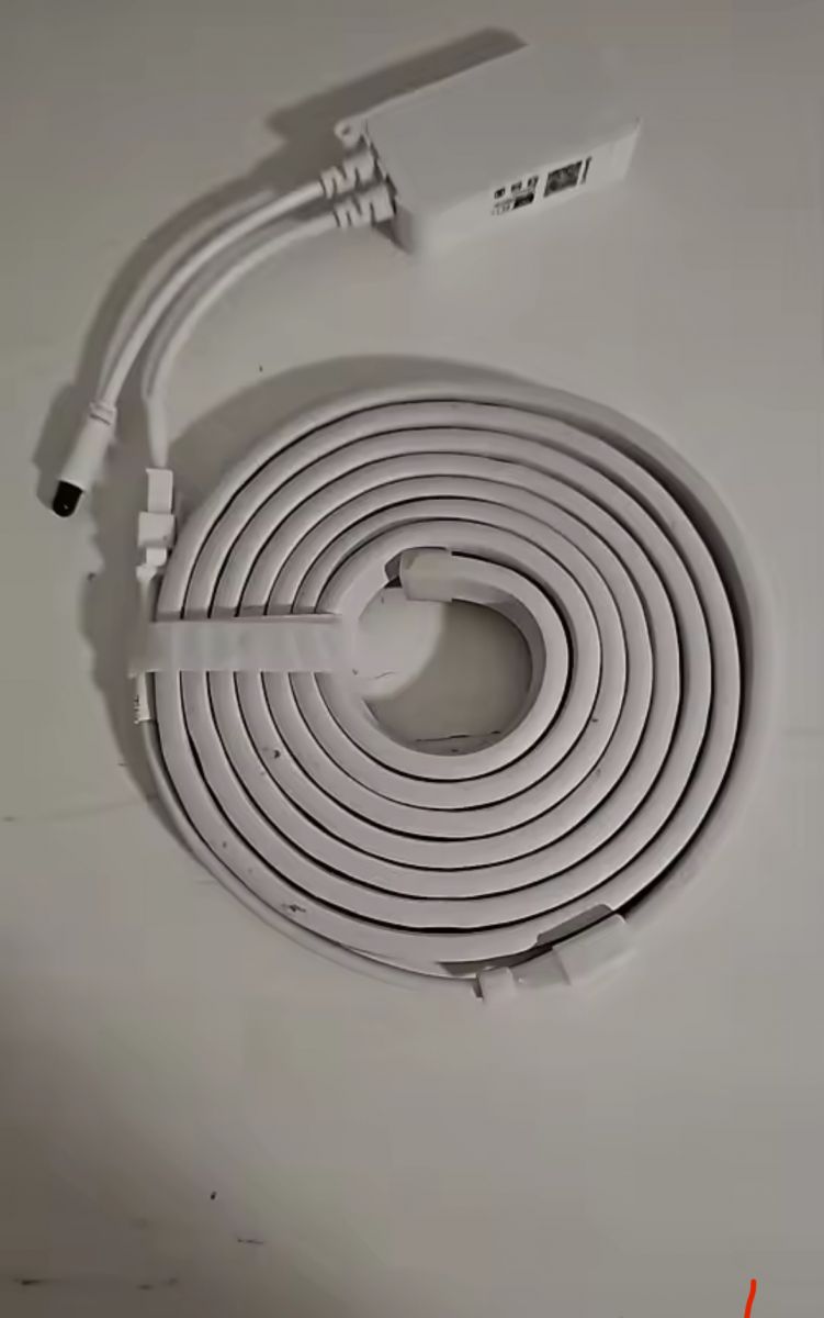

    Very out of the box, I’m using the RGBIC strip that came with the controller. So I’ve done no physical mods, only flashed with Tuya Cloud Cutter.
    Coiled RGBIC light strip with controller on a white surface.
