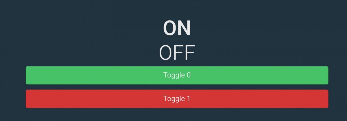

    Hi all, is it possible to change the button names "Toggle 0" etc. change to an individual name like "Desk Light" or "Air Pump" or something else ?
    Interface with buttons Toggle 0 and Toggle 1 with ON/OFF options.

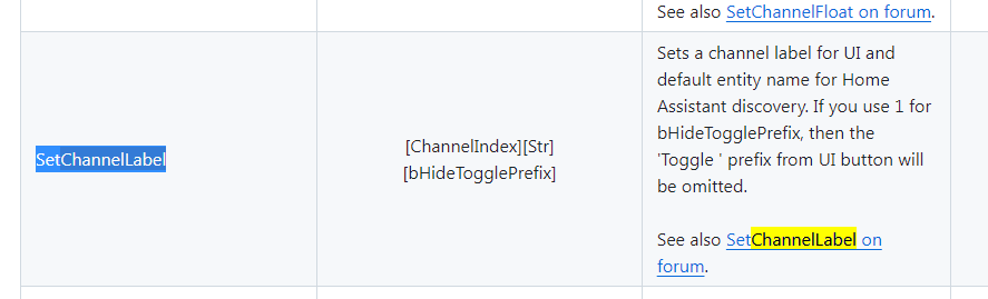

    #2 21235810
    Posts: 14699
    Help: 656
    Rate: 12744
  • #3 21235973
    150219v8
    Posts: 46
    Perfect answered
