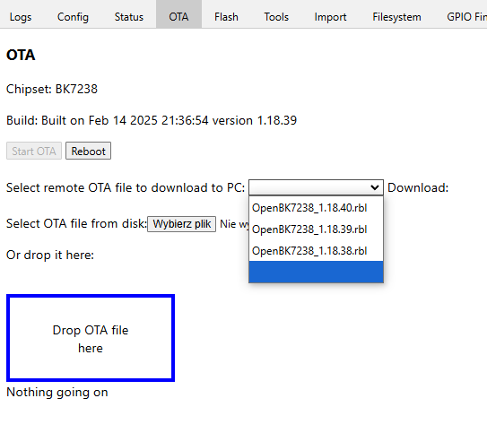

    Interesting. I saw your post over there and was planning to look over that firmware backup in the morning.
    BK7238 development is still a work in progress but there are OpenBK7238 firmwares that could be flashed
    https://www.elektroda.com/rtvforum/topic4092465-60.html#21361724

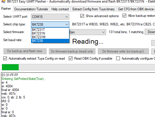

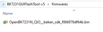

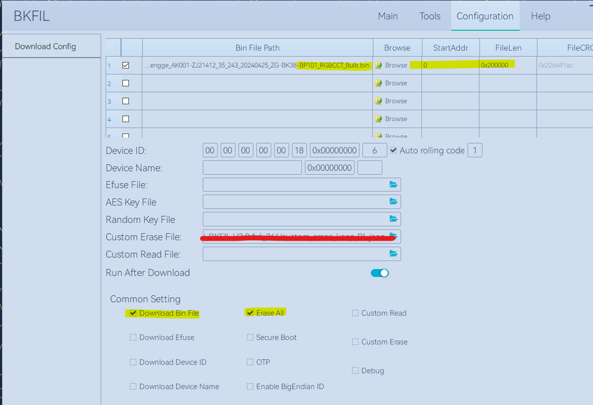

    Easy Flasher and rename firmware for BK7238 flashing
    #4 21376381
    Posts: 5208
    Help: 446
    Rate: 914

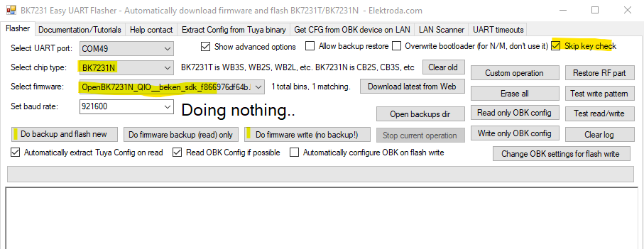

    Jinaria wrote:
    - I'm not sure how to flash the experimental firmware, I dumped the flash and rom using ltchiptool but it cannot write to the flash.
    Easy Flasher can be used to read/write firmware from BK7238 - https://github.com/openshwprojects/BK7231GUIFlashTool
    To burn the latest BK7238 firmware, place OpenBK7238_QIO__beken_sdk_f866976df64b.bin from the attached zip into the EasyFlasher firmwares subdir and rename to OpenBK7231N_QIO__beken_sdk_f866976df64b.bin
    View of the firmware folder in BK7231GUIFlashTool.
    Be sure to reveal advanced options and to choose skip key check
    Screenshot of the Easy UART Flasher software with BK7231N selected and OpenBK7231N_QIO__beken_sdk_f866976df64b firmware chosen.
    or flash with BKFIL https://www.elektroda.com/rtvforum/topic4059172.html

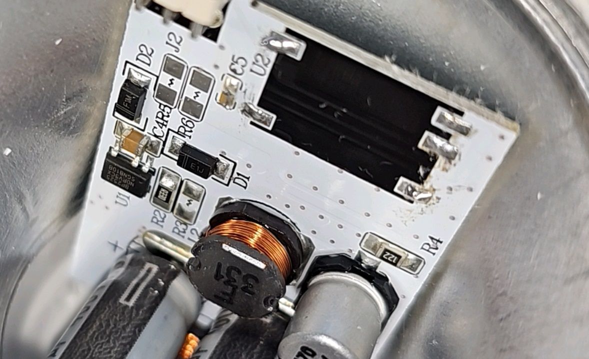

    Thank you for the step by step guide, I managed to flash the firmware successfully but for some reason the AP does not show up. I noticed that the factory firmware dump is 2MB but the experimental firmware size is only 1224KB.
    Added after 24 [minutes]:

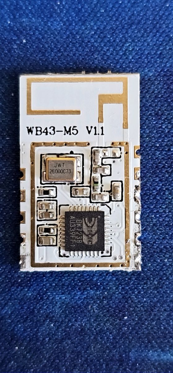

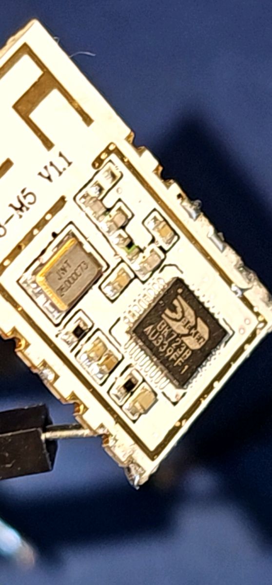

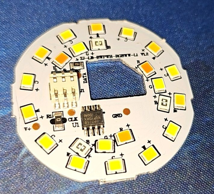

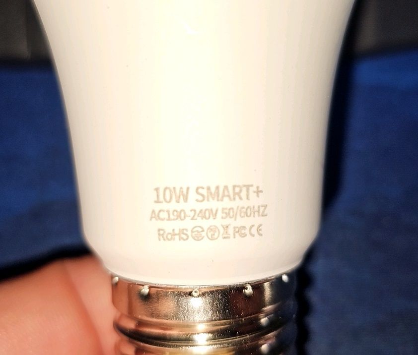

    Cannot edit the first post, here are some photos of the smart bulb:
    Close-up of a circuit board inside a smart bulb showing electronic components. 10W smart bulb with visible technical markings. LED smart bulb circuit board with LEDs and integrated circuits. Close-up of a circuit board with visible electronic components.

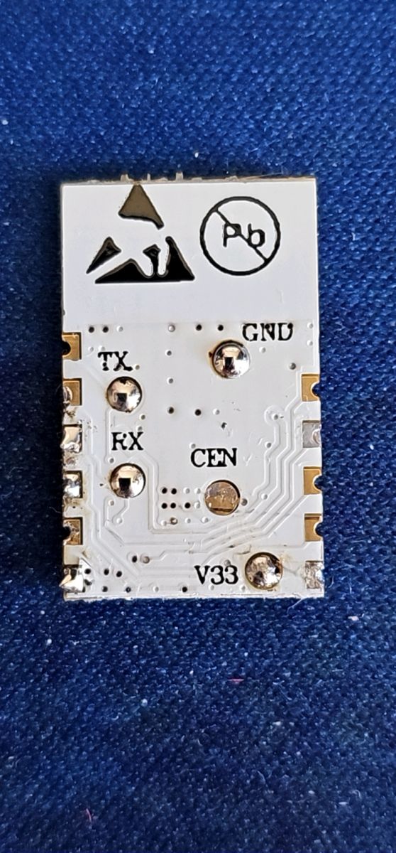

    are you able to see if there is any log UART log out from TX to see if it's booting at all? I'm not sure we know much about this module. Does it have labels on the reverse of the module?
    if you're able to, please post clear head-on front and rear pictures of the module

    The module has RX/TX/CEN/V3.3/GND on the back.

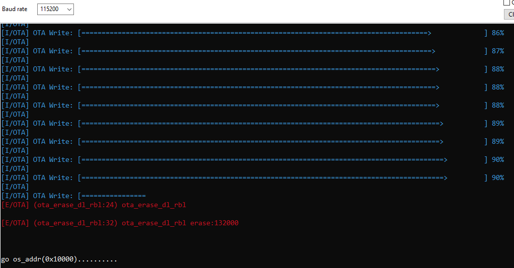

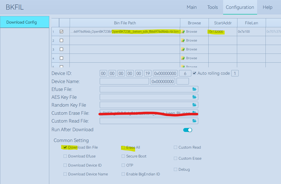

    so yes, flashing the QIO from 0x0 (I used BKFIL) does not result in any output for me - not even bootloader.
    I've flashed your original firmware in its entirety
    Screenshot of BKFIL software with a selected binary file for flashing.
    then flashed OpenBK7238__beken_sdk_f866976df64b.rbl.bin (from zip file above - add .bin to the end) from 0x132000
    Screenshot of the BKFIL tool showing device flashing configuration.
    if you can open the COM port quick enough you'll see the tail-end of the OTA
    Screenshot of OTA process on a black terminal background.

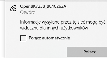

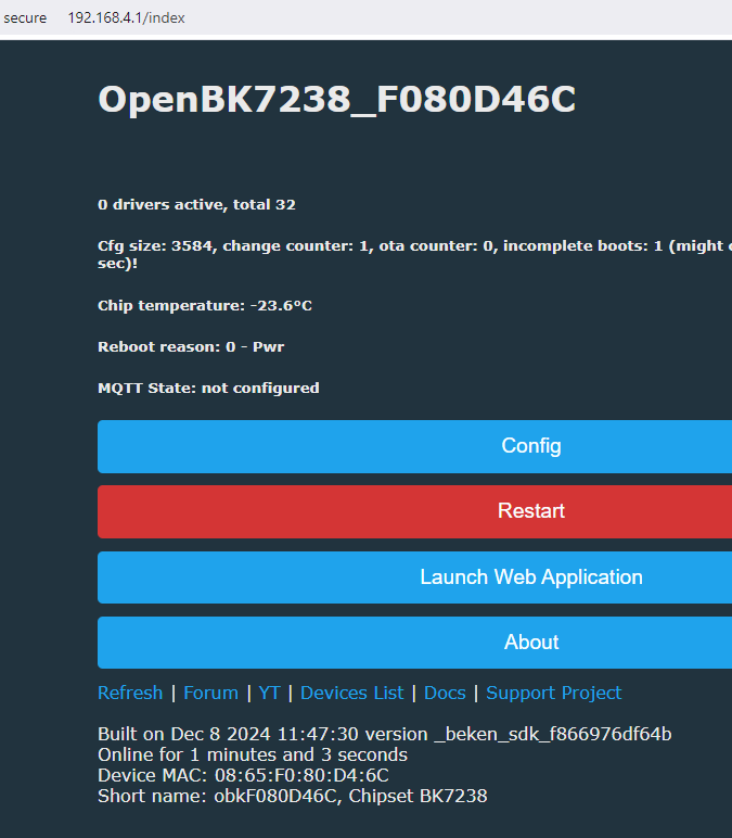

    then the AP broadcasts
    OpenBK7238 user interface with technical data and configuration options.

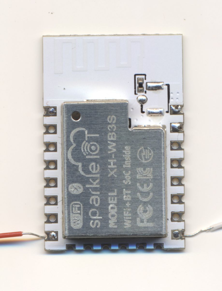

    #12 21438048
    taggbricka
    Posts: 48

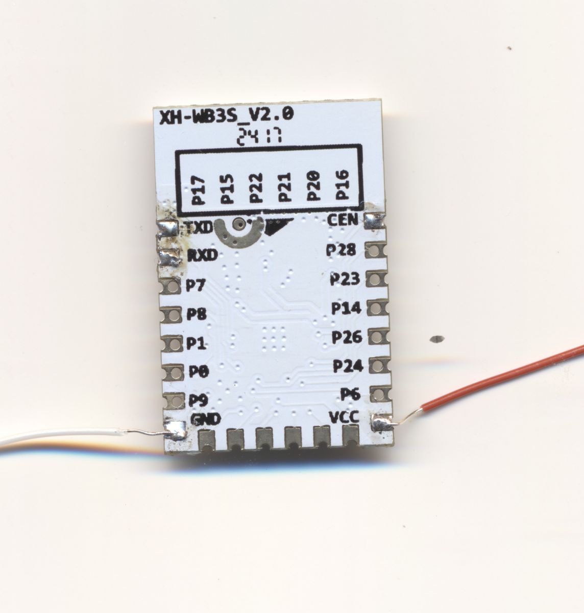

    I just bought (accidentally) a few of these XH-WB3S modules. I was not aware they were BK7238 based.
    XH-WB3S electronic module with labeled pins. XH-WB3S module with visible connectors and markings.
    However I have reprogrammed one with BK723flasher like so:
    The Easy UART Flasher screen with BK7231N chip and OpenBK7231N firmware selected. The interface shows the operation is idle.
    After this the module seems to be idle after power up, draws only 4mA.
    I am wondering if some of the port pins need to be at 3.3V or 0V at startup for the module to boot correctly.
  • #13 21438126

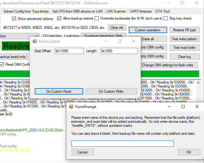

    Flash MID loaded: 152085
    Flash def found! For: 152085
    Flash information: mid: 152085, icName: P25Q16HBK, manufacturer: Puya, szMem: 1000000, szSR: 2, cwUnp: 0, cwEnp: 7, cwMsk: 407C, sb: 2, lb: 5, cwdRd: 05-35-FF-FF, cwdWr: 01-31-FF-FF
    sr: 4
    sr: 4004
    final sr: 4004
    msk: 407c
    cw: 0, sb: 2, lb: 5
    bfd: 0
    sr: 0
    sr: 0
    final sr: 0
    msk: 407c
    cw: 0, sb: 2, lb: 5
    bfd: 0
    Going to read encryption key...
    Encryption key read done!
    Encryption key: 84f67900 84f67900 84f67900 84f67900
    WARNING! Non-standard encryption key!
    If it's all zero, it may also mean that read is disabled.
    Please report to forum https://www.elektroda.com/rtvforum/forum51.html
    Or just try using BK7231M mode
    Going to start reading at offset 0x1D1000...
    Reading 0x1D1000... Ok!
    Basic read operation finished, but now it's time to verify...
    Data is entirely filled with 0xff, something must went wrong!
    OBK config load failed.

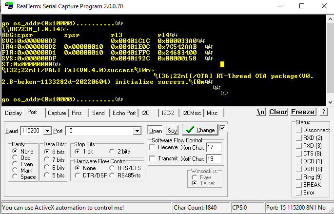

    One device starts up and then goes to zero current consumtion after 2 seconds. (other devices consumes 35mA in operation)
    Tried to reprogram it, programming succeds.
    This is on the serial port:
    BK7238_1.0.14
    REG:cpsr spsr r13 r14
    SVC:0x000000D3 0x00401C1C 0x000033A0
    IRQ:0x000000D2 0x00000010 0x00401E0C 0x09BCA98D
    FIR:0x000000D1 0x00000010 0x00401FFC 0x10F08789
    SYS:0x000000DF 0x0040192C 0x00000158
    ST:0x00000000
    [I/FAL] Fal(V0.4.0)success
    [I/OTA] RT-Thread OTA package(V0.2.8-beken-1133282d-20
    220604) initialize success.
    go os_addr(0x10000)..........

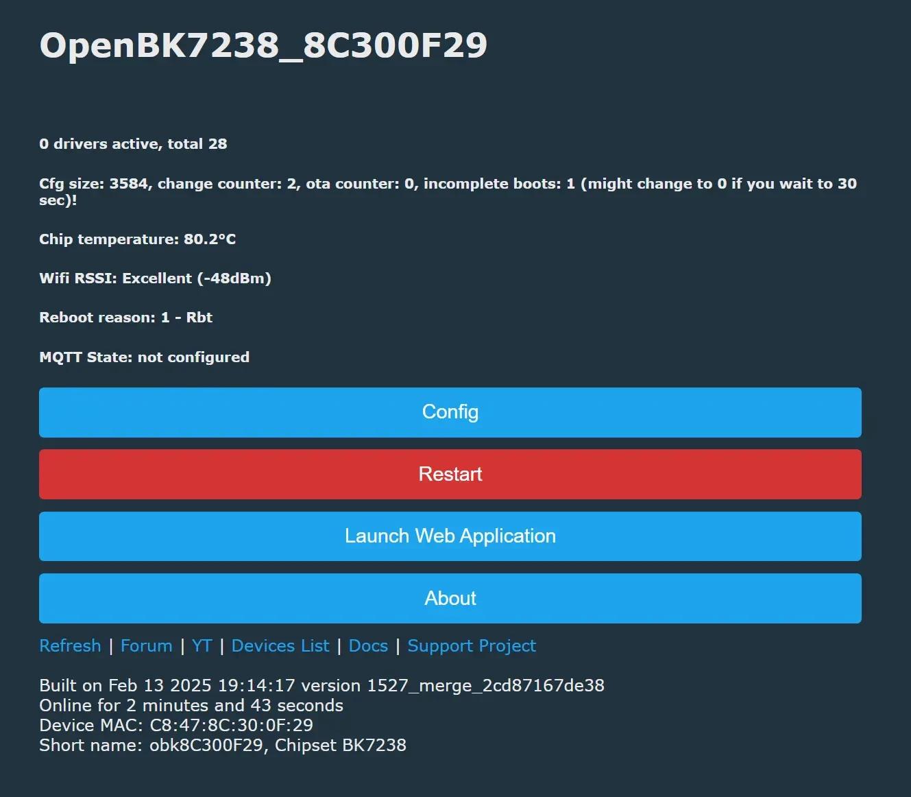

  • #21 21438705
    insmod
    Posts: 1432
    Help: 168
    Rate: 455
    >>21438506 You either flashed an older firmware, or looking at wrong uart port. OBK sends log to UART1 by default, so try to connect your adapter to either P0 or P1 (i don't remember which).
    If you reflash with bootloader overwrite, then bootloader will also log to uart1.

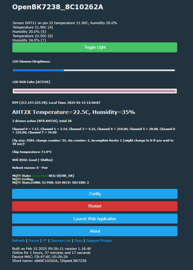

  • OpenBeken flashes successfully on BK7238 module
    #22 21439888

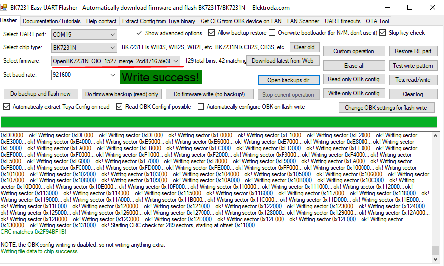

    Posts: 14754
    Rate: 12875

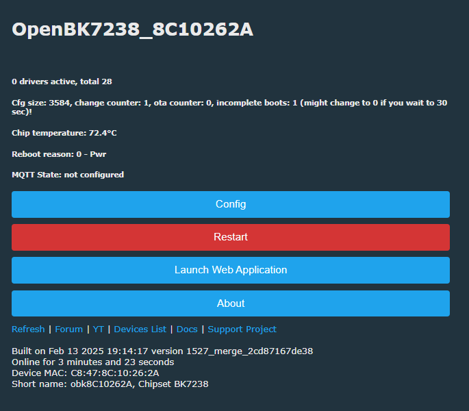

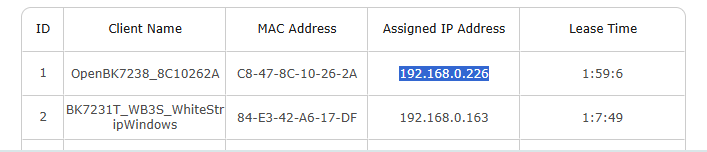

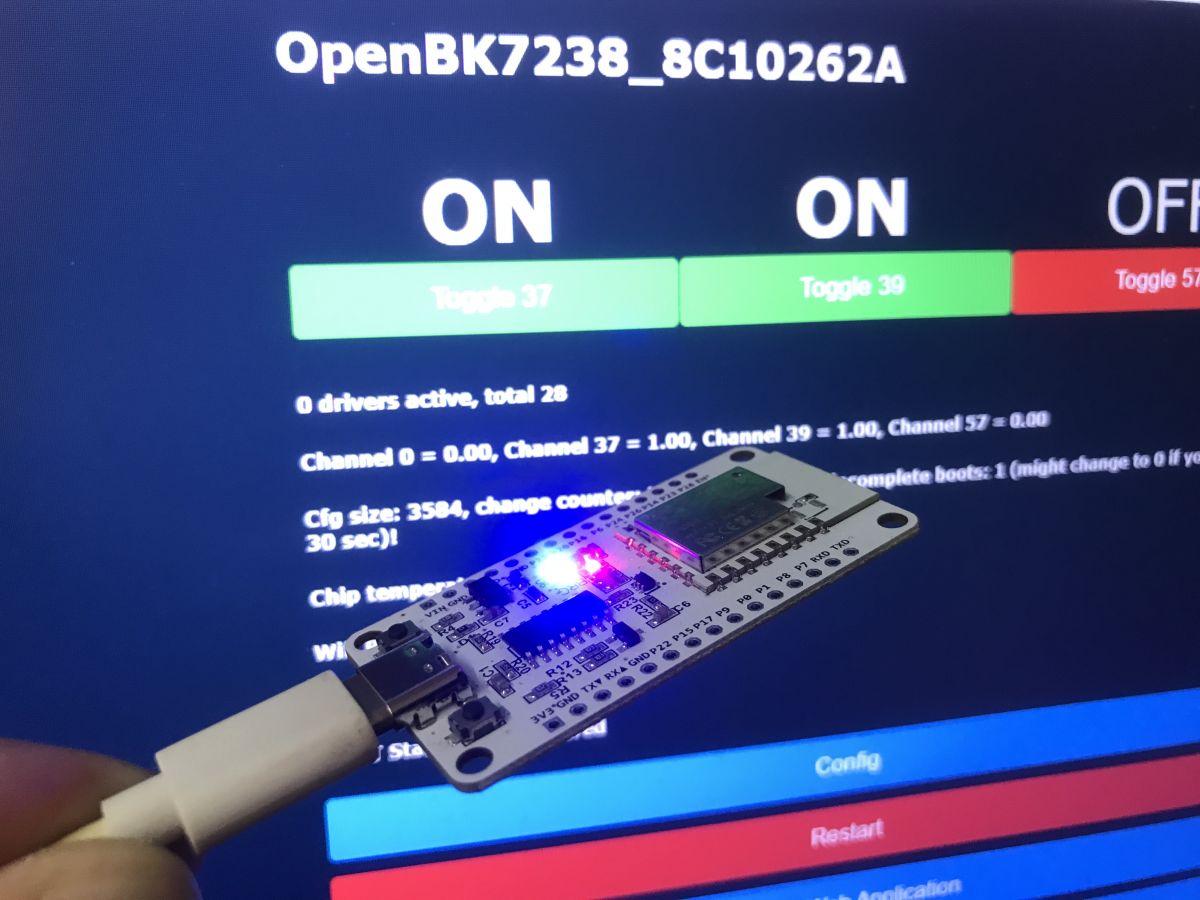

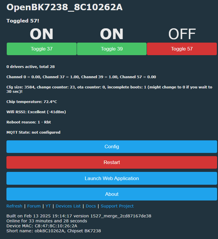

    It seems @insmod did a very good job. Works for me at first try. I just need to update the flasher.
    Screenshot of Easy UART Flasher software showing firmware write success.
    Log from programming UART:
    Screenshot of the Serial Capture Program showing a UART programming log.
    ( didnt have time to connect debug uart)
    Screenshot showing a dialog box for connecting to a Wi-Fi network named OpenBK7238_8C10262A.
    OpenBK7238_8C10262A user interface with options for configuration, restart, and web application.
    Screenshot showing a table listing network devices and their IP addresses.

    #23 21439906
    taggbricka
    Posts: 48
    There is something funny with my last unit.
    I reflash it with "bk7231flasherfirmwaresOpenBK7231N_QIO_1527_merge_2cd87167de38.bin"
    That works OK.
    I connect to the device AP 192.168.4.1
    There I get a full UI.
    I go to wifi setup and enter my net's local credentials and submit.
    After this the UI at 192.168.4.1 is still active. I can navigate in it freely. The wifi credentials are there to see.
    Then I power cycle the device, it powers up to 35mA and after 2 seconds crashes to 5mA. It is not possible to access anymore.
    I have repeated this twice.
    EDIT:
    I will try to check debug output and see if there is something.

    Here my BK7238 is stable:
    Screenshot of OpenBK7238 user interface showing the state of toggle switches.
    OpenBK7238 board with USB power connection, in front of a screen displaying a graphical interface.
    I am updating flasher:
    User interface of BK7231 Easy UART Flasher with a dropdown menu selecting BK7238 chip.
  • #25 21439934

    Is Custom read working or not? I don't really remember at the moment:
    Screenshot of software for downloading and flashing firmware on BK7231T/BK7231N devices with open configuration windows.
  • #27 21439939
    Posts: 5208
    Help: 446
    Rate: 914
    I haven't got round to testing it yet

    I am fixing small stuff for BK7238, I altered flash tool for it, I am fixing OTA in the Web App, etc, I will try to fix DHT11 and later maybe SPI DMA, depending on what is the problem, is the SPI DMA driver totally missing or just different? https://github.com/OpenBekenIOT/webapp/commit/39fde8263f682323bb4b8ced6b0cfe8fa3b1b006
    Screenshot of the OTA interface for the BK7238 chipset.
    ajh one more fix needed
    https://github.com/OpenBekenIOT/webapp/commit/7cdc1daadd54a10a01bbac2516e3e56d96775a19

    taggbricka
    Posts: 48
    Here is the startup debug output on pin P0.
    "bk7231flasherfirmwaresOpenBK7238_QIO_1527_merge_2cd87167de38.bin"
    Flashed with today's version of bk7231flasher.
    • Dump.txt (15.9 KB) You must be logged in to download this attachment.
  • #30 21440502
    Posts: 14754
    Rate: 12875
    Looks like a random crash? What does the reboot reason say?

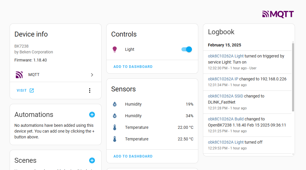

    I'm testing BK7238 NiceMCU on latest release with MQTT and it seems ok so far:
    Screenshot of OpenBK7238 interface displaying temperature and humidity data.
    User interface of a monitoring application for BK7238 device with charts of temperature and humidity, event log, and light control.
