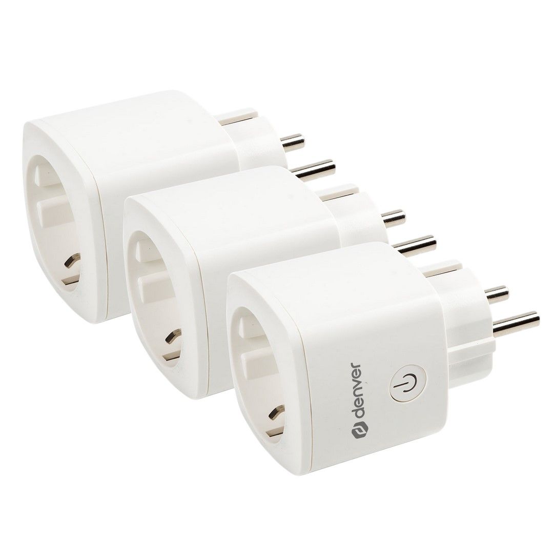

    Flashing Smart plug Denver SHP 102.
    This can be performed without opening with tuya cloudcutter.
    Unlike as in this thread: https://www.elektroda.com/rtvforum/topic3935136.html
    the Pinout is as follows:
    BL0937 SEL Pin24
    BL0937 VI (CF1) Pin 6
    BL0937 ELE (CF) Pin 7
    Button Pin 11 (Ch1)
    LED_n Pin 10 (Ch1)
    WifiLED Pin 8
    Relay Pin 26 (Ch1).
    After that you'd have to calibrate the Energy meter. I connected a 1300W Heater, and measured the mains with a voltmeter.
    There is one thing that bugs me though: The internal temperature shows a high value of some 55-65 deg Celsius. Even when it is off for a longer time.
    @p.kaczmarek2 could it be measured in an alternative way?
    Three Denver SHP 102 smart plugs arranged in a row.
