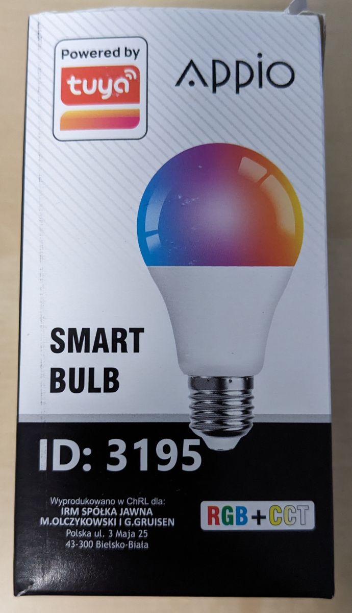

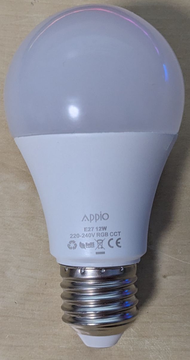

    Please have a look at this smart-bulb from Appio.
    Here is the bulb:
    Packaging of Appio smart bulb with Tuya logo and RGB+CCT label.Appio smart bulb E27 12W RGB.

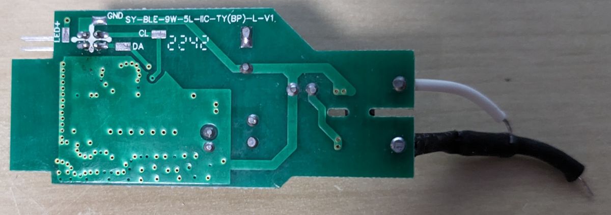

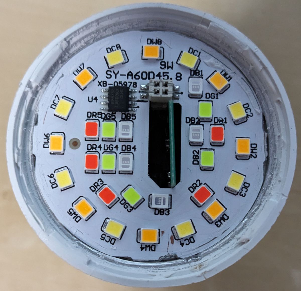

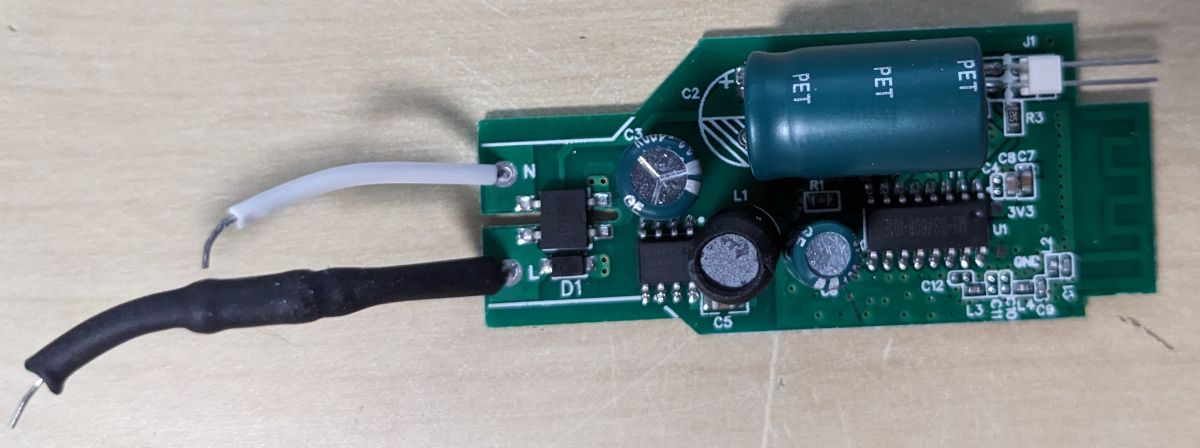

    This is the teardown:
    Close-up of the circuit board inside a smart bulb, with multi-colored LEDs and visible markings. Close-up of the electronic circuit inside an LED bulb. Printed circuit board with electronic components on a wooden background. Circuit board of an Appio smart bulb on a wooden surface.

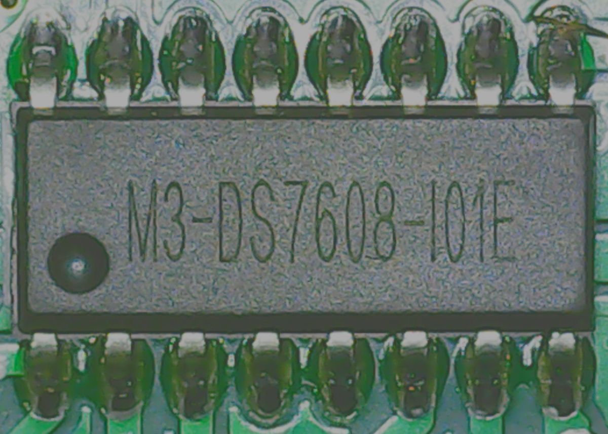

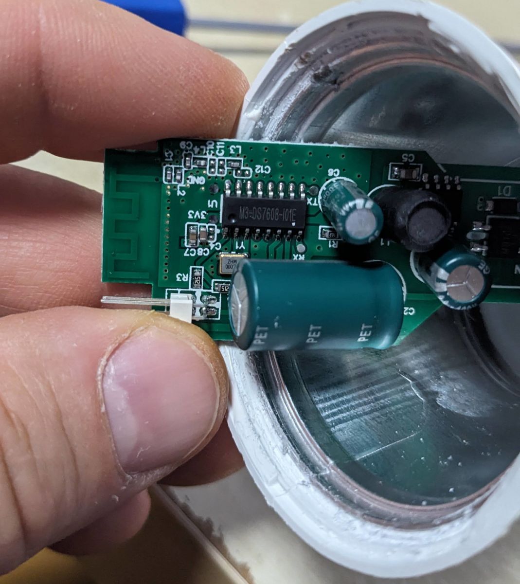

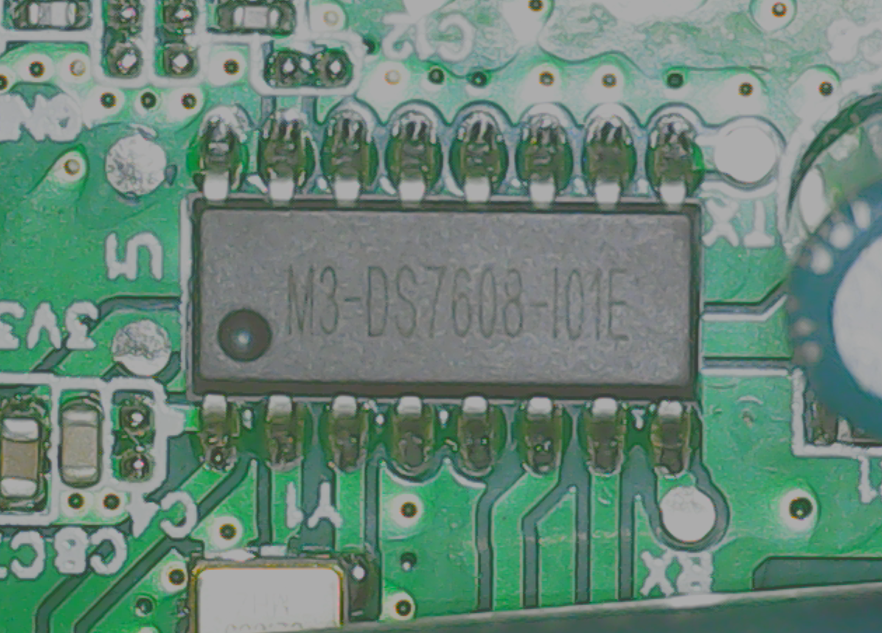

    Better photo of the chip:
    Close-up of M3-DS7608-101E chip on a circuit board.Close-up of M3-DS7608-101E chip on a circuit board.
    I've bought it hoping that I can flash it with Tasmota or OpenBeken but I'm puzzled there is no sandwich with any Tuya module.
    All the suggestions are welcome. Please consider me a hobbyist not an expert in this matter.
    Thanks for the great stuff you do with OpenBeken.

    It looks like a Bluetooth-only device. Can you check whether it really works with WiFi as well?
    Marking seems to confirm it's BT-only: SY-BLE-9W-5L-IIC-TY(BP)-L-V1
  • #3 21274629
    priva7eer
    Indeed. I didn't realize there is such a thing as a Bluetooth-only smart device. It's super-useless. Thanks for pointing that out. You saved me some searching.
