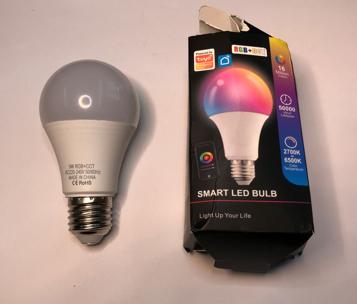

  • RGB/CCT LED bulb with packaging .
    How do you pair a Bluetooth RGB/CCT colour 'bulb' with the Tuya app? How is its interior built? Is there an inverter inside, how is the LED brightness control implemented and what is responsible for communication? This is what I will try to check here.
    I guess I have to start by saying that the term "bulb" is not very correct for such a product, but as far as I can see it is repeated in the trade and you can find this product under this name.... and so I have used it here anyway - for future searchers.
    However, the name RGB/CCT means that the product can operate in two modes - a colour selection mode from either RGB (red/green/blue, along with intermediate colours) or CCT (Correlated Colour Temperature), which is the shade of white - cold or warm white. We also necessarily have control over the brightness level.
    I bought the product from the theme in a promotion for literally PLN5 with free shipping, but you often have to pay more for it. In addition, you have to be careful when ordering, because sometimes you can get the Bluetooth version when you want the WiFi version and you do not read the name of the offer. The BT version is cheaper.
    No model name on the packaging:
    Damaged packaging of a LED bulb with a label and barcode. .
    Box of Bluetooth RGB/CCT bulb with Tuya app control .

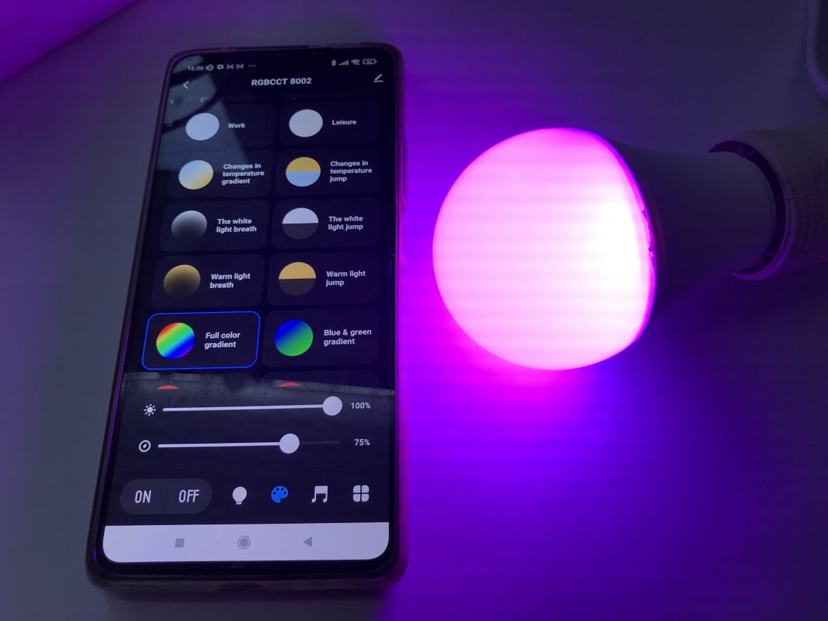

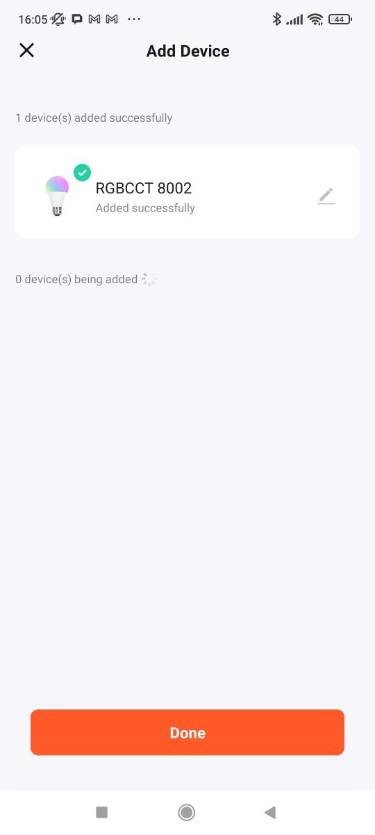

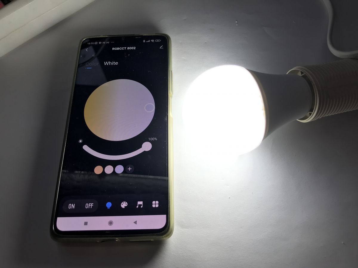

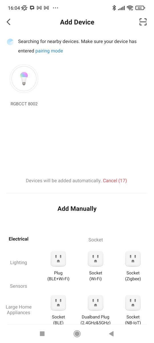

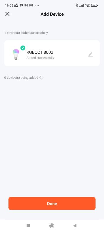

    I had the Tuya app already installed. I did not have to select a device from the list. Once Bluetooth was switched on, the app detected it by itself.
    Device addition screen in the Tuya app with a colorful RGB/CCT bulb. .
    Pairing was seamless:
    Tuya app screen showing successful addition of RGB CCT 8002 device. .

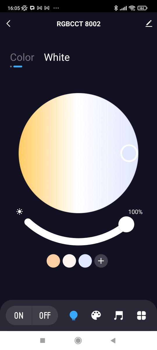

    The control panel took several seconds to load, but eventually loaded without problems and everything started working.
    Tuya app interface for controlling RGB/CCT bulb.

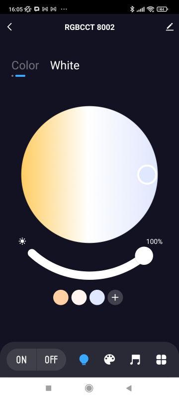

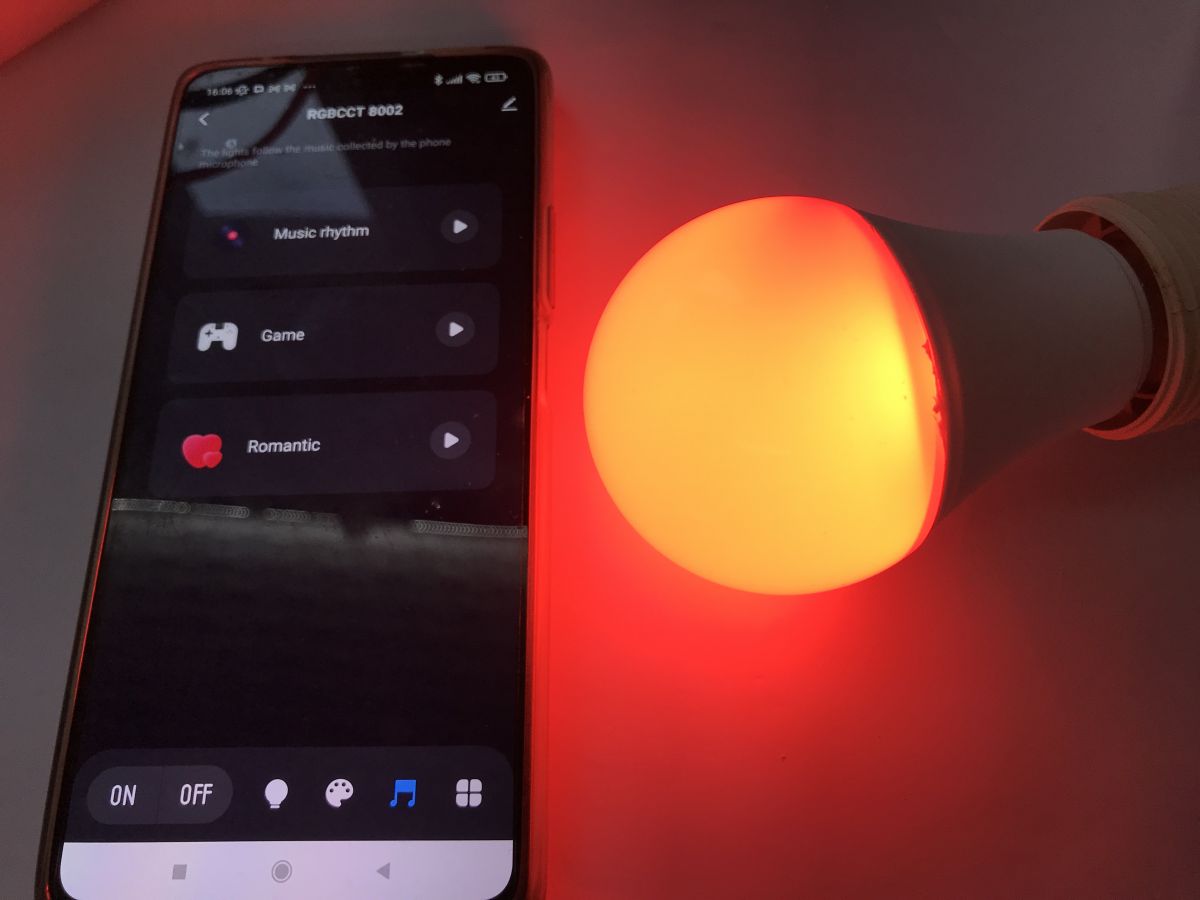

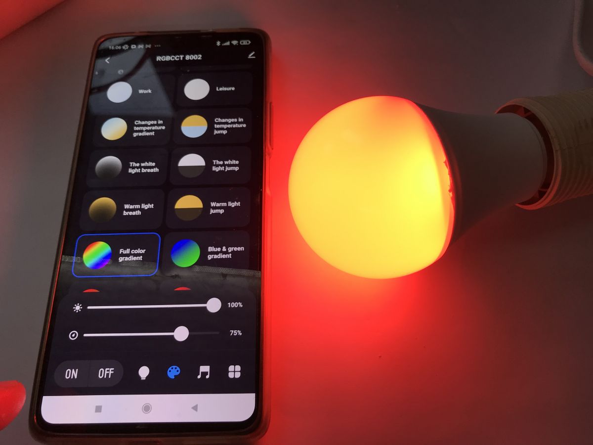

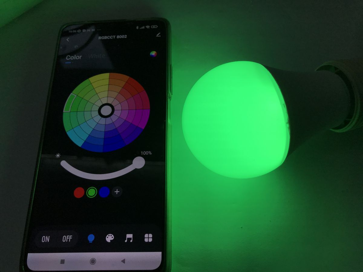

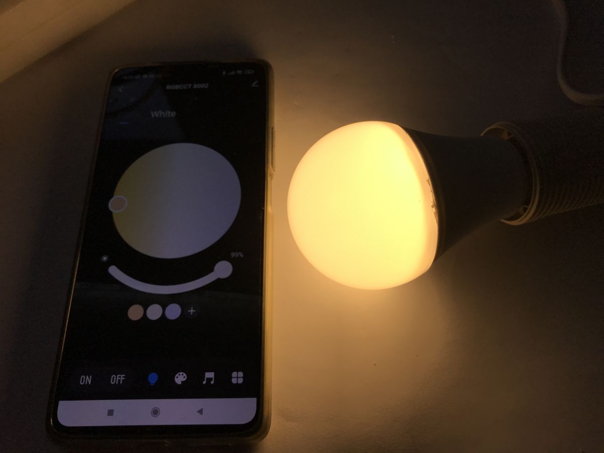

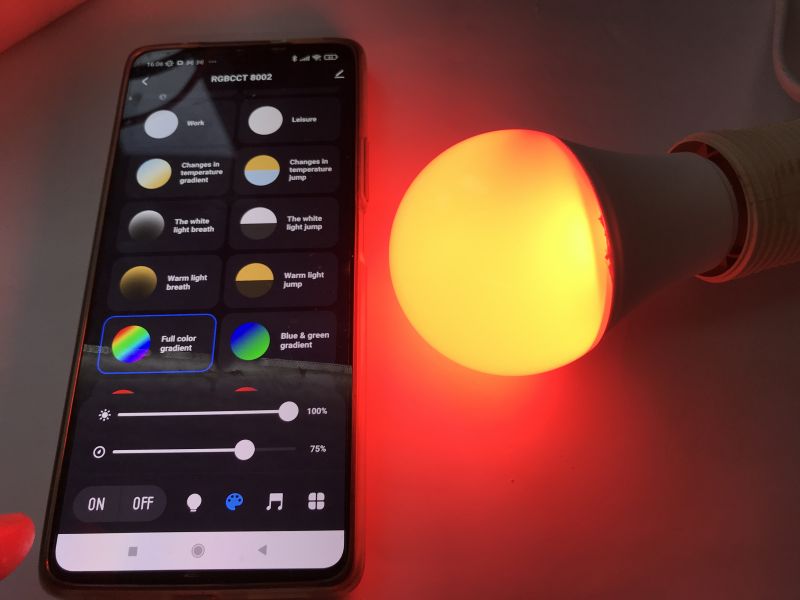

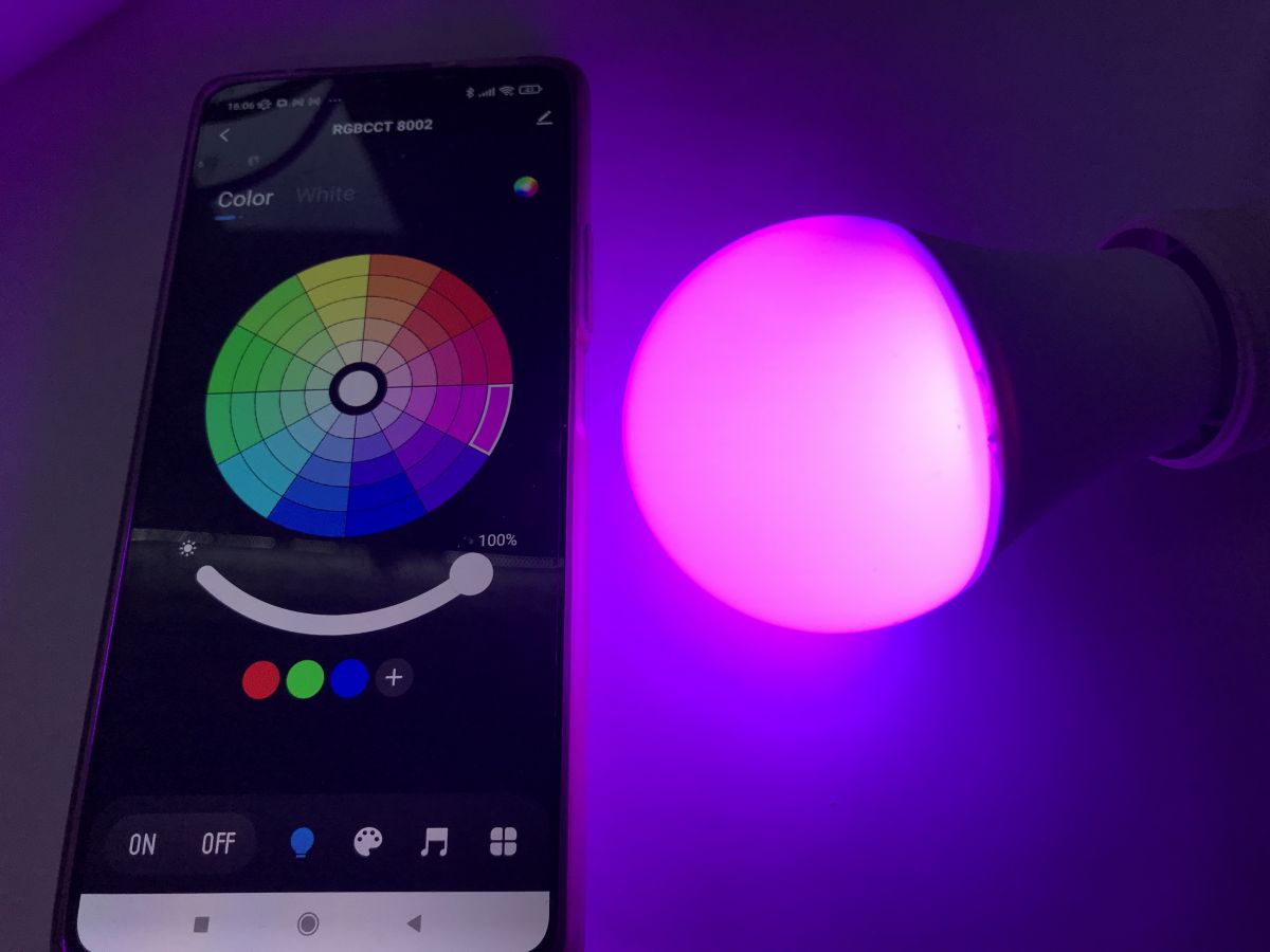

    The application offers multiple modes of operation. You can simply set a fixed colour or white tint, and of course you also have control over the brightness level. Another option is to select one of the many different animations, as well as to enable operation to the rhythm of music from the phone. The product itself does not have a microphone on board.
    RGB/CCT LED bulb glowing red next to a smartphone with the Tuya app. .
    Smartphone with Tuya app next to an illuminated Bluetooth RGB/CCT bulb. .
    LED bulb controlled by the Tuya app on a smartphone. .
    Smartphone with an app controlling a colorful LED bulb glowing purple. .
    Smartphone with Tuya app next to a colorful RGB/CCT LED bulb .
    Smartphone with Tuya app and glowing green RGB/CCT LED bulb. .
    Phone with Tuya app paired with a colorful RGB/CCT bulb glowing pink. .

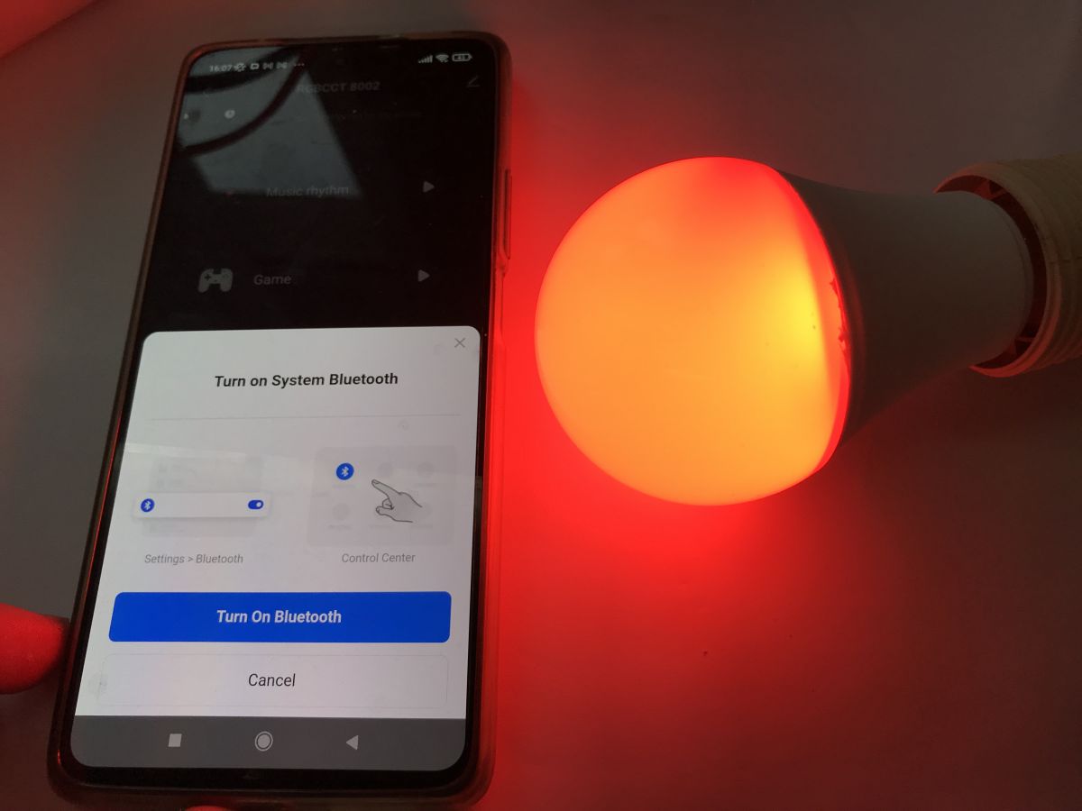

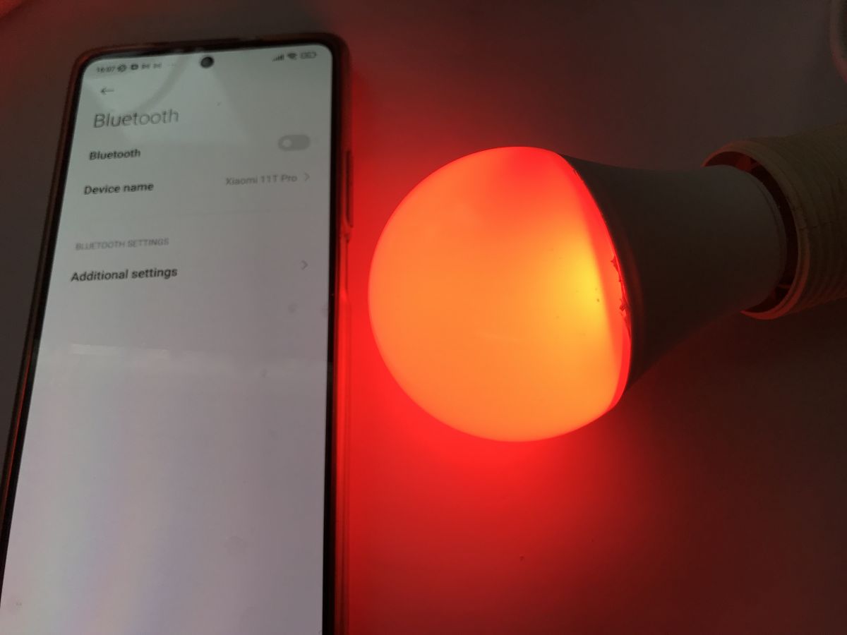

    The only thing to remember is that the moment you switch off BT you will lose control and the app will notify you:

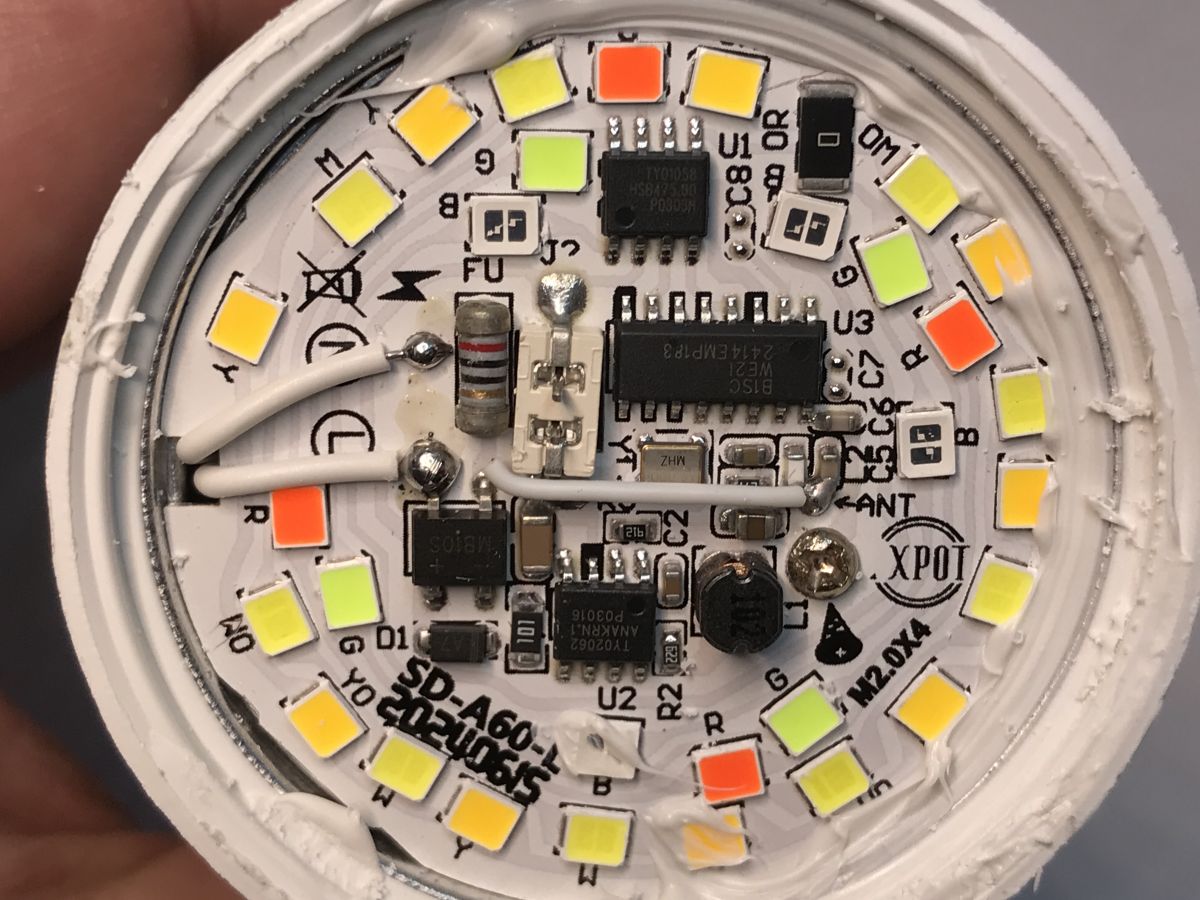

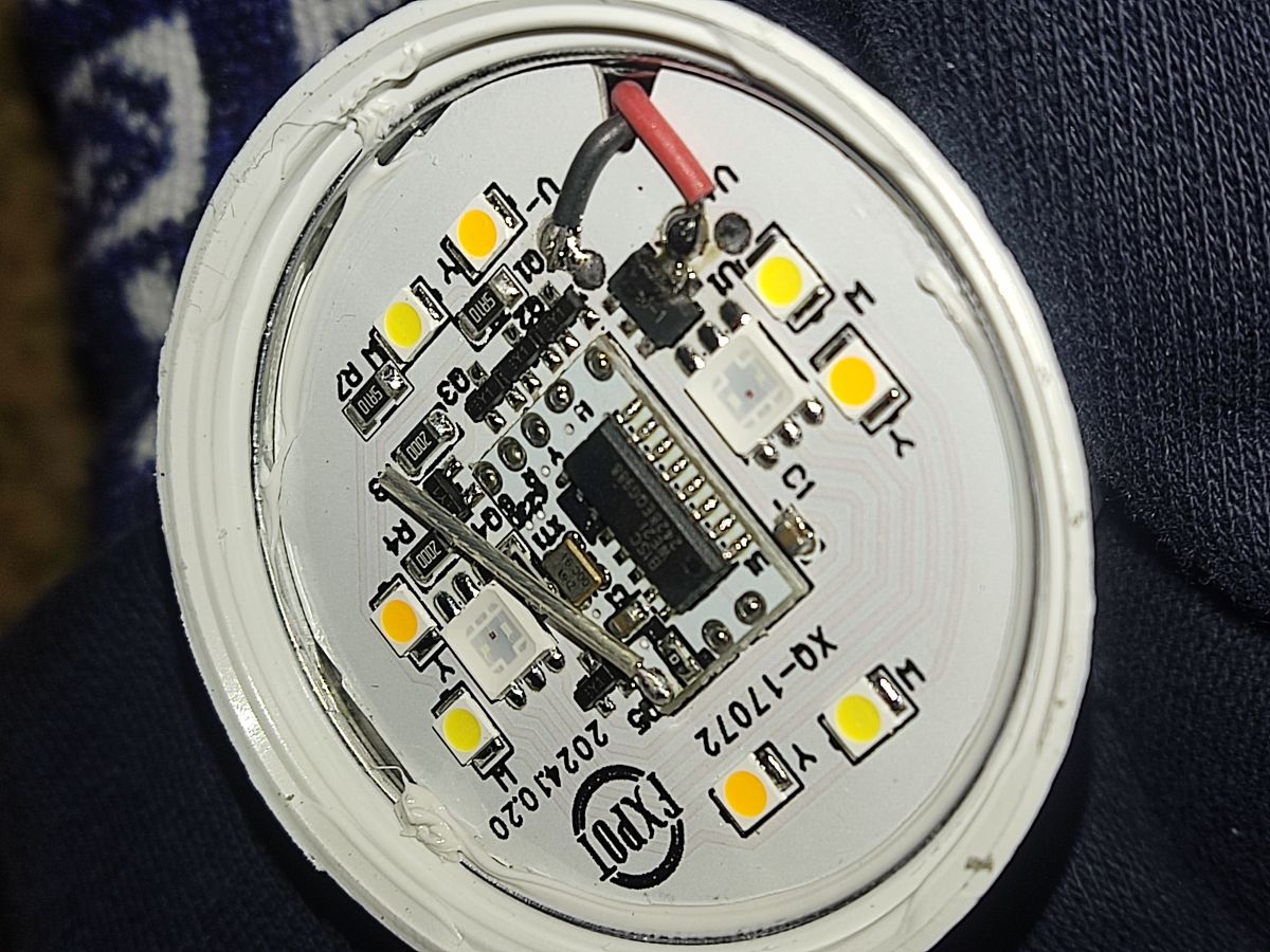

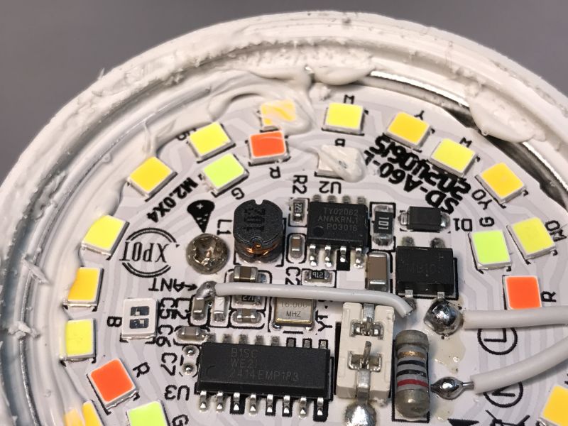

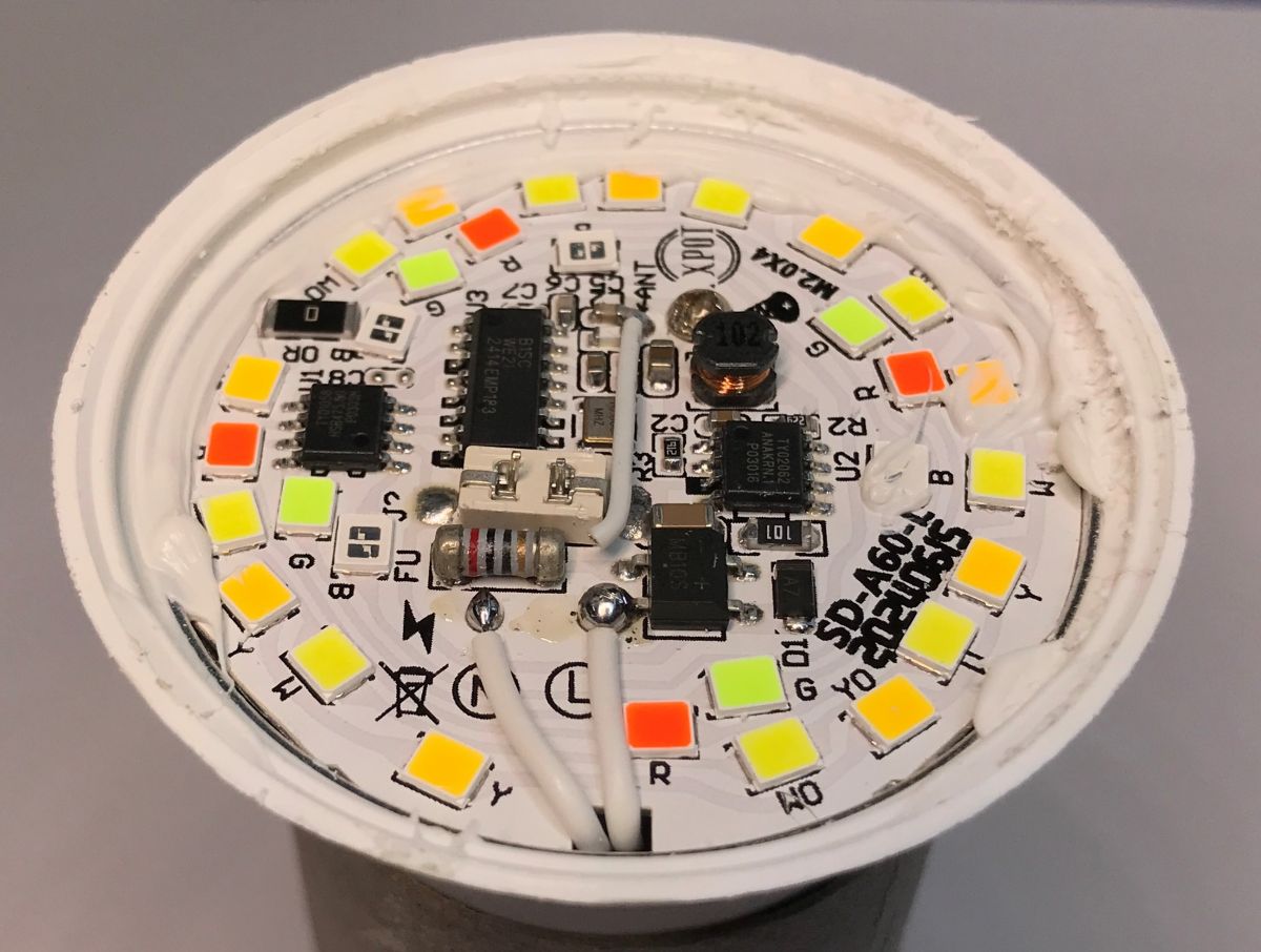

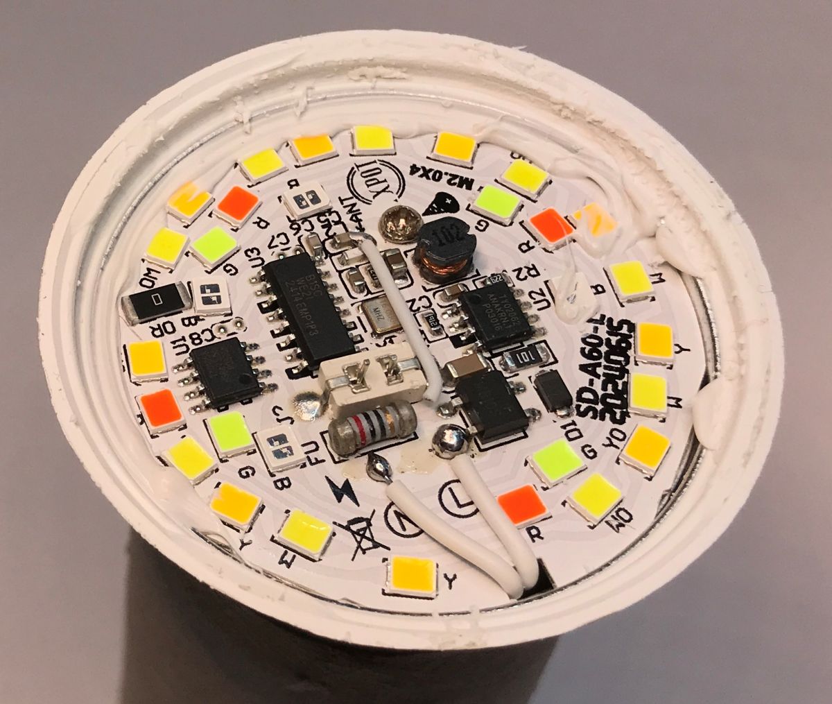

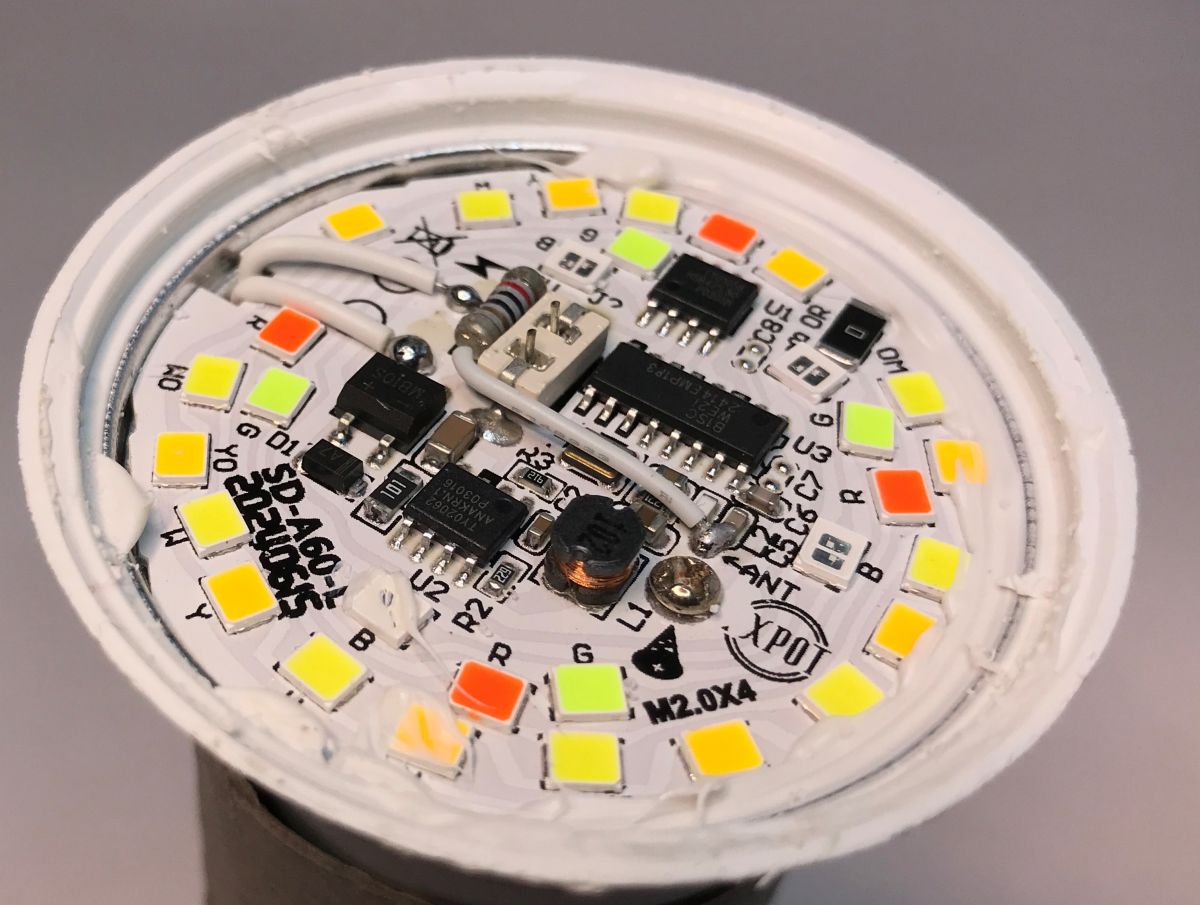

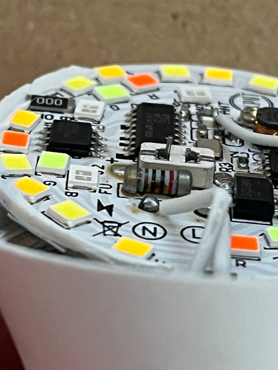

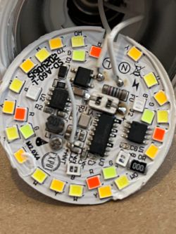

    All that remains is to look inside. The bubble can be removed with the bare hand, it's plastic, barely holding on:
    PCB of an RGB/CCT LED bulb with visible diodes and electronic components. .
    Interior of an RGB/CCT smart bulb with visible LEDs and electronic components .
    Close-up of the interior of an RGB/CCT LED bulb showing LEDs and integrated circuits. .
    Interior of a smart LED bulb showing electronic circuits and components. .
    Interior of a Bluetooth RGB/CCT bulb with visible circuits and LED lights. .
    Internal structure of Bluetooth RGB/CCT LED bulb .
    Interior of a Bluetooth RGB/CCT LED bulb showing electronic circuitry. .
    Interior of a colorful RGB/CCT LED bulb with visible diodes and electronic components. .

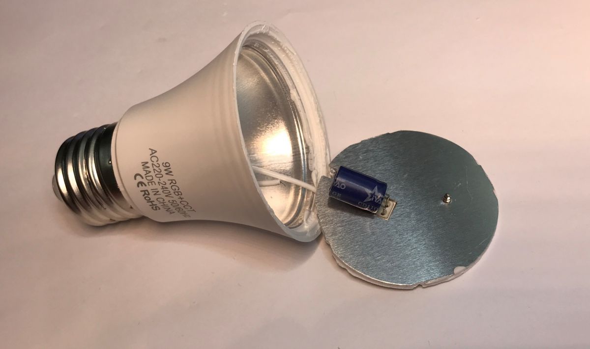

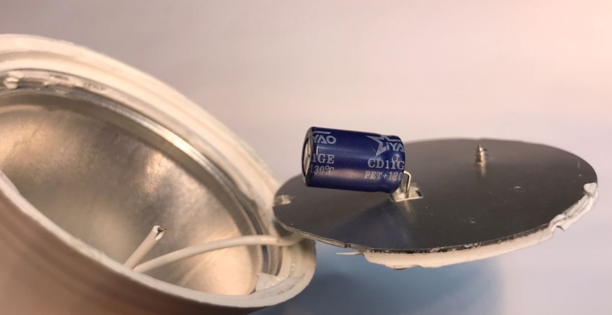

    Is there anything more under the tile?
    Dismantled RGB/CCT LED bulb with visible circuit board and capacitor.

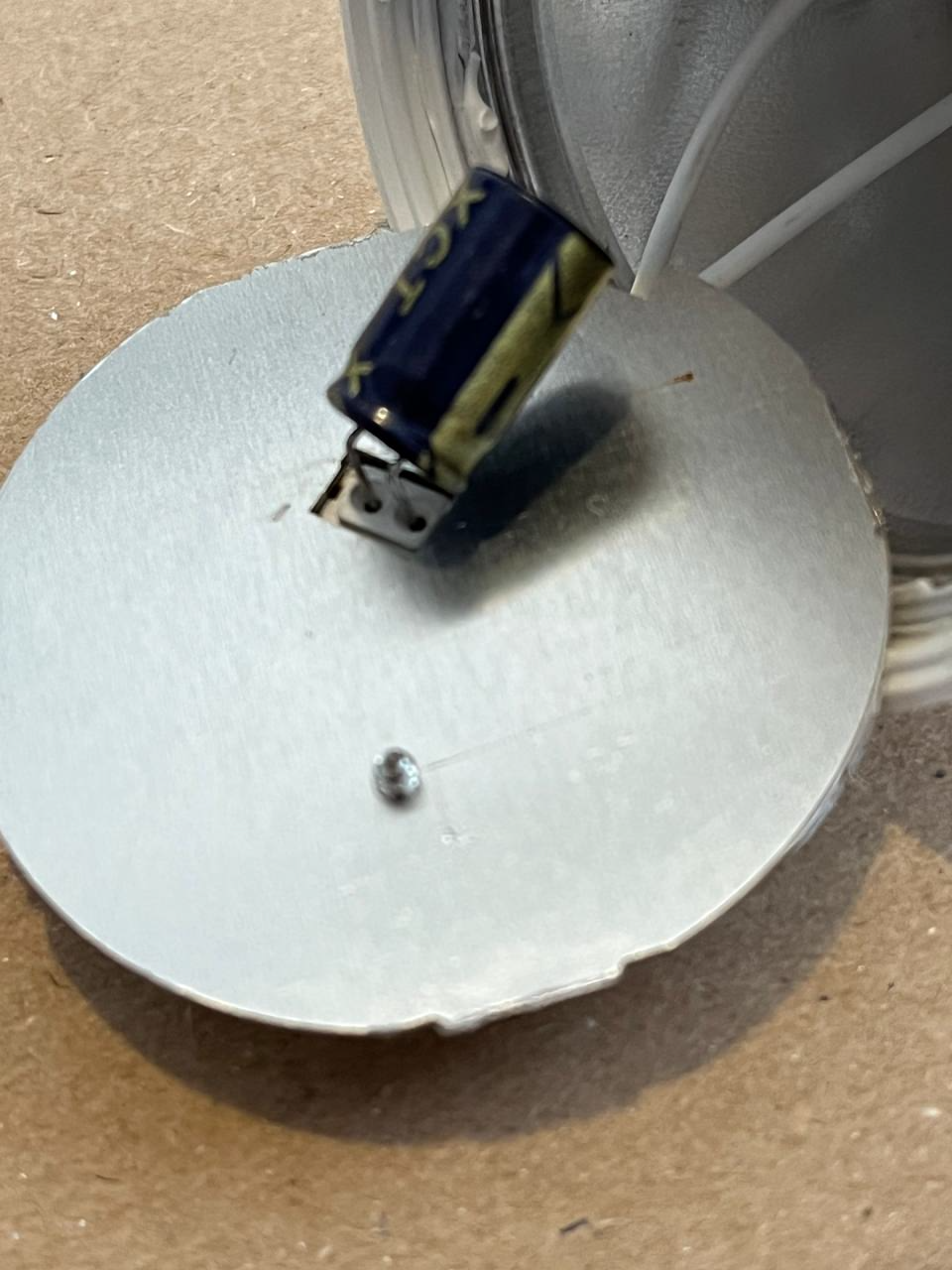

    Open part of a colorful Bluetooth RGB/CCT bulb showing a capacitor and internal electronics. .

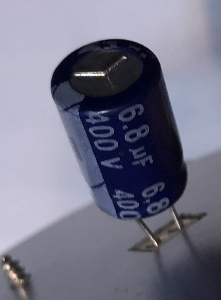

    The underside of the board is a poor heatsink and serves to dissipate heat.
    6.8 µF 400 V electrolytic capacitor on a circuit board. .

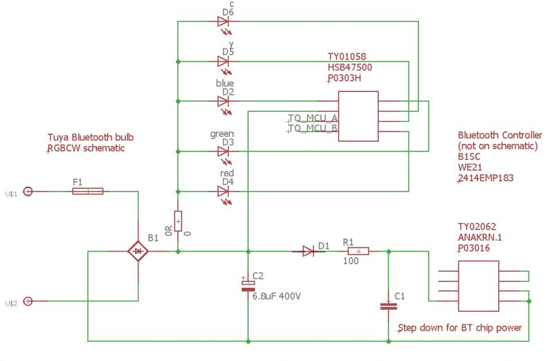

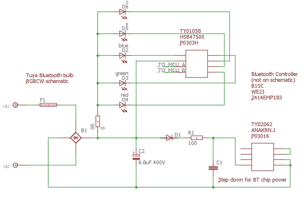

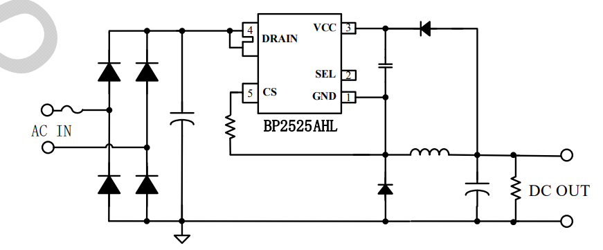

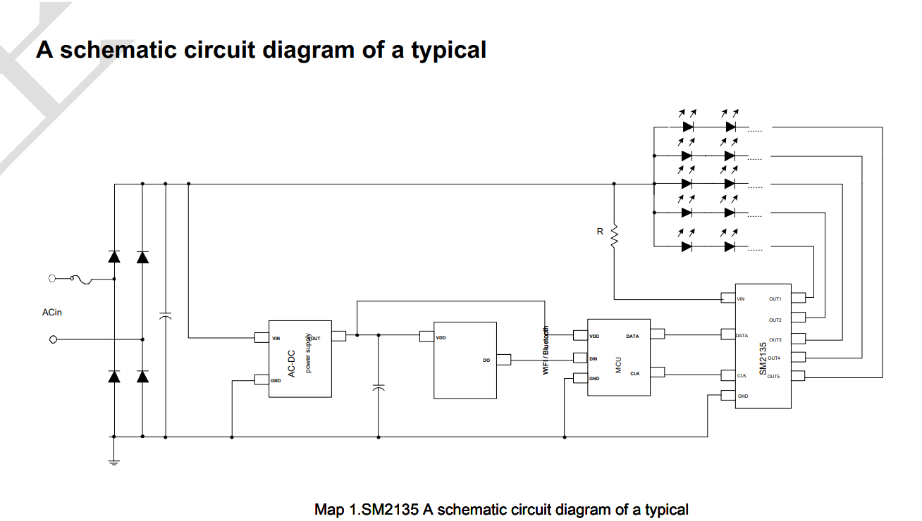

    The capacitor itself ... I have sketched a schematic based on the board:
    Schematic diagram of Bluetooth RGB/CCT bulb .
    In my sketch there are single diodes, but in practice there are many in series. If one burns out, the whole chain goes out.

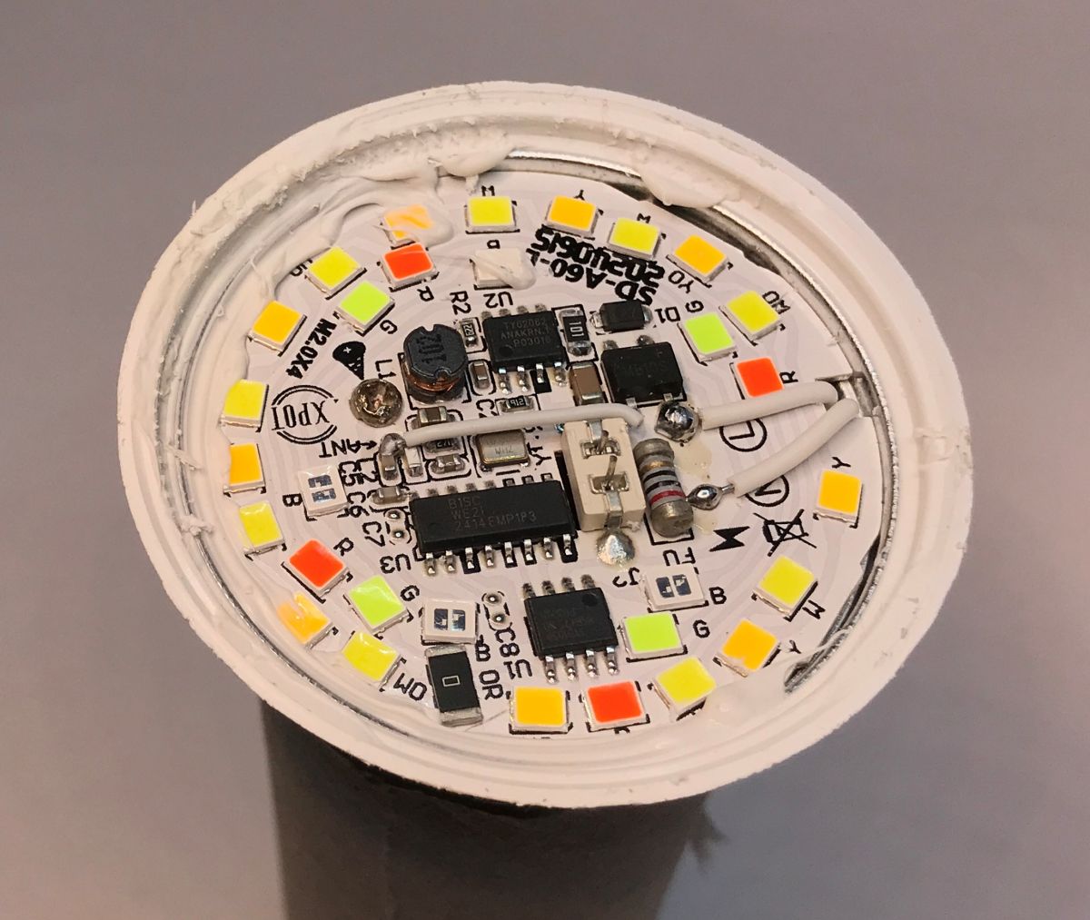

    The circuit here is different from the older LEDs. There is no transformerless power supply based on a simple circuit with a capacitor. Here we have first a fuse, a bridge rectifier, a 6.8uF electrolytic capacitor and then separately there is a small step-down inverter used to power the Bluetooth controller circuit. I didn't draw it fully in the schematic, but I suspect it's something like a BP2525:
    Electrical schematic with BP2525AHL circuit. .
    The distinctive coil from the circuit can be seen in the photos, although I have not applied it to the schematic.

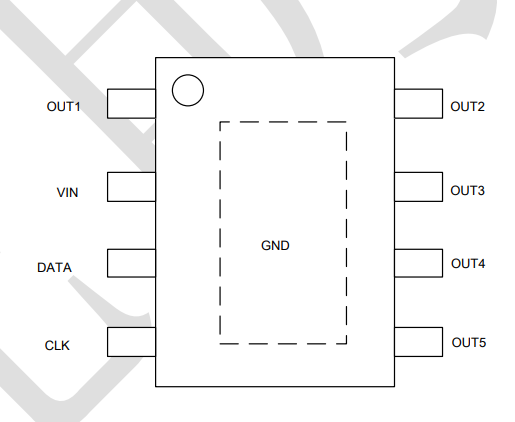

    Next to it, in turn, we have a separate circuit that controls the LEDs. We have 5 types of LED: R G B C W, and this circuit has 8 pins. This leaves three pins, one of which I have identified as the power supply and the other two as the control signal from the circuit from Bluetooth. This is reminiscent of a constant-current SM2235 or SM2135. It may even be that the control is implemented similarly, i.e. an I2C-like protocol based on clock and data lines.
    Block diagram of an RGB/CCT bulb with Bluetooth and AC-DC power supply. .
    All in all, there is also a ninth "leg" here - or rather pad:
    Diagram of an LED controller with labeled pins. .

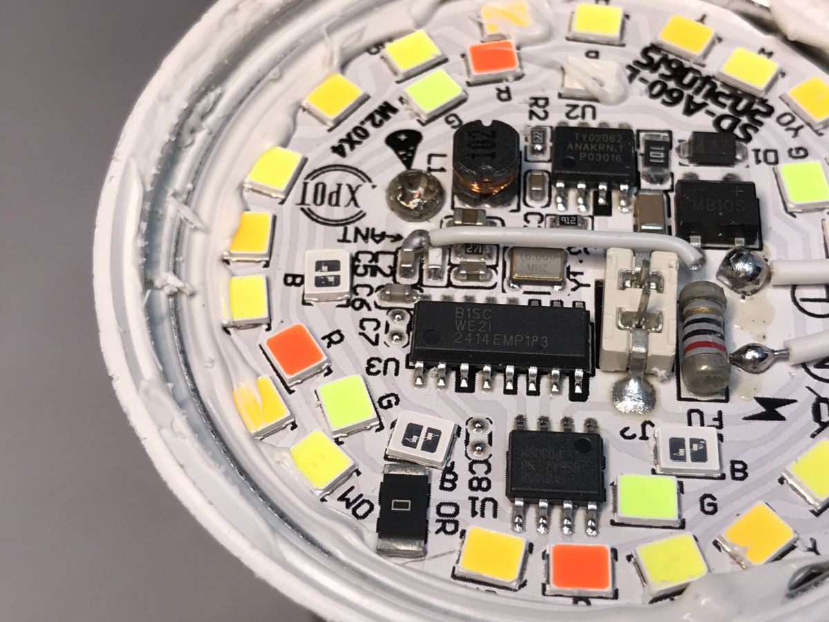

    Well, and that's basically it. I'll quote the component designations some more.
    LED controller: TY01058
    HSB47500
    P0303H
    Low-voltage power supply:
    TY02062
    ANAKRN.1
    P03016
    BT controller:
    B1SC
    WE21
    2414EMP183
    A search by BT controller designation brings us.... back to Elektroda:
    https://www.elektroda.com/rtvforum/topic4088853.html
    Does anyone know anything more about these chips?
    The TY in the name suggests to me that this is something manufactured for Tuya?

    I have exactly the same bulb and after a day of use it just blew out. There was a slight bang and as I was changing it it was very hot.
    You can even see traces of the explosion on the PCB, I think the fuse just tripped (FU). Maybe it's a thermal fuse.

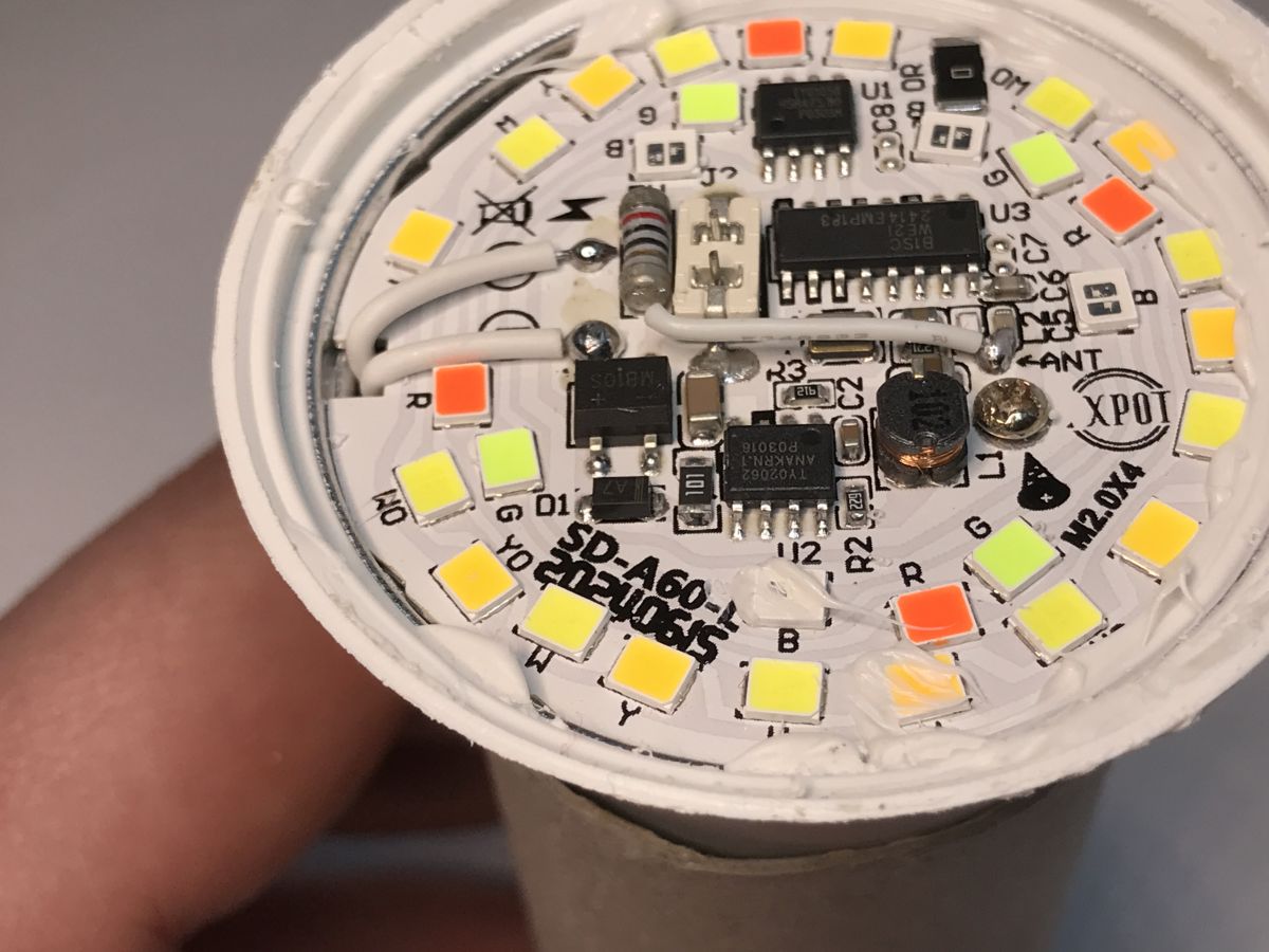

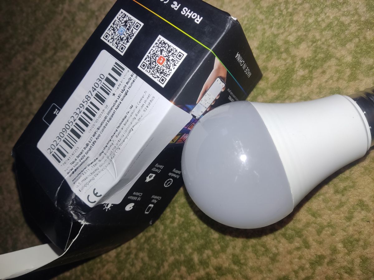

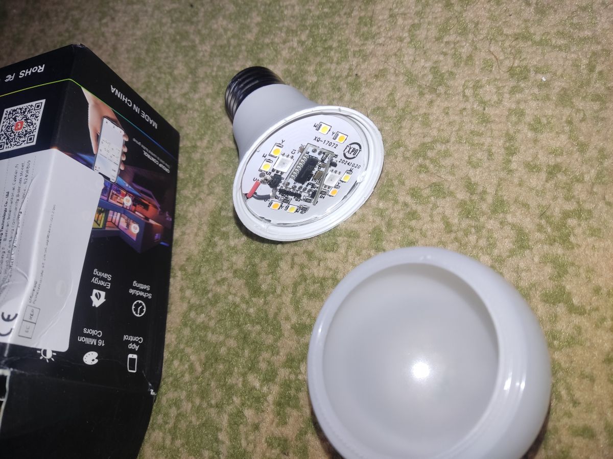

    I bought this bulb by mistake and it was supposed to be wifi.
    LED bulb and damaged box on a carpet background. .
    Disassembled LED bulb with packaging on carpet. .
    Close-up of the inside of an LED bulb with visible diodes and electronic components on a circuit board. .
    It is slightly different on the casing there is no manufacturer information. The scalak from the bluetooth is on a separate board.
