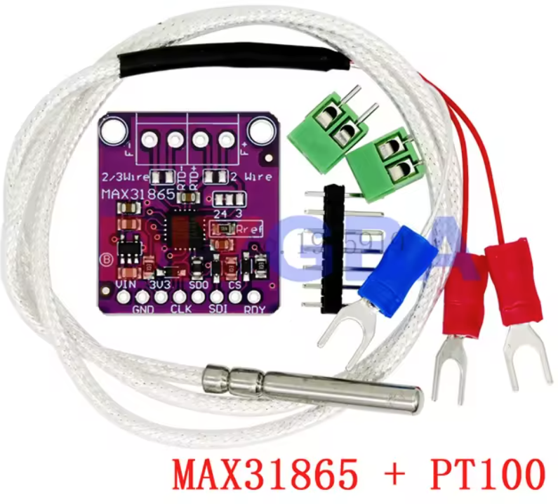

    I'm thinking of upgrading my home oven with support for remote temperature reading (and notification when the oven is hot, for example) using a K-type thermocouple.
    I noticed that Tasmota ( Link ) in the sensors compilation supports a module with the MAX31865 chip together with a PT100 thermocouple ( Link ).
    MAX31865 module with PT100 thermocouple and mounting components. .
    I've looked in your WiKi, documentation and on Eletrod but found no mention of support for this layout.

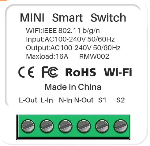

    For budget purposes, I would use the cheapest module with Beken chips etc.
    Mini Smart Switch with WiFi technology and ports for electrical connections. .
    and I would solder the wires there to the MAX31865 :) .
    Unless you know of another cheaper solution for temperature measurement 0-250℃ ?
    Could you add thermocouple support via the MAX31865?

    I can try to make a port of some library to the MAX31865, you would then have to help with the tests, but you can also look here:
    Configuring OpenBeken for hot air testing - MAX6675, temperature and power logging .
    The MAX6675 is supported.
