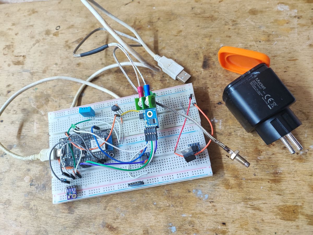

    Here I will show my setup for testing hot air stations - two OpenBeken devices, first used to measure hot air temperature with MAX6675, and second used to measure power - both reporting measurements to my HTTP server, so I can use them for futher processing. Of course, my setup was made on stock OpenBeken with no hardcoding - all reporting is done by scripts. So, let's see how I scripted them.
    First device - my WB3S dev board - MAX6675 temperature measurement

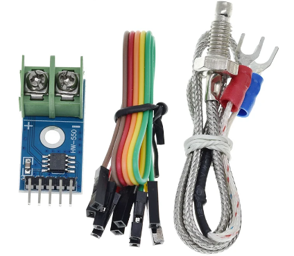

    MAX6675 can measure very high temperatures and is actually very easy to use - it can be attached to any three GPIOs. MAX6675 is using SPI protocol, but in this case SPI transaction is very simple and requires only reading just a single 16-bit word.
    K-type thermocouple with MAX6675 A/D converter module, kit.
    So, in this case, any OBK device could be easily used.

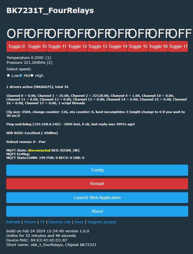

    Here is a screenshot from my panel, and I know, it's very messy, most of the stuff is not related to this project:
    Screenshot of the BK7231T_FourRelays user panel.
    The more important part is in autoexec.bat in LittleFS, see here how to make one:
    Here is my script:
    startDriver MAX6675 24 26 6 1
    again:
    SendGET http://192.168.0.169:8002/log.php?temperature=$CH1
    delay_s 0.5
    goto again
    Let's break down what happens here:
    - first you have MAX6675 init and pins setup, the syntax is:
    MAX6675 CS CLK MISO targetChannel
    - then you have a loop, every 0.5s the temperature is sent (to be more precise, channel 1 value) to my custom HTTP server, where a log.php script processes it futher

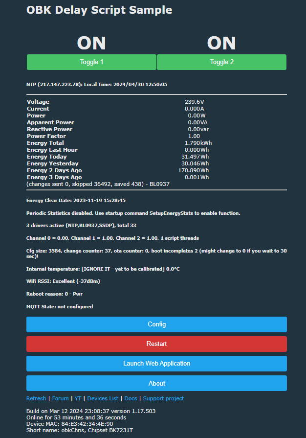

    Second device - Mycket Power Metering Socket - power measurement
    Here is some information on the second device I used:
    Mycket Smart Outdoor Socket PE-01E IP44 with energy measurement
    Screenshot of the OBK delay script panel with measurement data.
    However, any power-measuring socket should be good for this purpose.
    My script here is sending voltage/current/power measurements to my script every 0.5 seconds:
