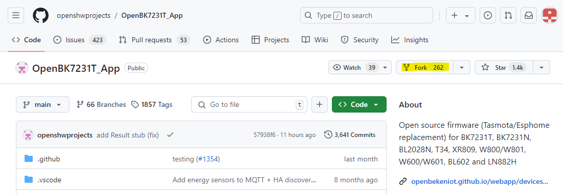

    -Register for a GitHub account and login

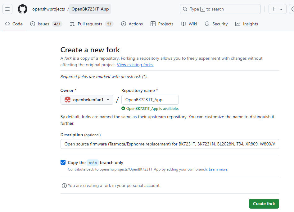

    -Navigate to https://github.com/openshwprojects/OpenBK7231T_App and create your own fork of the main app
    GitHub interface for the OpenBK7231T_App repository
    -Customize your fork name or stick with the original
    GitHub screen for creating a fork of the OpenBK7231T_App repository.

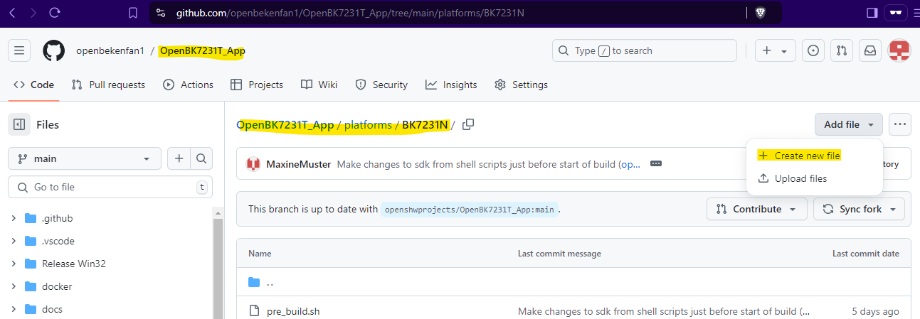

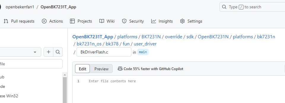

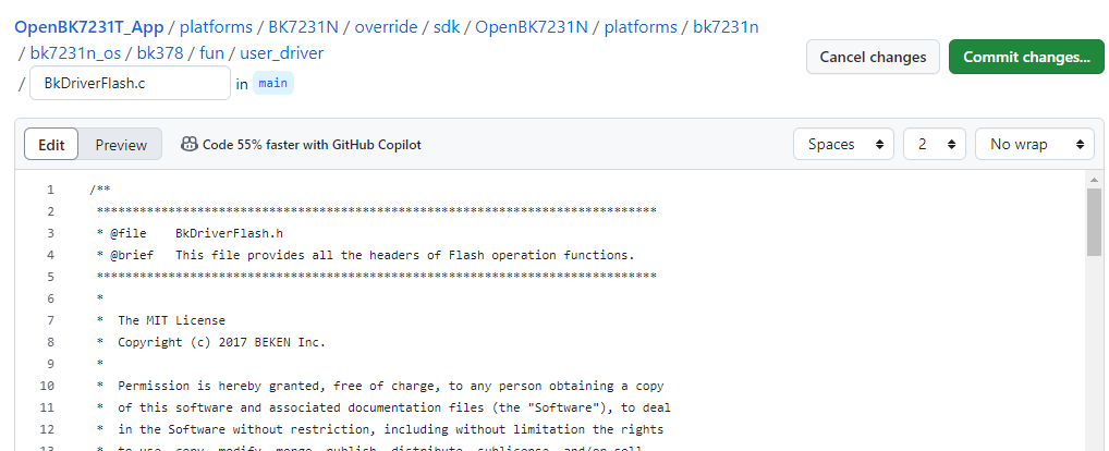

    -In your fork navigate to the platforms folder then BK7231N
    -Click Add file -> Create new file
    Screenshot showing the GitHub interface on the OpenBK7231T_App page with the Create new file option selected.
    -Type "override/" then the name of each folder of the rest of the submodule path followed by a "/" until you get the empty file to create - "BkDriverFlash.c" in this case.
    Eventually you'll have created this path and file sdk/OpenBK7231N/platforms/bk7231n/bk7231n_os/beken378/func/user_driver/BkDriverFlash.c under OpenBK7231T_App/platforms/BK7231N (Note: I missed the c in "func" in my screenshots - so imagine it's there!)
    Screenshot of a GitHub repository with file editing view.

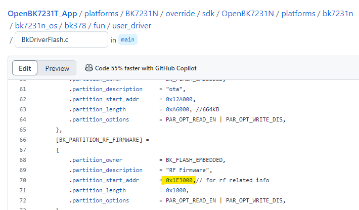

    -Copy the raw content of the real BkDriverFlash.c from the submodule location into the empty file space just created -
    GitHub editor interface displaying the BkDriverFlash.c file.

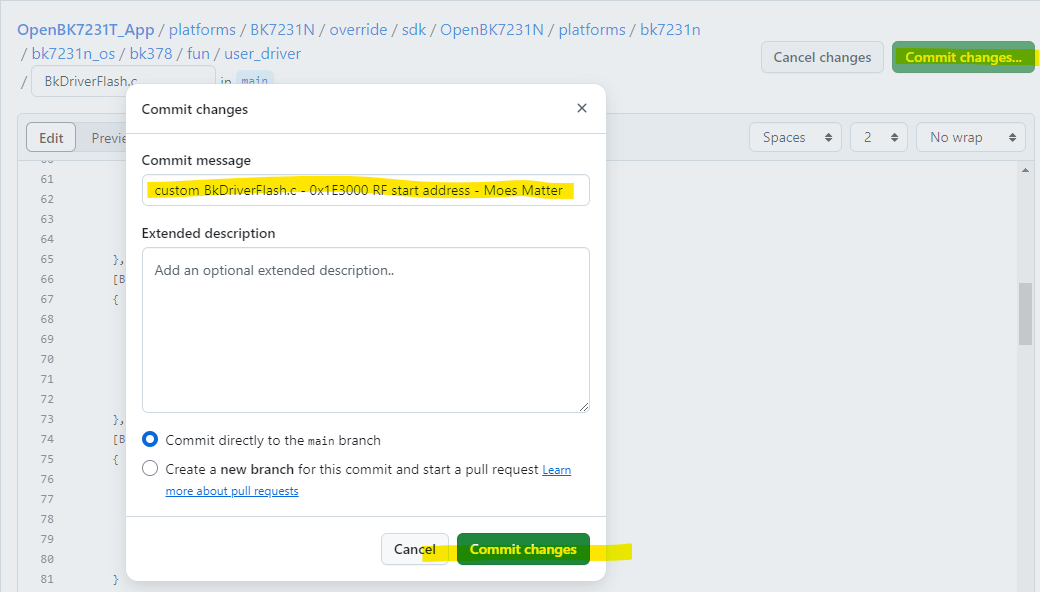

    -Make the required changes to the content of the file - in this case we're changing the start address of the BK_PARTITION_RF_FIRMWARE from 0x1D0000 to 0x1E3000
    Code snippet in a GitHub repository with a new partition start address.

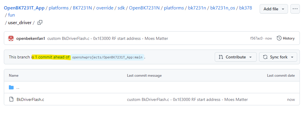

    -Commit your changes, giving your commit a short meaningful descriptive name
    Commit changes window on GitHub with message and Commit changes button highlighted.
    You'll see that your file is created and your main branch is 1 commit ahead of the base repository.
    Screenshot of the GitHub repository OpenBK7231T_App showing the BkDriverFlash.c file

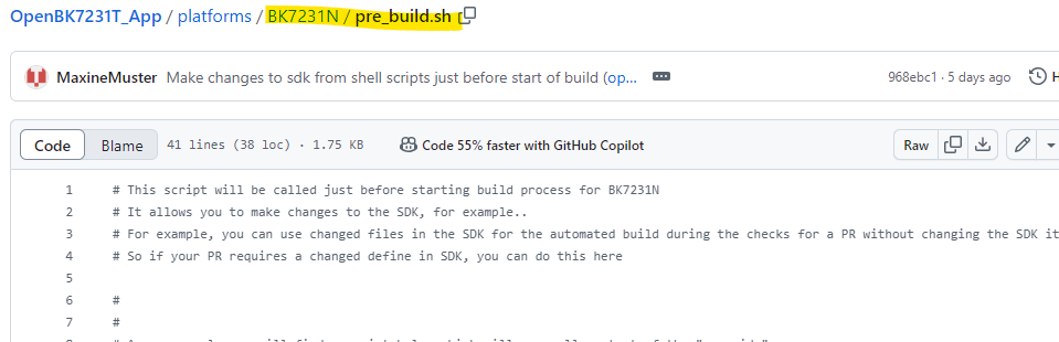

    -Navigate back up to BK7231N folder and open the prebuild.sh file
    Screenshot of pre_build.sh file in GitHub repository
    -Edit this file by clicking the pencil icon on the right and then uncomment (remove the "#" from the beginning of) lines 11, 12, 14, 15, 16, 17, 19, 23, 25, 26, 27 and 29 and click "commit changes...". Use default or set custom commit message for this change.

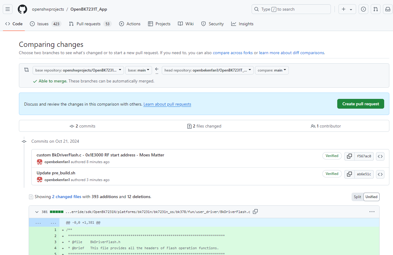

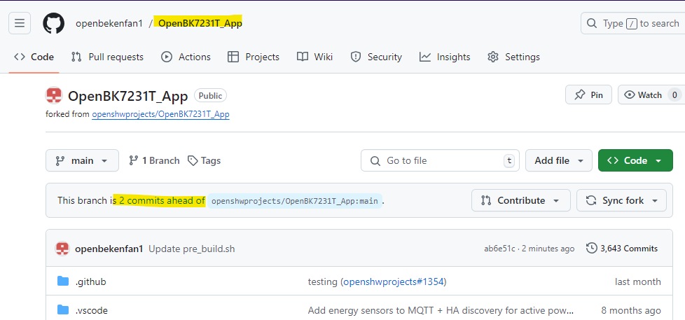

    -navigate to the root of your fork and you'll see you're now 2 commits ahead of the base repo. The "2 commits ahead" link is clickable where you'll see a summary of your changes
    Screenshot of the OpenBK7231T_App GitHub repository showing the main branch view. Screenshot of comparing changes in OpenBK7231T_App code on GitHub.

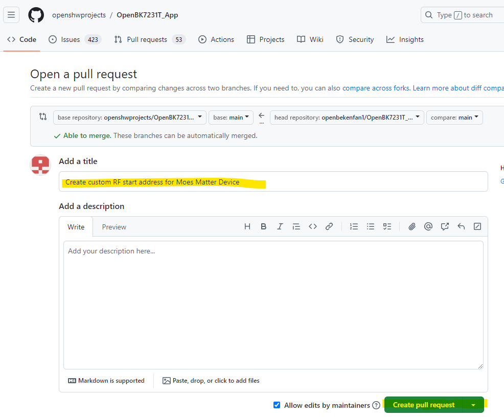

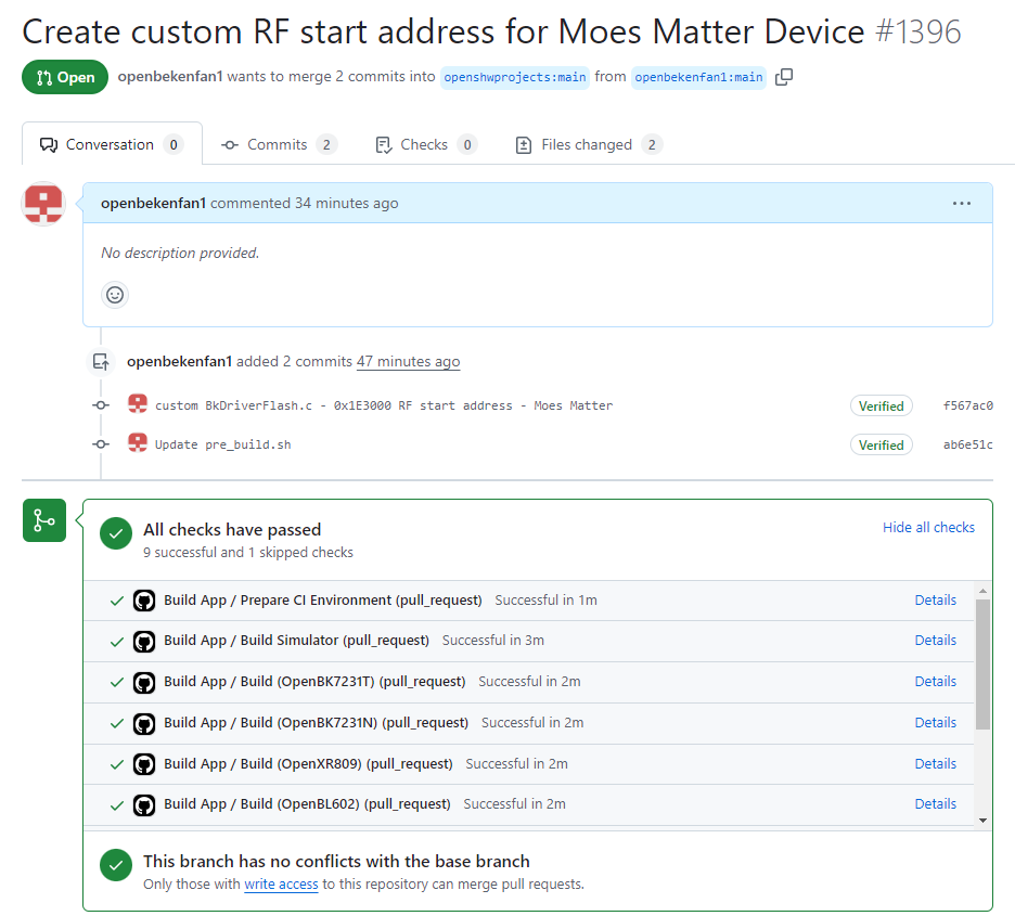

    -Create a pull request to the base repository. Give it a decent title, description optional, and finally submit the PR with "Create pull request" at the bottom
    Screenshot of a pull request creation form on GitHub for the OpenBK7231T_App project.

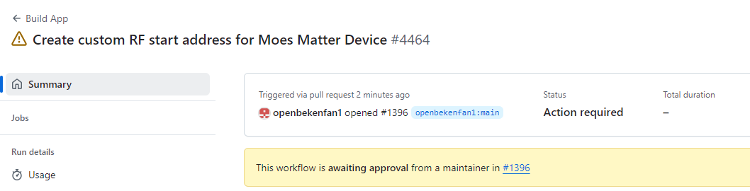

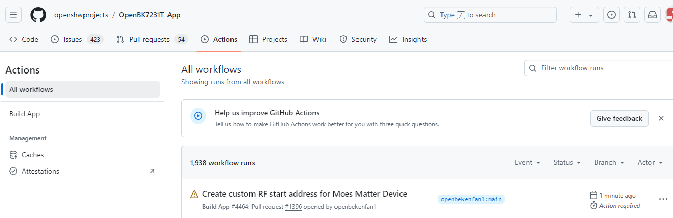

    -If this is your first PR then you'll have to wait for the administrator to approve the build. You'll see your PR listed in here https://github.com/openshwprojects/OpenBK7231T_App/pulls and the build paused under Actions https://github.com/openshwprojects/OpenBK7231T_App/actions
    Screenshot showing the GitHub Actions page for the OpenBK7231T_App project.
    Screenshot of a pending GitHub workflow approval.
    -Once approved, the build will run and if all is well, successfully.
    Screenshot from GitHub showing a pull request with all tests successfully passed.

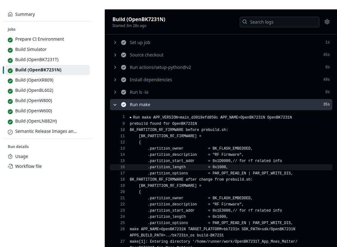

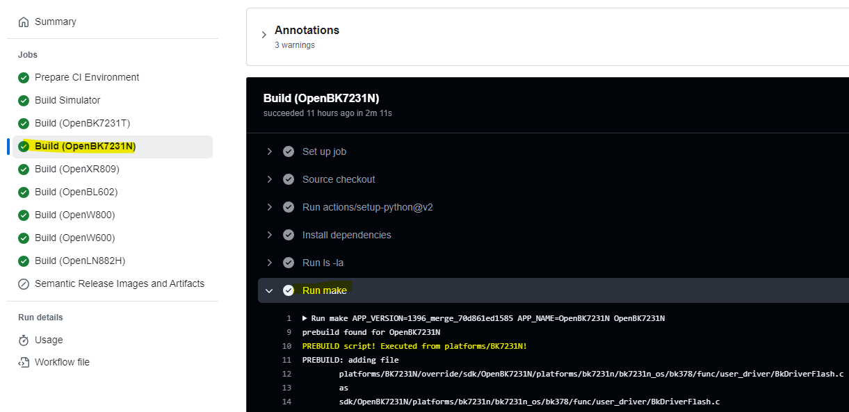

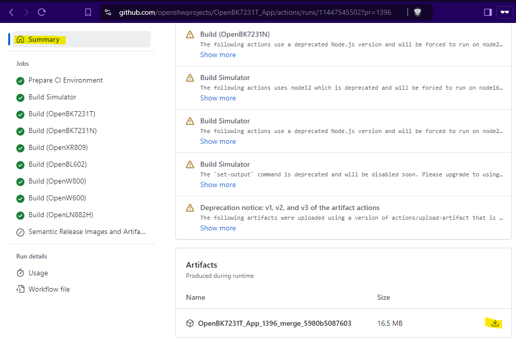

    -Review the status of the override script success by expanding Build (platform you made changes to) -> Run make
    Build screen of the OpenBK7231N project showing the execution steps of the process.
    Example success:
    To get to your binaries click one of the blue "Details" links and navigate to the bottom of the "Summary" page

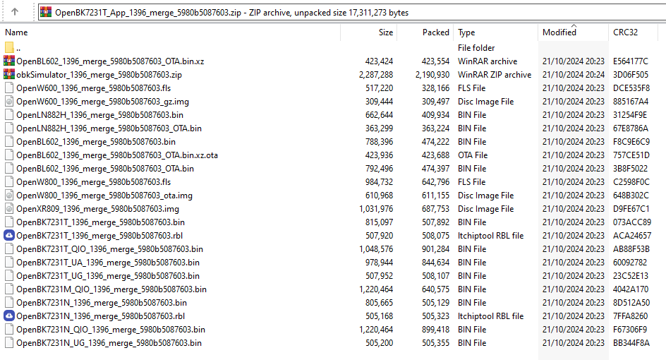

    The zip file will contain all platform binaries even though your changes are only effective in the platform to which a change was made - BK7231N in this case
    Screenshot showing the contents of a ZIP archive with various binary files and disk images.
    Your custom firmware is ready to be OTA or UART flashed to your device.

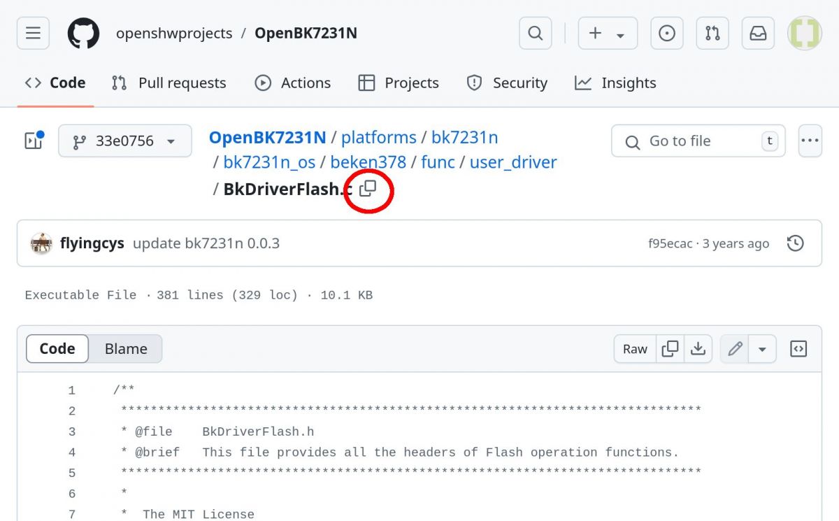

    So the first challenge is to get the path to the code file you want to change.
    My proposal is to navigate to this file in the git tree.
    There you use the "copy path" and have it in your clipboard (relative to the SDKs home):
    Screenshot of a GitHub repository for the BkDriverFlash.c file in the OpenBK7231N project.
    we only need to prepend the rest of the path from App-directory to the sdk to get the final path:
    Alternatively you can simply copy the path from the browser URL and remove the unneded part.

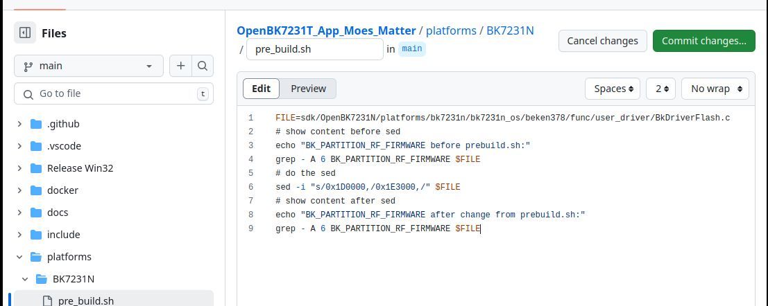

    we combine this with the sed to a simple script (and add some output, just to check what we have done):
    FILE=sdk/OpenBK7231N/platforms/bk7231n/bk7231n_os/beken378/func/user_driver/BkDriverFlash.c
    # show content before sed
    echo "BK_PARTITION_RF_FIRMWARE before prebuild.sh:"
    grep -A 6 BK_PARTITION_RF_FIRMWARE $FILE
    # do the sed
    sed -i "s/0x1D0000,/0x1E3000,/" $FILE
    # show content after sed
    echo "BK_PARTITION_RF_FIRMWARE after change from prebuild.sh:"
    As I said, this is a special case, we know the replacement of all values will only change the single line.
    But in a more general approach we could combine the replacement with a "range" or even a line inside the file to make sure, we only change the value(s) we want to be changed.
    In this case we see the line to change is line 70, so we can use this sed command to only replace this line
    If we don't need the file path several times, we could also combine it to a single line:
    sed -i "70 s/0x1D0000,/0x1E3000,/" sdk/OpenBK7231N/platforms/bk7231n/bk7231n_os/beken378/func/user_driver/BkDriverFlash.c
    This line is the minimum needed in the script to make this approach work, everything else is comment or debug output.

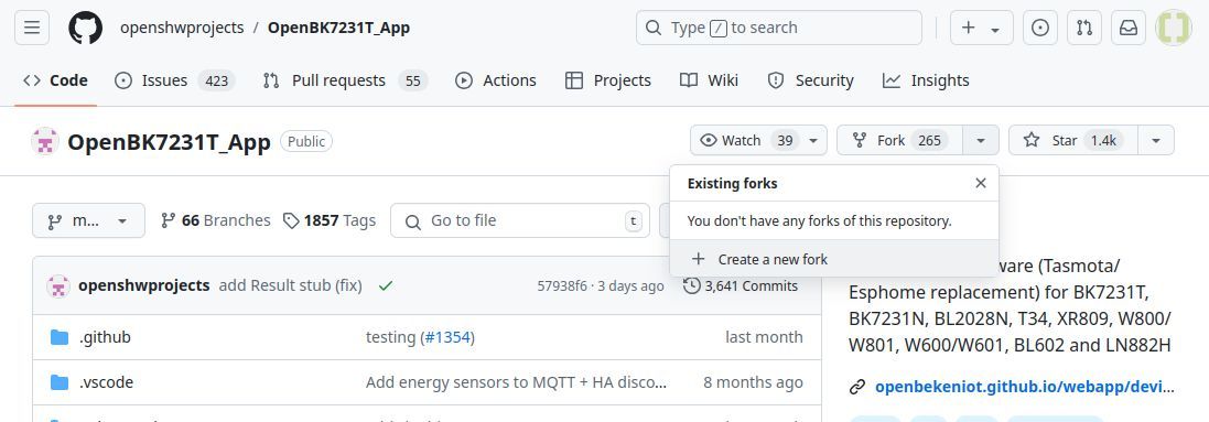

    Navigate to the git URL for OpenBeken:
    and fork the repository with "+ create a new fork"
    Browser window on GitHub page of OpenBK7231T_App project with an option to create a new fork.

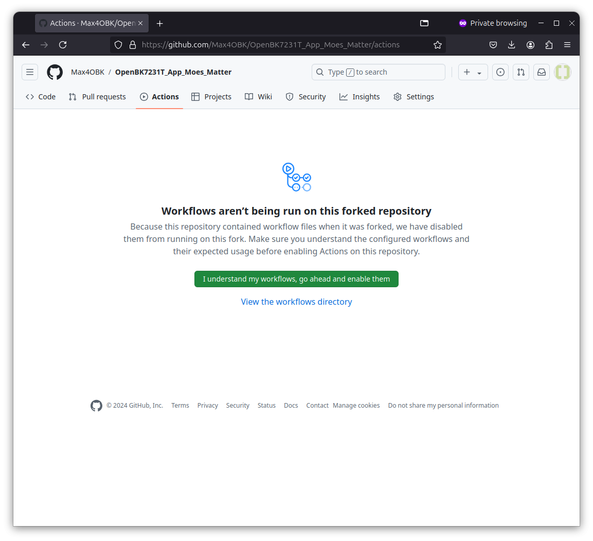

    Assuming this is your first approach, you will need to activate "workflows" once:
    So open "your" fork and as the very first step go to the "Actions" tab.
    If you read:
    "Workflows aren’t being run on this forked repository"
    That's not what we want, since the workflows are exactly what you need to get our (online) build to be done. So allow workflows with the button "I understand my workflows, go ahead and enable them".
    GitHub actions page for a forked repository OpenBK7231T_App_Moes_Matter.
    After that, return to "Code" again - you are ready for your change to the code now.

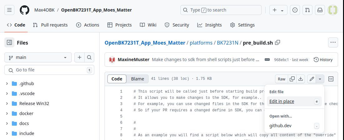

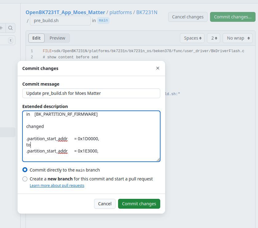

    To bring the script to work, navigate to the git folder with the pre_build.sh (in platforms/BK7231N):
     https://github.com/<your git name>/<the forks name>/tree/main/platforms/BK7231N/pre_build.sh
    Here use "edit in place":
    Screenshot of the GitHub interface with the pre_build.sh file open.
    You can append the script at the end of the comments (that's easy e.g. on a phone), or simply delete the content and only paste your new script there:
    Screenshot showing an online editor with the pre_build.sh file open in the OpenBK7231T_App_Moes_Matter repository on GitHub.
    And then commit the change you made. Give some additional information, if you like an decide, if you want to create a new branch (e.g. if you later plan to do other changes on the "original" fork) or simply change main branch (let's do this here).
    GitHub commit window with edited script file pre_build.sh.

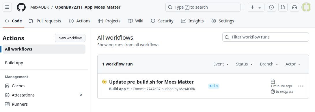

    That's it, we have done our work. So what now?
    Action(s) is what we want ;-)
    So go to "Actions" again and you should see there is something going on ;-).
    Screenshot of the GitHub Actions panel displaying workflow run information.
    You can click the link of our commit to see some details.
    Now you will need some patience until everything is done, but you can take a look for "your" platform BK7231N, and see, what happened during "make":
    User interface of the OpenBK7231N build process displaying code.

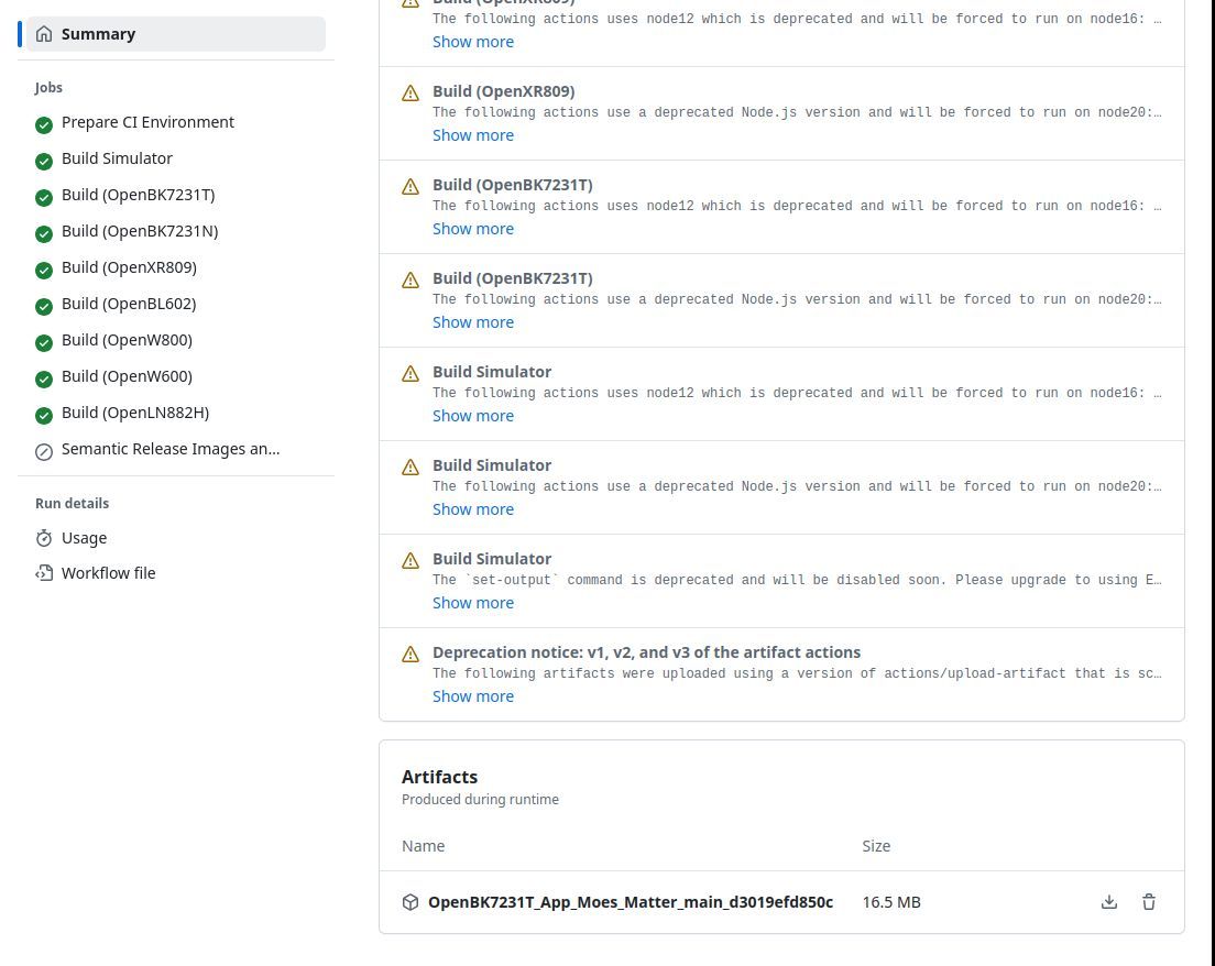

    That looks good, so when everything is done, you can use the resulting "Artifacts" to get the firmware you made.
    Go back to the "Summary" page and find the desired file at the end of the page.
    Summary of actions in the continuous integration process on GitHub
    In the downloaded zip, there is the result of our work, the firmware for BK7231N with changed values!

  • In the full override workflow, your fork first becomes 1 commit ahead, then 2 commits ahead after editing prebuild.sh, which gives a quick sanity check before opening a PR. [#21273290]

  • The smartphone-friendly method can reduce the actual patch to 1 line: sed -i "70 s/0x1D0000,/0x1E3000,/" .../BkDriverFlash.c, using file line 70 to target the change precisely. [#21275413]

What is the override mechanism in OpenBK7231T_App, and how does it replace files inside the OpenBK7231N SDK submodule at build time?
The override mechanism lets the main app inject a replacement file into the SDK submodule during the prebuild stage. You create a matching path under platforms/BK7231N/override/..., place the modified file there, and enable the relevant prebuild.sh lines. The build log then shows PREBUILD: replacing file, followed by the original SDK path and the override path, confirming the replacement happened before make compiled OpenBK7231N. [#21273290]
How can I modify BkDriverFlash.c in a browser-only workflow to change BK_PARTITION_RF_FIRMWARE from 0x1D0000 to 0x1E3000 for a BK7231N device?
You can do it entirely in GitHub by copying BkDriverFlash.c into the override path and editing one value. Create platforms/BK7231N/override/sdk/OpenBK7231N/platforms/bk7231n/bk7231n_os/beken378/func/user_driver/BkDriverFlash.c, paste the original file, and change BK_PARTITION_RF_FIRMWARE from 0x1D0000 to 0x1E3000. Commit the file, then enable the override lines in prebuild.sh so the build uses your edited version. [#21273290]
Why did PR 1340 require changing BkDriverFlash.c for the Moes Tuya Matter bulb, and what problem does the new TLV partition address solve?
PR 1340 changed BkDriverFlash.c because the Moes Tuya Matter bulb needed a different TLV-related partition layout than the default build used. The shown fix moves BK_PARTITION_RF_FIRMWARE from 0x1D0000 to 0x1E3000, so users no longer need older PR binaries when building for that device. The thread states this custom TLV partition address can now be set from the main app workflow instead of editing the submodule upstream first. [#21273290]

Why is my first pull request build paused in OpenBK7231T_App Actions, and what approval step is required before the workflow runs?
Your first PR build pauses because an administrator must approve it before Actions continues. The thread says first-time pull requests appear in the repository PR list while the build stays paused in Actions. After the approval step, the workflow runs normally and produces artifacts if the build succeeds. This safeguard applies before the custom binaries are generated. [#21273290]

How can I use a sed command inside prebuild.sh to patch a single line in BkDriverFlash.c when working from a smartphone or other limited-input device?
You can patch one exact line by placing a single sed command in prebuild.sh. The demonstrated command is sed -i "70 s/0x1D0000,/0x1E3000,/" sdk/OpenBK7231N/platforms/bk7231n/bk7231n_os/beken378/func/user_driver/BkDriverFlash.c. It targets line 70, which reduces risk when the same value might appear elsewhere. This method was proposed specifically for limited-input devices such as smartphones without a real keyboard. [#21275413]
What should I check in the GitHub Actions logs to confirm that the OpenBeken prebuild override script actually replaced the intended SDK file?
Check the Build (platform you made changes to) job and expand Run make. A successful override shows prebuild found for OpenBK7231N, PREBUILD script!, and PREBUILD: replacing file, followed by both the original SDK path and the override path. If you use the sed method, verify the before-and-after grep output around BK_PARTITION_RF_FIRMWARE instead. Those log lines prove the patch ran before compilation. [#21273290]
