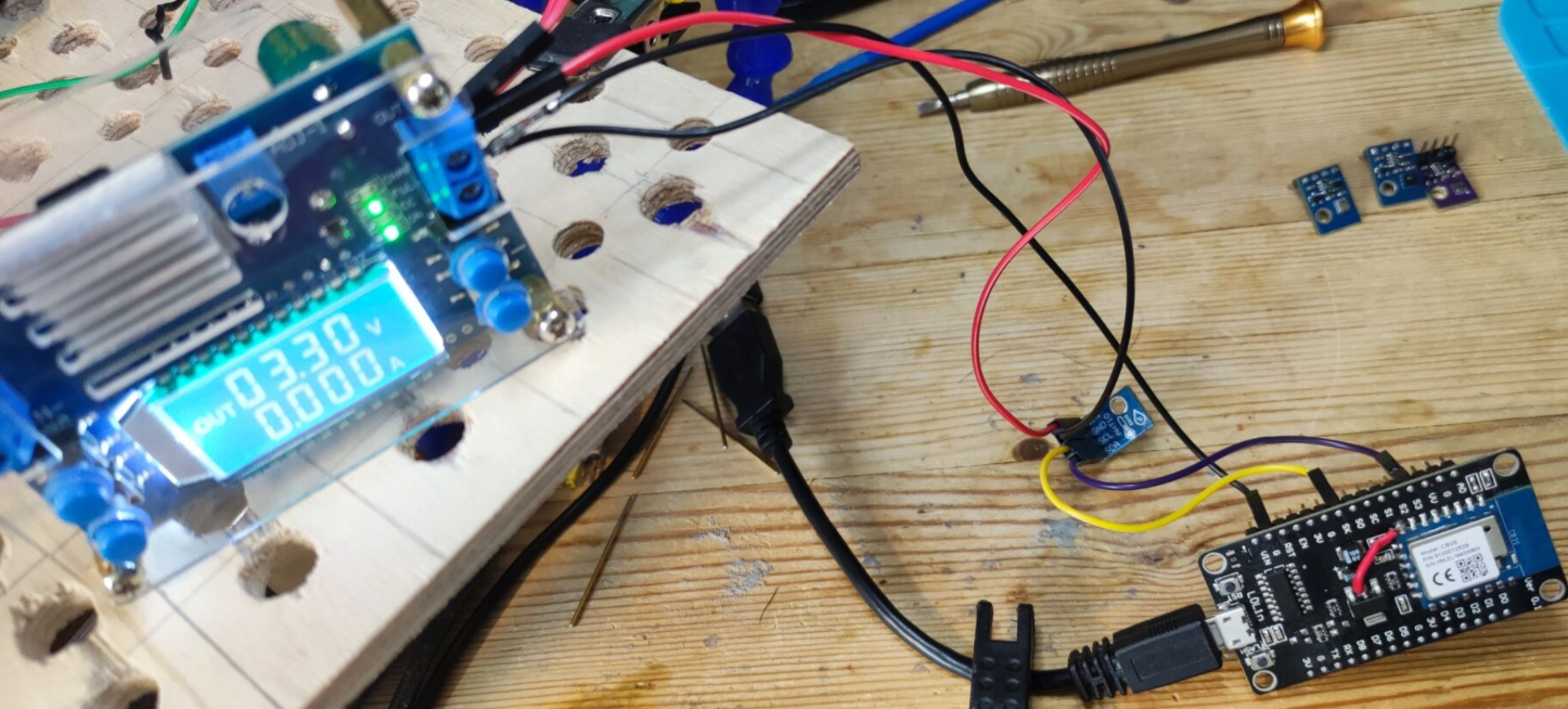

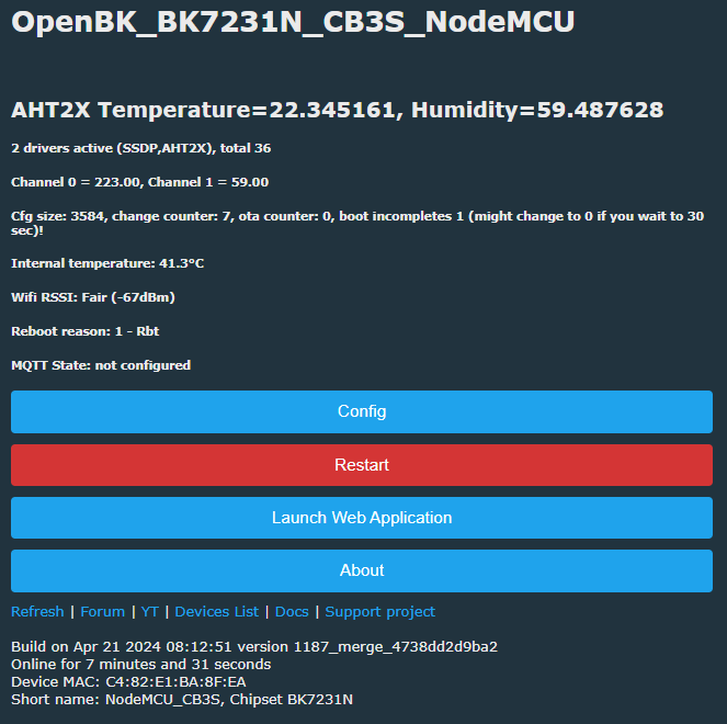

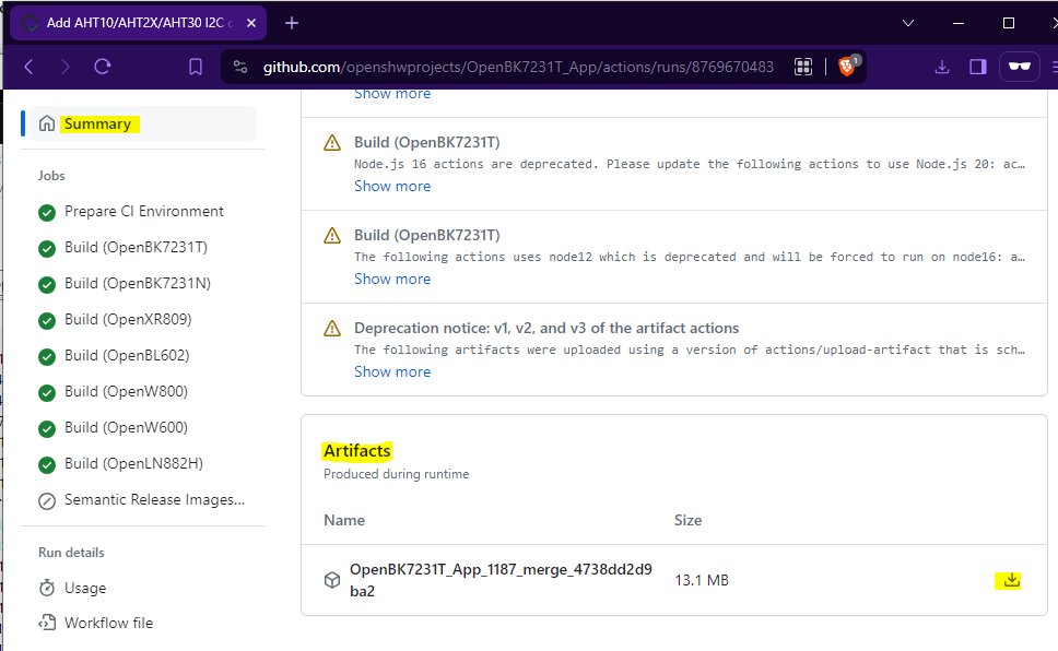

    Onto some testing. I am using a NodeMCU dev board with a transplanted BK7231N based CB3S module. To save space, the AHTXX driver is disabled by default, ie it is not included in the general release builds. The binaries specific to the PR need to be flashed to make use of the driver. To download the special binaries navigate to https://github.com/openshwprojects/OpenBK7231T_App/actions/runs/8769670483, login to Github, scroll to the bottom of the Summary page and download the zip file under the Artifacts section
    Screenshot of a Github page showing artifacts available for download.

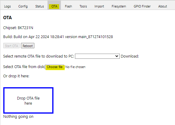

    If flashing a BK7231N device that's already running OBK you'll need to use the OTA update method to flash the OpenBK7231N_1187_merge_4738dd2d9ba2.rbl file in the downloaded zip. If flashing by UART using Easy UART Flasher then use OpenBK7231N_QIO_1187_merge_4738dd2d9ba2.bin
    I used OTA method from the web application
    Screenshot of the OTA tab for the BK7231N chipset.
    After either method your build details on the OBK main page will be
    Screenshot of the device information page on NodeMCU with BK7231N chipset.

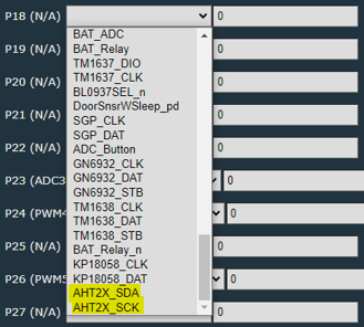

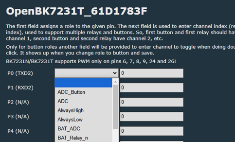

    and you'll see AHT2X driver options in the drop-downs on the module page
    Pin configuration for AHT2X sensors in the user interface.

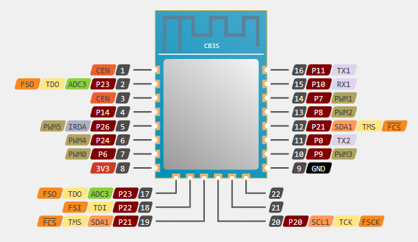

    With that in mind, it looks like I will need to use P20 (SCL1) for AHT2X_SCL and P21 (SDA1) for AHT2X_SDA with the CB3S module I have for testing

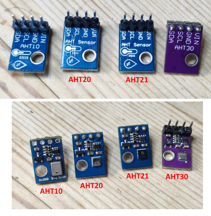

    First, here are the AHT sensors I have to play with. They're all from Ali Express. AHT10, AHT20, AHT21 and AHT30. This means I will not be able to test AHT15 or AHT25.
    Images of AHT10, AHT20, AHT21, and AHT30 sensors with visible pin labels.

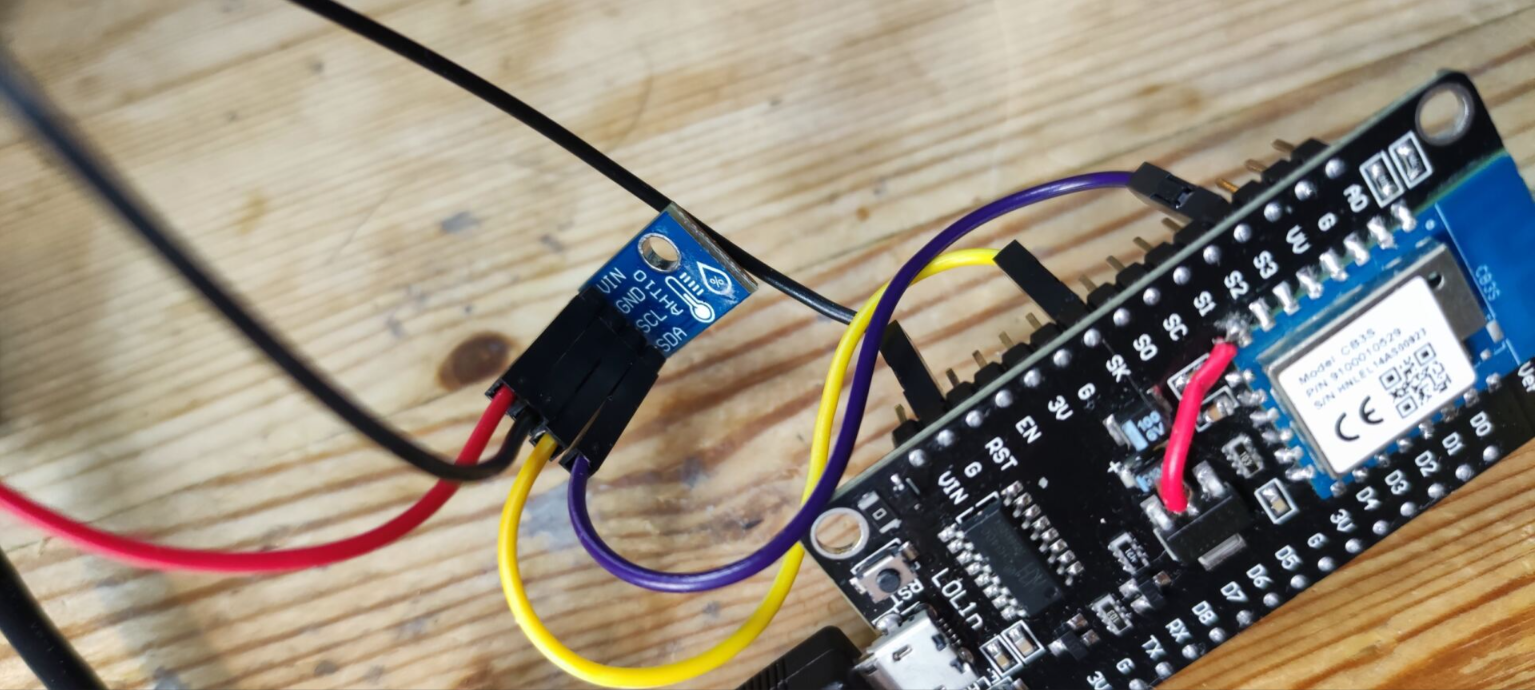

    Starting with the AHT10, I connect SDA to P21 (which maps to S3 on NodeMCU) and SCL to P20 (which maps to SK on NodeMCU). I am powering the AHTs with an external 3.3v so a common ground is established between the PSU, the sensor and the NodeMCU.
    AHT10 sensor module connected to NodeMCU board. NodeMCU development board connected with a sensor and power supply.

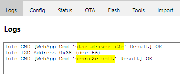

    To confirm the sensor is detected we can use OBKs Softi2c feature to detect the address of the device. Set SoftSDA and SoftSCL pins as appropriate. In my case:
    Screenshot of SoftSCL and SoftSDA settings on ports P20 and P21.
    in the web application log tab we check the i2c driver is started by entering command startdriver i2c then we can scan for i2c devices with command scani2c soft
    Screenshot of OBK configuration logs with i2c sensor detection
    We see in the log it detects and returns the correct address for the AHT10 - 0x38 (in decimal = 56). We should be able to swap to the AHT2X driver now. (note SCK = SCL). All the AHTXX tested will return 0x38 as their address.
    Screenshot of AHT2X pin configuration on NodeMCU.
    You'll need to save changes after swapping to reveal the second channel box for the SDA assignment. Ensure both channels differ from any other in use. After a reboot the AHT2X driver starts automatically and the temperature and humidity data is displayed as expected
    NodeMCU module configuration homepage with temperature and humidity data from AHT2X sensor

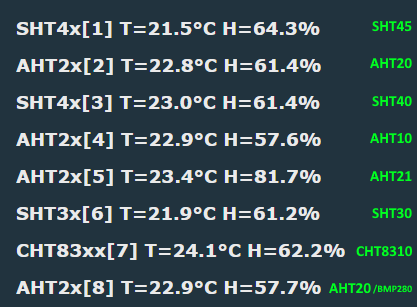

    Zipping through the remaining sensors:
    AHT20

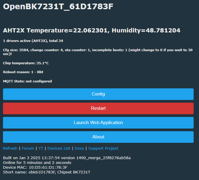

    Temperature and humidity readings from the AHT2X sensor in user interface.
    AHT21
    Screenshot showing temperature and humidity readings from AHT2X sensor.
    AHT30
    Screenshot showing temperature and humidity readings from the AHT2X sensor.
    Apart from the AHT21 humidity, they all seem consistent. Perhaps the AHT21 will sort itself out if left untouched powered for a while. I also do not have any professional equipment to compare measurements against so not sure how accurate these readings are.

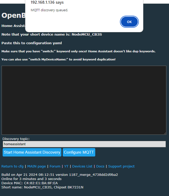

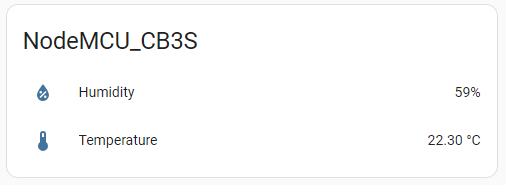

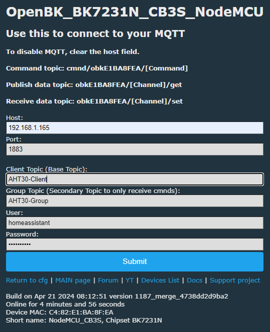

    Sticking with the AHT30 I'll demonstrate MQTT/HomeAssistant configuration and discovery. From the Config->Configure MQTT menu I'll set some test topic names, my HA server IP and the username/password credentials specific to my setup and click submit.
    MQTT configuration for AHT30 on the OpenBeken platform.
    Then under Config->Home Assistant Configuration->Start Home Assistant Discovery
    MQTT discovery in OpenBeken with Home Assistant discovery enabled
    A few seconds later the device tile should appear in HA complete with device name and the sensor readings
    Humidity and temperature readings on a NodeMCU CB3S device.

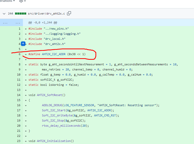

    The code you are referring to has I2C address hardcoded. It should be possible to adjust it to be taken from a variable or to rewrite the code so it can support multiple sensors if necessary.
    Screenshot of code in an editor, showing the definition of the I2C address for AHT2X.

    I hardcoded the address, as from what i have seen, only AHT10 has the ability to change its address. And it still comes with 0x38 as default, and very few will have the tools | ability to change it. It is very easy to adapt the driver, but i honestly saw no need for it. As for polling interval, AHT2X_Cycle is just for that.
    Sorry for not having seen github comments, turned out i had notifications disabled.

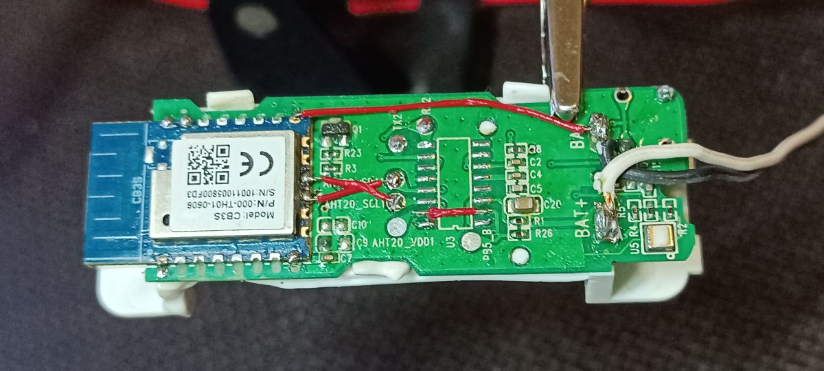

    I've tried this approach on one of aliexpress tuya generic th sensors.
    Close-up of a printed circuit board with an electronic module and wires.

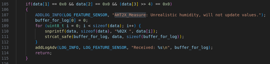

    Did a build with ath2x and some mods to output the data from AHT2X_Measure if in trouble.
    Screenshot of C code snippet related to the AHT2X sensor.
    Boot seems solid, but I get following:
    Some poking around pointed me into this datasheet, but it just got me confused more.
    Can't seem to reflect datasheet concepts in drv_aht2x, but I'm just a noob.
    Any help would be appreciated.

    Which sensor do you have there, exactly?

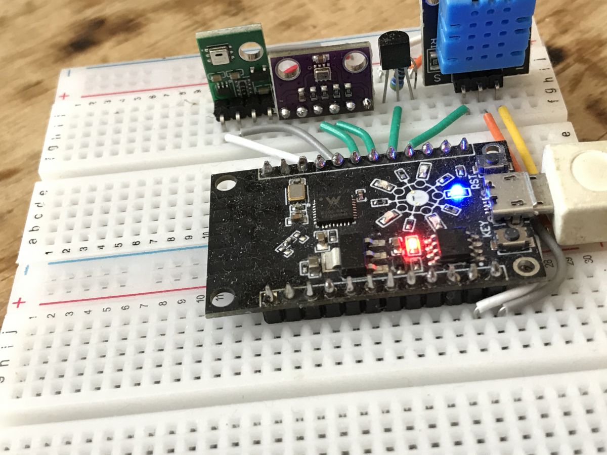

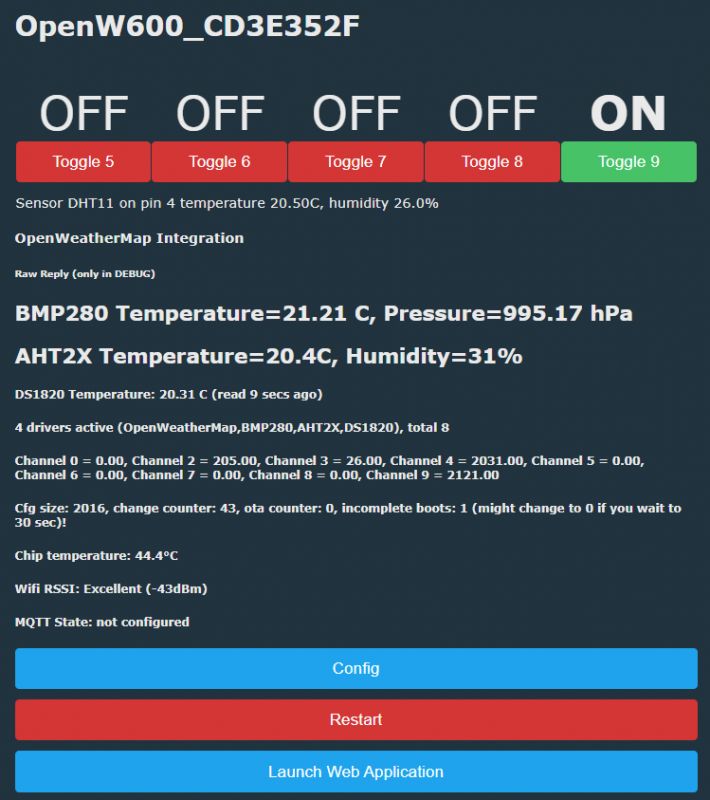

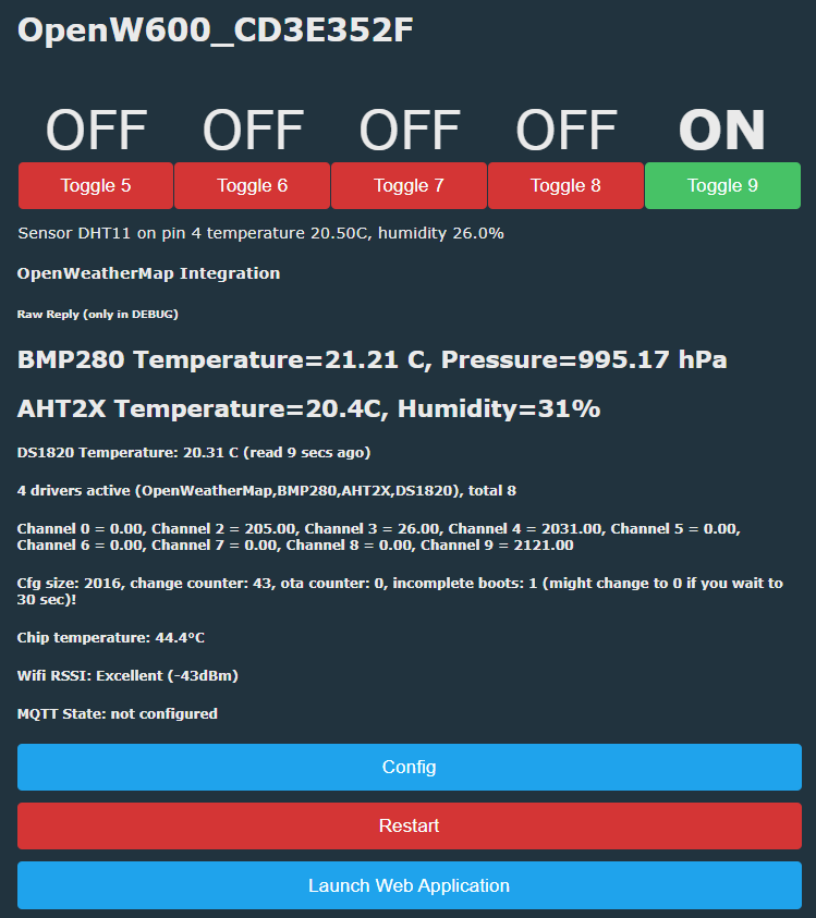

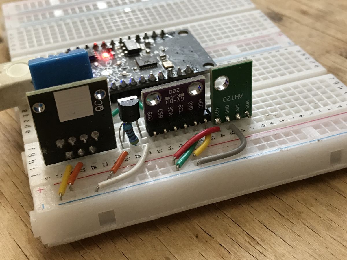

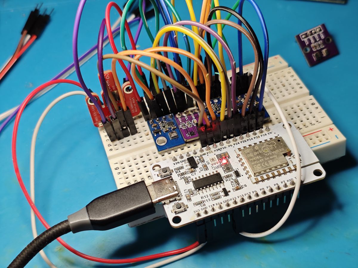

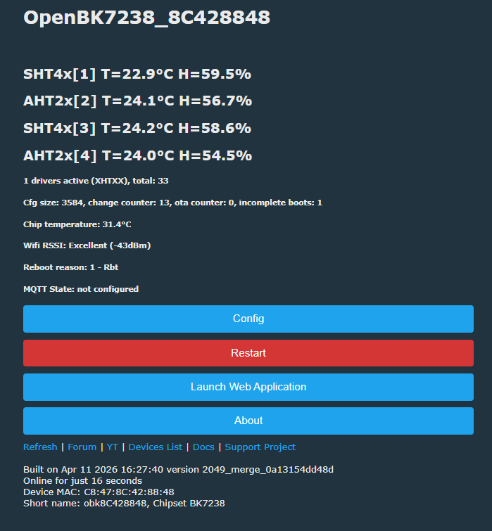

    I am asking because I have a dev board here, with AHT20 from Aliexpress:
    Dev board with AHT20 sensor on a breadboard with connected wires.
    Dev board with various sensors on a breadboard.
    And it works just good, so it's fair to say that you have most likely a configuration error or a wrong sensor? We would need to check driver code, do you get any communication at all? Maybe wrong pins set?
    OpenW600 system interface with sensor readings from DHT11, BMP280, AHT2X, and DS1820, including toggle and configuration options.

    Board pix + log attached in previous post. It just sends back 18 38 20 00 00 00 all the time. Odd thing is that init and rest of stuff up to "Unrealistic humidity, will not update values" you have in drv_aht2x.c runs fine.

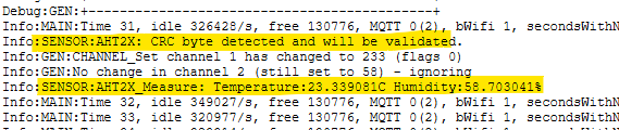

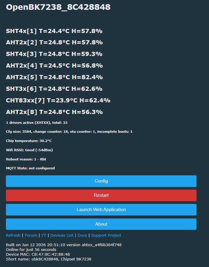

    fiddled with the AHT2X driver.
    https://github.com/openshwprojects/OpenBK7231T_App/pull/2130

    CRC support is opt-in using AHT2X_CRC, so existing users remain on the legacy six-byte read path unless they deliberately enable CRC validation.
    New commands
    AHT2X_CRC 0
    = legacy six-byte read - default
    AHT2X_CRC 1
    = auto CRC validation when a valid CRC byte is detected
    AHT2X_CRC 2
    = require valid CRC
    if enabled, on the first measurement where the seventh byte matches the calculated CRC, the driver logs:
    AHT2X: CRC byte detected and will be validated.
    After that, successful CRC validation does not log on every measurement. It just continues to update the readings and logs the normal measurement line:
    AHT2X_Measure: Temperature:27.200000C Humidity:60.000000%
    If CRC validation fails after CRC was detected, or if mode 2 requires CRC, it logs:
    AHT2X: CRC mismatch, expected 0xXX got 0xYY; measurement ignored.
    and the reading is not updated.

    Since you seem to have multiple/different AHTxx sensors, I'm just curious, if my multi sensor driver (https://github.com/openshwprojects/OpenBK7231T_App/pull/2049) will handle them correctly. Maybe you could give it a try?

    oh wow cool. I knew you'd done the SHT4X stuff but hadn't really acknowledged the further work. I'll set something up. Let's get some of these things merged! there are so many open PRs
    Added after 50 [minutes]:
    Screenshot of the OpenBK7238 dashboard showing SHT4x and AHT2x temperature/humidity readings and Config/Restart buttons.
    I guess 4 is the maximum.
    left to right
    SHT45 - AHT20 - SHT40 - AHT10 - AHT21 (not init)
    ESP32 board on a breadboard with many jumper wires and a sensor module; USB cable attached on blue mat
    Added after 56 [seconds]:
    Info:SENSOR:XHTXX: sensor array full (4).
  • #23 21919788
    max4elektroda
    Posts: 755
    Help: 48
    Rate: 187
    Yepp, but it's configurable, else set in src/driver/drv_xhtxx.h:
    #ifndef XHTXX_MAX_SENSORS
    #  define XHTXX_MAX_SENSORS 4
    #endif

    Screenshot of OpenBK7238 dashboard listing temperature and humidity readings from multiple sensors
  • #25 21920216
    Posts: 14616
    Help: 655
    Rate: 12633
    Well, they seem to be somewhat accurate at least. Maybe get more of them and create an accuracy test? It could be very interesting, especially if you capture data over time...

    Posts: 5062
    Help: 438
    Rate: 893
    hmm more?! :)
    was hoping they would settle a bit overnight, but no real change
    Screenshot listing temperature and humidity readings from multiple sensors on a black background

    I also had the experience, that while temperature is near, humidity is more or less guesswork ;-). And that's independent from the driver, only when using many at a time it's more obvious.
    And, especially with the ali sensors, you also have no real idea, if it's a genuine sensor or some clone...
