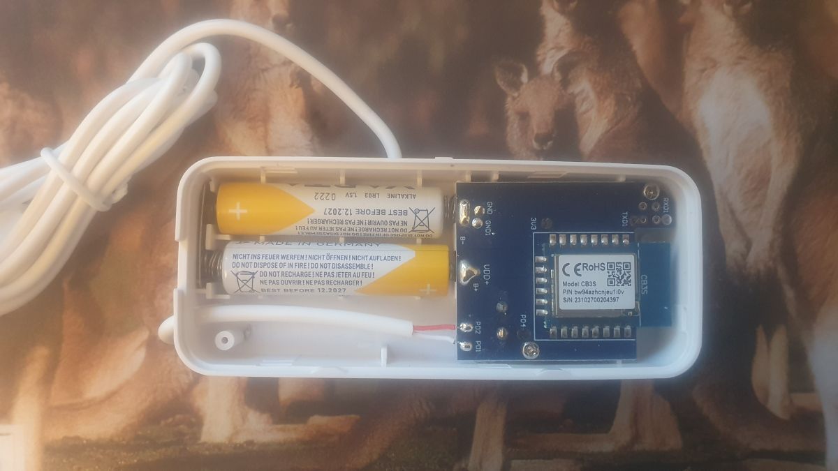

    I bought a water leak detector. Managed to flash it with Tuya Cloudcutter.
    Here is the Tuyaconfig:
    BK7231N_TuyaConfig_obkE158665D.bin
    It was listed as 1.1.9 in Tuya.
    When flashing:
    I had to first set it in long blink mode by first holding the button once, then once again.
    After the initial configuration, I had to pull the battery out and then put it back and put it into long blink mode again for the flashing itself. This advice was found somewhere on the forum, so thanks for that, but I can't find it now to give credit.
    - Button (channel 0) on P24
    - Status LED on P26
    - PIR sensor on P8
    - Buzzer on P7
    - Battery Relay on P14
    - Battery Max Voltage: 3000
    - Battery Min Voltage: 1800
    - Battery ADC on P23
    Device seems to use Battery Driver. See more details here: https://www.elektroda.com/rtvforum/topic3959103.html
    No module information found.
    And the Tuya section starts at UNCOMMON POSITION 0
