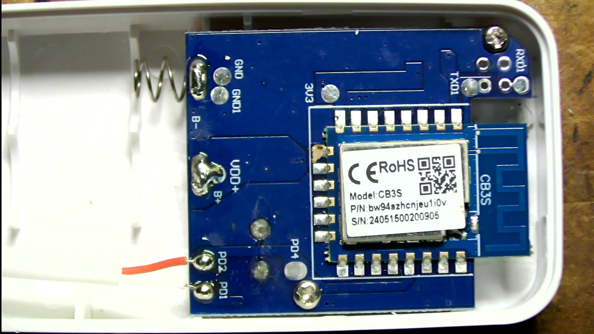

    After removing the battery compartment cover, this is what we see:
    PCB of a device with a CB3S module inside a casing.

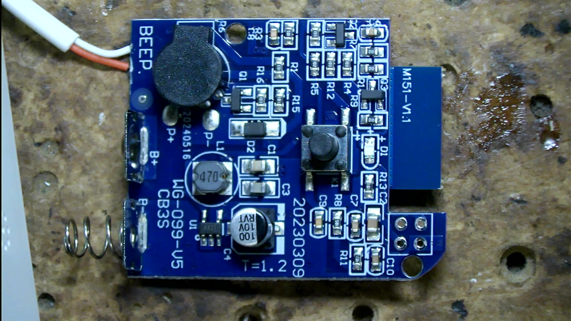

    The back side of the PCB:
    The interior PCB of a Tuya BK7231N water sensor with electronic components.

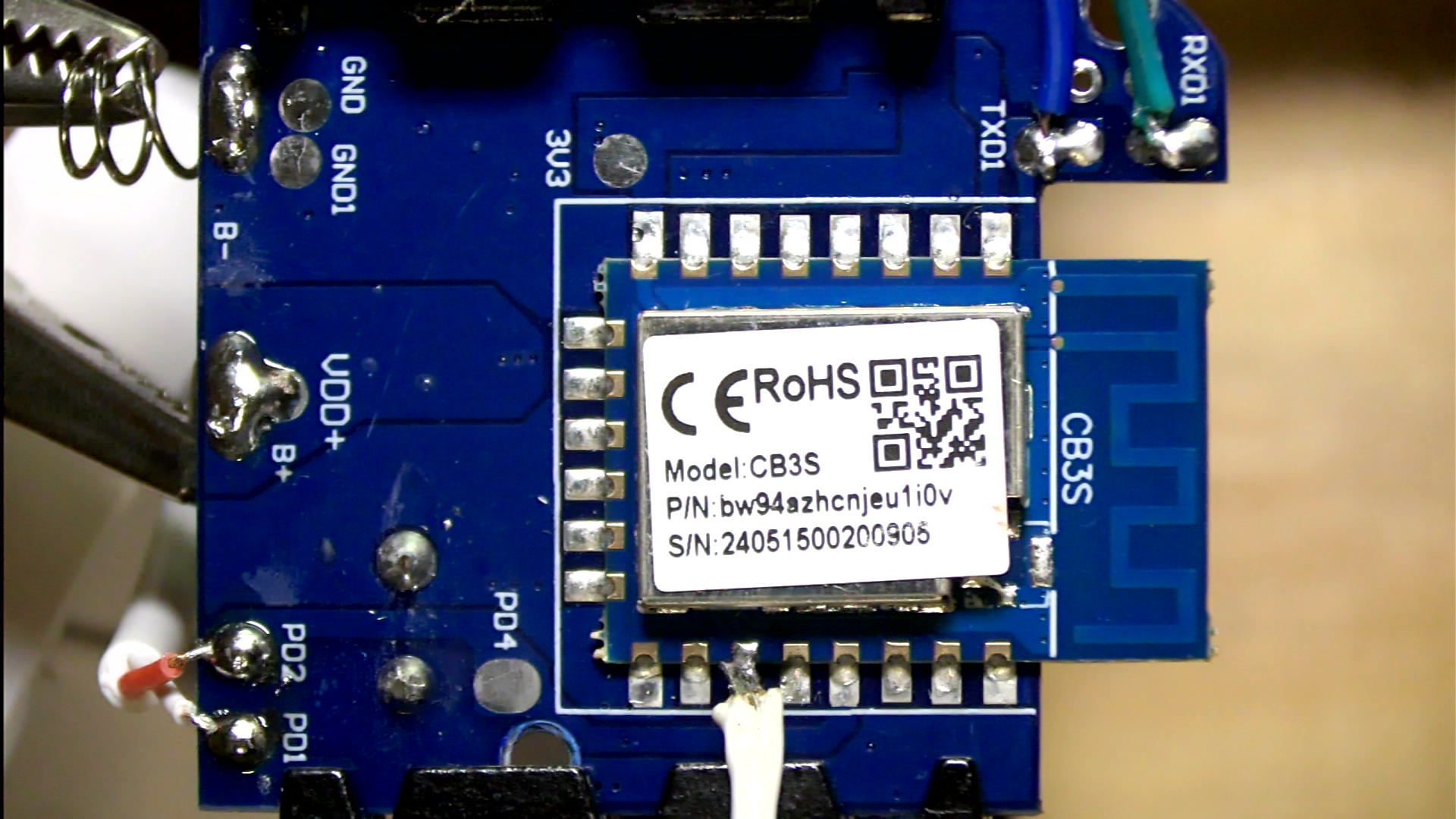

    These are the points we need to re-program the device:
    PCB of a device with CB3S module, showing solder points and wires.
    The white wire is the monitoring output. All the other points used are clearly marked on the board. I used the battery terminals to power the device with an external power supply.
    I attached the backup of the original firmware.
