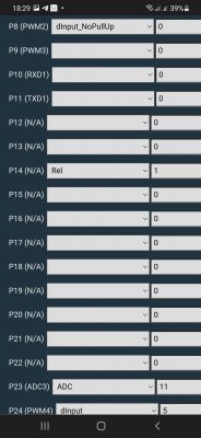

    Hi,
    first of all, thanks for making this great firmware.
    I have a Water Leak sensor that is not equipped with a tuyaMCU, The module is CB3S(BK7231N) I have flashed this CB3S with OpenBK7231N_QIO_1.15.407, the device has connected to HA, but the problem is I don't know how to reduce battery consumption.
    the following is a picture of the Water Leak sensor :
    CB3S (BK7231N) Water Leak Detector without TuyaMCU: Battery Saving Tips & Configuration CB3S (BK7231N) Water Leak Detector without TuyaMCU: Battery Saving Tips & Configuration CB3S (BK7231N) Water Leak Detector without TuyaMCU: Battery Saving Tips & Configuration

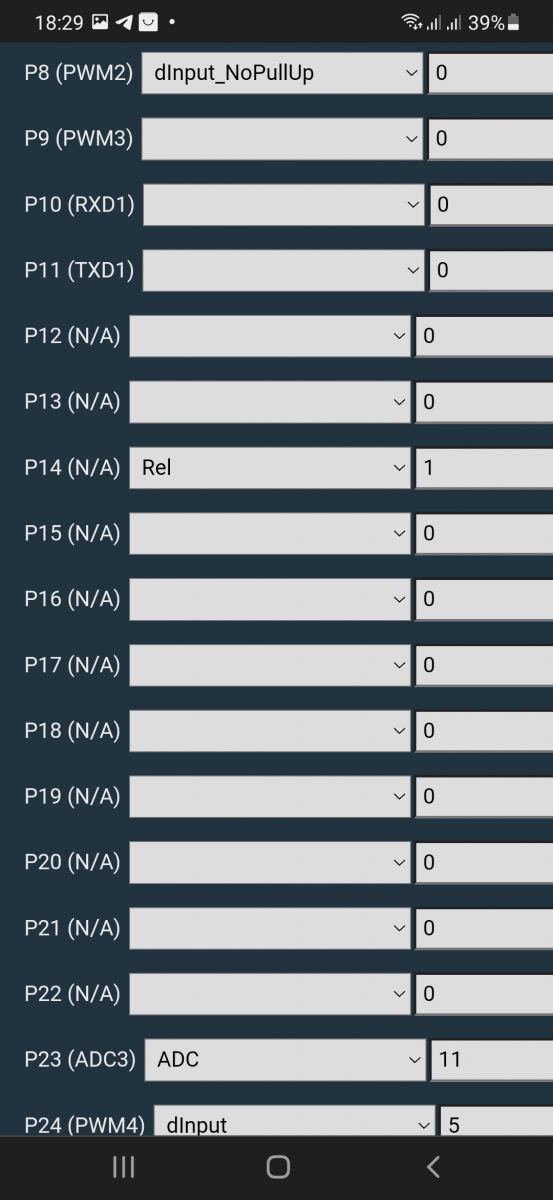

    This is the PINs :
    P8  Water Leak (dInput_NoPullUP) Channel 0 Readonly
    P14  Trig Q2 / Batt Monitor (Rel) Channel 1 Toggle
    ADC3  Analog input Batt Monitor(ADC) Channel 11
    P24  PushBttn Pairing (dInput) Channel 5 Readonly
    Dummy channel 3 humidity

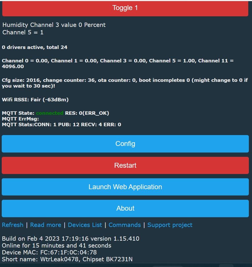

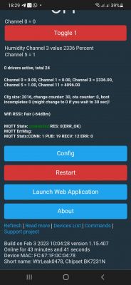

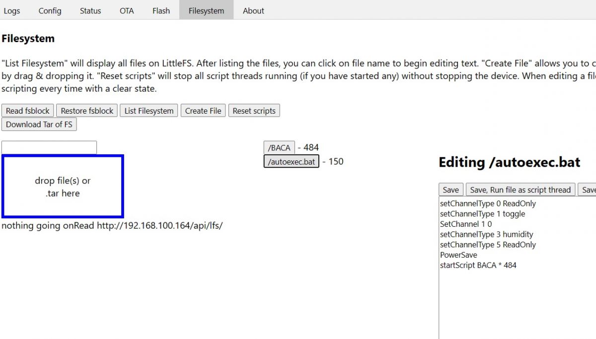

    I have updated to ver 1.15.410
    i don't where to put DeepSleep Command, putting on scripts but no effect
    this autoexec :
    setChannelType 0 ReadOnly
    setChannelType 1 toggle
    SetChannel 1 0
    setChannelType 3 humidity
    setChannelType 5 ReadOnly
    startScript BACA * 507
    this --> BACA id 507 :
    again:
              if $CH0==1 then goto done
              if $CH1==1 then goto done
              if $CH5==0 then goto done
              setChannel 20 0
              goto again
    done:     // make sure  BATT monitor OFF
              setChannel 1 0
                  // make sure only one shot
              if $CH20==1 then goto again
              setChannel 1 1
              delay_s 3
    	  SetChannel 3 $CH11
    	  setChannel 1 0
              setChannel 20 1
    	  delay_s 10
              DeepSleep 600 -------------------------------> no effect  :(  :(
    	  goto again

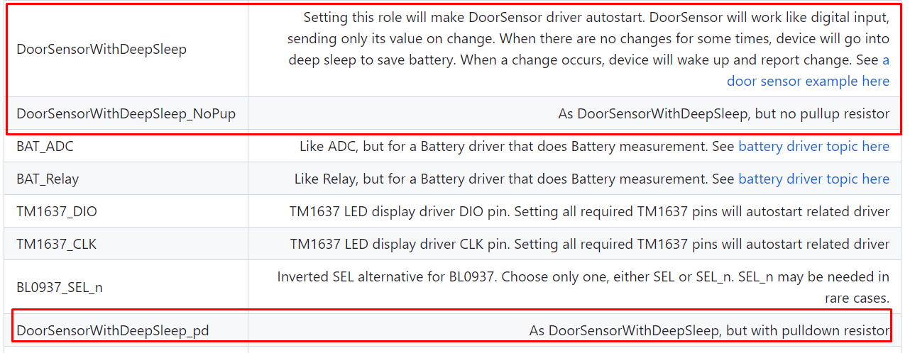

    Posts: 14767
    Rate: 12906
    This is configurable. You have multiple pin roles:
    https://github.com/openshwprojects/OpenBK7231T_App/blob/main/docs/ioRoles.md
    Namely:
    Screenshot of a table showing pin role configuration for OpenBK7231T application.
    There is also DSEdge setting:
    | DSEdge | [edgeCode] | DeepSleep (PinDeepSleep) wake configuration command. 0 means always wake up on rising edge, 1 means on falling, 2 means if state is high, use falling edge, if low, use rising. Default is 2.<br/><br/>See also [DSEdge on forum](https://www.elektroda.com/rtvforum/find.php?q=DSEdge). |
  • PinDeepSleep wrongly enables pulldown on P8 input
    #12 20741870
    eddie.t.h
    Posts: 36
    I know about these settings but they don't seem to work. That is, they work until the Pindeepsleep command is executed. Therefore, when the sensor is awake, everything works properly, i.e. it detects moisture correctly. After sleep, the measurements showed that an additional resistance of several dozen kohm is attached to the pin, so the water resistance is too high to get a high state. I have the latest version of the software.
    EDIT:
    I checked again carefully and everything indicates that the PinDeepSleep function is bugged.
    Setting pin P8 as DoorSnsrWSleep_nPup makes it correctly detect the dampness on the probe in active mode. The input resistance of the pin of the order of Mohms.
    Enabling DoorSnsrWSleep_pd makes the input resistance drop to 18kohm and the probe no longer works. So here everything is ok, the functions work properly.
    That is, with the DoorSnsrWSleep_nPup option, the sensor theoretically should work properly but unfortunately it does not. Until sleep everything is ok, the input resistance is in Mohm, but after sleep it drops to 18kohm - so clearly the pulldown resistor is activated!
    The same thing happens when I set the inputs as ordinary DI without pull-up and issue the PinDeepSleep command.

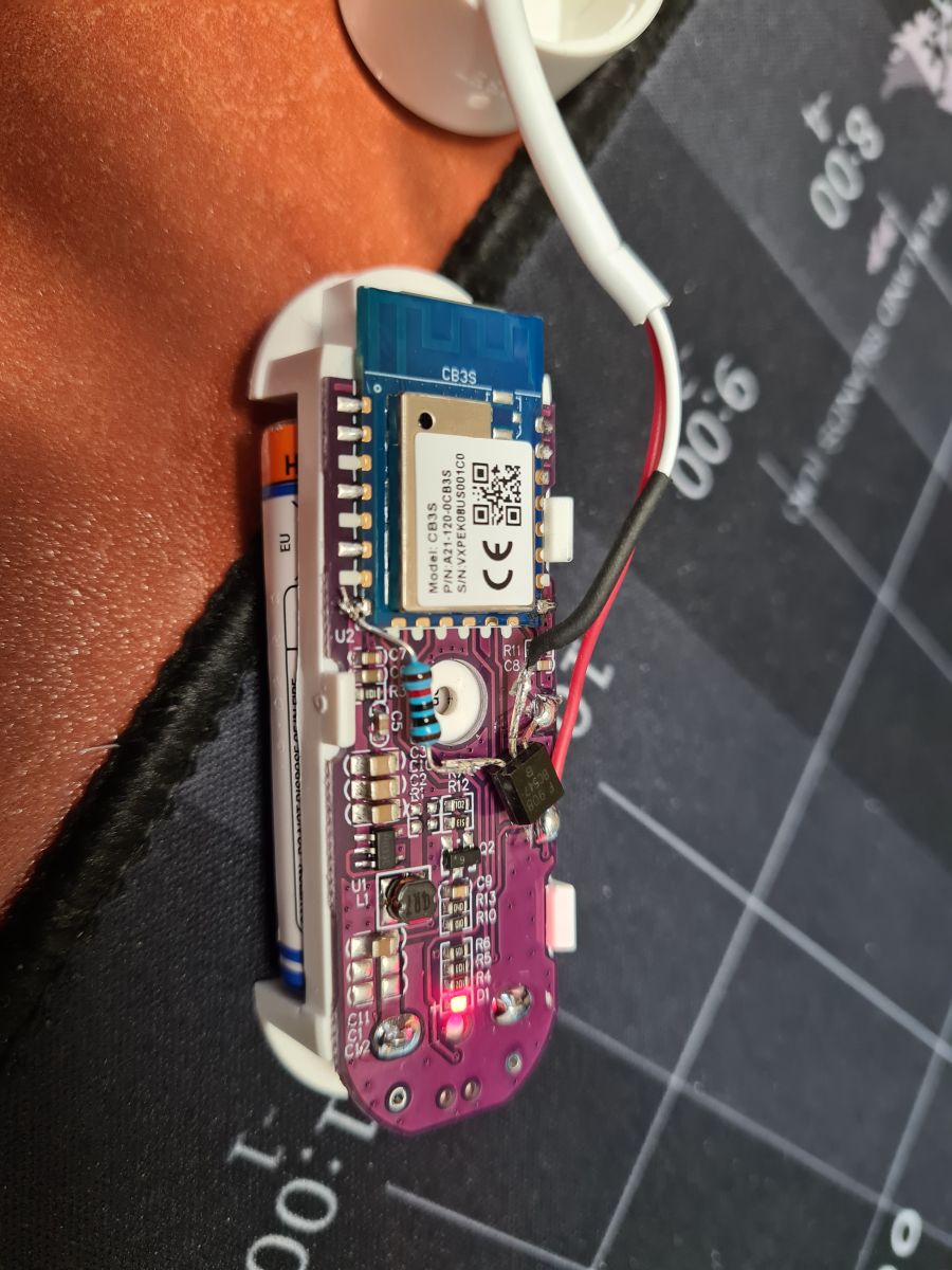

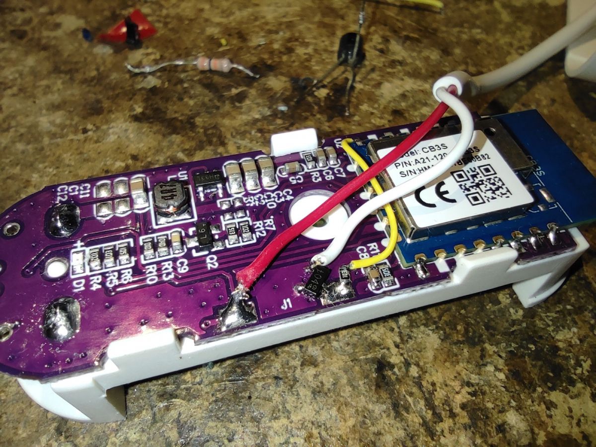

    I also became the owner of this water sensor. Unfortunately, after downloading Open Beken, I couldn`t force it to wake up when the state changed. And even with the original software, it didn`t quite work properly in my opinion.
    Therefore, I soldered an NPN transistor (the first one found on the motherboard) and a 10kΩ pull-up resistor connected to 3.3V to the P8 input, where one of the electrodes goes.
    Something similar to the example in this diagram: https://www.instructables.com/Simple-Water-Sensor/
    It looks like:
    Close-up of a circuit board with electronic components and wires.
    Thanks to this, the system simply gets 1 or 0 (3.3V or 0V). Now all I had to do was set the sensor as DoorSnsrWSleep_nPup and after short tests I found that it works properly. I will add that selecting DoorSnsrWSleep, which should pull up itself, also did not want to wake up the system. Additionally, you also need to turn on flag 42 to reverse the readings.

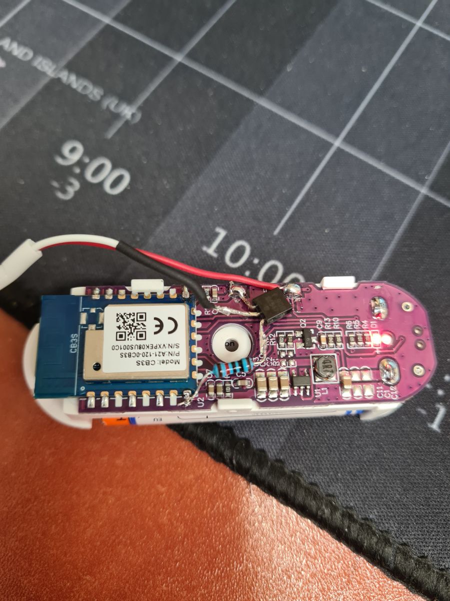

  • BC547 transistor wiring for correct leak detection sleep behavior
    #16 20974957
    Mad_Maxs
    Posts: 81
    By inserting the NPN BC547 transistor, with the emitter in place of the probe pad, the collector in the white wire from the probe, and the base through a 10kohm resistor in VCC, we obtain correct operation with pin 8 set as DoorSnsrWSleep_nPup, Flag 42 to OFF and DSEdge 2.
    Electronic module with NPN BC547 transistor installed Printed circuit board with NPN BC547 transistor and connected wires.
    I noticed that when the probe is immersed in water, the sensor wakes up, does its job, goes to sleep, immediately wakes up again, does its job, goes to sleep and won`t wake up again... Even if I take the probe out of the water and dry it, it gets wet again no longer agitates the module. Only btn wakes him from sleep, detects that he is dry and goes to sleep, again watching and waiting for the leak to be detected. So it has to be??
    BTW, how is work going on connecting PinDeepSlepp with DeepSleep so that you can periodically wake up the module to report the battery status?

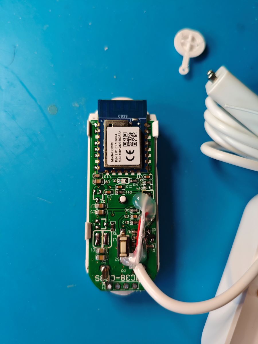

    Cloudcutterable CB3S leak detector pinout and sleep config
    #18 21183262
    Posts: 5216
    Help: 448
    Rate: 917

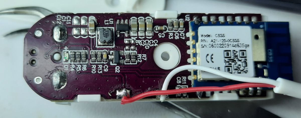

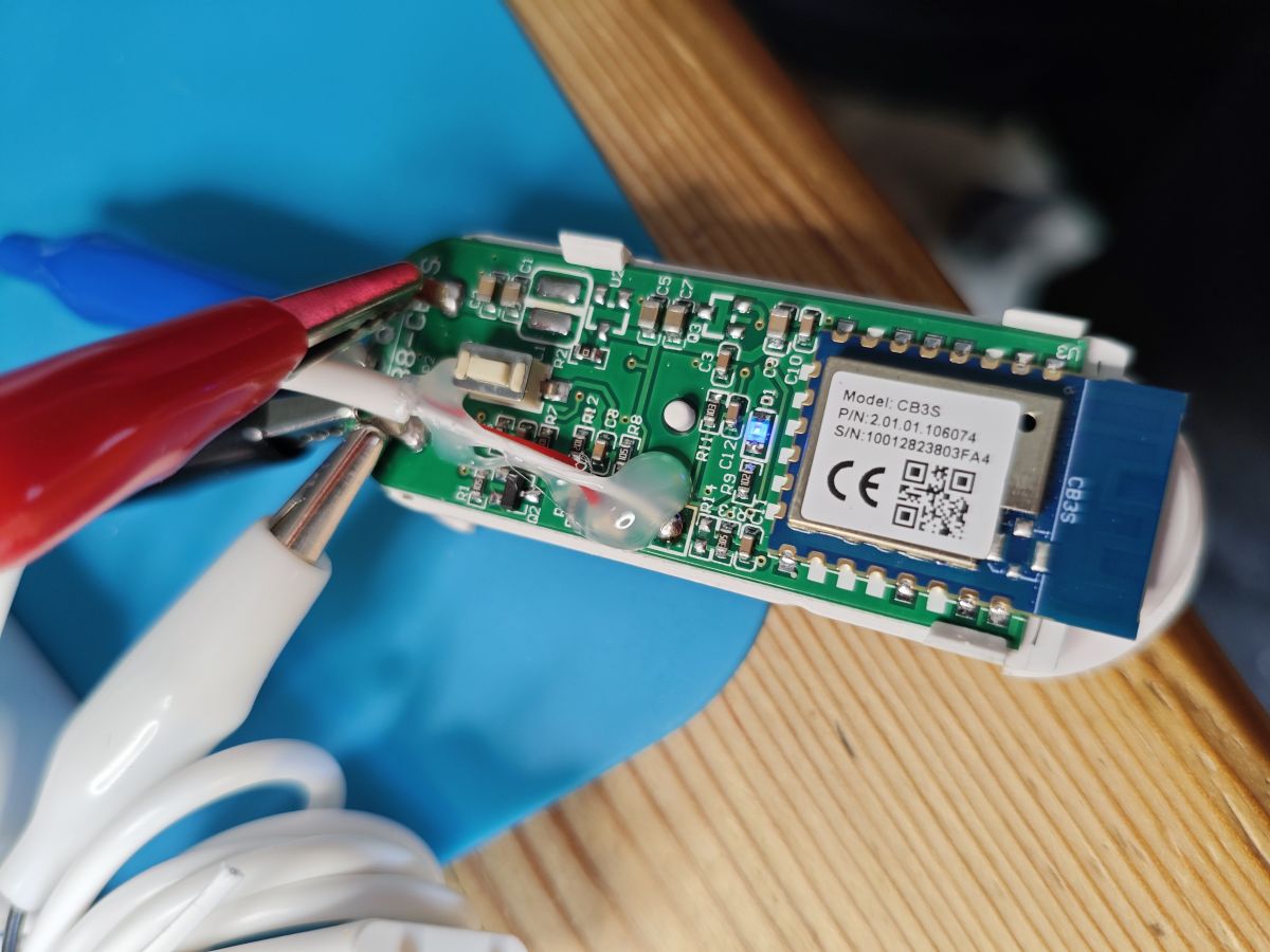

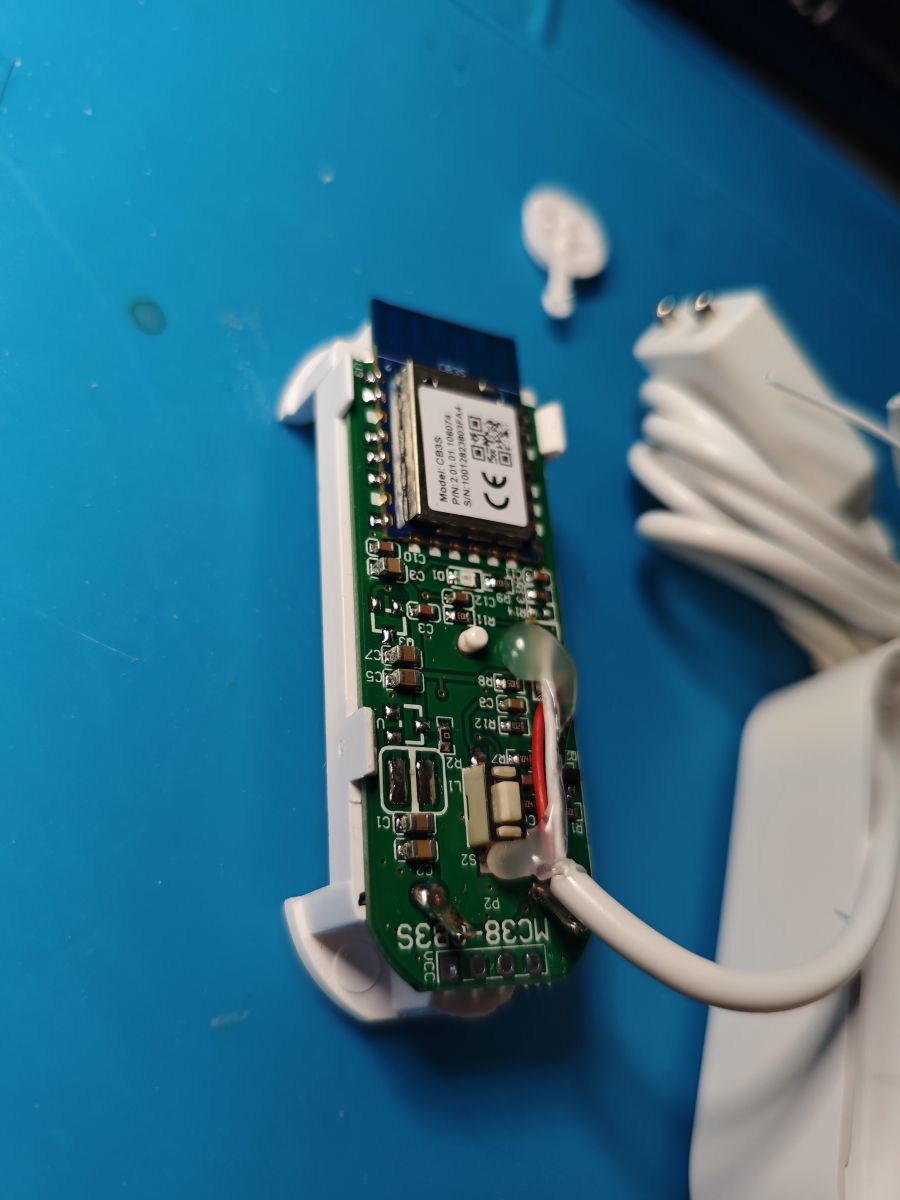

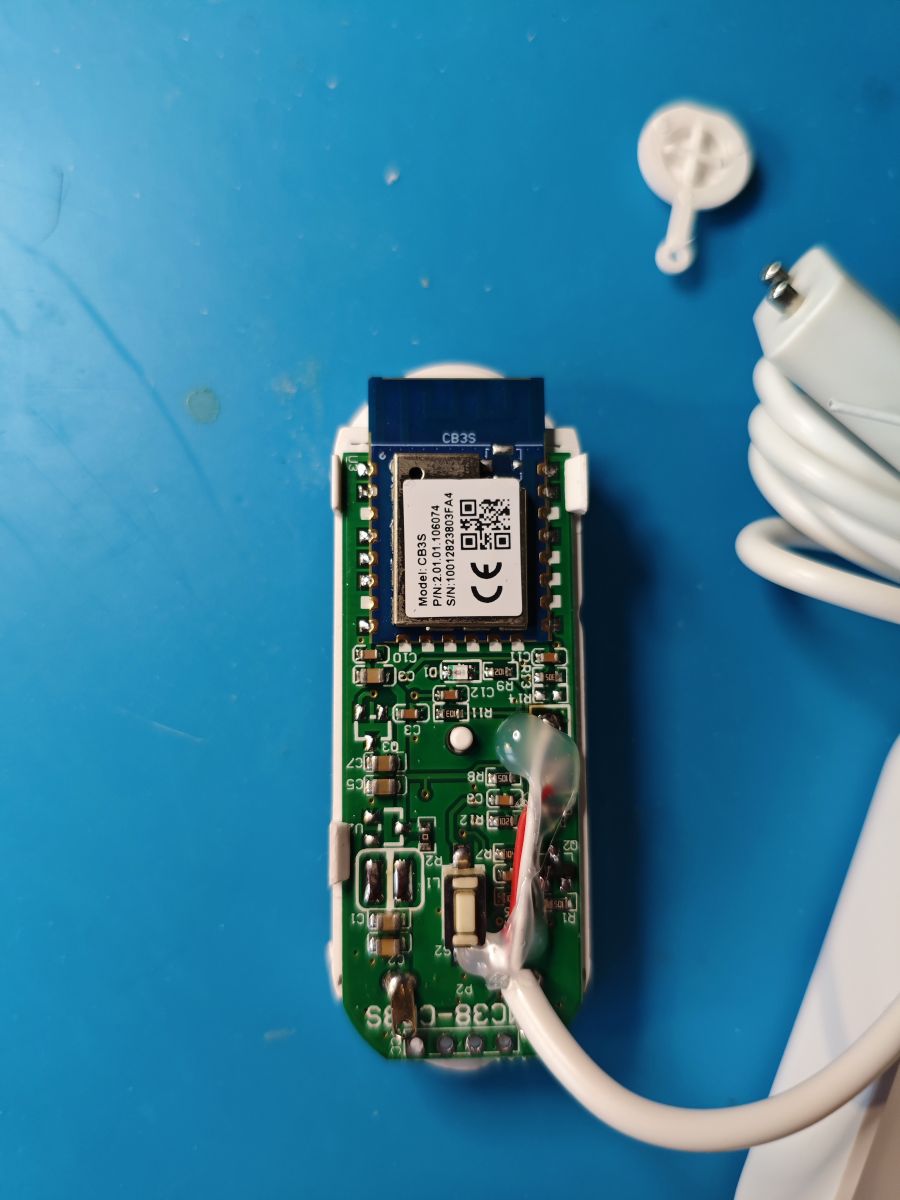

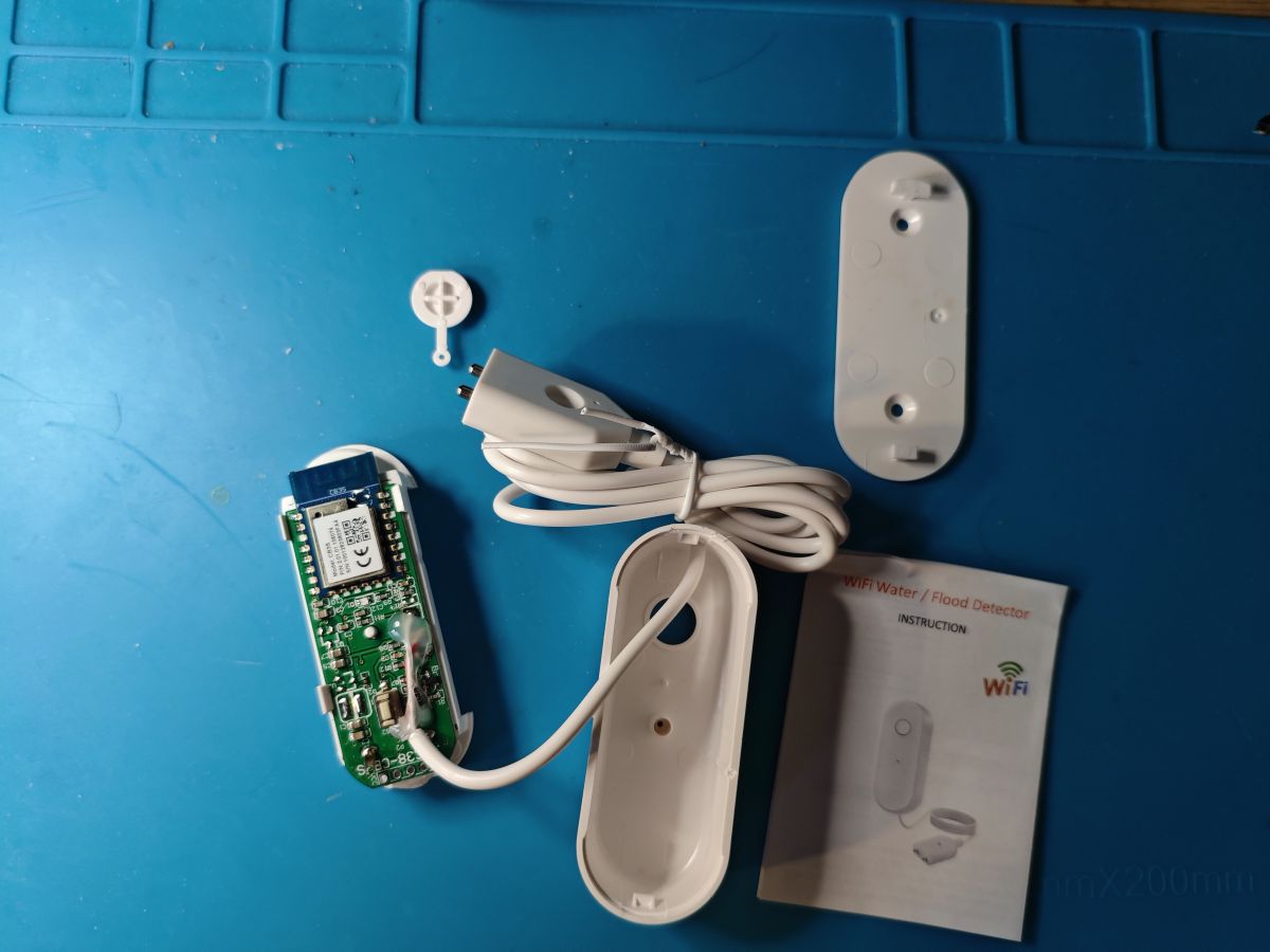

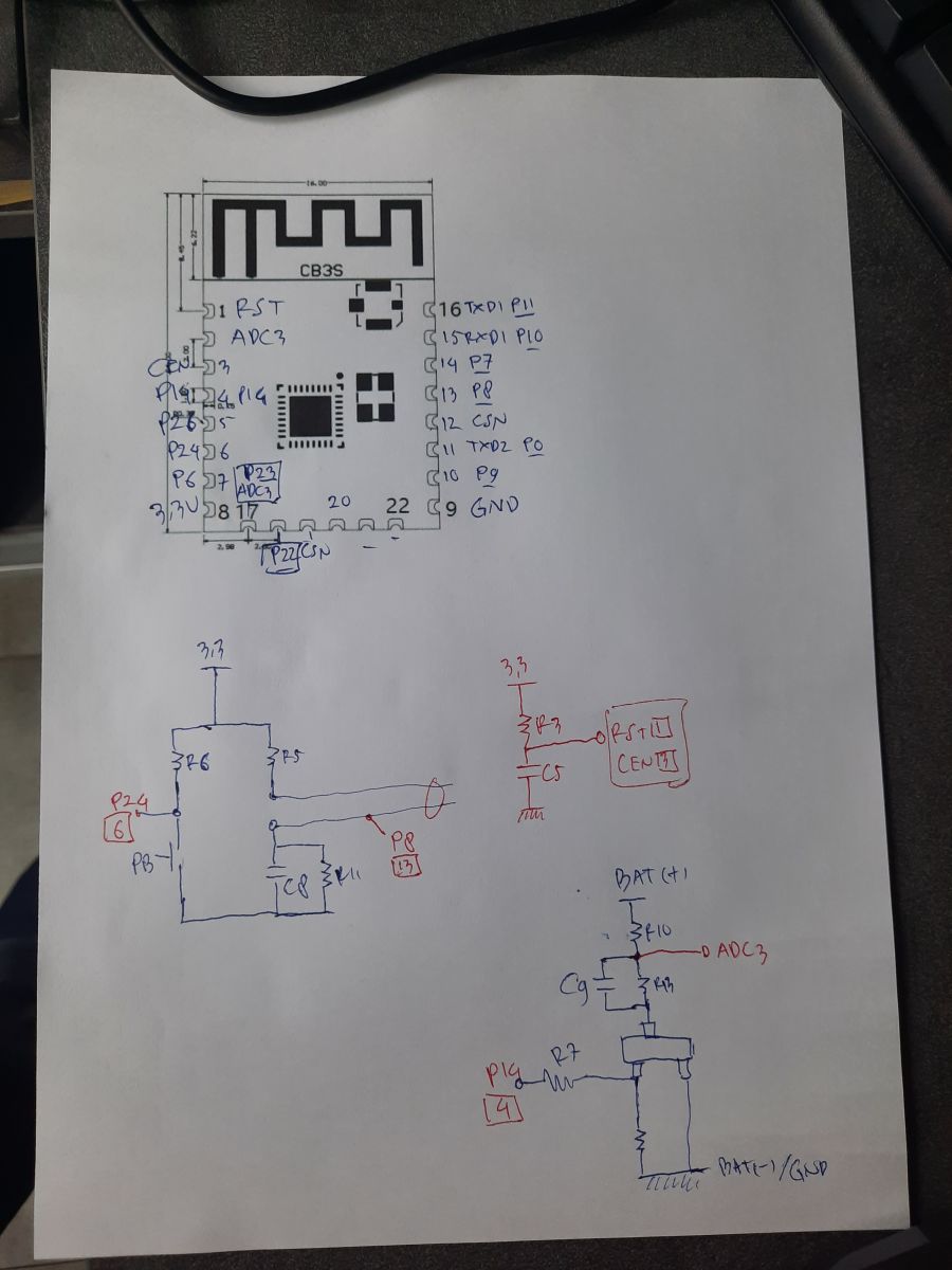

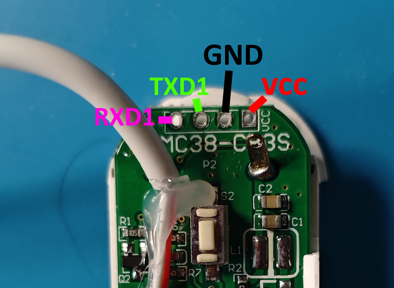

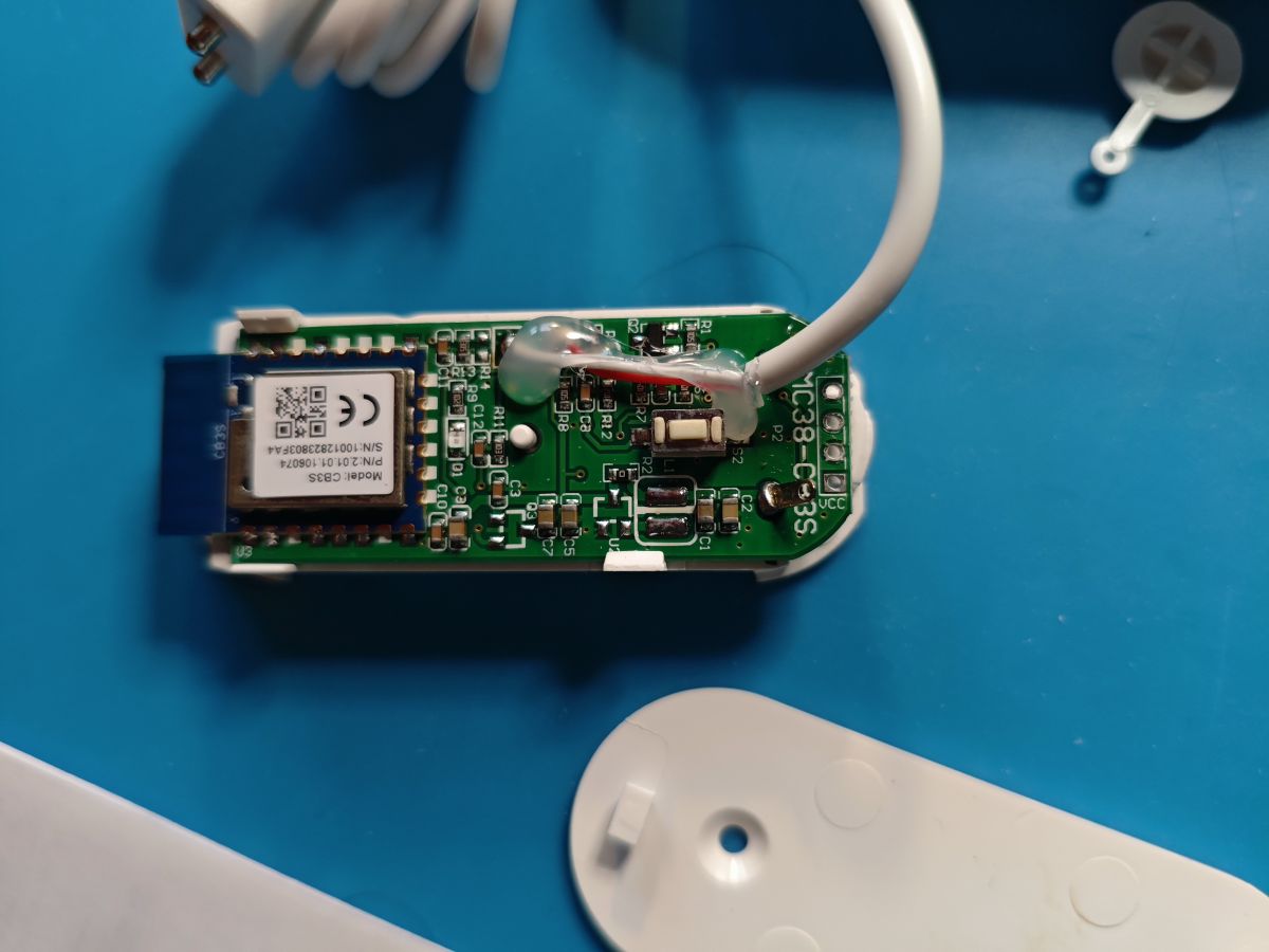

    Here's another variant I didn't think warranted its own thread. This one has a button and some test pads at the bottom of the PCB. FW ver 1.0.6 cloudcutterable.
    No soldering was performed as crocodile clips can easily be attached to all needed contacts for flashing.
    White leak sensor with a button and cable on a blue background. Tuya water leakage detector box with a drawing of the device on the front. Water leak detector packaging with barcodes and manufacturer information. WiFi flood detector instruction manual PCB with Wi-Fi module and wire, without device casing. PCB with electronic components on a blue background. PCB with CB3S module and cables on a blue background. Earykong Wi-Fi flood detector parts with an open case and instructions on a blue background. Open interior of a sensor with a circuit board and CB3S module. PCB with components and alligator clips.
    MC38-CB3S module with labels TXD1, RXD1, GND, and VCC.
    autoexec.bat with pindeepsleep. button wakes sensor as does moisture probe status change in either direction (dry/asleep -> wet and wet/asleep -> dry)
    OBK template
    https://github.com/OpenBekenIOT/webapp/pull/1...mits/efbc89f895def3b9794163e6b5fb84c8dfcef80c

  • Software-only fix for floating pin in deep sleep

    simonepiccardi
    I worked on a similar water leak sensor, based on CB3S, but I used ESPHome. I managed to solve this exact same issue by instructing the CPU to leave the pin floating during deep sleep (had to modify an already custom component though, you can find the code here: https://github.com/SimoPk/deep_sleep_libretiny/tree/main)
    I know this won't help you directly, but just to inform you this can be achieved by software only without soldering components on the board.

How do I enable DeepSleep on a CB3S/BK7231N leak sensor?
Update to a release that includes DeepSleep. You can wake on a GPIO change from the probe, or sleep for a fixed window like 15 minutes. Use DeepSleep [Time] to power down; the device reboots on wake. Pick the strategy based on latency needs. [Elektroda, p.kaczmarek2, post #20422757]
Where should I put the DeepSleep command in OpenBeken?
First verify DeepSleep works from the console: run DeepSleep 600 and confirm it goes offline and returns. After that, place DeepSleep at the end of your script branch, after publishing or measuring. If it does not trigger, fix script flow and labels first. [Elektroda, p.kaczmarek2, post #20422920]
How do I wake by timer and GPIO together for periodic battery reporting?
BK7231N now supports waking via both timer and GPIO. Follow the guide and use PinDeepSleep plus the documented settings to combine sources. “It is now working and released on N platform.” [Elektroda, p.kaczmarek2, post #21014578]
Which pin role should I use for the water probe, and how do DSEdge settings apply?
Use DoorSnsrWSleep roles: DoorSnsrWSleep (pull‑up), DoorSnsrWSleep_nPup (no pull), or DoorSnsrWSleep_pd (pull‑down). Configure DSEdge: 0=rising, 1=falling, 2=auto by state (default). This determines which edge wakes from PinDeepSleep. [Elektroda, p.kaczmarek2, post #20741347]
Why won’t it wake from water unless I short the pins?
On some builds, PinDeepSleep enables an internal pulldown (~18 kΩ), so water’s high resistance never registers a logic high. As one tester put it, “PinDeepSleep function is bugged.” This explains wakes only on a metallic short. [Elektroda, eddie.t.h, post #20741870]
Is there a simple hardware fix for unreliable wake-on-water?
Yes. Add an NPN transistor and a 10 kΩ pull‑up to 3.3 V so the MCU sees a clean 0/3.3 V. Set the probe pin to DoorSnsrWSleep_nPup and enable Flag 42 to invert readings if needed. This restores reliable wakes. [Elektroda, @GUTEK@, post #20933817]
How exactly do I wire the BC547 transistor mod and configure wake?
Wire BC547: emitter to the probe pad, collector to the white probe wire, base via 10 kΩ to VCC. Configure P8 as DoorSnsrWSleep_nPup, set DSEdge 2 (auto), and keep Flag 42 OFF in this wiring. This combination wakes reliably. [Elektroda, Mad_Maxs, post #20974957]

What template and pins work for the Earykong MC38 variant?
Use the posted OBK template: P8=dInput_NoPullUp for the probe, P14=BAT_Relay, P23=BAT_ADC, P24=Btn, P26=WifiLED. Autoexec shows PowerSave 1, Battery_Setup 2200 3000 2.46, DSEdge 0, and PinDeepSleep timing. [Elektroda, divadiow, post #21183262]
