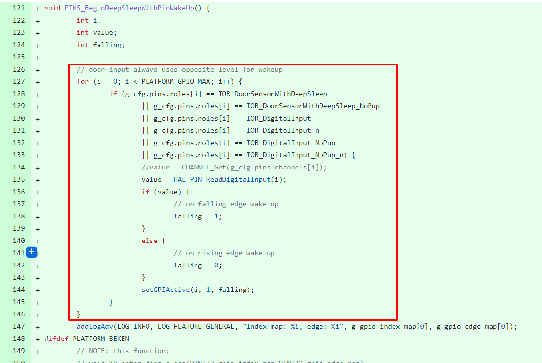

    #4 20456750
    Posts: 14781
    Rate: 12920
    Well, what about the second one? Those door sensors seems to be different.
    dheenhasty wrote:
    For the door detection, i will got with the pindeepsleep, but they will have a 30sec delay for detection..... Depending of the usecase it can be troublesome
    No worries, it's already solved. It's just that I haven't tested it on N yet, but should work as well?
    https://github.com/openshwprojects/OpenBK7231...mmit/4265f6730384180caa2adda6f7395190f38e75e7
    No commands required.
    One important change that I had to do is to add dInput (and similar) pin handling to pin deep sleep, so it checks the current input state and wakes on transition to separate state.
    [OpenBeken] Battery measurement driver based ADC with voltage divider
    Here is my test setup (the old-school switch, which is older than me, is acting like a door sensors):
    Measurements:
    I will be posting guide in separate topic soon.

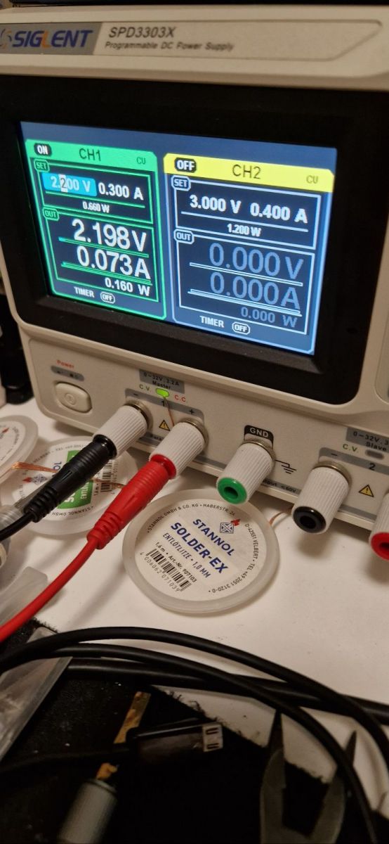

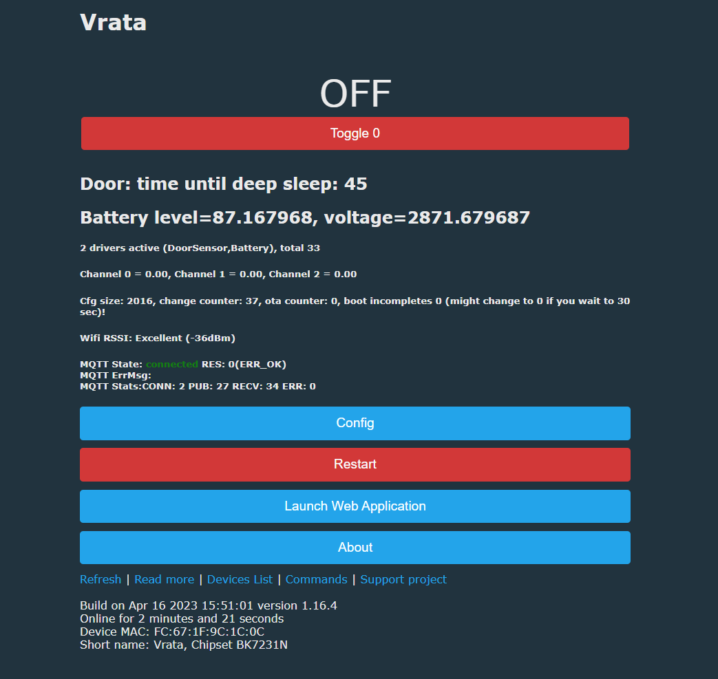

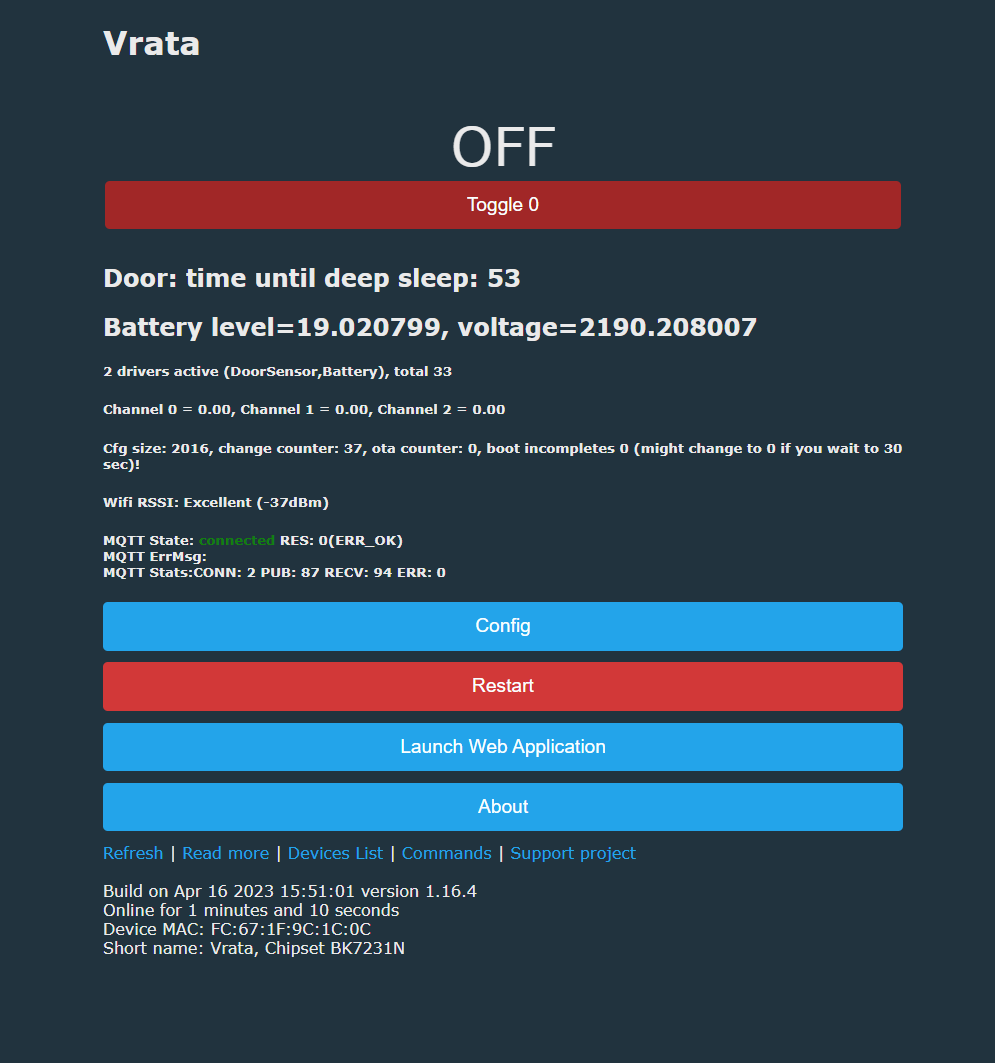

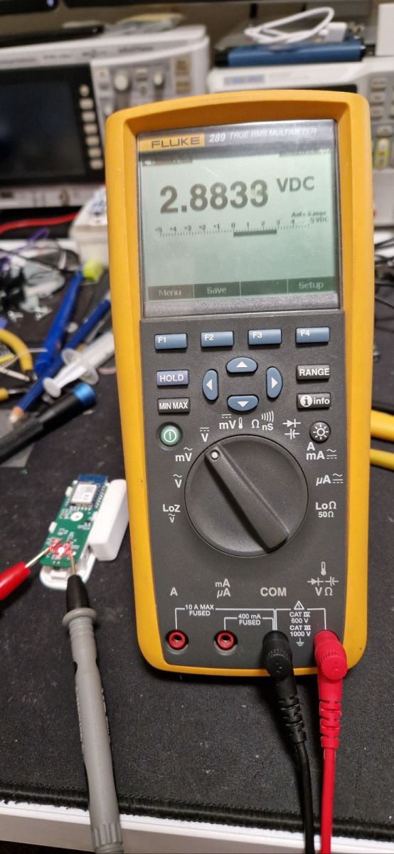

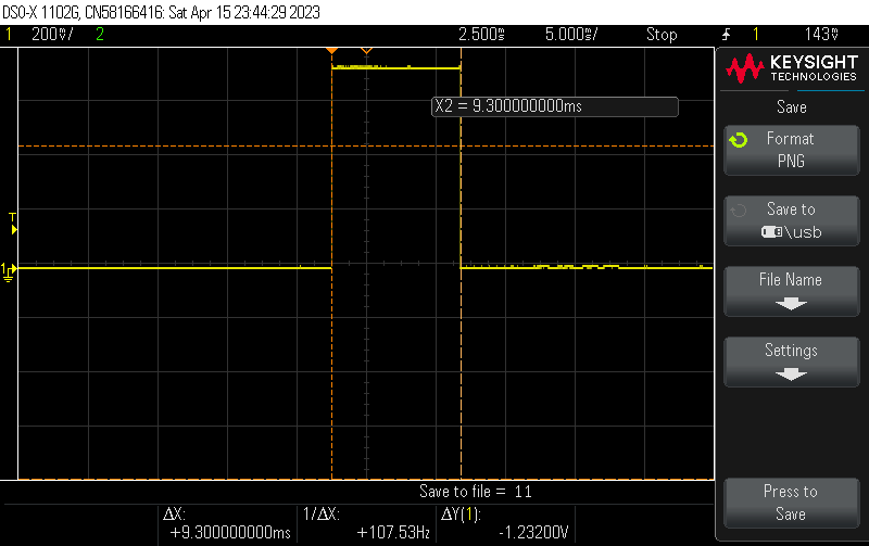

  • Measurement interval below 5 ms gives low readings
    #14 20541009
    DeDaMrAz
    Posts: 621
    Help: 34
    Rate: 130

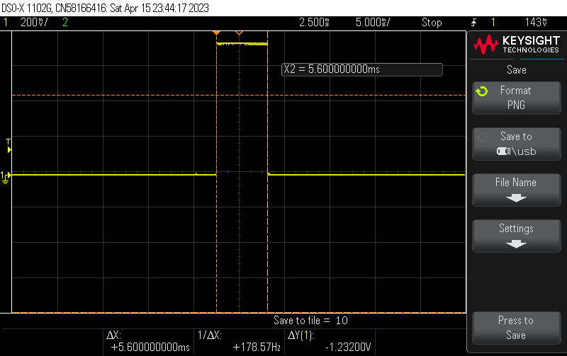

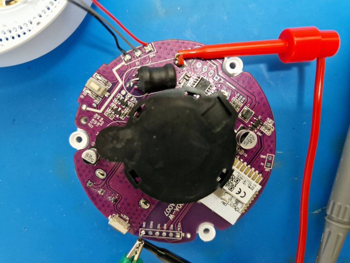

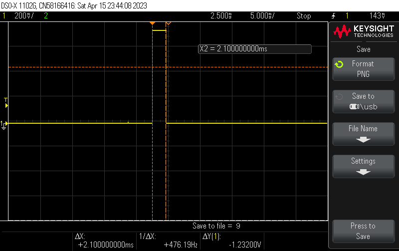

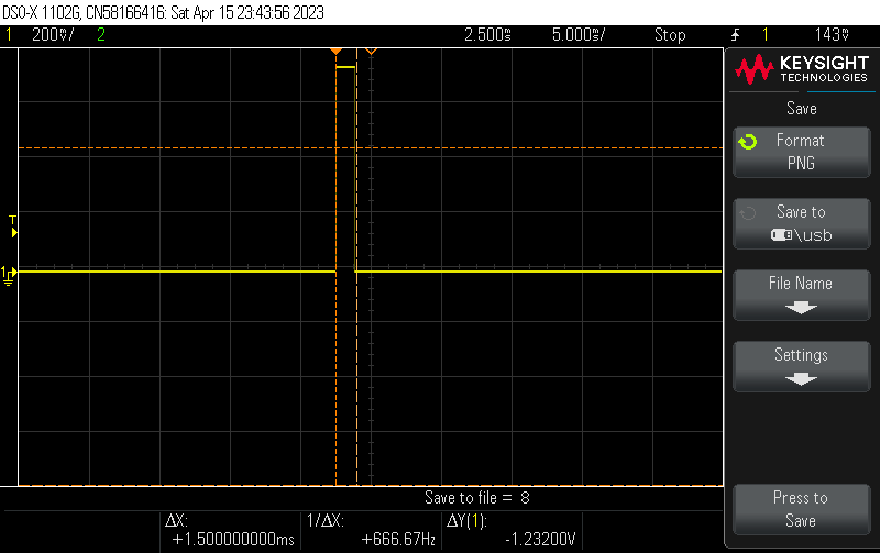

    Ok, this is what I've noticed on the bench so far.
    Measuring BAT_FET pulse with the oscilloscope (still trying to save images from it, so sorry no pictures right now).
    Measurement interval varies wildly from 1.35 to 11.1mS.
    Anything below 5ms is the wrong measurement and everything above that is valid and reassembles the input from my PSU.
    Is that time something that is configured in the driver or?
    EDIT:
    Tested on the latest fix 1.16.1
    EDIT 2: pictures added
    First two measurements (shorter pulse) are low, 72% and 76%, second two (>5ms pulse) are correct 96 and 99% respectively

    The first version included a delay. But after some test i have removed it and trust the beken..... But seems like we might need to had some delay between the switch and the measurement.

  • 10 ms pulse reading improves ADC accuracy
    #18 20542697
    DeDaMrAz
    Posts: 621
    Help: 34
    Rate: 130
    With 10mS pulse reading is much, much better. I've tested it on the entire working range (2.20 - 3.00V) with the latest 1.16.4 build.
    Here are some of the results:
    [OpenBeken] Battery measurement driver based ADC with voltage divider [OpenBeken] Battery measurement driver based ADC with voltage divider [OpenBeken] Battery measurement driver based ADC with voltage divider [OpenBeken] Battery measurement driver based ADC with voltage divider
    More testing is needed of course, but so far it looks promising. Pulse is floating around 10mS (in my case +/-0.5mS) but the reading is perfect.

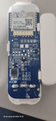

  • P26-controlled battery divider measurement with self-test
    #20 20588380
    Posts: 14781
    Rate: 12920

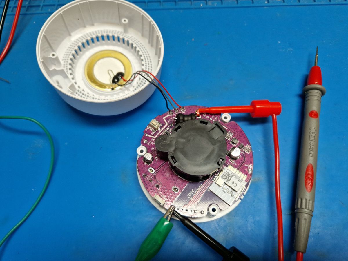

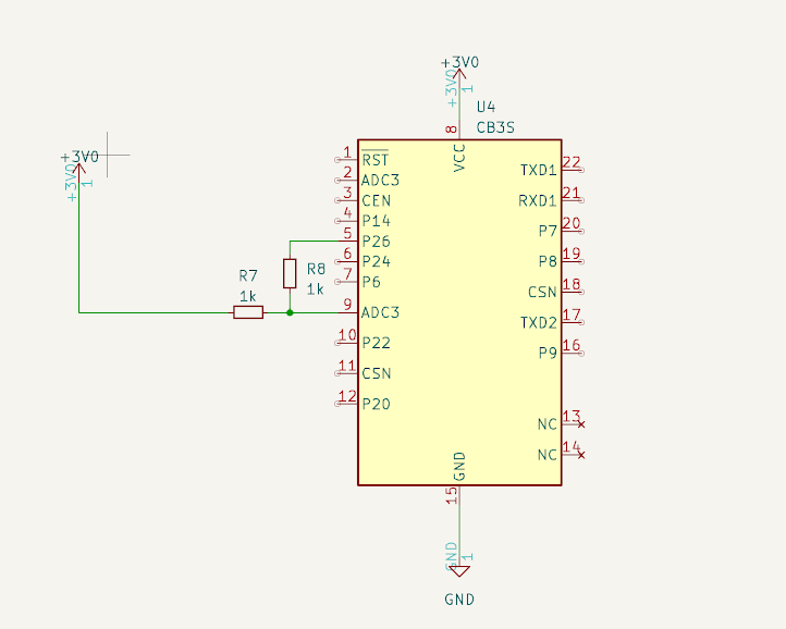

    I am working with @DeDaMrAz on smoke sensor:
    Here's how the battery measurement is done there:
    I had to introduce Bat_Relay_n for this purpose, because here, to do measurement, the P26 has to be low, so R7 and R8 form a voltage divider (divides voltage by two).
    So basically it works like it:
    - P26 is high by default
    - at measurement time, P26 is low, so battery divider works, current flows
    - after measurement P26 is high again
    I also introduced battery driver self test:

    I like the idea of getting the pin once on start, in fact most users won't change them during operation.
    Regarding the change of pins, what about a combined approach? Check if pin is still assigned the role and only if not start the searching loop again.
    But of course while saving some cycles almost every time it will cost some code/memory.
    I never though of that, I like it. I just dislike looping through a 95% unused array to find the real values over and over but this works.
    EDIT:
    After looking at it there is a problem with the "optional" bat_relay and bat_relay_n pins. Is it sufficient just to check the bat_adc pin and reassign everything based on that changing? What if you change from bat_relay to bat_relay_n but no change to bat_adc?
