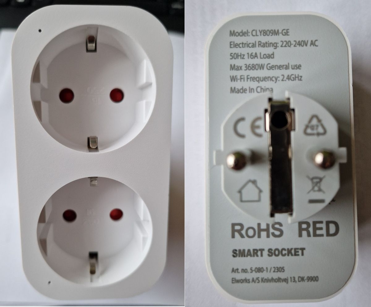

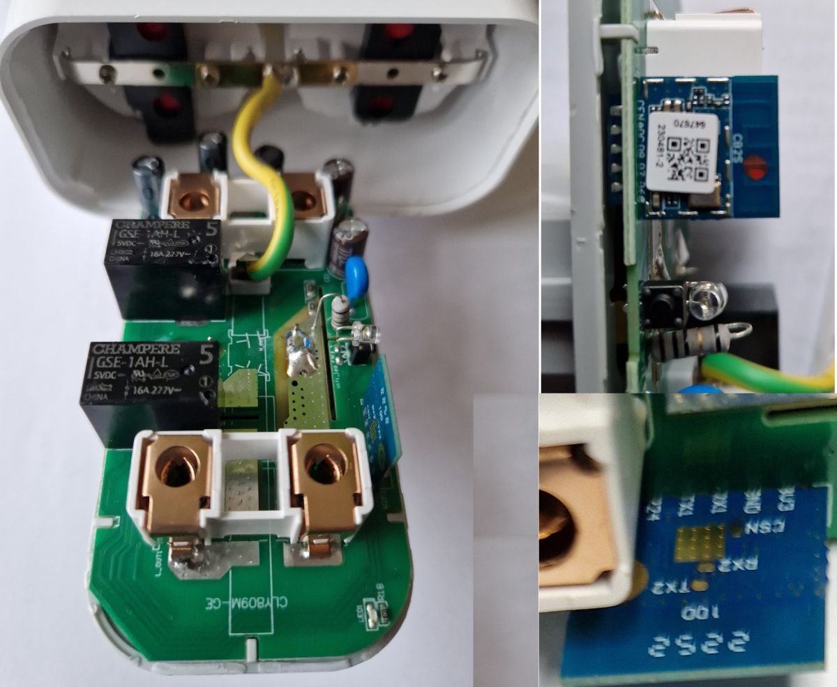

  • Bought a Tuya based dual smart socket here in Denmark for approx. 15 €, somewhat the same price as on Aliexpress.
    Double smart socket with front and back views shown in the image.
    Quite easy to separate top and bottom parts with a hobby knife and a small screwdriver:
    Close-up of the interior of a Tuya smart socket with visible electronic circuit components.

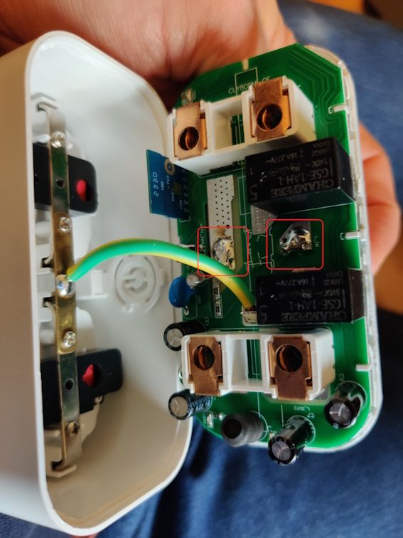

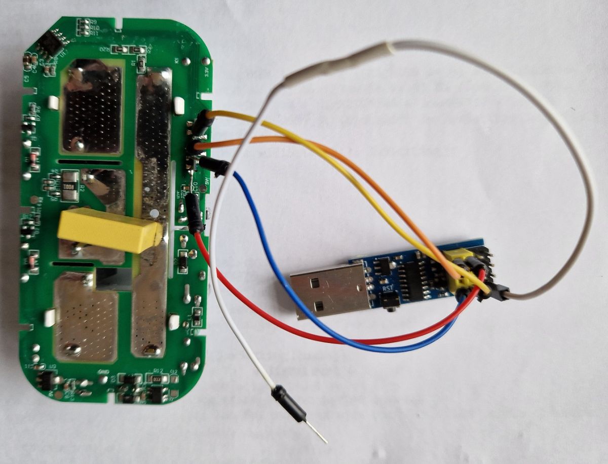

    To flash the BK7231N I needed to separate the plug part from PCB in order to reach 3V3, GND, RX1, TX1 and CEN on the CB2S module:
    Connected PCB module of a dual smart socket.

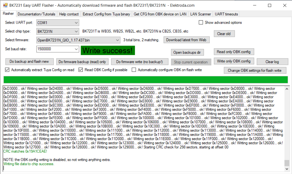

    I used the BK flasher with the following setup:
    Screenshot of BK7231 Easy UART Flasher software during sector 0xD000 writing.

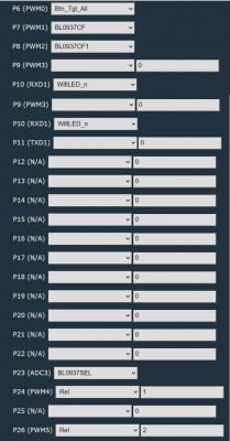

    The flash program was able to extract the Tuya parameters from the original firmware,
    and from the "Launch Web application" page, I got the nice {json} script:
    Screenshot showing PWM connections configuration with assigned functions.

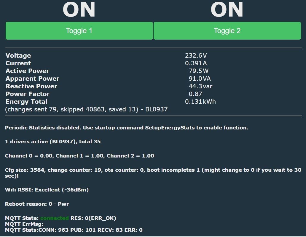

    Screenshot of the software interface for a dual smart socket.

  • Need to unsolder PCB from 230V power legs

    @snusken I have a Nedis WIFIP141FWT double smart plug, which looks identical to yours when opened, so I'm thinking your work applies, and would like to test it out. Thanks for your write-up.
    Did you have to unsolder the connection to the 230V power-legs? It looks like two big solder spots are locking the PCB onto the power-legs, and hindering the removal of the PCB, or did you just some force to break of the PCB?

  • #4 21368780
    snusken
    Hello Chris,
    As far as I remember, I used my old 100 W Weller solder gun
    and some solder wick to free the input mains pins from the PCB.
    best regards, Erik ( living place Sønderborg :) )

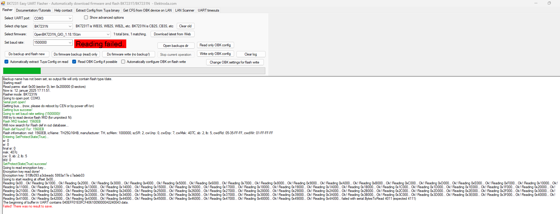

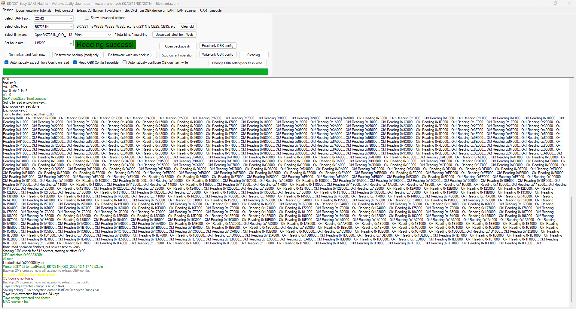

    When trying to just read out the firmware, using BK7231GUIFlashTool, it starts reading as soon as I trigger CEN for a short perioed, but then, at what seems as a random time later, it hangs, and after a while the tool displays: "Reading failed":
    Screenshot of BK7231 Easy UART Flasher software with Reading failed message visible.
    If I'm very fast to start reading as soon as 3V gets connected I can read more data before it hangs, or so it seems.
    I see some guides also mentioning adding 5V to AMS1117, maybe I missing that, or am I doing some other rookie mistake here?
    Or can anyone help me get a full read, to see everything is good, before attempting any write?
    My USB flasher is: USB TTL converter UART module CH340G 3.3V 5V switch: (aliexpress dot com/item/32668866076.html), and works with Tasmotizer.

    Are you sure about that high speed baud setting? Such high speeds never worked reliably for me.

    Thank you for taking your time to answer.
    I tried lowering it to 912600, but then got nothing, and from snuskens image of the flasher, he also had 1500000 set.
    But it might as well be bad soldering on my part.
    First I tried designing a 3D printable jig, but since that didn't work, I soldered directly to the CB2S module's legs, but I'm out of flux and the soldering is questionable. So I think I should fix that first, try at a lower baud rate, before taking up anymore of peoples time on here.
    Just got frustrated that it seemed to work, and then again not, and thought there may be something simple I was missing :)

    ChrCphDk
    Posts: 6
    Took the PCB with me to work, and had a friendly colleague solder some wires on.
    Lowered the baud rate to 921600, but it still stopped half way, but at least it got something.
    Lowered it to 115200, and bingo everything read out nicely:

    Added after 1 [hours] 31 [minutes]:
    It's working. Thank you so much for your work @snusken and all involved with OpenBK.
    Another device freed from Tuya!

  • Web-app config JSON with BK7231N pin mapping
    #11 21391319
    ChrCphDk
    Posts: 6

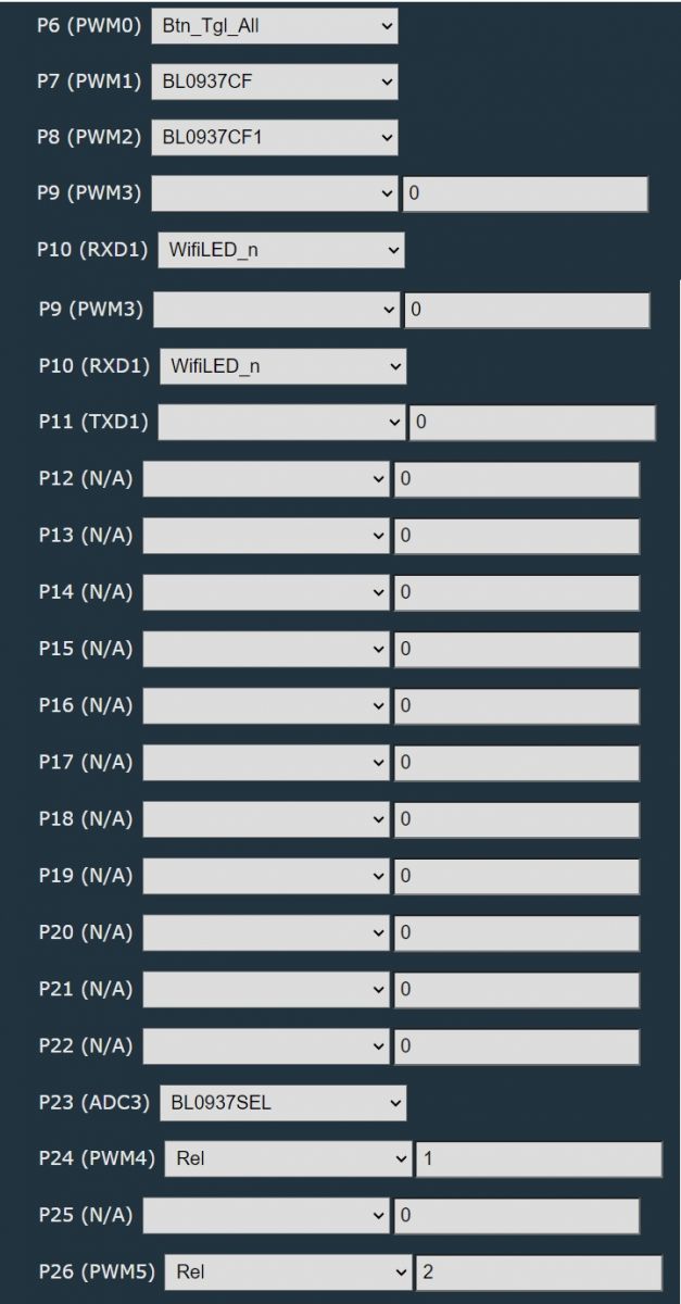

    This is from the web-app's Config menu, when accessing the device through: IP/app
      "vendor": "Tuya",
      "bDetailed": "0",
      "chip": "BK7231N",
      "board": "TODO",
      "flags": "0",
      "keywords": [
        "TODO",
        "TODO",
        "TODO"
      "pins": {
        "6": "Btn_Tgl_All;0",
        "7": "BL0937CF;0",
        "8": "BL0937CF1;0",
        "10": "WifiLED_n;0",
        "23": "BL0937SEL;0",
        "24": "Rel;2",
        "26": "Rel;1"
      "command": "",
    I have a different JSON from the flashing tool, let me know if that is also of interest.
