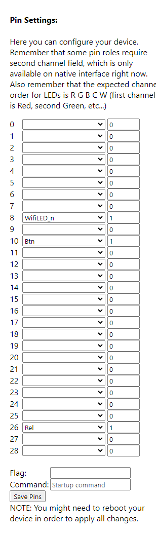

    I recently purchased a QCNX Plug because I thought they had an ESP chip, to find that they are using a BK7231N
    Since I already had the UART interface soldered (trying to flash Tasmota and failing on the process), I checked the chip and found the BK7231N inscription so I downloaded the OpenBK firmware flashing firmware and decided to flash it.
    [BK7231N] QCNX Plug with Smartmeter: ESP Chip, MQTT, Tasmota, OpenBK Firmware & Pin Settings
    And it flashed well.
    Now I have configured it via MQTT with my HA installation, and it also works well.
    Driver active says its BL0937

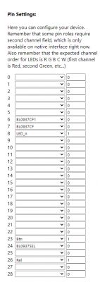

    I copied the Pin settings for a similar device (Aubess Smart Plug LSPA9)
    "pins": {
    "6": "BL0937CF1;0",
    "7": "BL0937CF;0",
    "8": "LED_n;1",
    "23": "Btn;1",
    "24": "BL0937SEL;0",
    "26": "Rel;1"

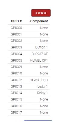

    It also could be a ELIVCO LSPA9, which has the Button on Pin 10 instead of 23.
    But I'm not sure if they are right. According to the Tasmota docs from Blakadder, these are the pins (at least for the ESP version, BASE 18)
    {"NAME":"QNCX","GPIO":[0,0,0,32,2720,2656,0,0,2624,320,224,0,0,0],"FLAG":0,"BASE":18}
    But here I find that this use a BASE28

    I don't have analyzed dump yet, but can you try: CF on P9 (ESP GPIO04), CF1 on P8 (ESP GPIO05), Sel on P24 (ESP GPIO12)? Those are mappings based on Tasmota template.
    Btw, it's worth to add a screenshot of the device:

    Maybe it's without energy meter? Or maybe it's BL0942? Remove BL0937 pin setting, reboot, and try "startDriver BL0942"...

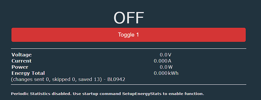

  • Switching from BL0937 to BL0942 driver
    #7 20516012
    sirlouen
    Level 4  
    Posts: 12
    I've switched to BL0942
    With pins format
      "pins": {
        "8": "WifiLED_n;1",
        "10": "Btn;1",
        "26": "Rel;1"
    Using the bootload command
    backlog startDriver BL0942; VREF 15987.125000; PREF -683.023987; IREF 272302.687500
    From ELVCO LSPA9 Power metering plug
    I have not set any of the CF, CF1, parameters.

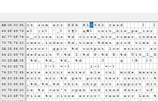

    So it's not BL0942?
    The JSON config from binary file doesn't seem to contain anything about BL0937.... but the binary has BL0942 string inside so it might be BL0942 based device:
    This is why I asked you to start BL0942 driver and try. Are you getting and correct readings on WWW panel?
  • BL0942 driver loaded and pin config shown
    #11 20516340
    sirlouen
    Level 4  
    Posts: 12
    So it's not BL0942?
    This is why I asked you to start BL0942 driver and try. Are you getting any correct readings on WWW panel?
    BL0942 is loaded
    This is the pins I currently have config'd.

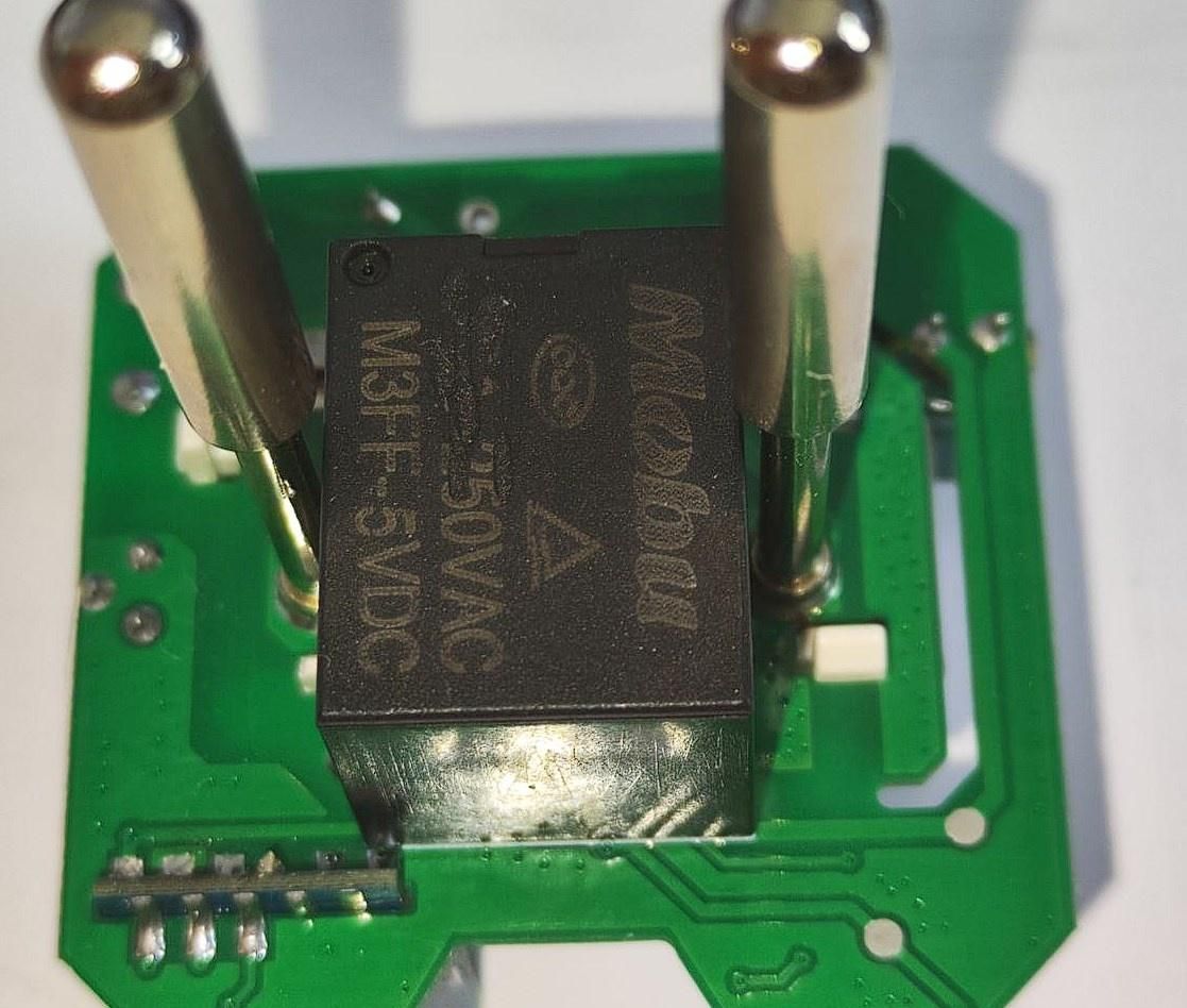

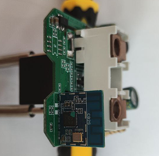

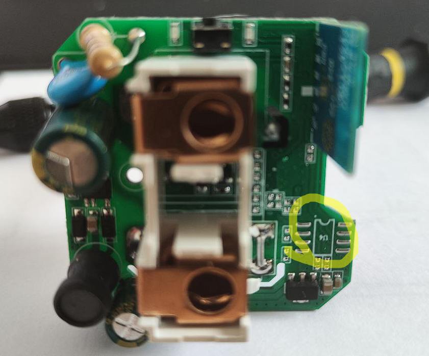

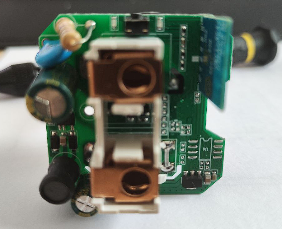

    Well, let's start with some photos from inside. Where is the BL0937 and where is WiFi module? Is WIFI module in CB2S form?
  • #15 20517632
    sirlouen
    Level 4  
    Posts: 12

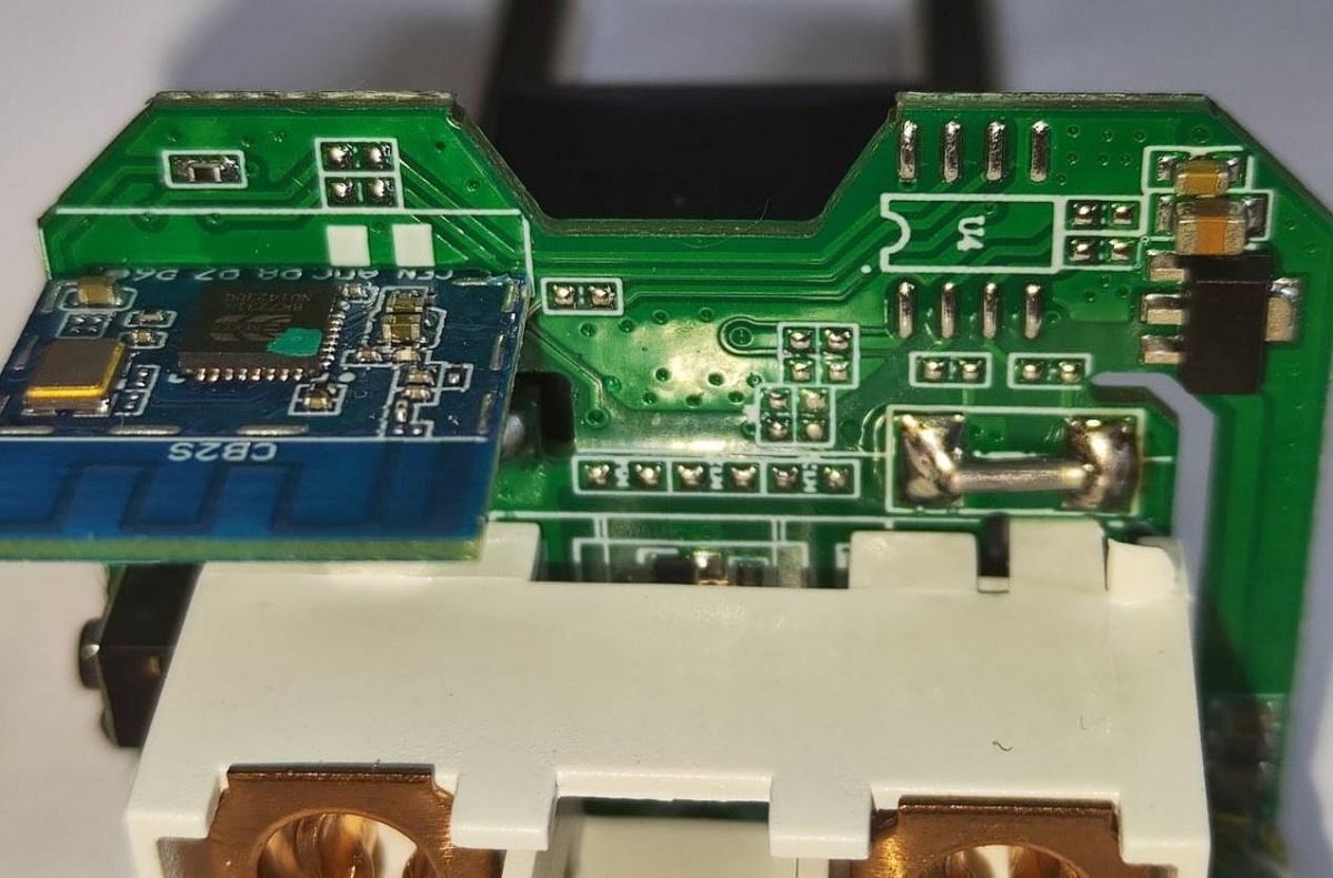

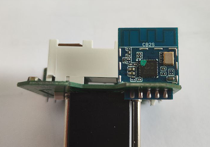

    There is CB2S:

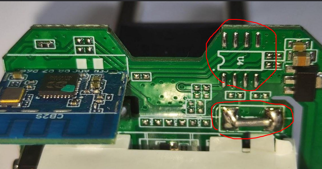

  • No power metering chip on the plug board
    #16 20517645
    Posts: 14754
    Rate: 12875
    I am sorry to say this but the photos confirms the data from the binary. It seems there is no power metering chip in this plug. There is only an empty place for one, which matches BL0937 footprint:
    If you want, you can post more photos so we can double check, because maybe I am missing something, but it really seems that this plug has no power metering chip.
    Did you test that device with original Tuya app? Did it have power metering?

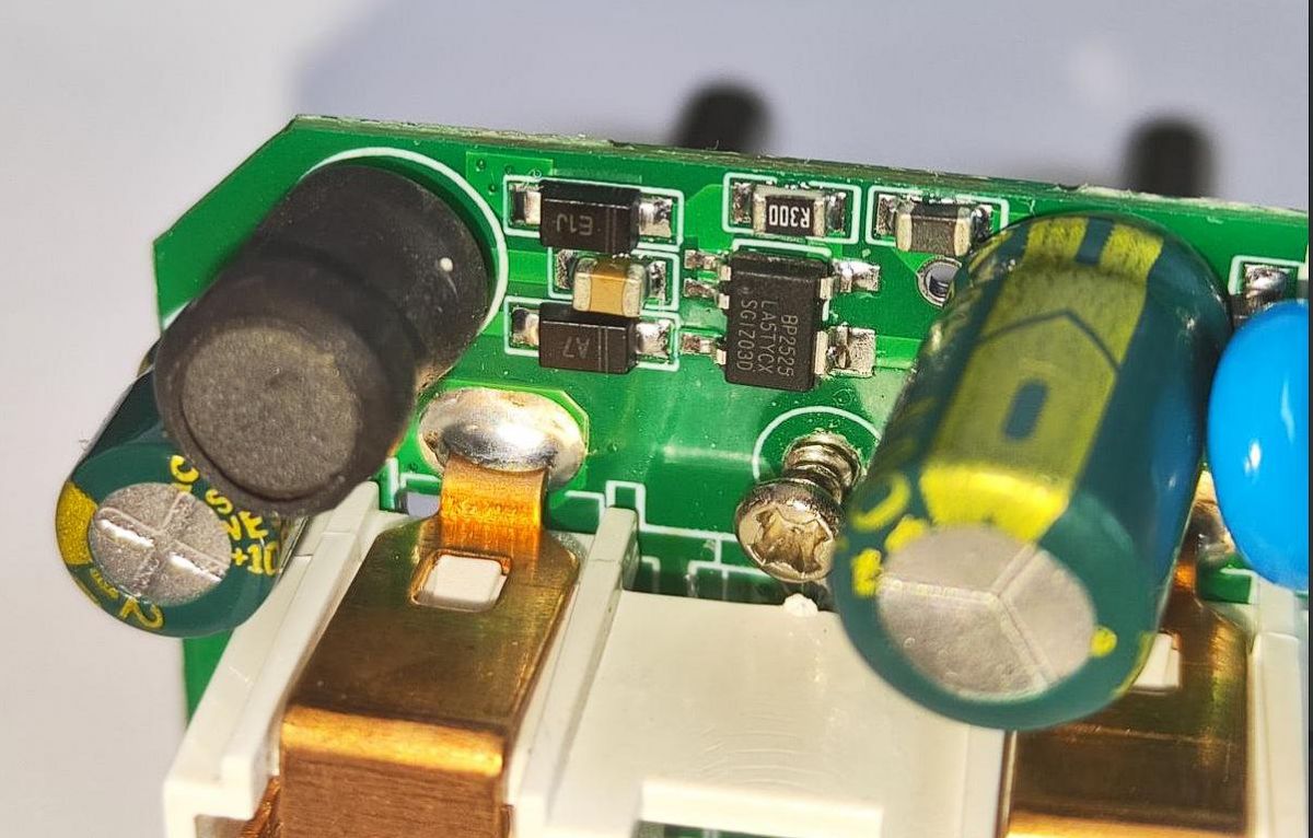

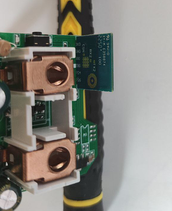

  • QCNX plug model with power monitor confirmed
    #17 20517662
    sirlouen
    Level 4  
    Posts: 12
    I did not test the Tuya app. I installed this straight away.
    More images
    [BK7231N] QCNX Plug with Smartmeter: ESP Chip, MQTT, Tasmota, OpenBK Firmware & Pin Settings [BK7231N] QCNX Plug with Smartmeter: ESP Chip, MQTT, Tasmota, OpenBK Firmware & Pin Settings [BK7231N] QCNX Plug with Smartmeter: ESP Chip, MQTT, Tasmota, OpenBK Firmware & Pin Settings [BK7231N] QCNX Plug with Smartmeter: ESP Chip, MQTT, Tasmota, OpenBK Firmware & Pin Settings
    I specifically bought the model with power monitor. There was a cheaper model without power monitor
    16A Power Monitor, EU, 100-250V, China
  • No power metering chip or shunt resistor present
    #18 20517706
    Posts: 14754
    Rate: 12875

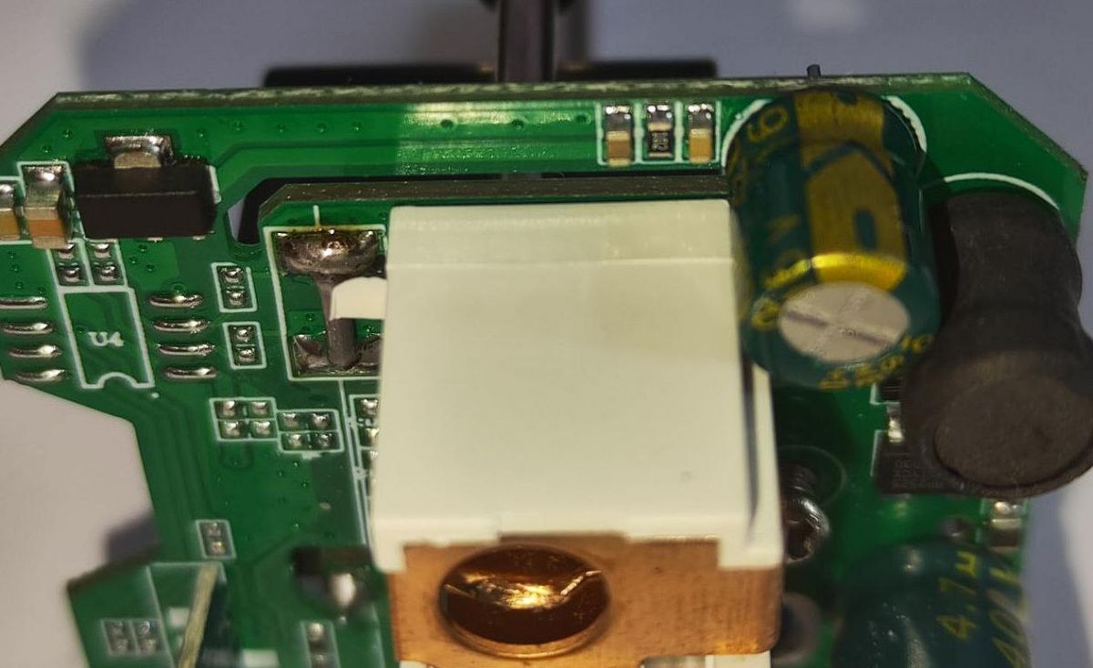

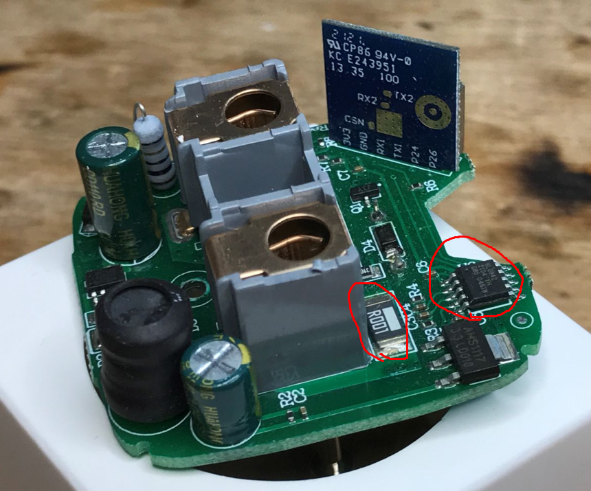

    Can you look here?
    Tuya LSPA9 smart socket - teardown, OpenBeken flashing guide for CB2S, BL0942
    This is my old LSPA9 teardown. The power metering sockets have the SOIC/SO/SSOP chip populated, here:
    They also have a shunt resistor populated, because it is required to do measurements. By measuring a voltage drop on shunt resistor, and knowing the resistance value, the current can be calculated.
    Your device, on other hand:
    has no BL0942/BL0937 IC and furthermore, the is no shunt resistor - it is replaced with a jumper soldered in it's place.
    I am sorry, but I am 100% sure that your device has no power metering capability. Please open a ticket/dispute on Aliexpress and you may try to receive a refund. I had issues with them several times, but usually they refunded the money. At least part of it.
  • Wrong QCNX variant lacks power metering

Open the enclosure and read the radio module silkscreen. If it says CB2S, it is a Tuya BK7231N module. The shared teardown photos clearly show a CB2S on this board. That indicates different firmware needs than ESP devices. [Elektroda, sirlouen, post #20517632]
What pin mapping works for relay, LED, and button on this CB2S board?
Use the Tuya JSON discovered in the backup: Relay on P26, Wi‑Fi LED on P8 (active‑low), and Button on P10. In OpenBeken, set Rel;1 on P26, WifiLED_n;1 on P8, and Btn;1 on P10. Save and reboot to apply. [Elektroda, p.kaczmarek2, post #20515896]
How can I check if power metering hardware (BL0937/BL0942 + shunt) is actually present?
Open the plug and inspect the energy‑meter IC footprint and the low‑value shunt resistor. The teardown showed both missing, with a jumper replacing the shunt. "I am 100% sure that your device has no power metering capability." If missing, energy reporting cannot work. [Elektroda, p.kaczmarek2, post #20517706]
OpenBeken shows no power readings; what is the likely cause?
If the board lacks the BL0937/BL0942 IC and the shunt resistor, reported power stays at 0. The teardown confirmed an empty meter IC footprint and a jumper in place of the shunt on this model. Remove any metering driver assignments in that case. [Elektroda, p.kaczmarek2, post #20517706]
How do I find CF, CF1, and SEL pins without a schematic?
Trace from the metering IC pads to the module pins, or use multimeter continuity. "The simplest way is to follow the traces on the board." If the IC is unpopulated, those signals won’t exist, so skip configuring CF/CF1/SEL. [Elektroda, p.kaczmarek2, post #20514056]

How do I map ESP GPIOs from Tasmota templates to CB2S pins?
Use the suggested mapping from the thread when testing: CF on P9 (ESP GPIO04), CF1 on P8 (ESP GPIO05), and SEL on P24 (ESP GPIO12). This mirrors a Tasmota template approach for initial validation. [Elektroda, p.kaczmarek2, post #20515896]
The listing promised power monitoring, but my board has no meter. What should I do?
Open a dispute with the seller. Attach photos that show the empty BL0937/BL0942 pad and the shunt replaced by a jumper. The moderator advised this route and noted sellers typically issue refunds when presented with clear evidence. [Elektroda, p.kaczmarek2, post #20517706]
Is this plug BL0942- or BL0937-based?
The firmware dump contained a BL0942 string, so starting the BL0942 driver was advised to test. On this particular board, no metering IC was populated, so readings remained zero regardless of driver selection. [Elektroda, p.kaczmarek2, post #20516283]

What pin configuration should I use for a non-metering QCNX/ELIVCO-style socket?
Set only the essentials: P8 as WifiLED_n;1, P10 as Btn;1, and P26 as Rel;1. This configuration matched the confirmed working setup without any energy meter present on the board. Save and reboot after applying. [Elektroda, sirlouen, post #20516012]
Can a 2MB Tuya backup reveal the pinout?
Yes. Parsing the 2MB dump produced a JSON that identified Button on P10, Wi‑Fi LED on P8, and Relay on P26. These assignments worked when applied in OpenBeken. Energy signals were absent in the dump’s config. [Elektroda, p.kaczmarek2, post #20515896]
