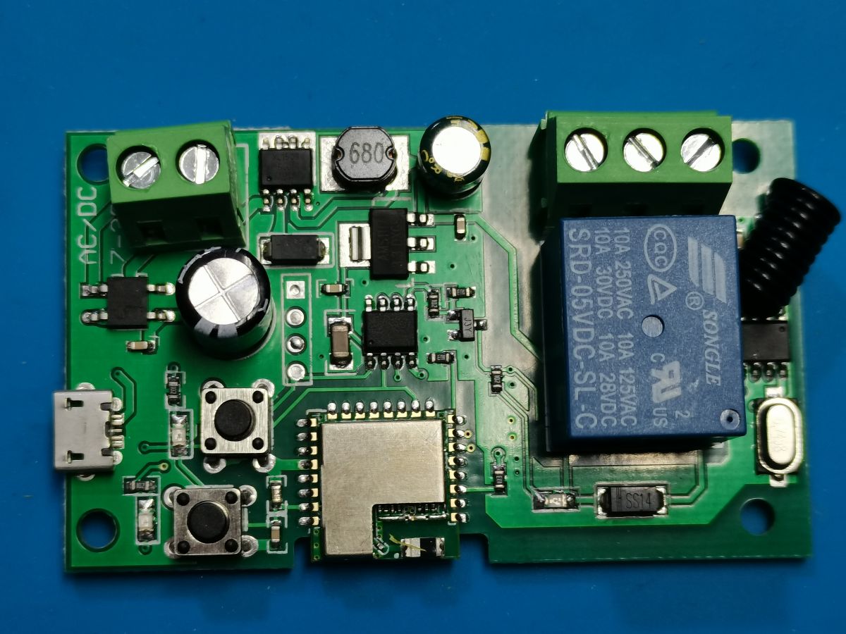

    Hi, I've purchaded this wifi relay from aliexpress (manual shows that it is a DC7-32Pro)
    https://es.aliexpress.com/item/1005006511781009.html
    Close-up of a WiFi relay circuit board with green connectors and a Songle relay.
    If I put it in pairing mode (relay button for several seconds) it shows a SSID called ITEAD-1002129f4f
    It listens port 80 TCP at 10.10.7.1 and shows a web with the message "SONOFF"
    Ewelink app also recognizes it.
    So, although aliexpress shows that is a Yiweilian, in fact it is an Sonoff

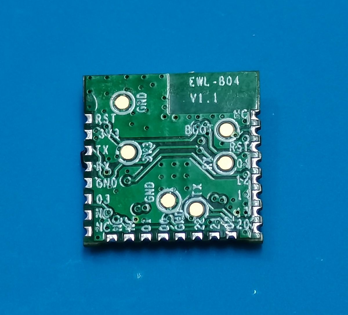

    So I removed the chip board to look for UART programming ports:
    Close-up of a circuit board with labeled pins: BOOT, RST, 3V3, TX, RX.
    And found them (TX, RX, BOOT, GND and 3V3)
    Close-up view of a bare EWL-B04 V1.1 printed circuit board.

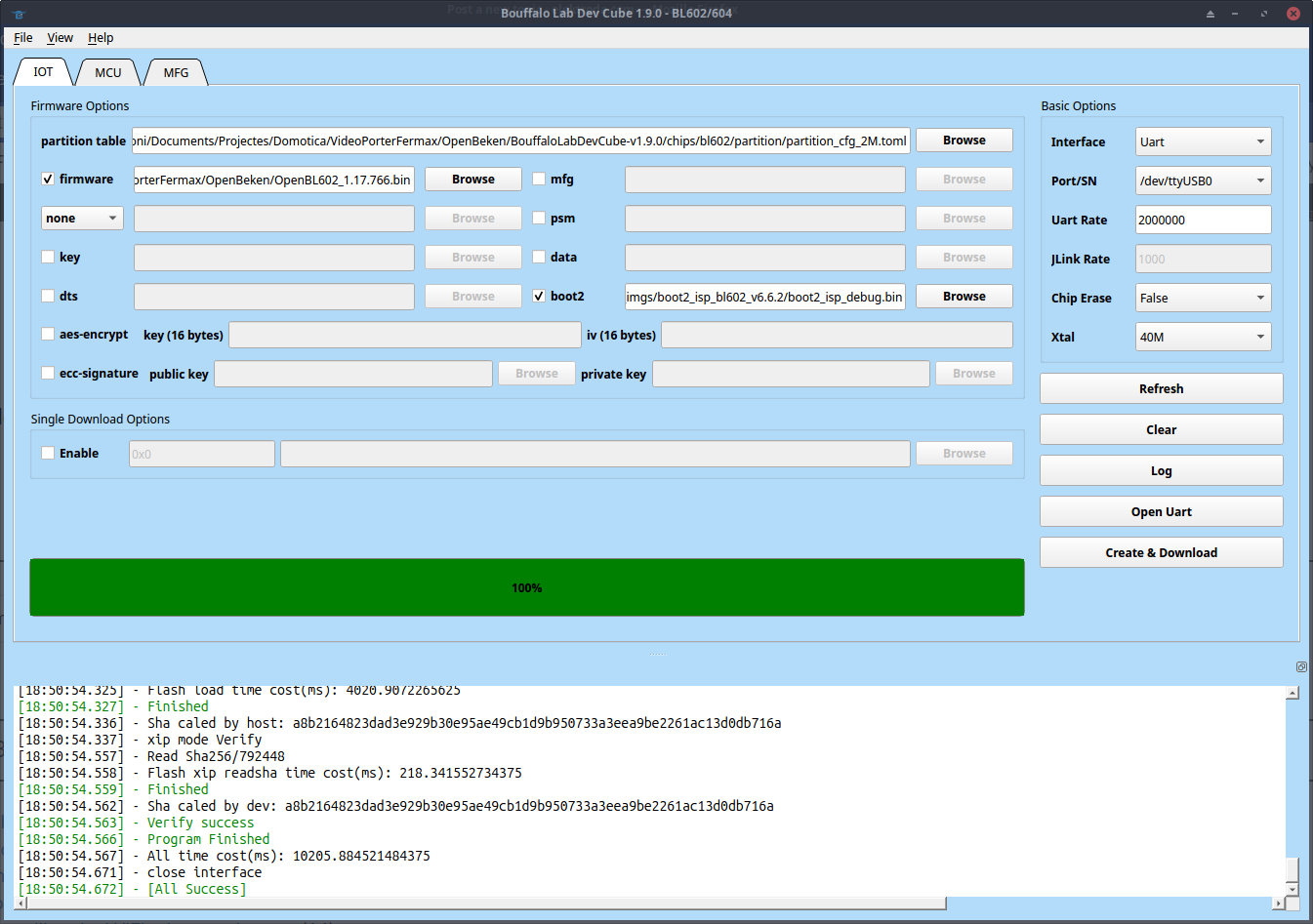

    So I've installed BouffaloLabDevCube-v1.9.0 on my Ubuntu and tried to flash (booting it with BOOT pin connected to 3V3 using a 10Kohm resistor)
    Bouffalo Lab Dev Cube application screen with filled firmware options.
    After reboot I can see OpenBL602_43C90001 SSID and then I can connect it I get the access to OpenBeken at http://192.168.169.1

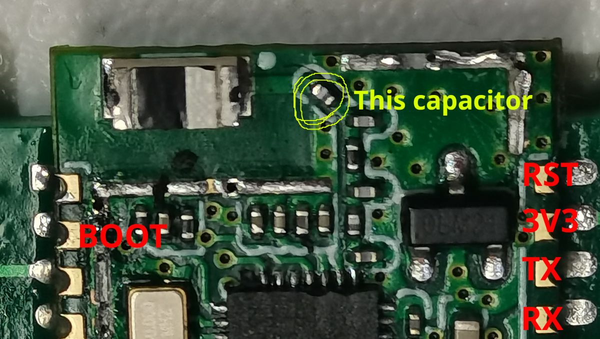

    Unafortunatelly, when I removed the IC miniboard from the board I removed also a small capacitor, I don't know how important is.
    Close-up of a circuit board with marked points BOOT, RST, 3V3, TX, RX and a highlighted capacitor.
    With this config:
    I got:
    - Red LED always blinking.
    - When I push relay button the relay turns on for only 2 seconds, after that switches off.
    But if I push it again before the 2 seconds, it switches off correctly.
    I don't know how to solve that.
    Perhaps is the capacitor that I've lost...
    And also, when I try to detect GPIO with "GPIO Finder" the device stops responding IP, wifi is connected and button and relay are working but not web
    or ping access.
    - Any idea?
    is it gone gone or do you still have it around and could potentially repair?
  • #3 21297354
    elbuit
    Posts: 10
    Rate: 7
    It's gone and I don't know the capacitance.
    It was really small, so it should be a few nF.
    I'll try to put another one with a similar "size"
