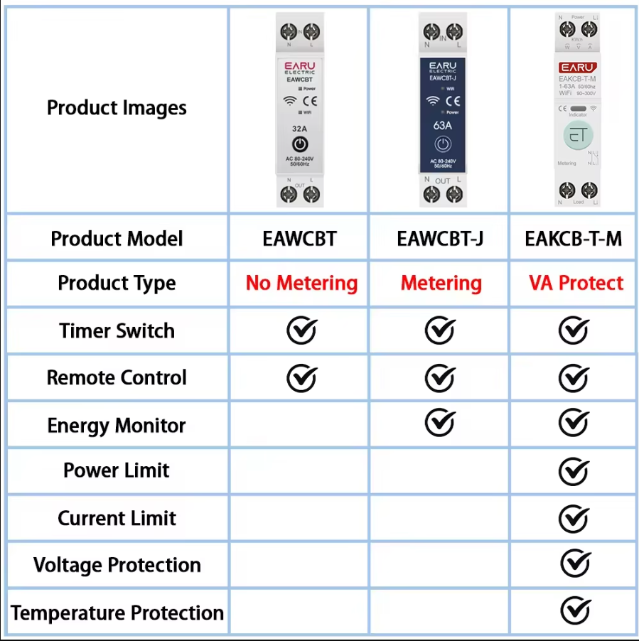

    I want to buy this smart switch with VA Protect (the right one)
    Comparison chart of smart switches with models EAWCBT, EAWCBT-J, and EAKCB-T-M

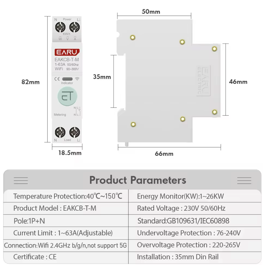

    Diagram and parameters of the EARU EAKCB-T-M smart switch.
    It is specified as "Circuit Breaker", I'm not sure it is, is it?
    It is safe enough to replace my current regular circuit breaker with this smart switch? or the better way is to connect my current regular circuit breaker to this smart switch for safety?
    I just don't want to burn my electrical appliance or my electrical board.
    Thanks.

    mipix
    Posts: 4067
    Help: 495
    Rate: 1475
    Don't think of this thing as a safety device. It's more like a smart switch on a relay without a short-circuit arc extinguishing chamber. Secure it with a standard installation circuit breaker. Automatically or with a fuse.
