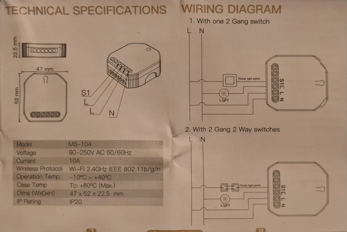

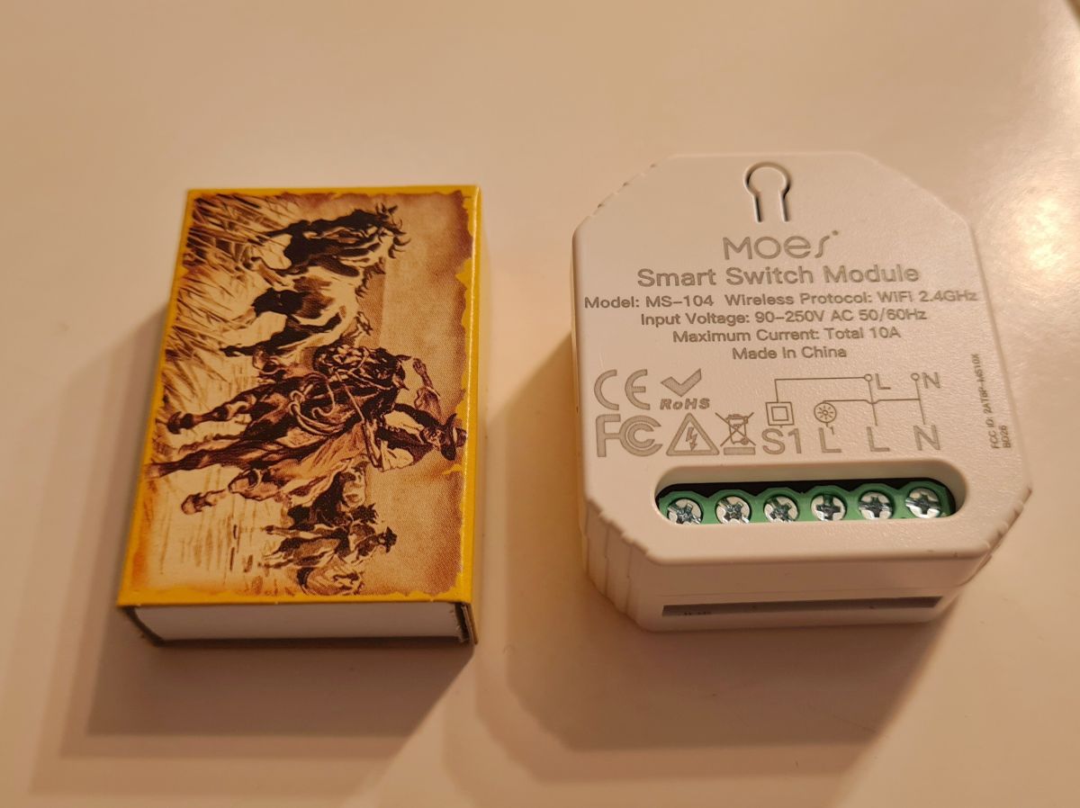

  • Moes Smart Switch Module MS-104 is a 1-gang WiFi smart switch module built around a Tuya CB2S (BK7231N) WiFi module.
  • The 1-gang board appears to share PCB design with the 2-gang version, while the 4-gang version uses different internals.
  • It supports 90 - 250V AC 50/60Hz input and up to 10A current.
  • Pin mapping identifies Pin23 as Button1, Pin24 as Relay1, and Pin26 as a PWM buzzer.
  • A solder blob between the CSN pad and adjacent cooling pad puts CB2S into programming mode, and hid_download_py flashed the latest release.
  • Module name: Moes Smart Switch Module MS-104
    Protocol: WiFi 2,4GHz
    Input Voltage: 90 - 250V AC 50/60Hz
    Max Current: 10A
    Wifi module: Tuya CB2S (BK7231N) datasheet
    This is the 1 gang vesion of the module there is also a 2 gang version available (obviously with the same PCB based on tear-down).
    Bought it on aliexpress from MOES Online store. It has also Zigbee, Zigbee+RF, WiFi+RF versions.
    4 gang version has different internals, see tear-down in other topic: Link
    Flashed latest release with python flasher: hid_download_py

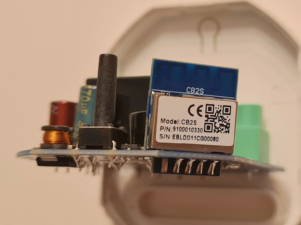

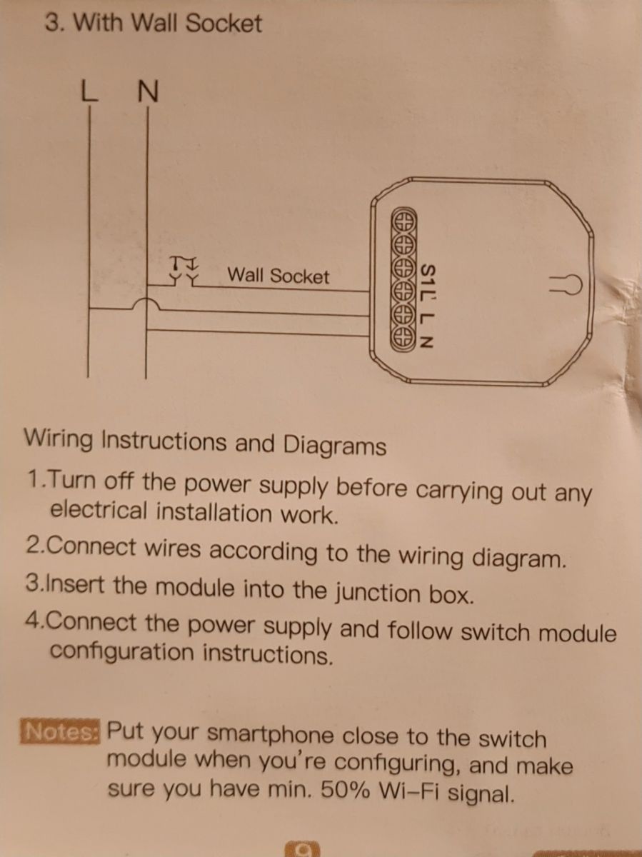

    Pictures of the module:
    [BK7231N CB2S] Moes Smart Switch 1 gang WiFi - MS-104 [BK7231N CB2S] Moes Smart Switch 1 gang WiFi - MS-104 [BK7231N CB2S] Moes Smart Switch 1 gang WiFi - MS-104 [BK7231N CB2S] Moes Smart Switch 1 gang WiFi - MS-104 [BK7231N CB2S] Moes Smart Switch 1 gang WiFi - MS-104

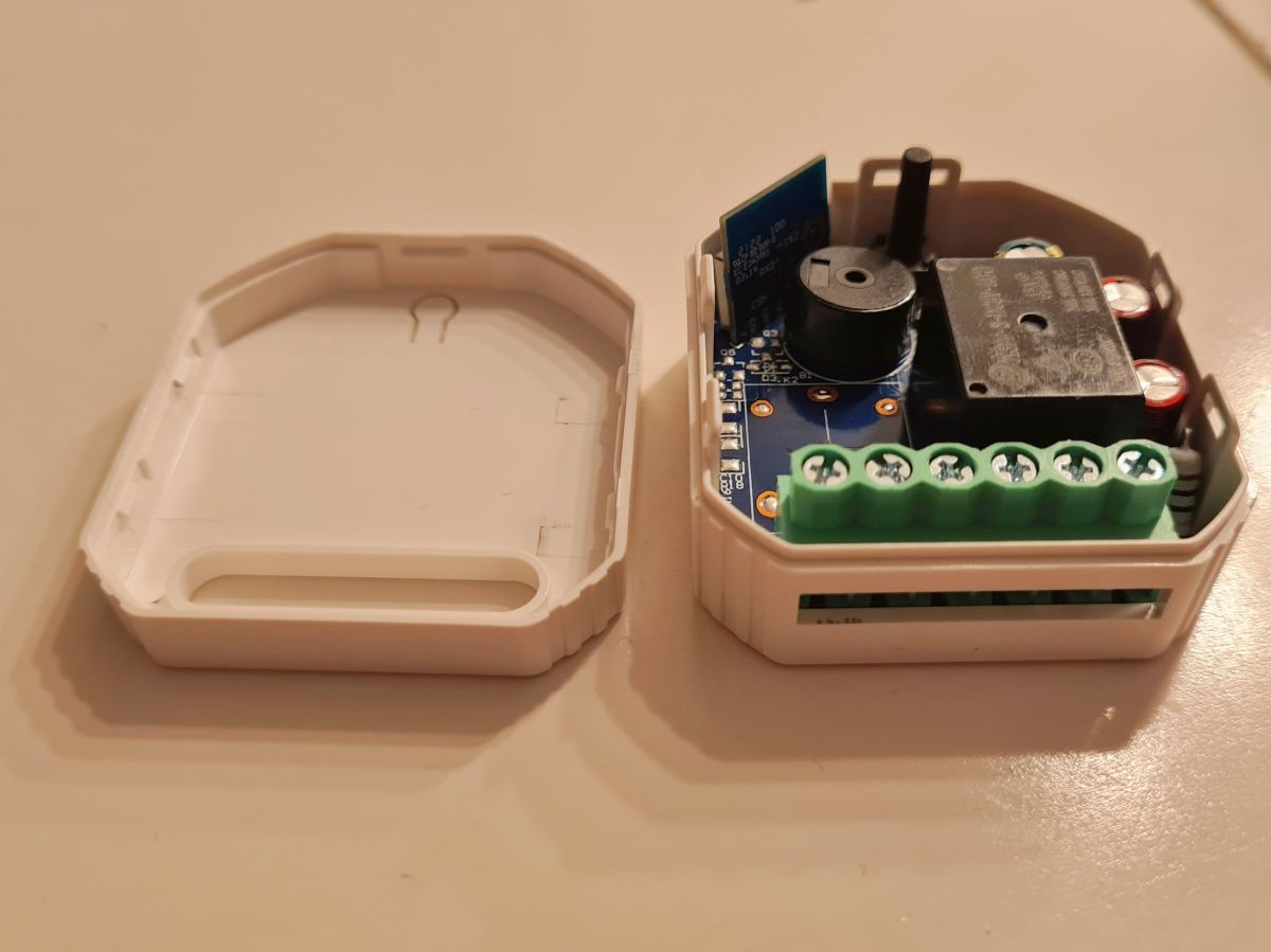

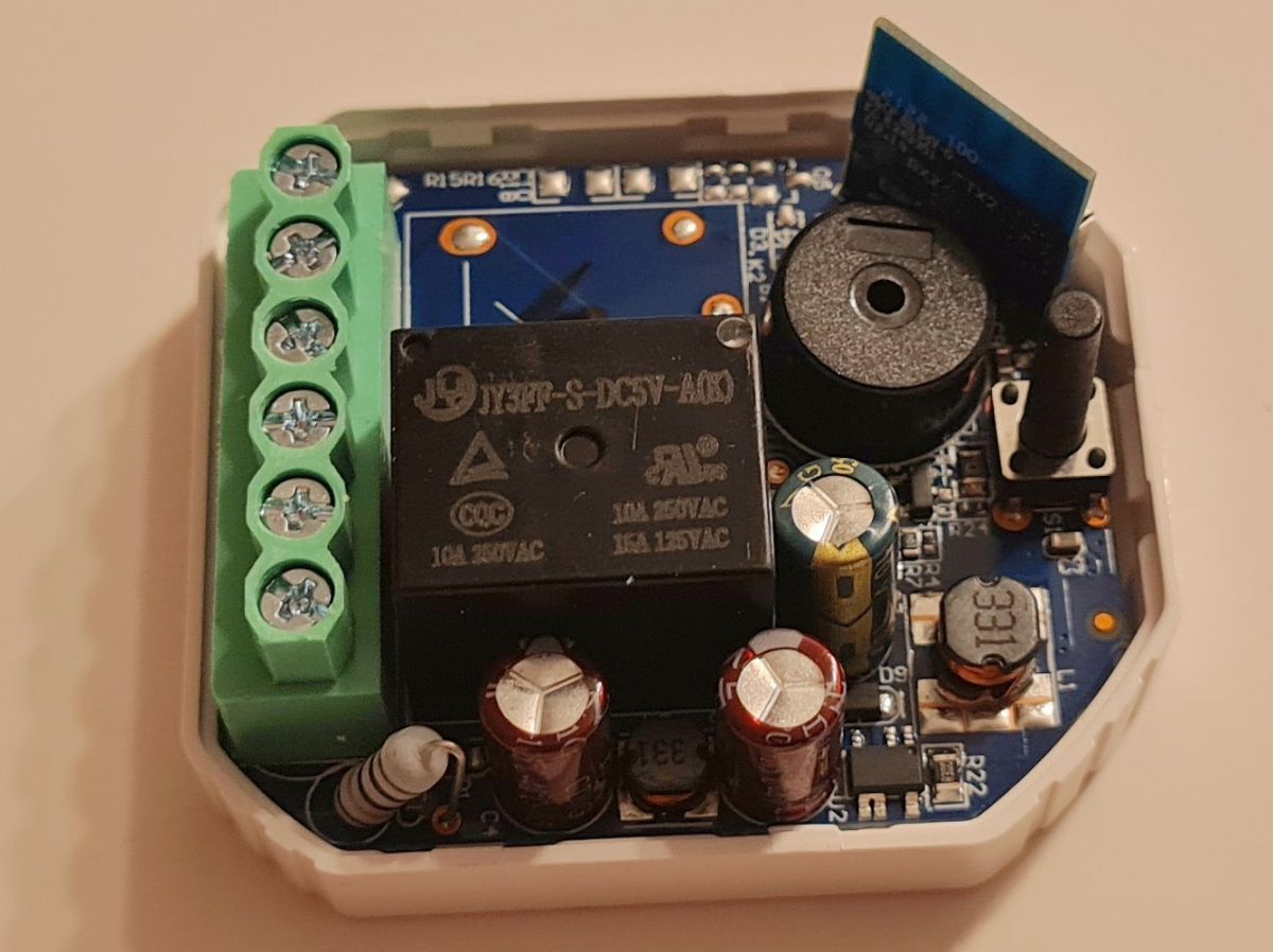

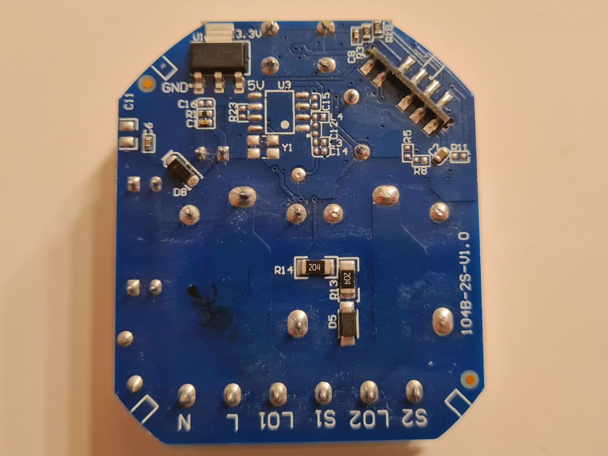

    Tear-down of the module:

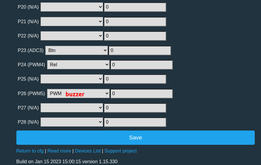

    Pin config:
    Pin23: Button1
    Pin24: Relay1
    Pin26: Buzzer (works as PWM)

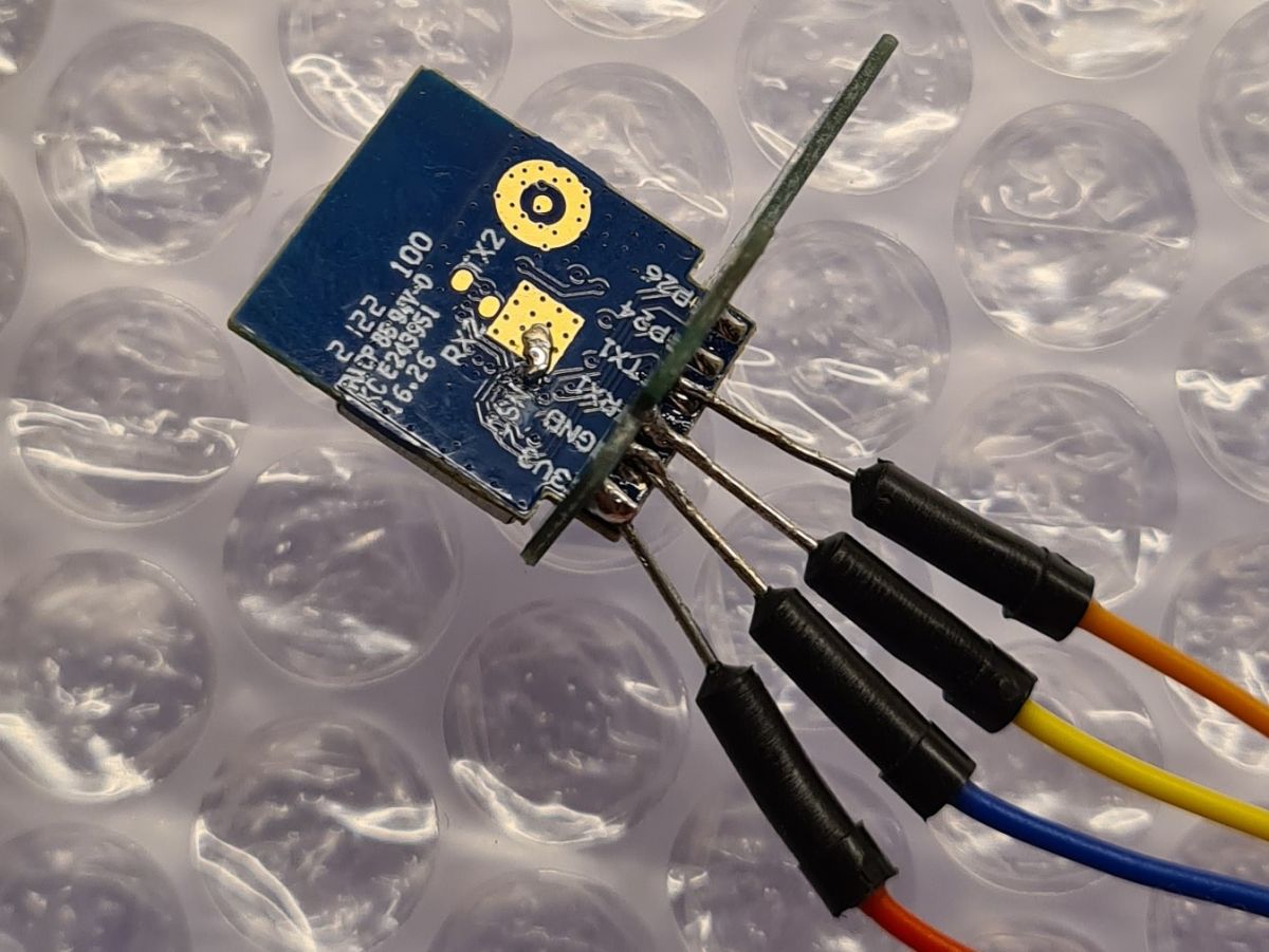

    Edit:
    One easy way I have found to put CB2S into programming mode to put a solder blob between CSN pad and the cooling pad next to it to ground it:

  • #2 20409374
    Posts: 14756
    Rate: 12881
    Thanks! I haven't seen a device with buzzer on configurable pin yet. Do you think it would be useful to add some scriptable commands for playing tunes with buzzer?
  • #3 20410068
    spln
    Posts: 7
    Rate: 10
    Well, I don't have a use case in mind for the buzzer in my setup.
    But some people might want to play around with it for like an alarm or smart doorbell.
  • #4 20410122
    Posts: 14756
    Rate: 12881
    How was it working with original Tuya firmware?
  • Buzzer likely replaces LED status indication
    #5 20411399
    spln
    Posts: 7
    Rate: 10
    Well I haven't tried it with Tuya fw. My guess is that it's the same as the dimmer version with the Tuya MCU: Link
    Perhaps the idea was to notify connection issues by sound when the module is installed in a wall box behind the switch.
    Also this one doesn't have any LEDs, they have added the buzzer instead. In the linked thread it's mentioned that the beeps correspond the LED blinks on that module.

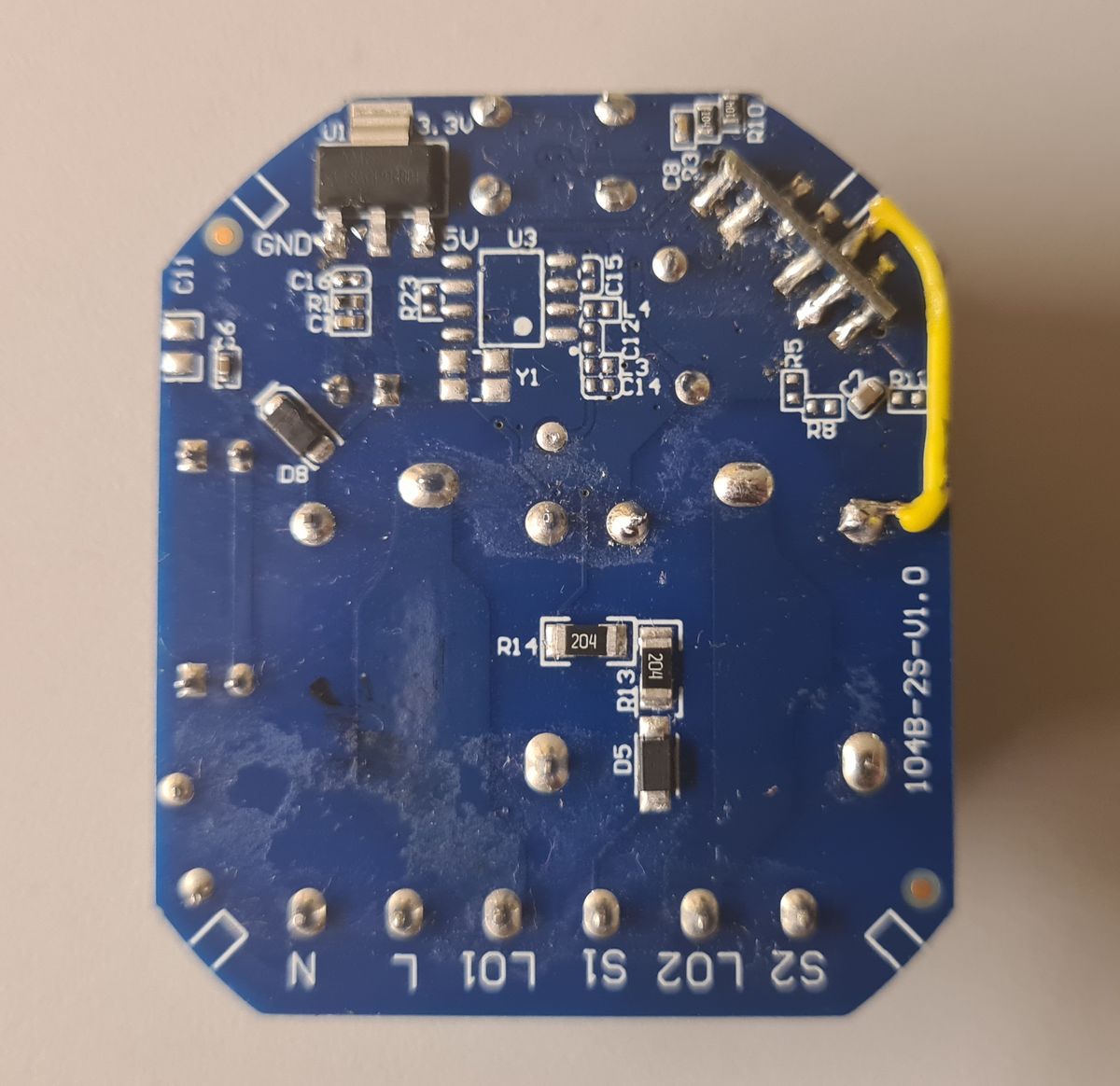

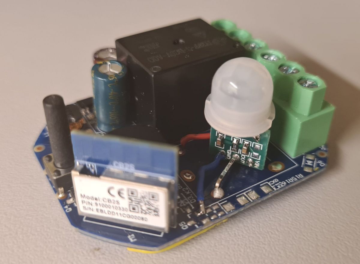

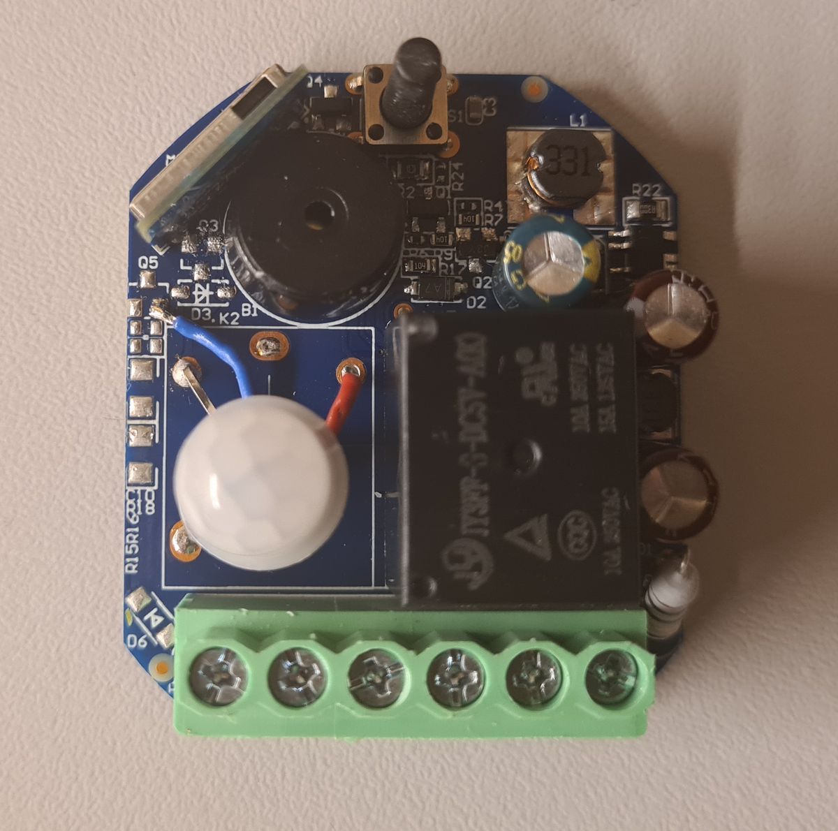

  • PIR motion sensor mod using spare relay footprint
    #6 20726105
    spln
    Posts: 7
    Rate: 10
    I have created a PIR motion sensor mod of this sensor. See pictures below.
    Used the place of the second relay for this. Checked the PCB and found out that one of the holes for the relay has 5V. There is also a ground pad nearby, and the other whole is not connected anywhere, so that became the PIR sensor output to easily get to the back of the PCB to connect to the CB2S.
    Used this sensor from Ali: aliexpress.com
    Pin config is the following:
      "pins": {
        "7": "dInput_NoPullUp;0",
        "23": "Btn;0",
        "24": "Rel;0"
    Moes smart switch module with PIR sensor
    Close-up of a modified PCB with a yellow wire soldered on the surface.
    Modified PIR motion sensor mounted on a PCB with a relay and other electronic components.
    Close-up of a modified PCB with a PIR motion sensor, relay, and CB2S module.
  • #7 20726469
    Posts: 14756
    Rate: 12881
    Very nice mod. Given enough free GPIOs, you can still connect more sensors, like a DHT11 which requires just one GPIO and can give you temperature and humidity measurements.
