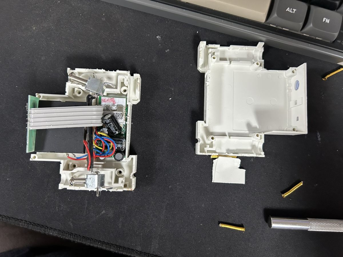

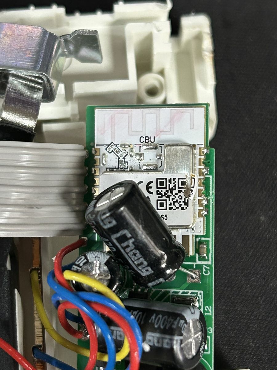

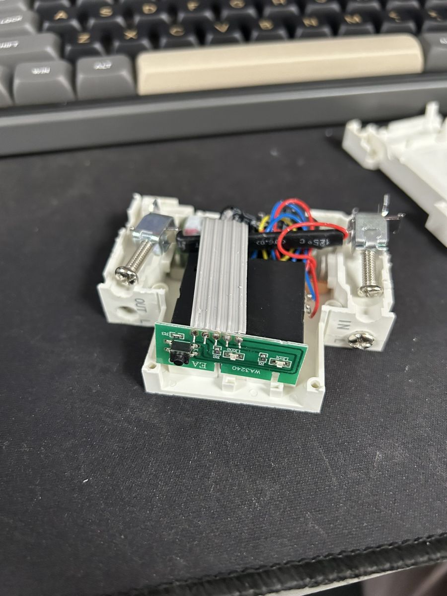

    Opened:

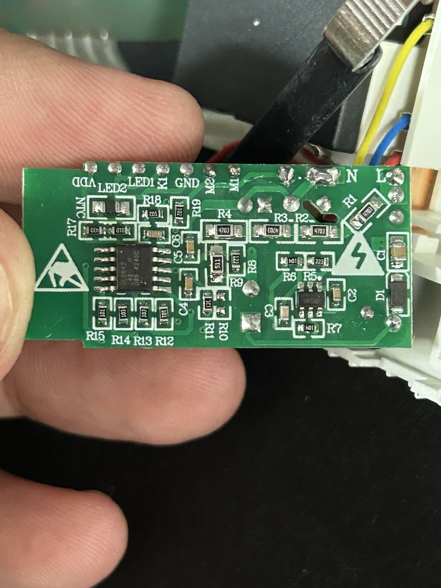

    Disassembled Tuya WiFi Smart Circuit Breaker 63A on a table. Open interior of a circuit breaker with electronics and wiring on a black background.Close-up of a Tuya WiFi circuit board with visible electronic components. Close-up of an electronic module with capacitors and colored wires.
    It opens just like this one.
    It has a CBU module. I was able to flash OpenBeken through UART.
    Downloaded the tuya firmware, but wasn't able to open it in any tool.
    readResult...-03-43.bin (2 MB)You must be logged in to download this attachment.

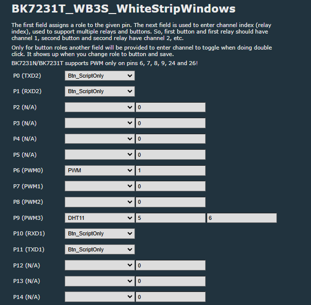

    I'm new to openbeken (I'm more of a tasmota/esphome guy), is there a way to sincronize the LED to the state of the bridge relay?

    Thanks for sharing. I see you've even filled the topic field of the template, nice!
    Of course you can sync LED to the relay - just set the same channels for LED pin as you've set for the Bridge. The channels are used to group together things like buttons, LEDs, relays, etc. You can do this in this view:
    Screenshot of the BK7231T_WB3S_WhiteStripWindows configuration with pin settings.
    Did you attempt to run PowerSave 1 on your device? It should reduce heating and prolong power supply life.

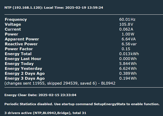

    Is BL0942 working? This device may require SPI mode of BL0942, which is also currently supported.
  • #5 21447034
    chiconws
    Level 4  
    Screenshot displaying energy parameters of a device.
    It's spitting out some numbers, but I haven't calibrated it or put a load on it yet. I'll have time to test it properly this weekend.
