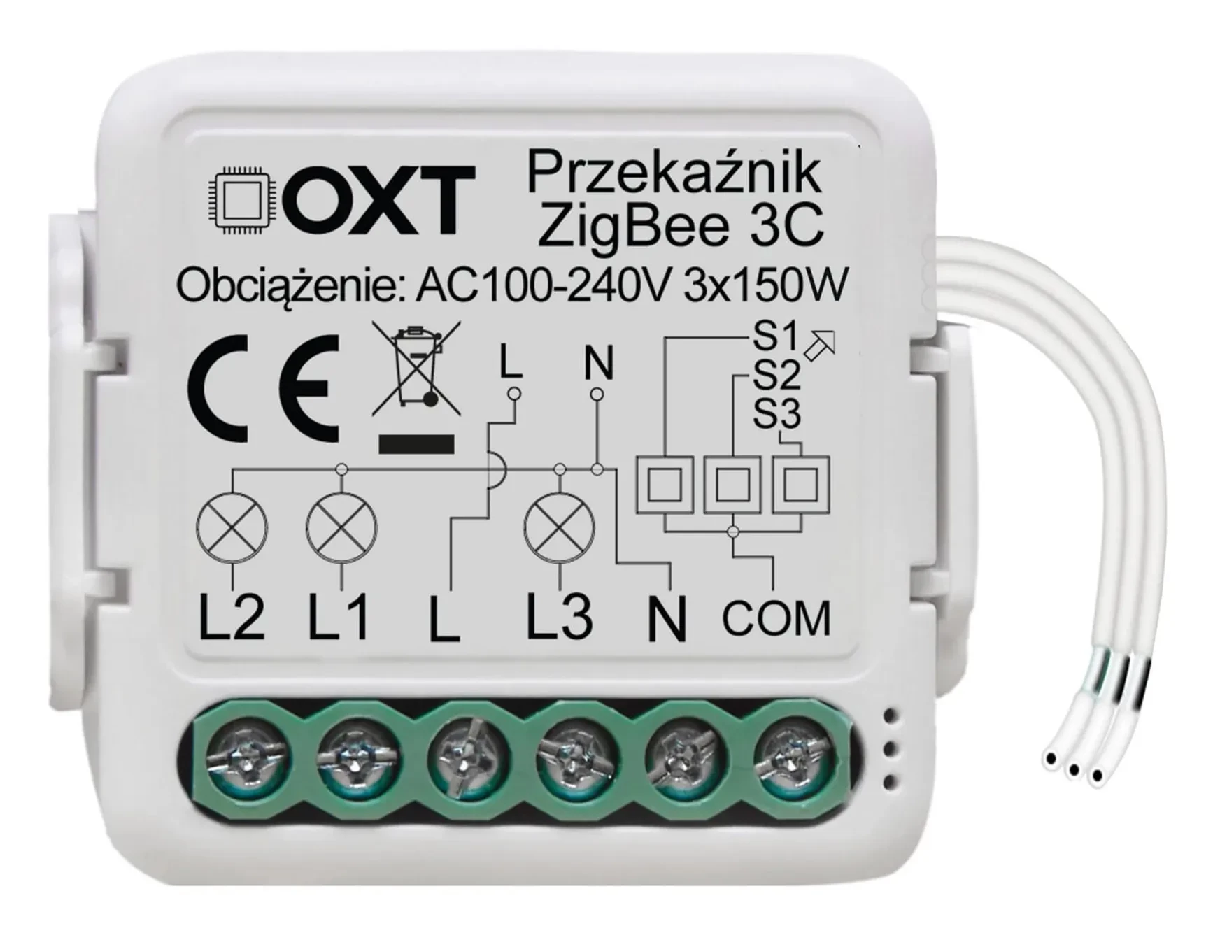

    Good morning,
    I am getting ready to renovate my house, I will be replacing the electrical system, I would like to use zigbee relays to control the lights. I'm looking for an in-box relay that can be controlled with low voltage, namely to manually switch the light on over a twisted pair of wires. The buttons I will use will be monostable (bell).
    All the relays I find are controlled by 230V.
  • #2 21327416
    bar7709
    Posts: 205
    Help: 28
    Rate: 39
    I have found a relay that meets my requirements, "OXT mini relay module 3 circuits ZigBee TUYA".
    Zigbee in-box relay for monostable switch and low-voltage lighting control options .
