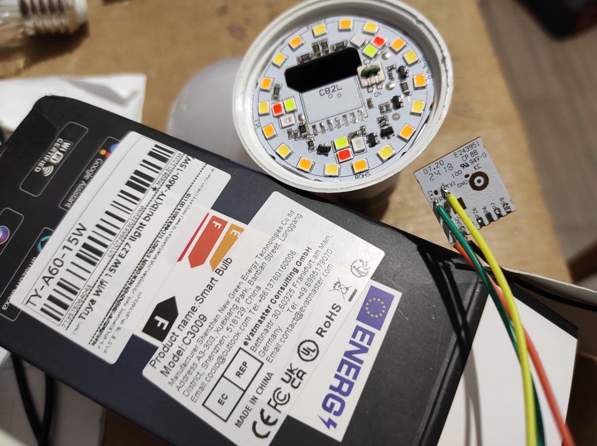

    leśny_ziutek
    Posts: 52
    Rate: 9
    Bought here .
    The design of this bulb allows easy access to the CB2L module without completely disassembling it, as can be seen in the photo below:
    How do I configure the GPIO in the TY-A60-15W bulb (C3009) with the CB2L module?
    GPIO configuration:
    "pins": {
        "6": "PWM;3",
        "7": "PWM;5",
        "8": "PWM;4",
        "24": "PWM;2",
        "26": "PWM;1"
    Attached is the original Flash content, ripped using uartprogram.
    • backup.bin (2 MB) You must be logged in to download this attachment.

    #2 21328069
    leśny_ziutek
    Posts: 52
    Rate: 9
    Measurements show that this bulb draws a maximum of 9 W, not 15 W. The amount of light is also more in line with the 9 W bulb.
    I bought it mainly for decorative purposes, so I am mainly interested in the RGB mode. In this mode it shines quite brightly. It's far from the brightest of my RGB bulbs, but it's not the dimmest either. Overall, for the price it's probably worth it, although it mainly depends on how long it lasts.
