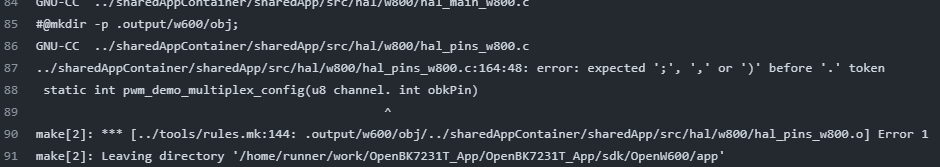

    Sorry, there must be some typo or something, I am helping now in about 4 threads and I am doing it in "round robin" manner, I haven't noticed it failing.
    Oh yes, it's a typo:
    Screenshot of a compilation error message indicating a typo in the code.
    I have put a dot instead of a comma. Let me fix this... and then try.
    When you test it, please test two things:
    - are the PWMs that worked before STILL working?
    - are new PWMs working?
    Please REBOOT between every try, just to be sure... later check without reboots. Again, I don't have this device, so I need your help with testing.
