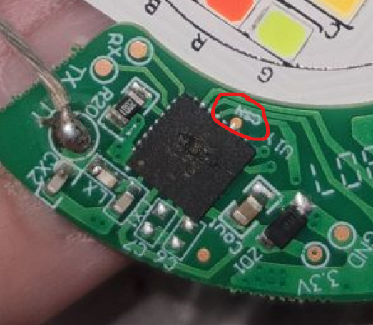

    I am trying to reflash several Glow Ray 4in recessed LED gimbal lights that have firmware 1.5.21. I know that these can't be flashed using CloudCutter, but I am lost on the serial connections as I can't find CEN on the chip. Here is a photo of the board if that helps, but I am hoping someone has a better suggestion.

    I don't think I've seen a bulb where everything is on the LED disc before. Is that a T34? I think I just about see a "T34".
    Close-up of a circular circuit board with electronic components and an LED.
    CEN is circled but you can achieve the same by toggling the 3v3 power off/on until Easy Flasher catches it in uart download mode.

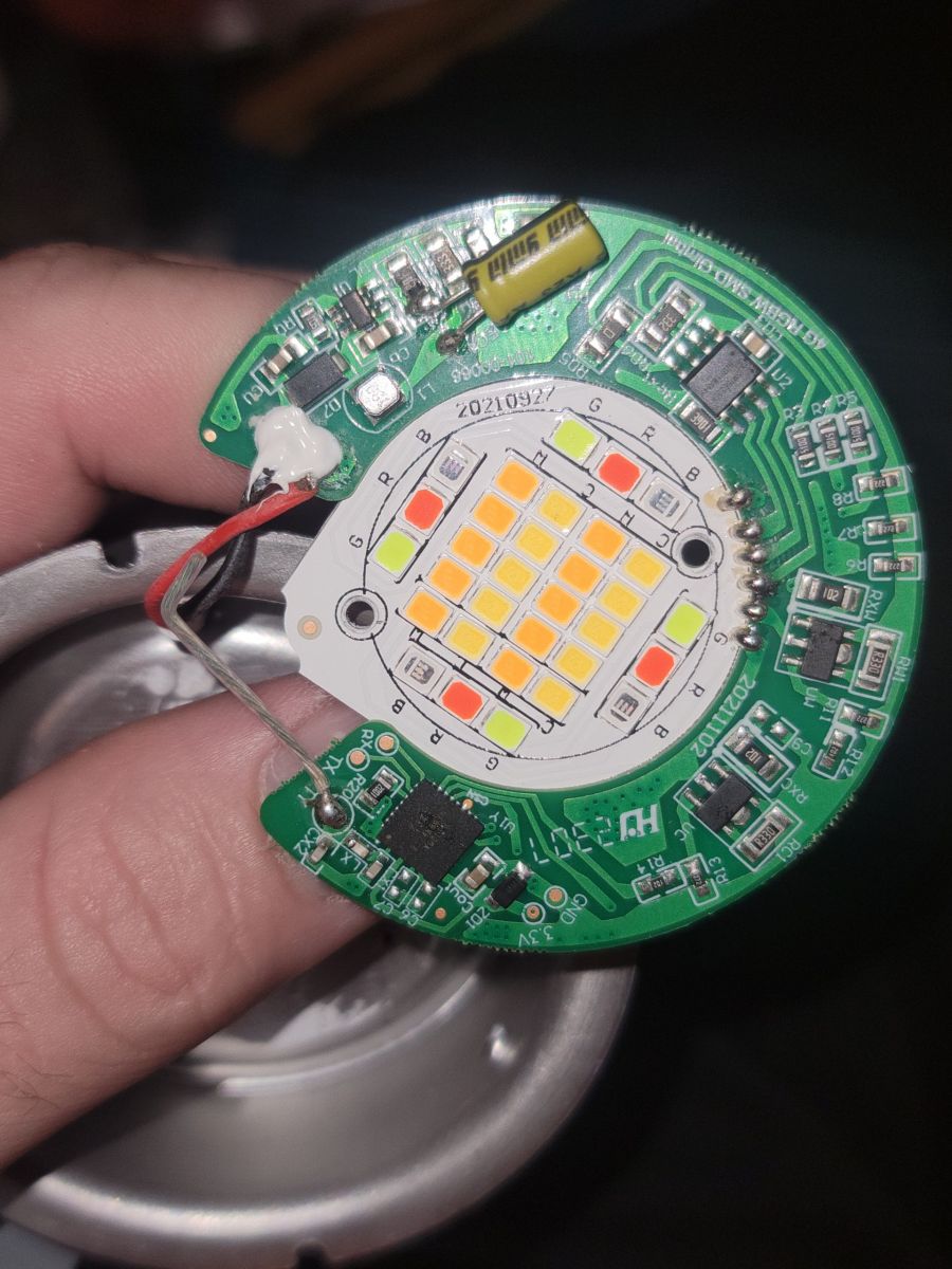

    what does your wiring look like? what is your power source?
  • #8 21330990
    yonubear
    Level 4  
    Posts: 29
    I have tried the 3.3V on the USB serial. I have tried a second 3.3V adapter and having the board powered by the mains supply.

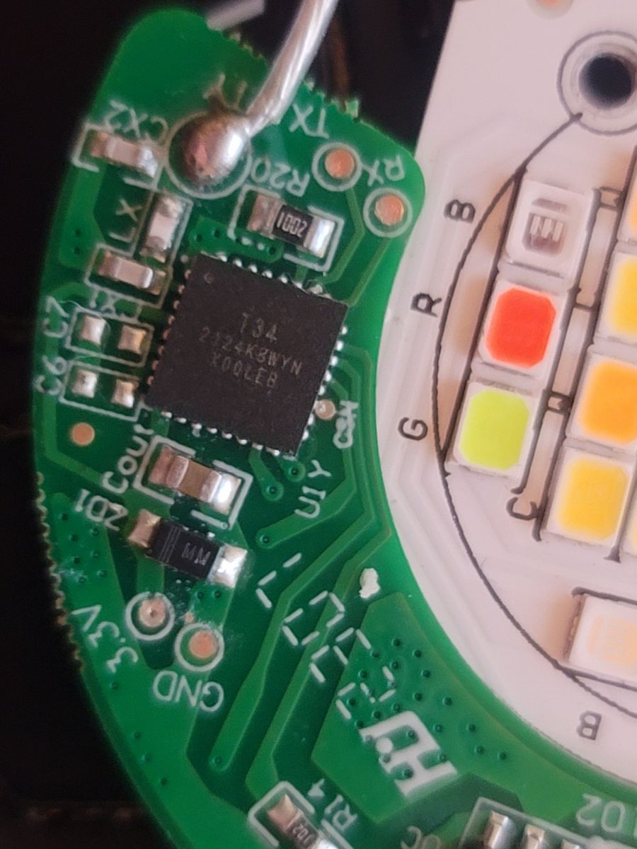

    please confirm it says T34 on that chip.

    wiring i was using pogo pins i am currently redesigning a 3d printed jig to see if I can get a better fit
    Added after 35 [minutes]:
    >>21330993 >>21330993 >>21330993
    let me see if i have a pic as I have everything apart remeasuring and let me see if I can read the chip
    Added after 5 [minutes]:
    >>21330993
    Close-up of a circuit board with electronic components and a chip labeled 134 2122-K8WYN K00LEB.

    OK that makes sense. just wanted to be sure :)

  • #13 21331101
    Posts: 5236
    Help: 450
    Rate: 920
    unsure.
    confirm the following I guess:
    3.3v from external PSU
    GND to PSU and shared to USB-TTL adaptor GND
    bulb TX to USB-TTL RX
    bulb RX to USB-TTL TX
    continuity OK to the end of your pogo pins from furthest point
    shortest cables possible with the pogo pins or, preferably, solder short cables to 3.3V, GND, RX, TX

  • #17 21331973
    Posts: 5236
    Help: 450
    Rate: 920
    Ok. Have you tried soldering instead? Ie no pogos.
