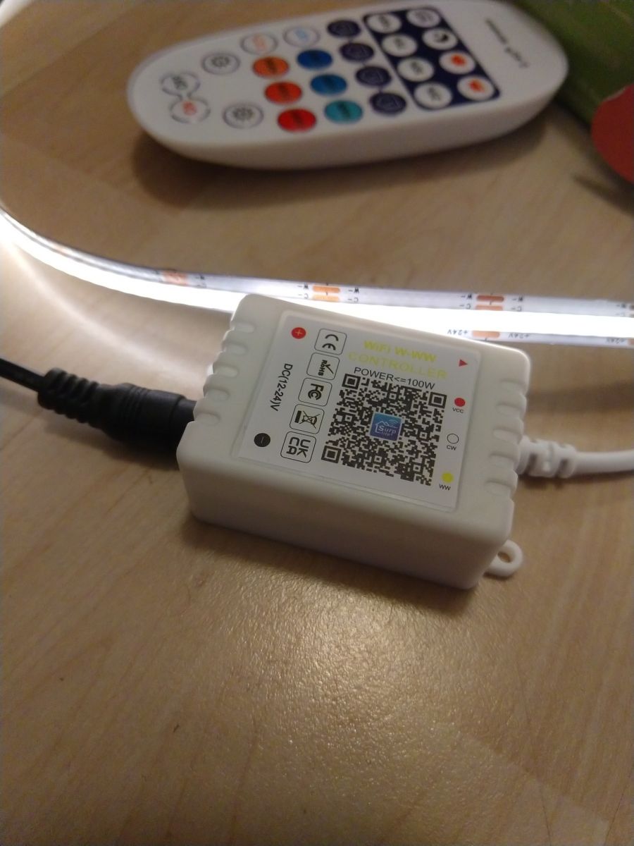

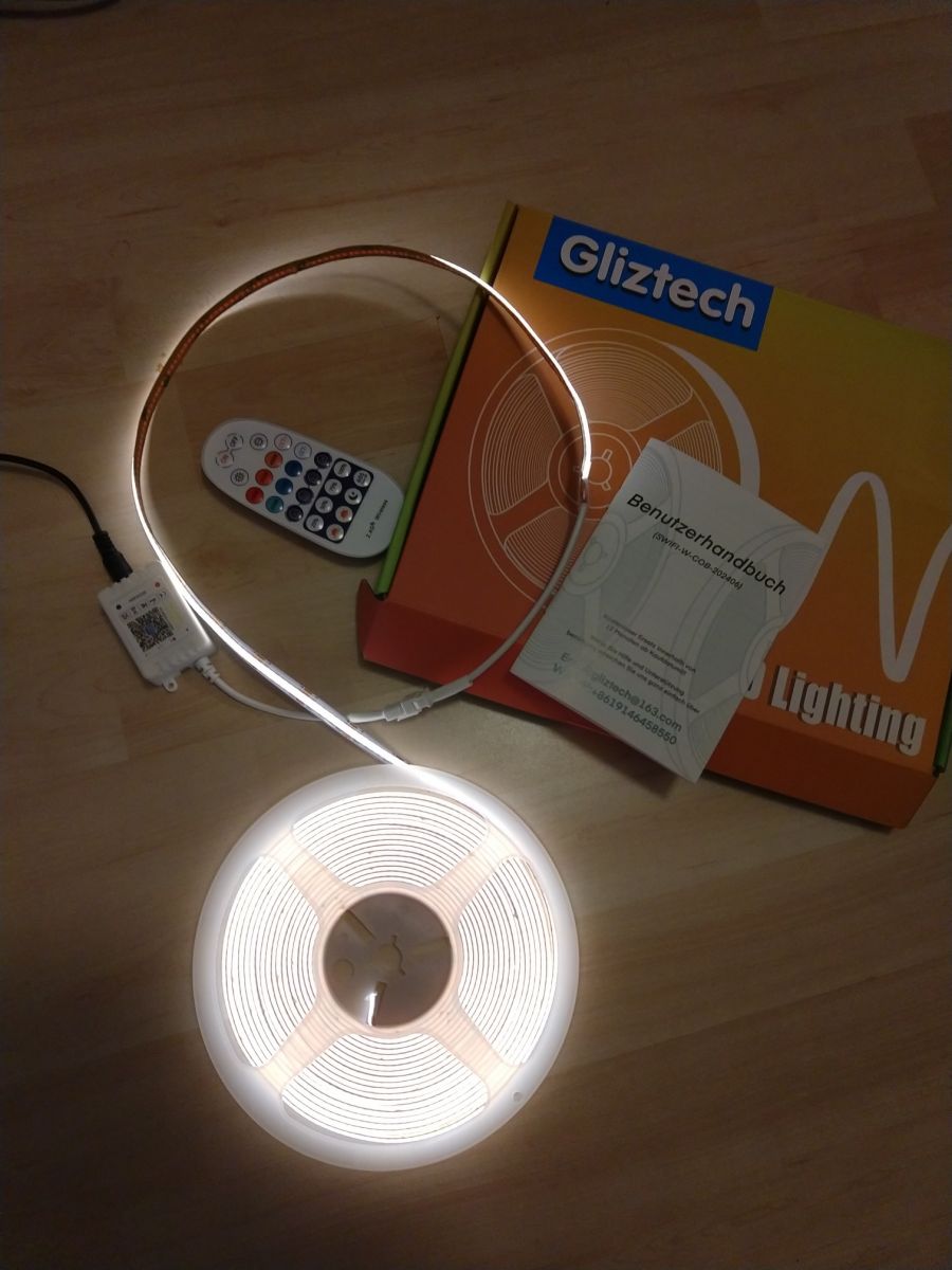

    I want to tell about the gadget "Cob Led Strip ‎3000K to 6500K SSDNWFB1R4" from the vendor "Gliztech" that I bought recently and flashed successfully with Openbeken. The user manual calls it "SWIFI-W-COB-202406". It's a LF686-Chip on a board named "ZJ-BWCD-CCT-VC-IR V1.1".
    Cob Led Strip with color temperature of 3000K to 6500K against a Gliztech box with remote and user manual.
    LED controller with remote on a table.

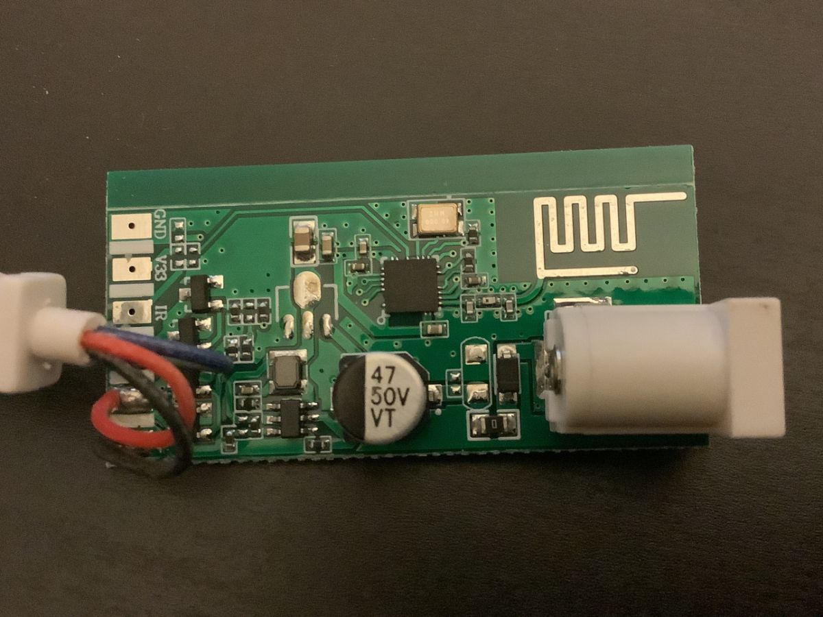

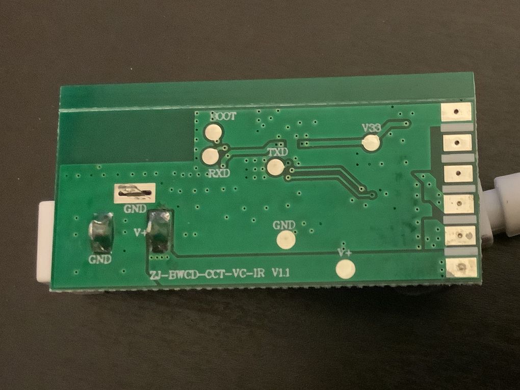

    View of the back of the PCB of the ZJ-BWCD-CCT-VC-IR V1.1 module.
    Printed circuit board with electronic components for Gliztech LED strip.
    Eventually, since flashing via Wifi didn't work, I soldered the pins and flashed it with blflash.
    ./blflash-linux-amd64 flash OpenBL602_1.17.772.bin --port /dev/ttyUSB0

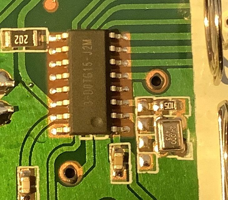

    Close-up of an electronic circuit featuring chip 3-DOTG15-J2M and a 24.000MHz crystal.

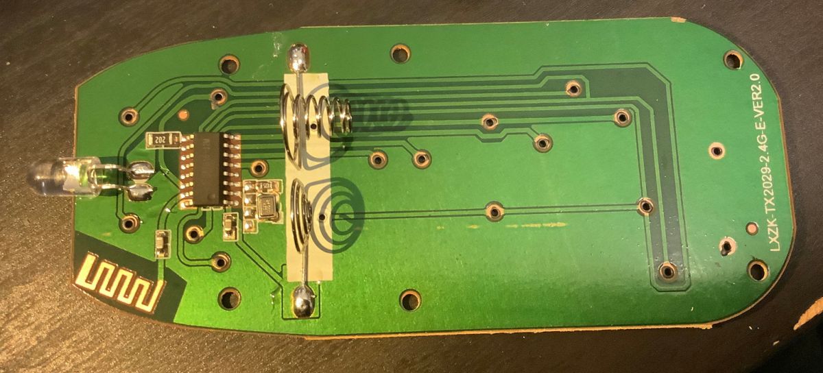

    Concerning the remote control: I opened it and as you can see
    Interior of a remote control with visible chip and quartz.
    there is not much more than a chip 3-DOTG15-J2M and a 24.000MHz quartz inside. It sends supposedly on 2.4GHz (strange: a factor of 10?!), the LED is just there to indicate a key press, I guess. I could not find any information on what kind of chip this is. The board's name is LXZK-TX2029-2.4G-E-VER2.0 .
    I'm not sure if it is possible to use this remote once Openbeken is flashed.
  • #4 21325144
    Posts: 5236
    Help: 450
    Rate: 920
    It's definitely possible on Beken-based devices.
    I don't think the IR drivers are even enabled for BL602, let alone tested.
    You'd also need to add an IR receiver as demonstrated here: https://www.youtube.com/watch?v=KU0tDwtjfjw
