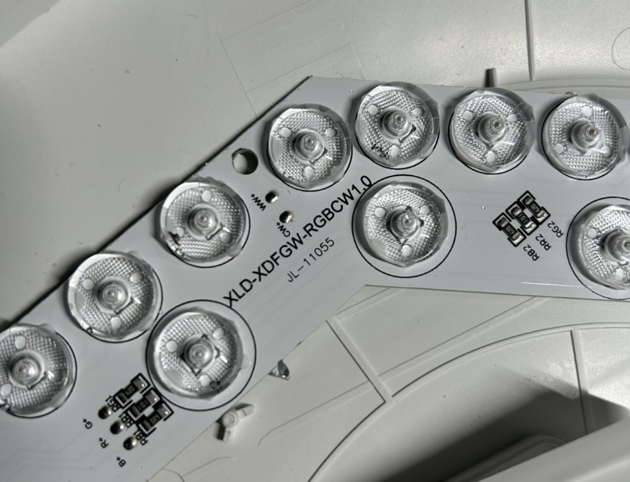

    A glowing red ceiling lamp next to a box labeled LED Ceiling Light.
    I am not entirely sure of its original model name, but the PCB is labeled as XLD-XDFGW-RGBCW1.0:
    LED panel on a white background.
    Opening the lamp is straightforward - just push off the plastic ring surrounding it.

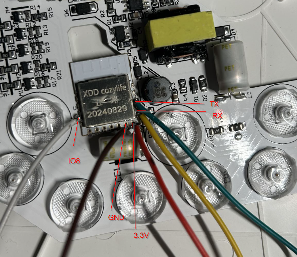

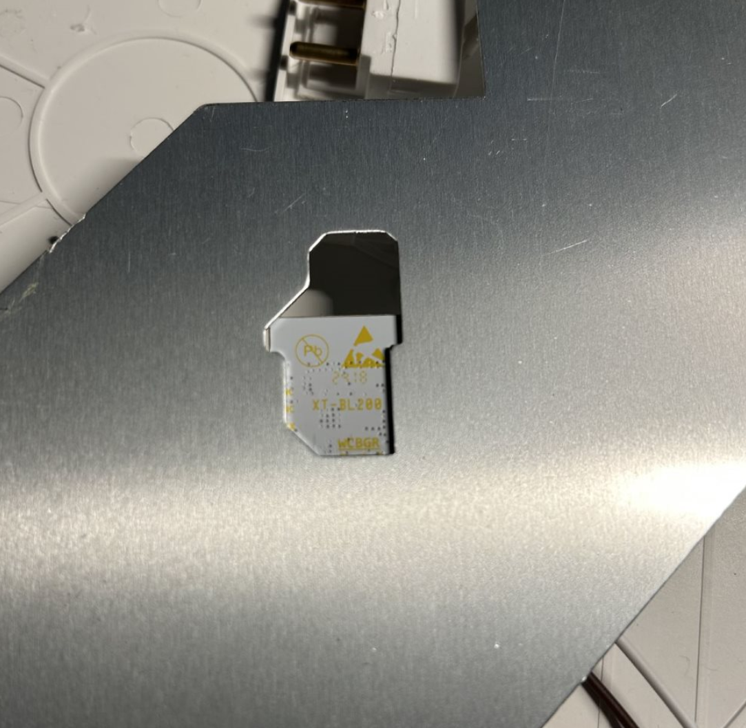

    The lamp uses a BL-200 module, which can be flashed without desoldering it from the PCB. The text XDD cozylife 20240829 is written on the shield (see photo further down).
    Here is a photo of the backside of the module which shows the text XT-BL200 (WCBGR):
    Metal plate with a cutout for a technical marking.
    However, I encountered several challenges while flashing due to insufficient power. Initially, when I powered it directly from a UART-over-USB adapter, the device kept appearing and disappearing. My second attempt involved using a power supply from a board included with a breadboard. This provided enough power for the device to connect to my computer, allowing me to read the output (though some text was corrupted). However, when I tried to put the BL-200 into flash mode, the output was entirely garbled. Finally, I resolved the issue by powering the device with an ST-LINK V2, which worked perfectly.
    To flash the BL-200 module, you need to solder five cables to the appropriate pins. You can find a detailed image of all the pinouts in this topic. The required connections are as follows:
    - TX
    - RX
    - GND
    - 3.3V
    - IO8
    Image of a circuit board with an electronic module and marked wires.
    Next, connect TX and RX to a UART-over-USB converter. To put the module into download mode, IO8 must be connected to 3.3V via a 10k resistor during power-up:

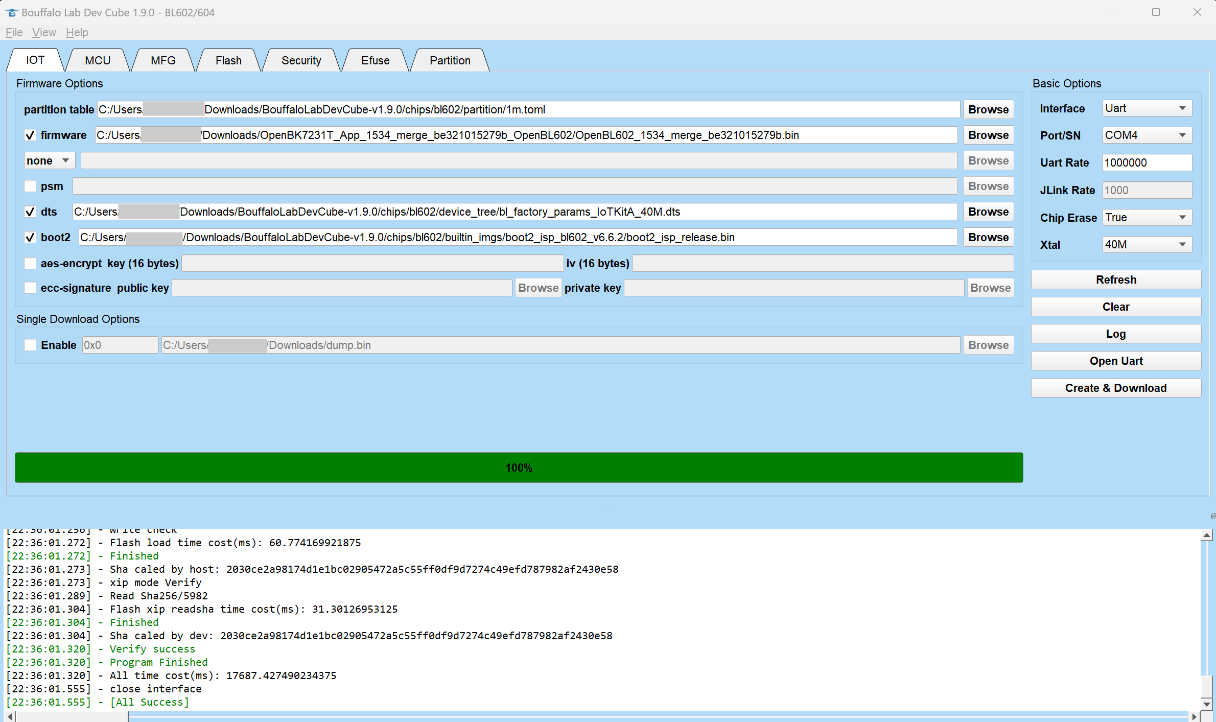

    I used the partition TOML and the build file described in this post. Flashing requires Bouffalo Lab Dev Cube, which I configured as shown below:
    Screenshot of Bouffalo Lab Dev Cube 1.9.0 software settings for firmware update.

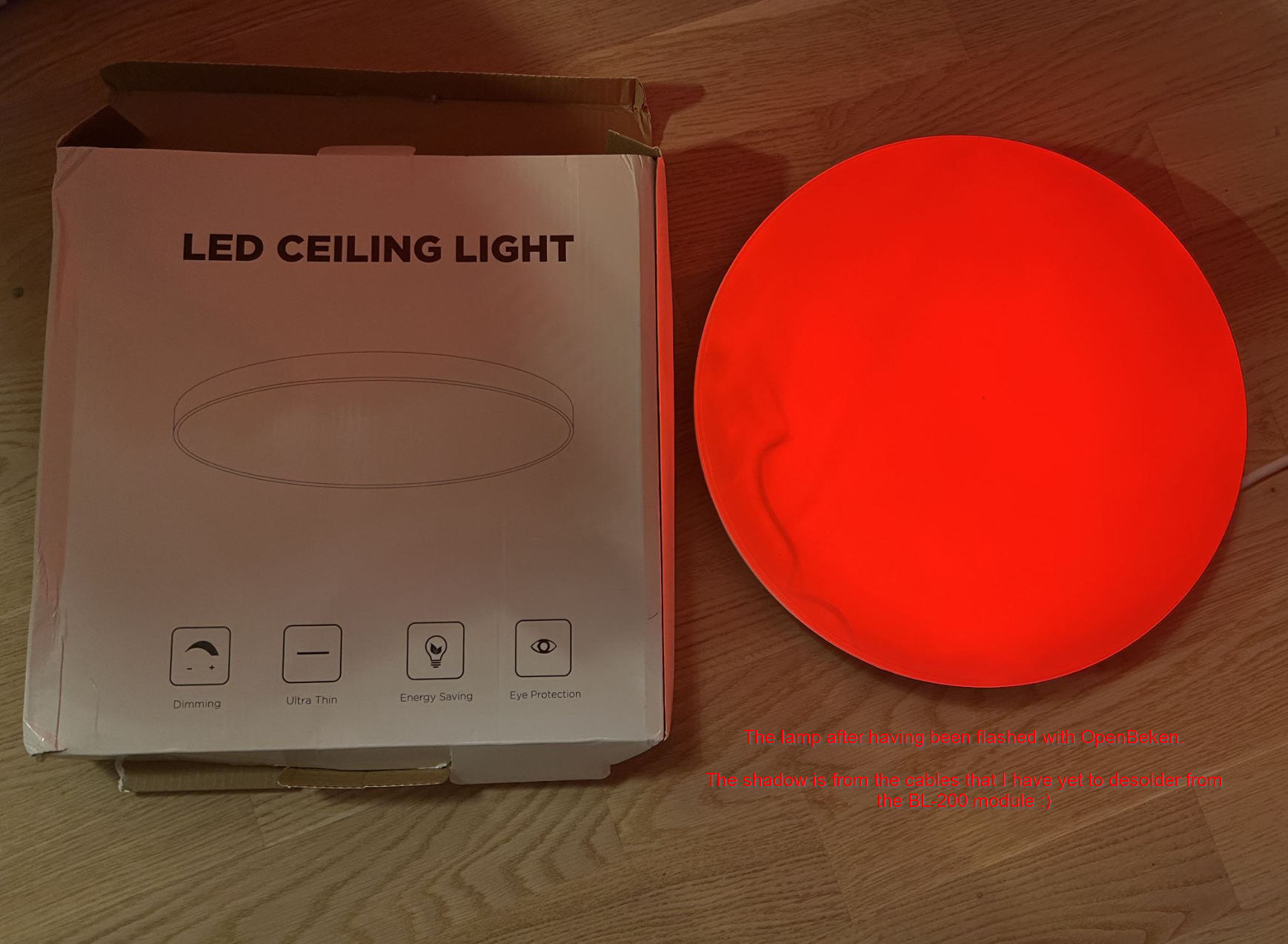

    After flashing, I successfully connected to the device via the AP Hotspot and configured the lamp. I used the OBK template from this post.
    The lamp is functional, however, it occasionally becomes unresponsive when displaying certain colors. I need to test further to identify the specific conditions that trigger this issue.

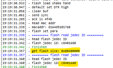

    kvakulo wrote:
    Unfortunately, I did not succeed in dumping the original firmware.
    Are you sure your module is a 1mb version of BL602? If you do the flash ID read it'll tell you the size and ID
    Screenshot of a console with logs of a flash memory read process.
  • Flash ID indicates a 1 MB SPI flash

    >>21478605 Yeah, I thought I had managed to dump the firmware using blflash, but it was just a 1024 kb empty file :(
    The output from flash id read is:
    [21:41:24.496] - ========= flash read jedec ID =========
    [21:41:24.511] - Read flash jedec ID
    [21:41:24.511] - flash jedec id: c2201480
    [21:41:24.511] - Finished
    [21:41:24.527] - get flash size: 0x00100000
    [21:41:24.527] - ========= flash read jedec ID =========
    [21:41:24.542] - Read flash jedec ID
    [21:41:24.542] - flash jedec id: c2201480
    That means 1MB right?
    yes

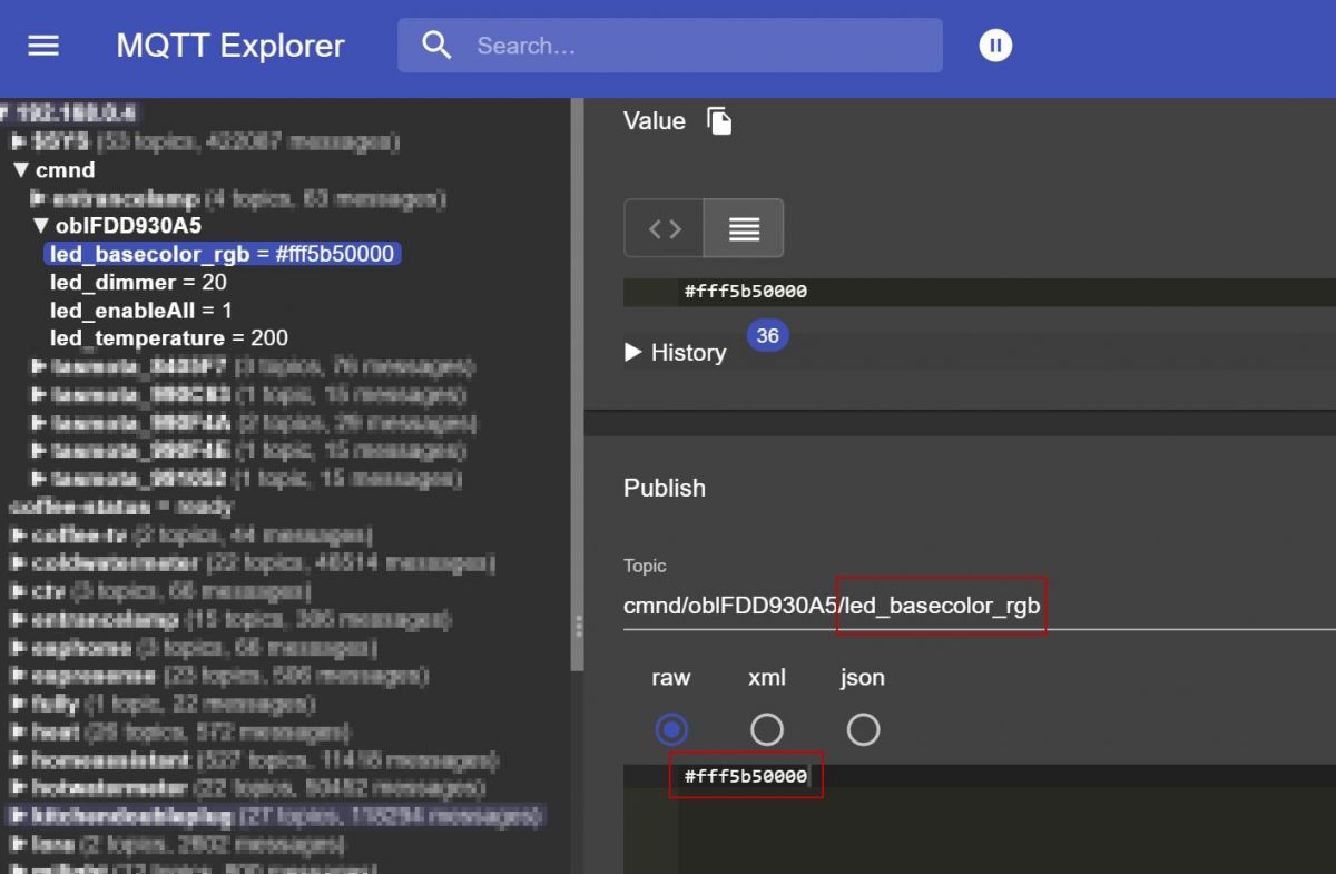

    I have tried to understand in which scenarios that obk crashes, and it seems to be mostly related to mqtt.
    If I disable mqtt, then obk is running stable (unless I change colors very quickly through the web interface).
    But if I enable mqtt, then obk crashes almost consistently when I change the color through homeassistant, or by simply publishing a mqtt message on the led_basecolor_rgb topic, e.g. publishing the value #fff5b50000:
    Screenshot of MQTT Explorer showing led_basecolor_rgb setting.
    The log looks like this:
    Screenshot of system logs indicating an issue with system hang when using MQTT.
    Any ideas of what I could perhaps tweak to avoid this issue?

    The lamp has been running stably with no crashes for the past two weeks 🥳
    I've attached the build with optimized hex parsing in case anyone needs it.
