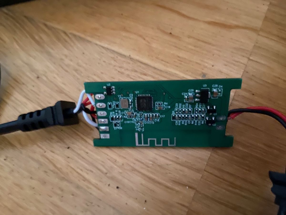

  • Missing OpenBK7231T build for the LED driver
    #19 20671391
    wsoltys
    I mean the LED driver. The chip is already flashed with OpenBK7231T. I can test a new build when it helps.
    Unfortunately I made something wrong with the backup so I can't go back anyway.
    Here are some blurry photos:
    A blurry photo of a green LED controller PCB with visible wires and electronic components. Blurry photo of an LED controller PCB with attached wires and BK7231T marking. Two elongated LED controllers with cables and a power adapter, one showing an exposed circuit board on a wooden surface.

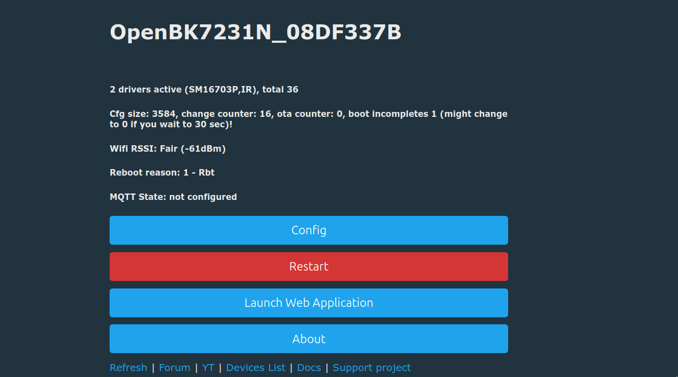

  • #29 20828915
    alfakenzo
    Posts: 32
    OpenBK7231N graphical interface displaying device status and configuration options. I tried this too, but after flashing my stripe, I got nothing. For me, toggle doesn't work.
  • #30 20830376
    alfakenzo
    Posts: 32
    I have managed to get the toggle for power toggle 57 PIN6;
    warm white toggle 54 Pin 9;
    cold white toggle 39 Pin 24;
    User interface for OpenBK7231N with three active switches.
    The things you wrote, I pasted it but nothing happened.
