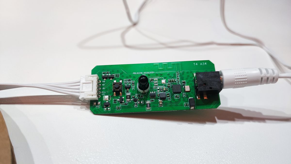

    Saw this led strip in our local Action and thought let's try to convert this to Openbeken.
    Opening the housing on this is very easy as nothing is glued together but clicked.

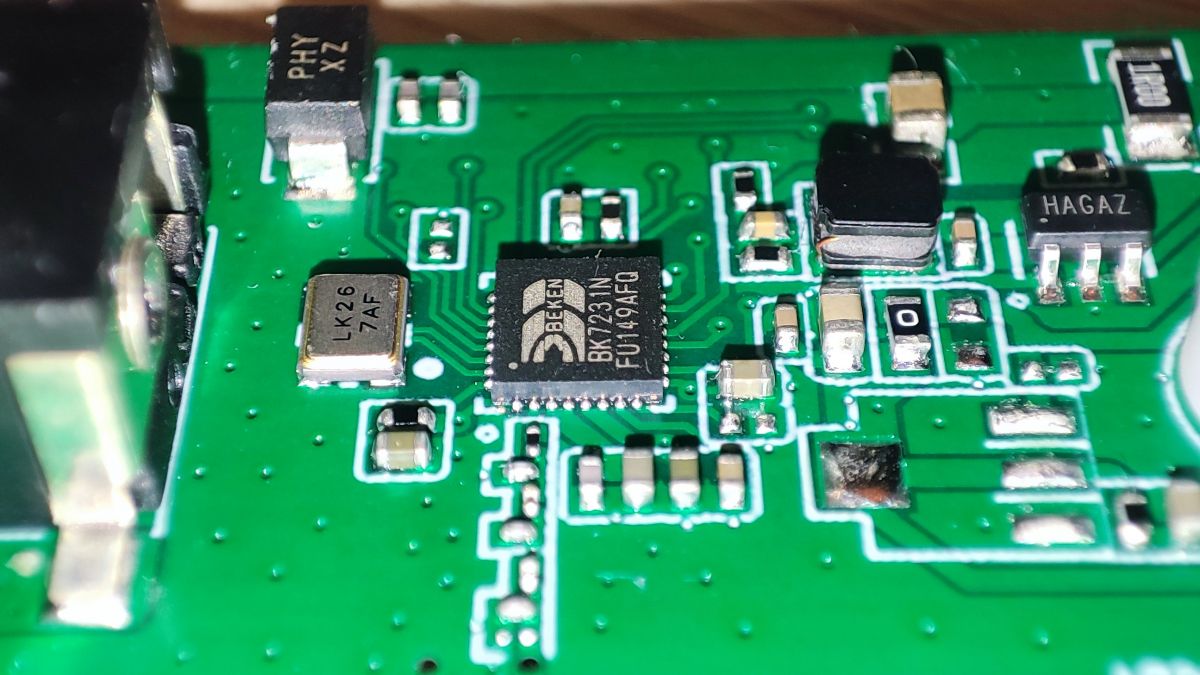

    Had the PCB in hand in a jiffy, nice a BK7231N so flashable with OpenBeken.
    Printed circuit board with electronics and attached white connector.

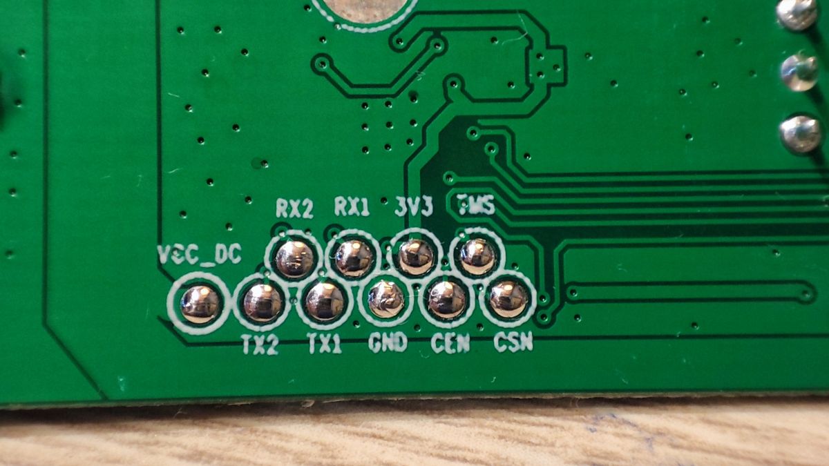

    View of a printed circuit board with labeled solder points.
    All points are marked clearly and there is space enough around so attaching the wires was also a breeze.
    First attempts to read the memory and back up failed, it seemed to get stuck after a while.
    Tried a few times got stuck every time at different points in process and then failed.

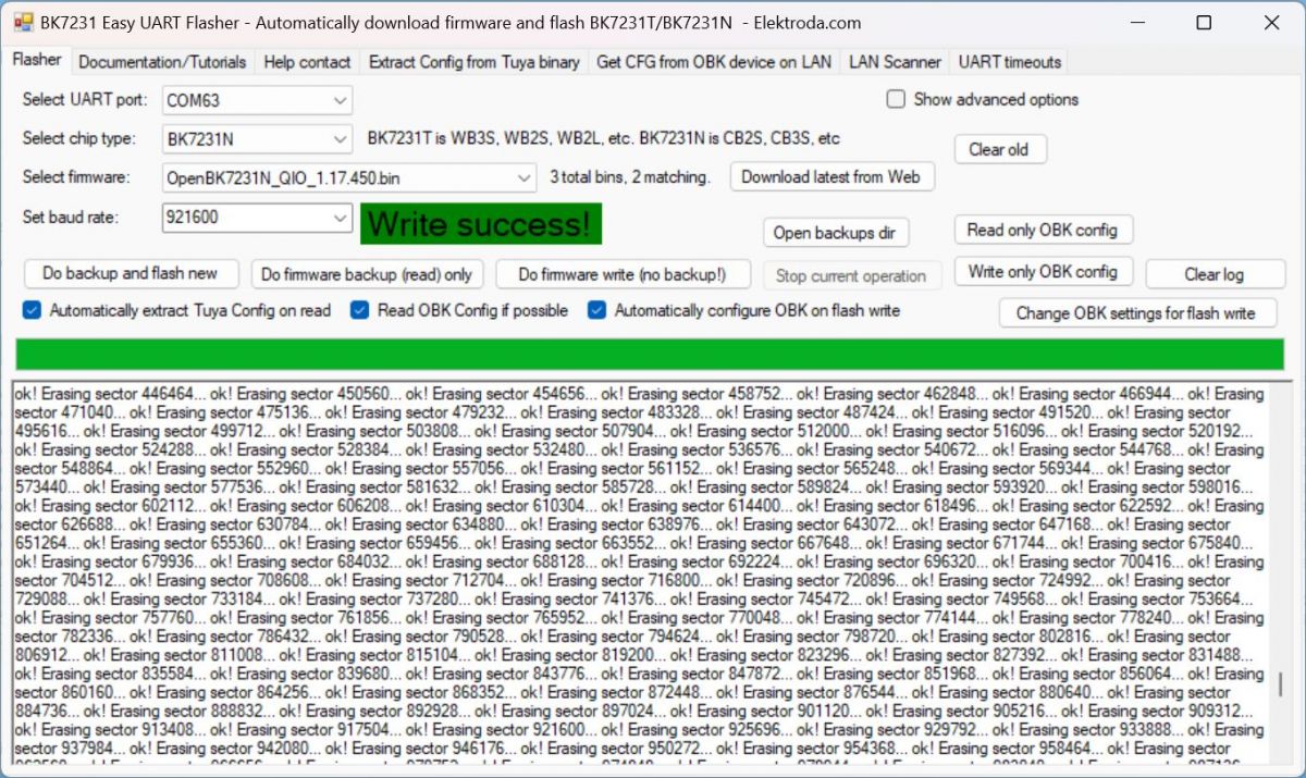

    I was thinking this was due to insufficient power, as I was only using my Serial USB TTL adapter to power it. I plugged in the supplied adapter and tried again. This time I had more success the 'EASY Uart flasher' finished all steps with flying colors.
    Screenshot of BK7231 Easy UART Flasher showing Write success! message.
    Circuit board with Beken BK7231N chip.

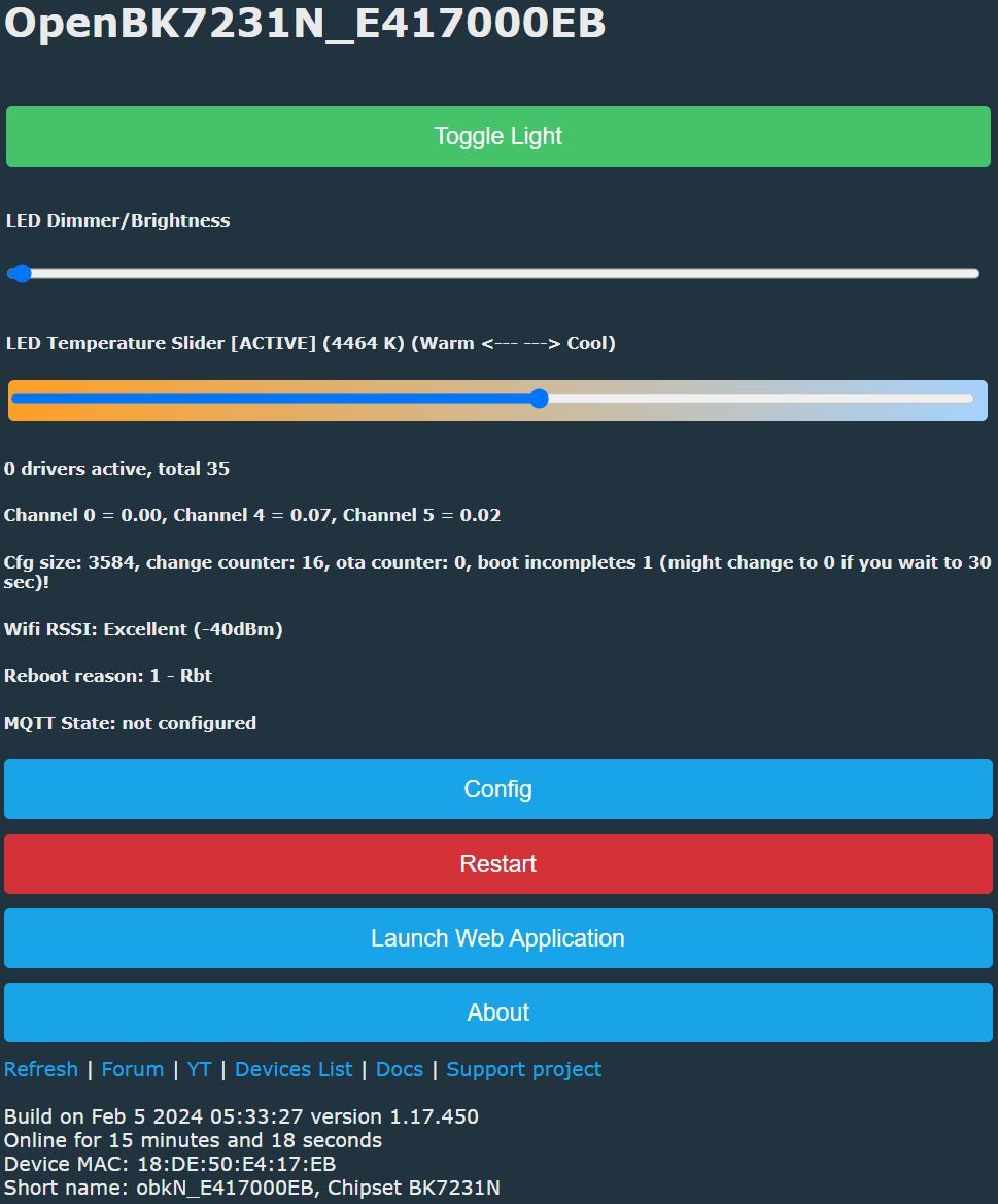

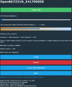

    After the job was finished I desoldered al the wires and added the ledstrip and power, and plugged it into the wall socket. Nothing happened, but I thought maybe I need to configure something. So first things first and I connected to the openbeken Wi-Fi network. I changed it to my home Wi-Fi and connected again. Strange thing is that I do not see it is an RGB device.
    Only see LED Dimmer/Brightness and LED Temperature Slider
    When I press 'Toggle light' nothing happens the Led strip does not react to anything.
    What am I’m missing?
    Any pointers will be appreciated as my electronical knowledge is very limited.

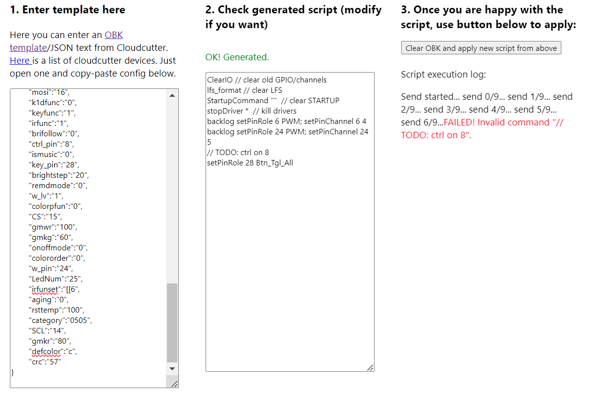

    Adding the generated JSON in web app does gives some error.
    But I have no clue to what it is meaning.

  • OpenBeken pin map and SM16703P RGB setup
    #4 20954715
    DevilDuck
    I have the same device on my table.
    Here is the configuration that I am using:
    "pins": {
    "6": "PWM;4",
    "8": "AlwaysHigh;0",
    "16": "SM16703P_DIN;0",
    "24": "PWM;5",
    "26": "IRRecv;0",
    "28": "Btn;4"
    It's important to have pin 8 alwaysHigh, otherwise the 24V line to the LED strip is off.
    PWM on PIN6 and 24 controls the Warm/cold white part of the strip.
    PIN 16 requires the SM16703P driver for RGB control.

    Unfortunately, I couldn't figure out so far how to control the RGB part through sliders on the web interface.
  • #5 20955083
    Rockking81

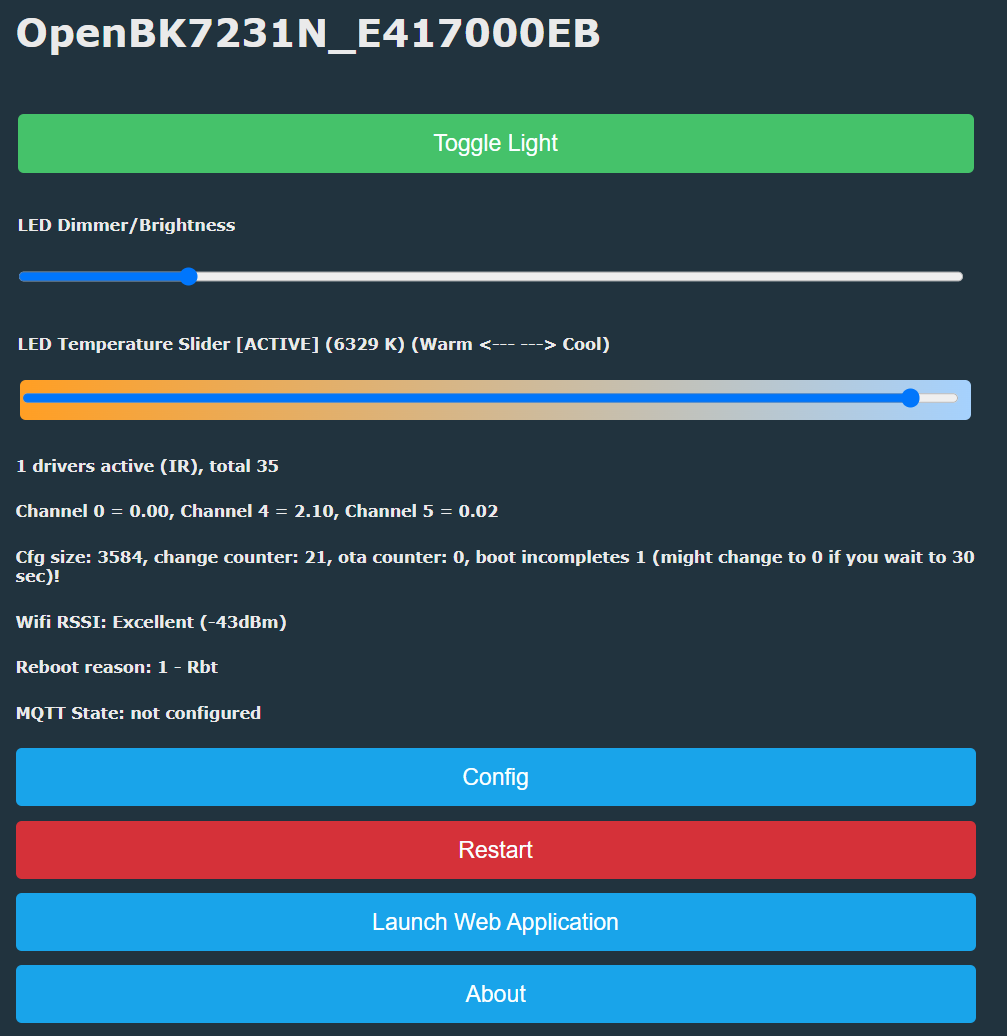

    Hi, thanks so far, it is alive!
    Indeed, it would be great if we could figure out how to control the RGB part.
    Now that part is constantly on and uncontrollable.
    User interface of an application with options to control LED brightness and temperature.
