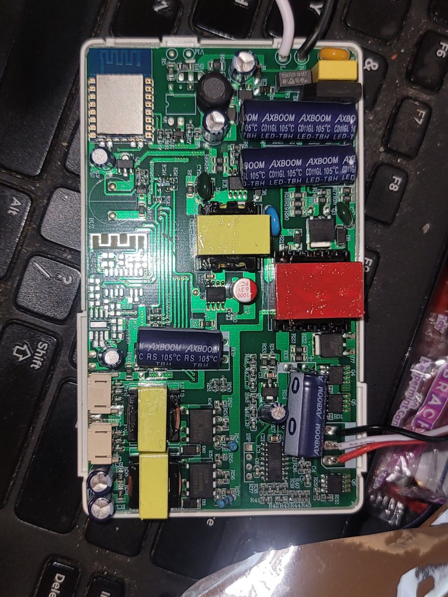

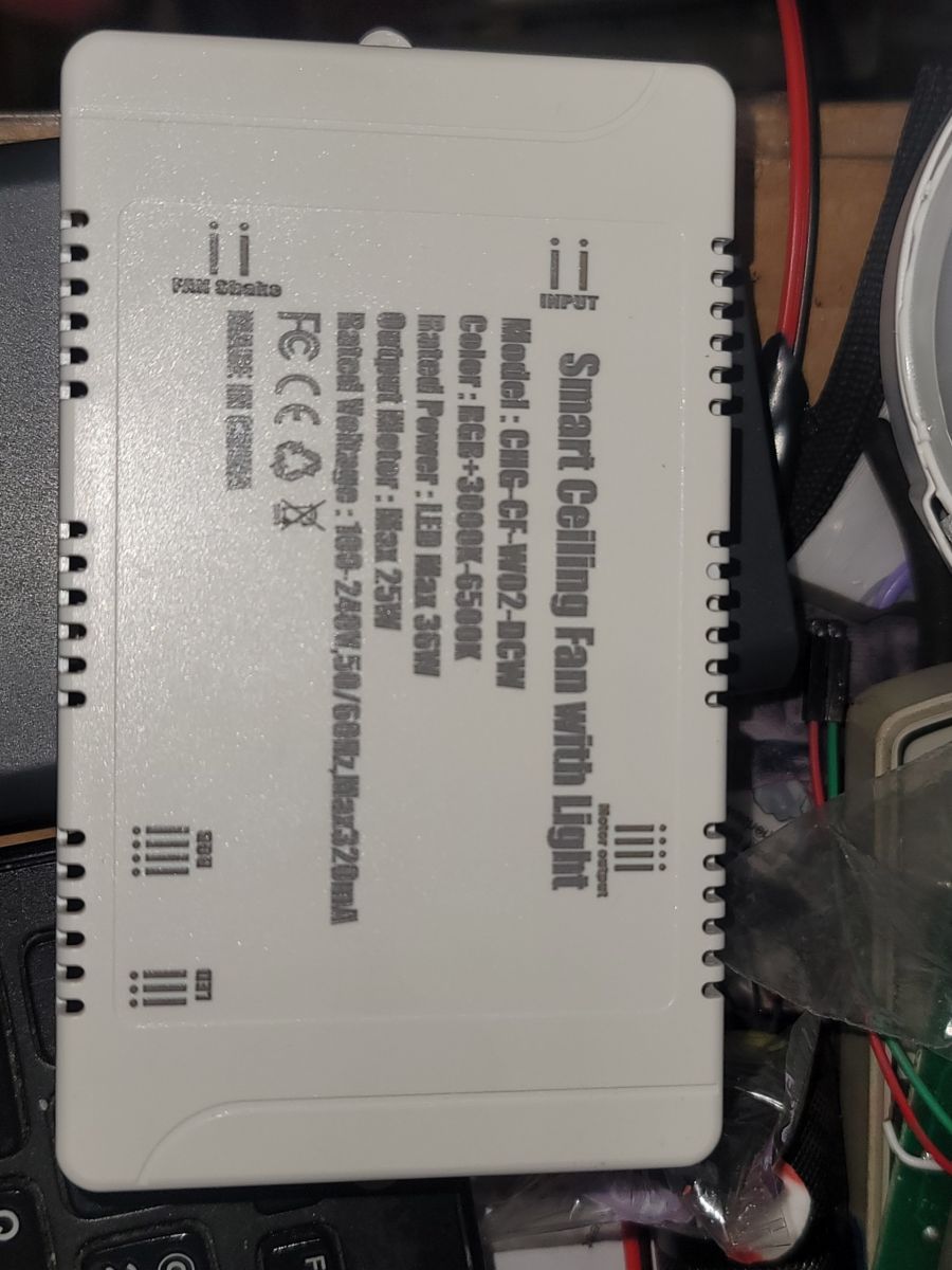

    ok sorry all the be a pain but I am trying to figure out if I should even attempt this as I am not sure if Openbekten will work on a tuya fan or not I have a couple of tuya fans that run on version 1.2.2 FIRMWARE and 1.2.2 MCU I am including photos of the case and PCB I just want to get some input before I remove the module for flashing as I had to end up with a bricked fan if it won't operate on other than stock firmware
    smart ceiling fan with light
    model CHG-CF-W02-DCW

    assuming that unmarked module is Beken based, then I guess it's possible. Investigation and reading up on OpenBeken required.
    Maybe that module is a CB3S or a WB3S.
    Also, this looks like it might be a TuyaMCU with some surrounding test pads:
    Circuit board with an integrated circuit and test pads.

    Very interesting device, try to make 2MB backup and we'll see
