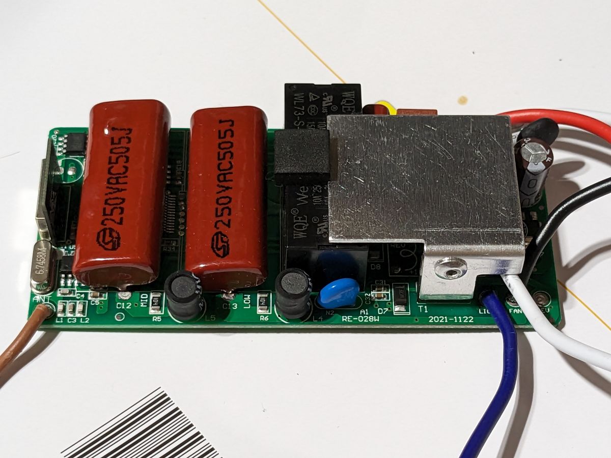

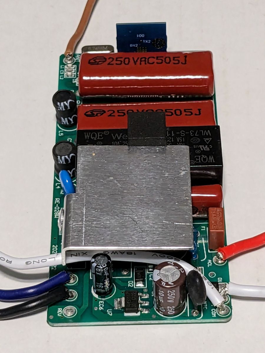

    I purchased a Tuya compatible Ceiling Fan Remote Control Kit with light dimmer and RF remote hoping to get it running Local Only on HomeAssistant. I feel like I may have bitten off more than I can chew on this project and am wondering if people have any tips on configuring this device?
    Manufacturer: San Sheng (Zhongshan), but it is branded [or unbranded] under various names.
    Model: RE-028W, SS-T28
    Chipset: CB2S
    Replacement: ESP8685-WROOM-03
    Notes: The unit connects electrically to load and neutral without a ground.

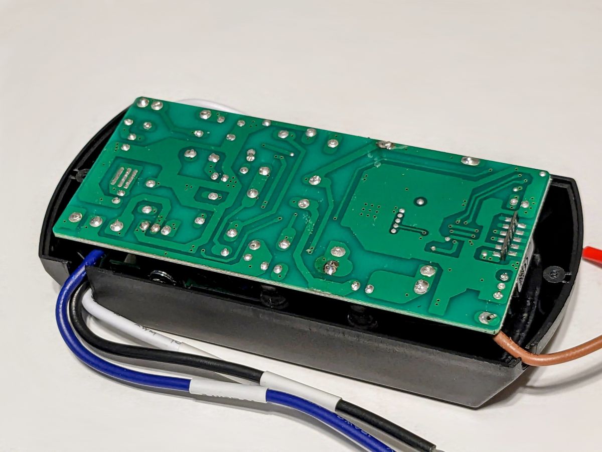

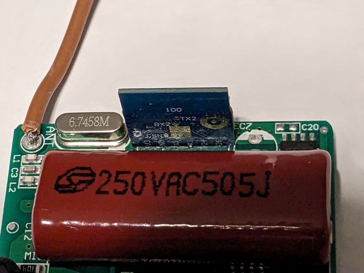

    I did successfully flash the CB2S to OpenBeken, but after failing to get any results with attempts to configure, I attempted to hook up my dusty old Oscilloscope [which I don't have much experience with] and as soon as I contacted the probe's ground to the CB2S GND pin something popped and the fan unit just kept clicking [I presume b/c the fan unit isn't grounded]. After removing the CB2S chip the unit operated just fine using the included RF remote. At this point I managed to load up Tasmota 4MB onto an ESP8685-WROOM-03 and soldered it onto the board.

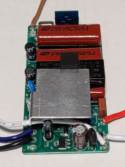

    Chip Connections to the Board:
    On the front of the chip, only CEN was soldered to the board.
    On the back of the chip, all pins were soldered to the board.
    ESP8685 seems to be a direct drop-in replacement just with different pin names.
    CB2S : CEN || 3v3 | GND | RX1 | TX1 | P24 | P26
    ESP-x : _EN || 3V3 | GND | RX_ | TX_ | IO5 | IO4
    My current understanding is on the ESP I need to configure Pins GPIO20 / GPIO21 (RX / TX) and GPIO5 / GPIO4 but do not know what to configure them as or what function each pin performs.

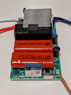

    Below are some images that might be of use to someone more familiar with electronics. Let me know if you have any questions or need better photos of the board to assist with recommendations. I appreciate any assistance provided.
    PCB with electronic components, including a CB2S module and two large capacitors.
    Close-up of a circuit board with electronic components. Circuit board of a ceiling fan remote control showing capacitors and components. Electronic module for ceiling fan control. Printed circuit board inside a device casing with protruding wires.

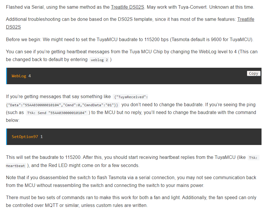

    On Tasmota, I'd try:
    https://templates.blakadder.com/treatlife_DS03.html
    Screenshot of instructions for configuring TuyaMCU in Tasmota.
    If you do the part from the screenshot and press buttons on remote, do you get those messages in Tasmota?
    Do you know dpIDs of this device?

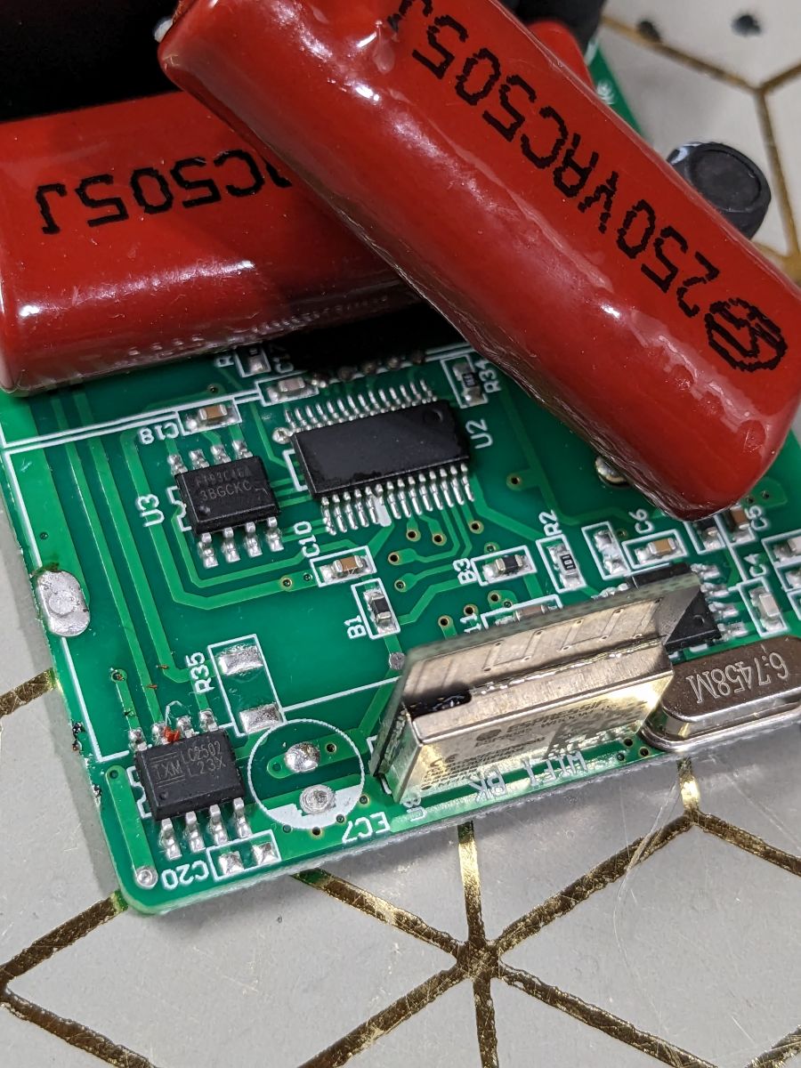

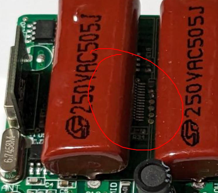

    -I did just desolder that capacitor and one of the chips is actually unlabeled. (See attached photo)
    -On the currently installed ESP8685-WROOM-03 w/Tasmota, SetOption97 did not provide valid heartbeats using either =0 nor =1. Both resulted in the "TYA: Send 55..." outputs
    -I do not know the DpIDs. I presume I could know this if I can get the Option97 comms working.
    -The CB2S got zapped when I tried to hookup to the O-scope. I did buy another of this product, but was hoping to keep it mint until I figure out what exactly needs to happen in case I can't get this working.
    **Is it possible TuyaMCU got zapped at the same time causing invalid heartbeats in the console?

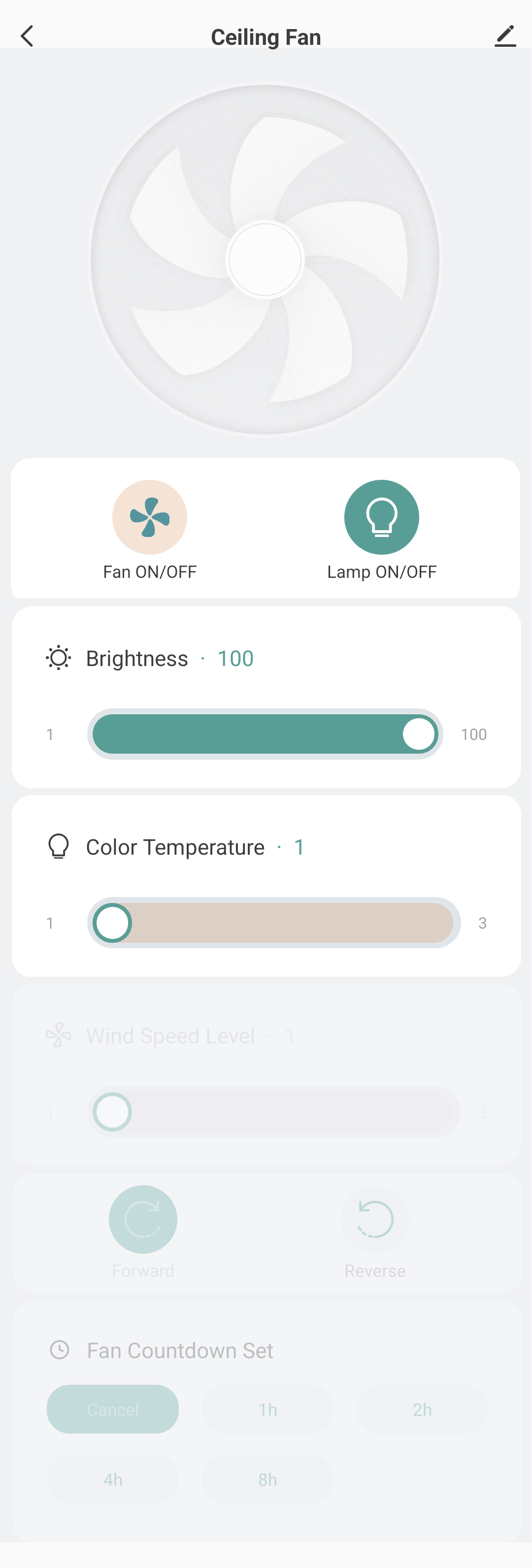

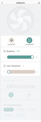

    Based on the information you provided, I was able to map out all of the critical dpIDs and values to functions and then successfully issue TuyaSend commands via the console to change their states.
    dpIDs retrieved from my Tuya Cloud Project.
    {"20":"Lamp ON/OFF","22":"Brightness","23":"Color Temperature","60":"Fan ON/OFF","62":"Wind Speed Level","63":"Direction Fan","101":"Fan Countdown Set"}
