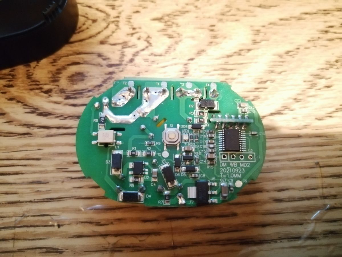

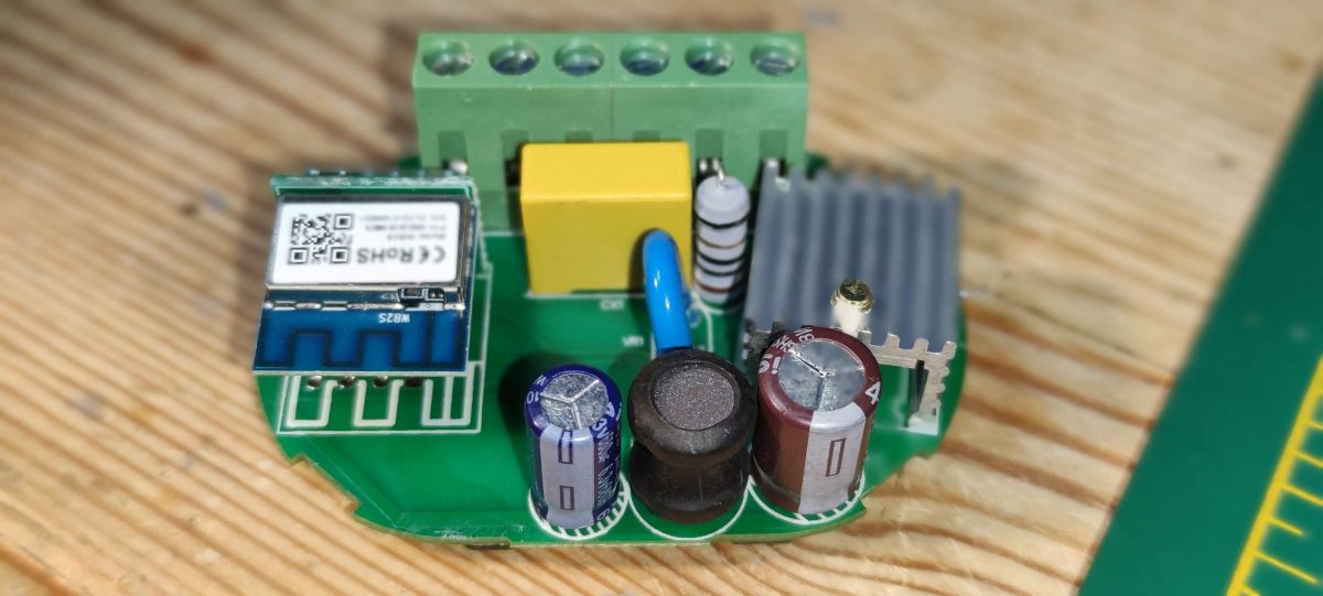

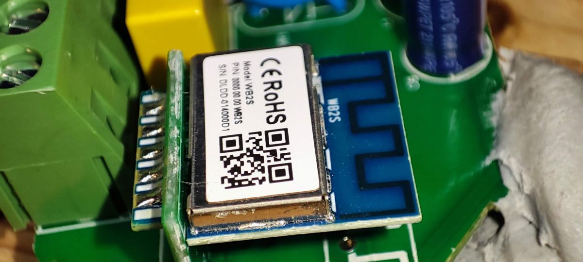

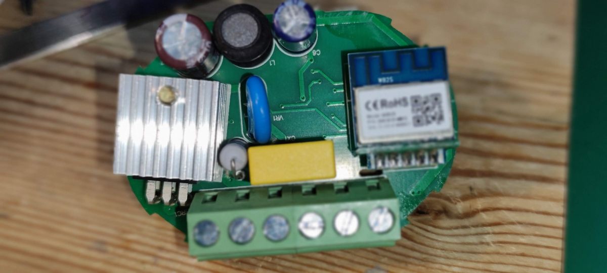

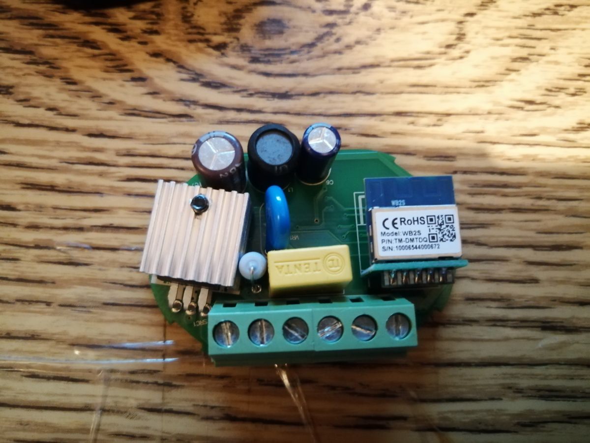

    This module is basically a light dimmer that is used for Fan Speed Control.
    Printed circuit board of the ATARM TMWF02 fan module with visible electronic components. Fan control module labeled WB2S with a serial number. Black module on a wooden surface near a keyboard.
    Can be easily flashed to OpenBeken without any kind of soldering using Cloudcutter
    The device heavily relies on TuyaMCU for controls. The DpID used on this device is the same with the stock firmware
    DP 1 = Toggle Switch (power on/off)
    DP 2 = Timer (measured in seconds)
    DP 3 = it exists but non-functional (level1 - 5)
    DP 4 = Speed (or rather the dimmer itself)
    Dimmer range is from 1 to 100

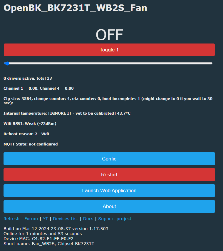

    This is what I used to get it functional under OpenBeken firmware. Just add this text to autoexec.bat text file and upload it via Openbeken's webapp under filesystem tab and reboot the device.
    startDriver TuyaMCU
    setChannelType 1 toggle
    setChannelType 4 dimmer
    tuyaMcu_setDimmerRange 0 100
    linkTuyaMCUOutputToChannel 4 val 4

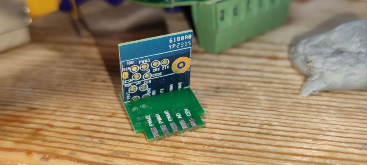

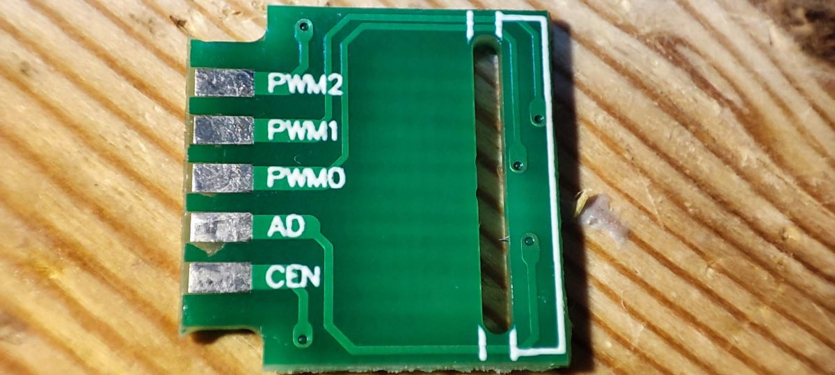

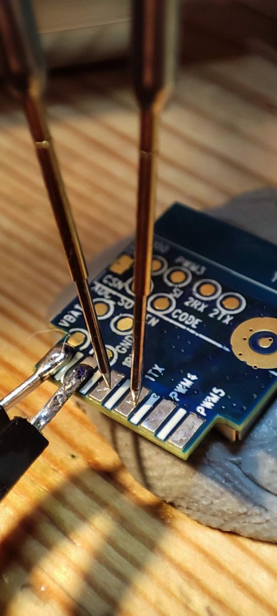

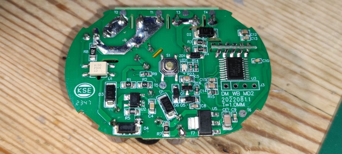

    #8 21001924
    Posts: 5236
    Help: 449
    Rate: 918

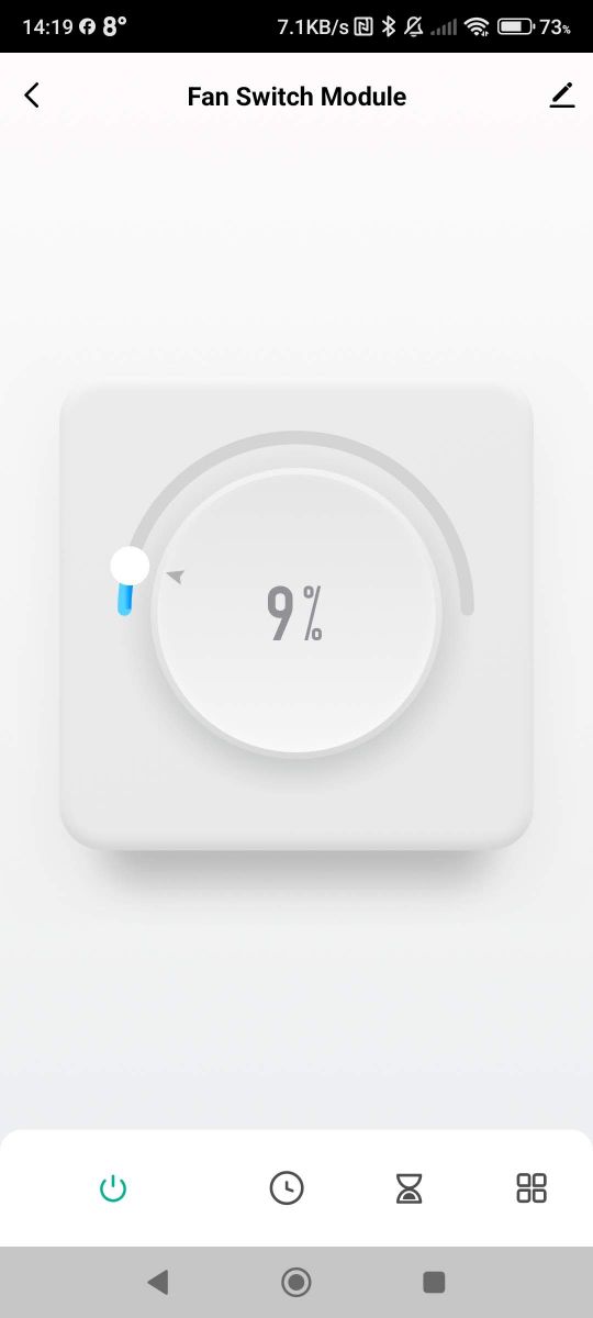

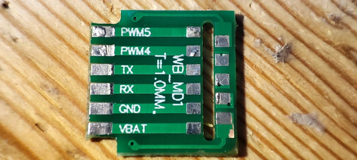

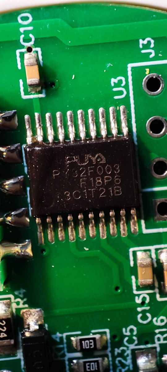

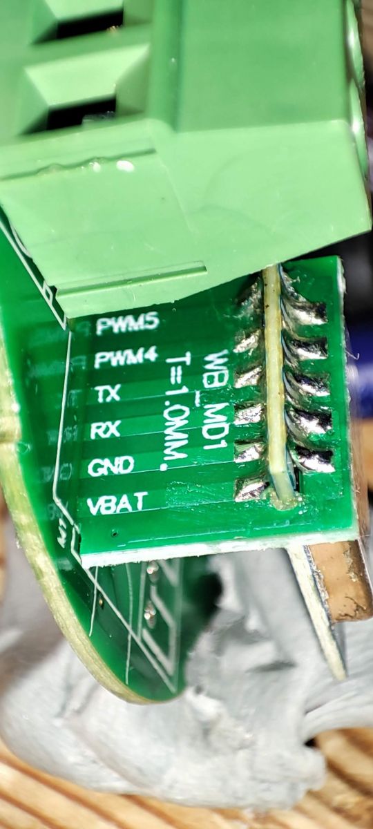

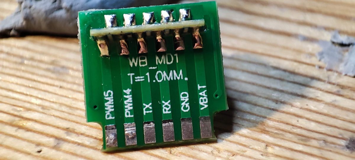

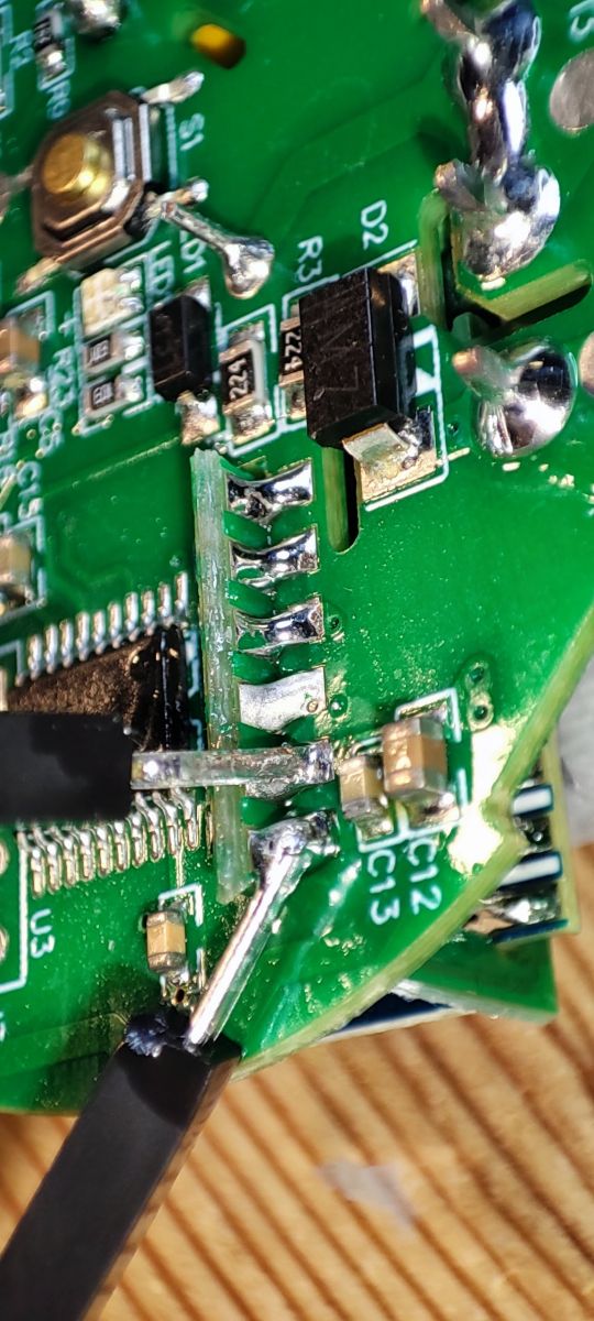

    I've just done one of these. The TuyaMCU is a Puya PY32F003
    Close-up of Puya PY32F003 microchip on a circuit board.
    DP 1, BOOL(rw), switch_fan (风扇开关)
    DP 2, VALUE(rw), countdown_fan (风扇倒计时)
    DP 3, ENUM(rw), fan_speed_enum (风速)
    DP 4, VALUE(rw), fan_speed (风速)

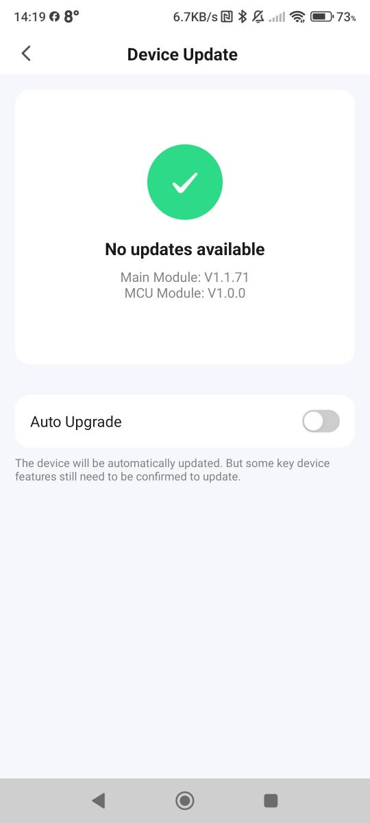

    full Tuya response
    UART boot, with WB2S desoldered
    interesting seeing it switch to trying 115200 baud to MCU when it cannot get a response at 9600.

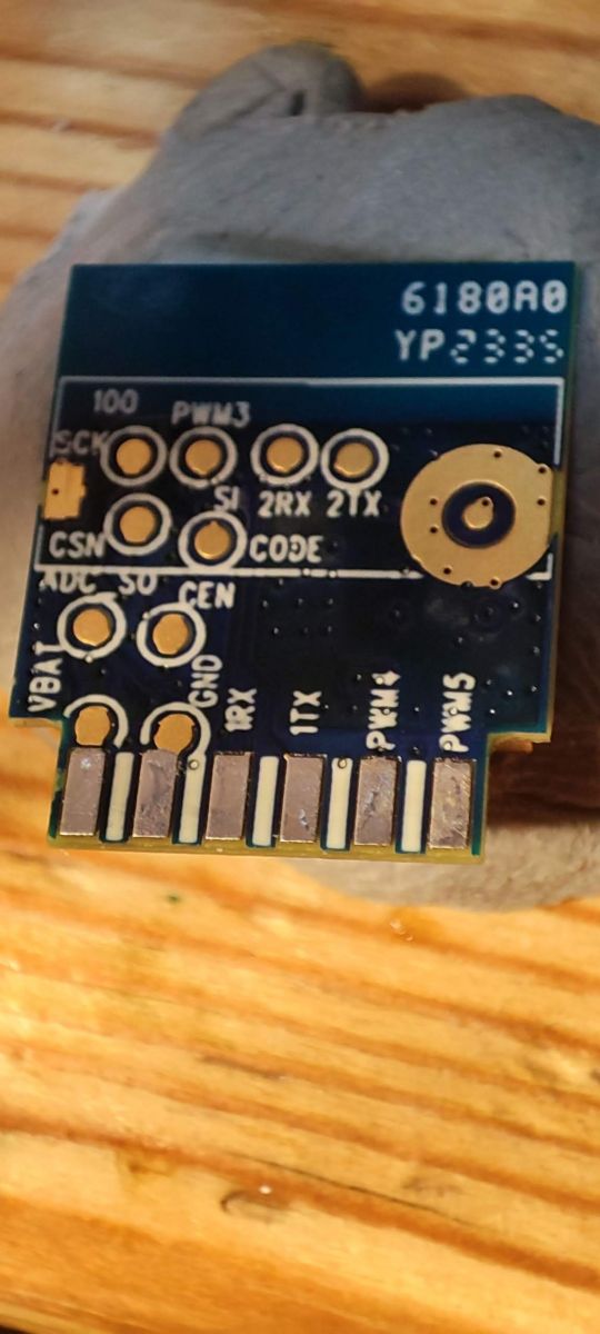

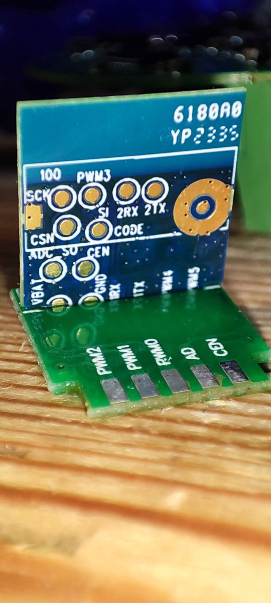

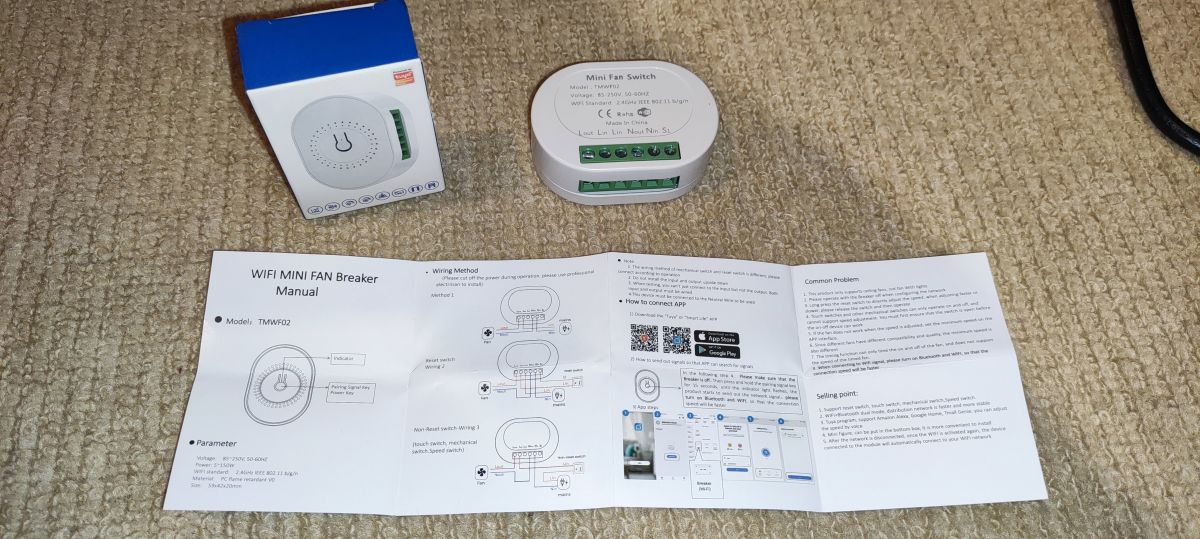

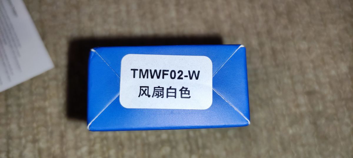

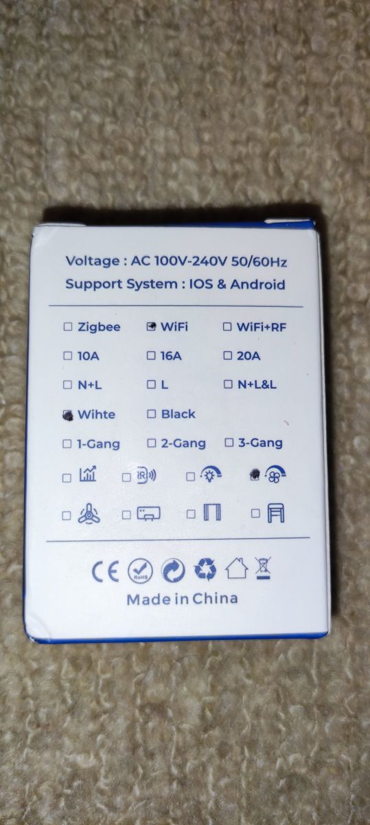

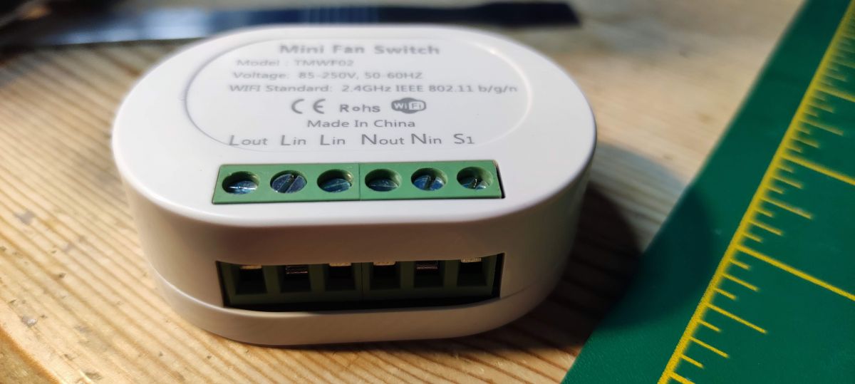

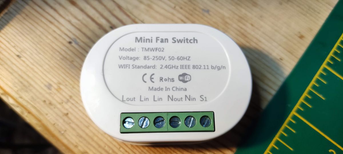

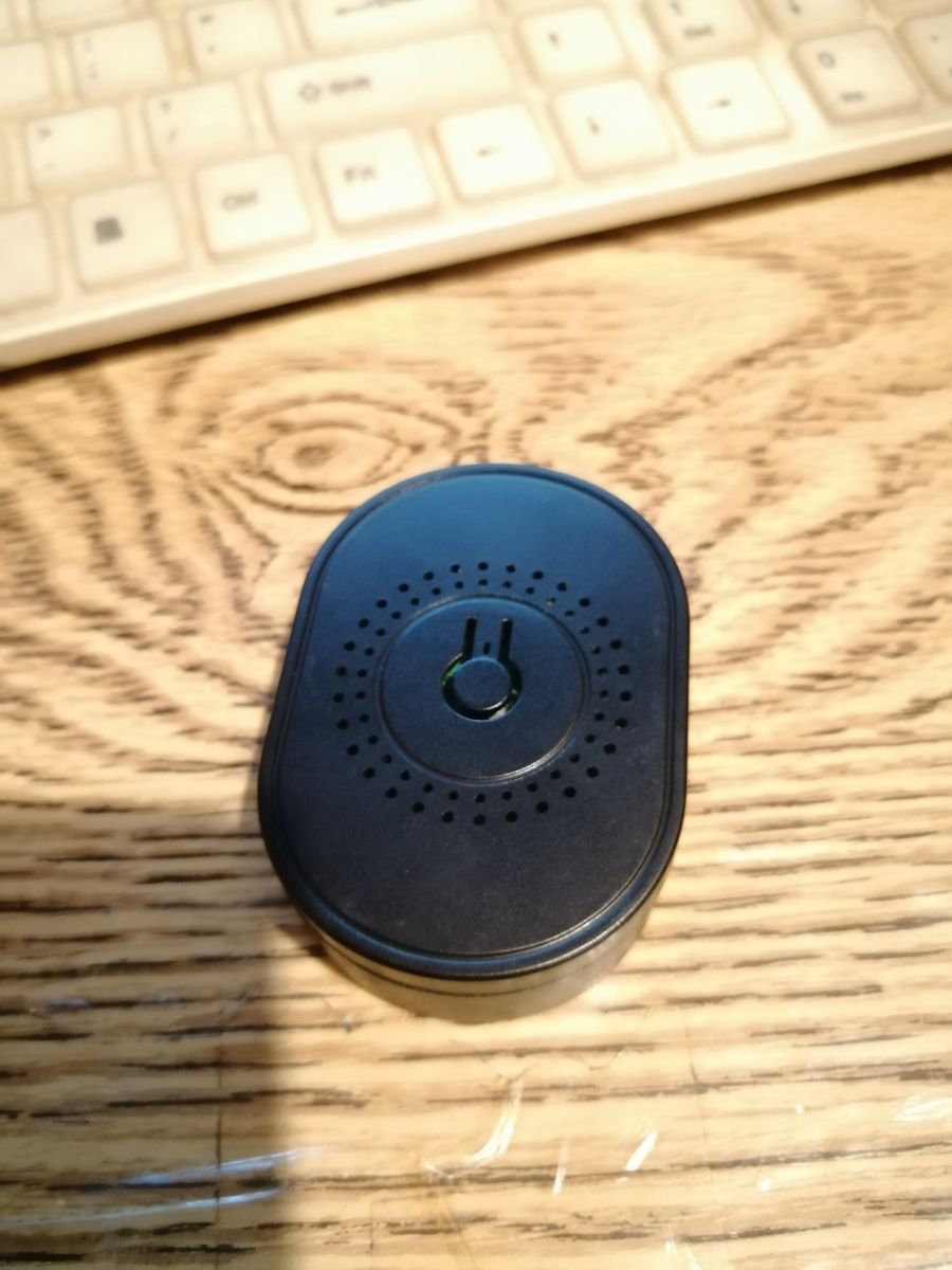

    Here are some basic pics of various parts and a factory flash, attached.
    Mini Fan Switch model TMWF02 with technical markings. Electronic fan switch module with visible label. Fan control module on a cutting mat. Close-up of a PCB with pin labels and a connector. WB2S module on a green circuit board with a capacitor. Close-up view of an electronic module with various components, including capacitors and a WB2S module. Printed circuit board with various electronic components. Electronic module with components on a circuit board. Close-up of electronic components with a heatsink and connector. Close-up of electronics on a green PCB board. Close-up of a PCB with connector labels. Small electronic board with various markings and connectors. Close-up of a PCB with connector labels and metal pads. Printed circuit board with pin labels on a wooden background PCB with track labels for PWMs, AD, and CEN Printed circuit board with labels for various connections. Fan control module with soldering points WiFi Mini Fan Breaker TMWF02 manual with wiring diagrams. Packaging of Tuya fan control module Tuya product box on a beige carpet. View of a smart switch module box with specifications and supported systems listed. Box with label for product ZN304602_01 and QR codes Top view of a blue box labeled TMWF02-W with Chinese characters. WiFi Mini Fan Breaker set with user manual on a carpet Mobile app screen showing Fan Switch Module with a power toggle button. Fan switch module interface with slider set to 9%. Device update screen showing no updates available.
    I've yet to solder it all back together but I do not have a fan to test it with. Would an incandescent 60w bulb be a worthy substitute?
    Update: Yes, 60w incandescent behaves as expected and dims nicely.
    As in a previous post I am using this in autoexec.bat
    Fan control panel with an off state
    I do not see it in the device list so, OBK template:
    silkscreen keywords: WB_MD1 / T=1.0MM / KSE / DM_WB_MD2 / 20220811
    https://github.com/OpenBekenIOT/webapp/pull/84
