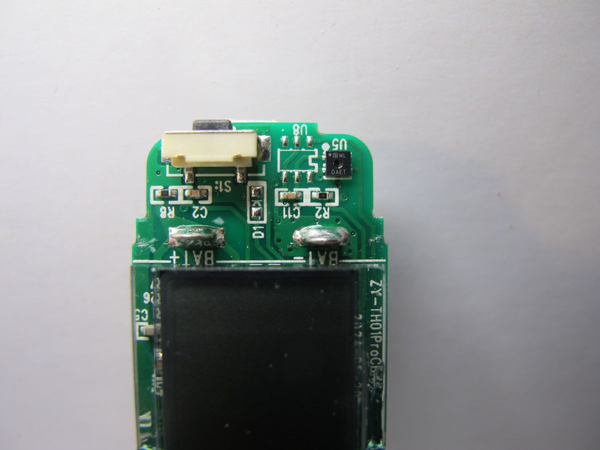

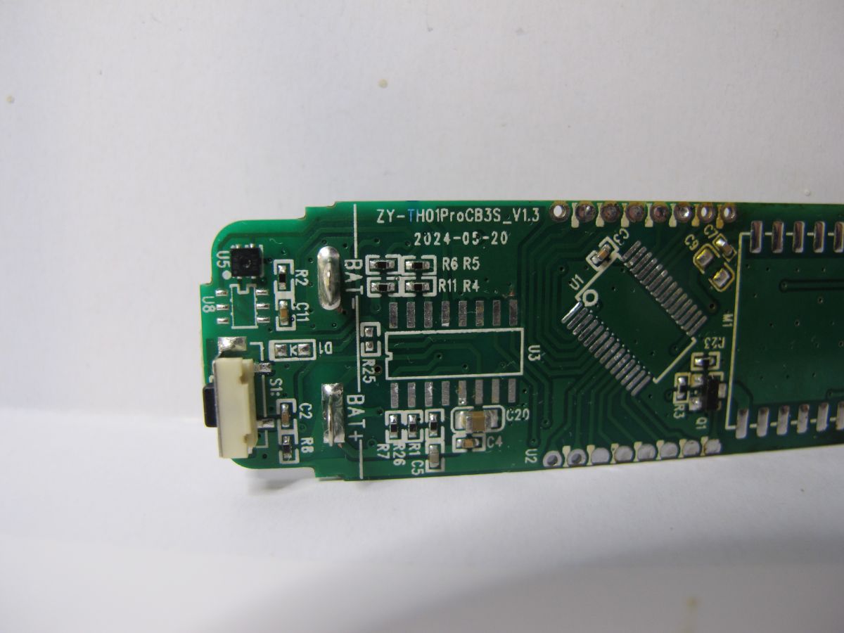

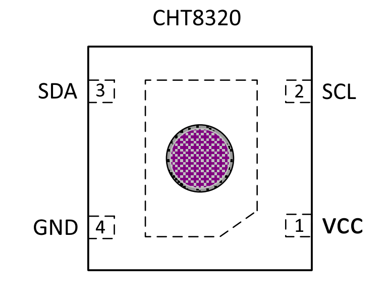

    I wasn't that interested in getting another battery-powered TuyaMCU temp/hum sensor working with OpenBeken so decided to strip this ZY-TH02Pro down to just the sensor for use in testing. The sensor is labelled "ML DAET" alongside the Sensylink logo. Not very helpful considering other Sensylinks are usually "CHT83xx".
    Close-up of a black electronic component marked ML DAET.
    A kind person at Sensylink informed me it was the CHT8320. A datasheet was supplied, attached.

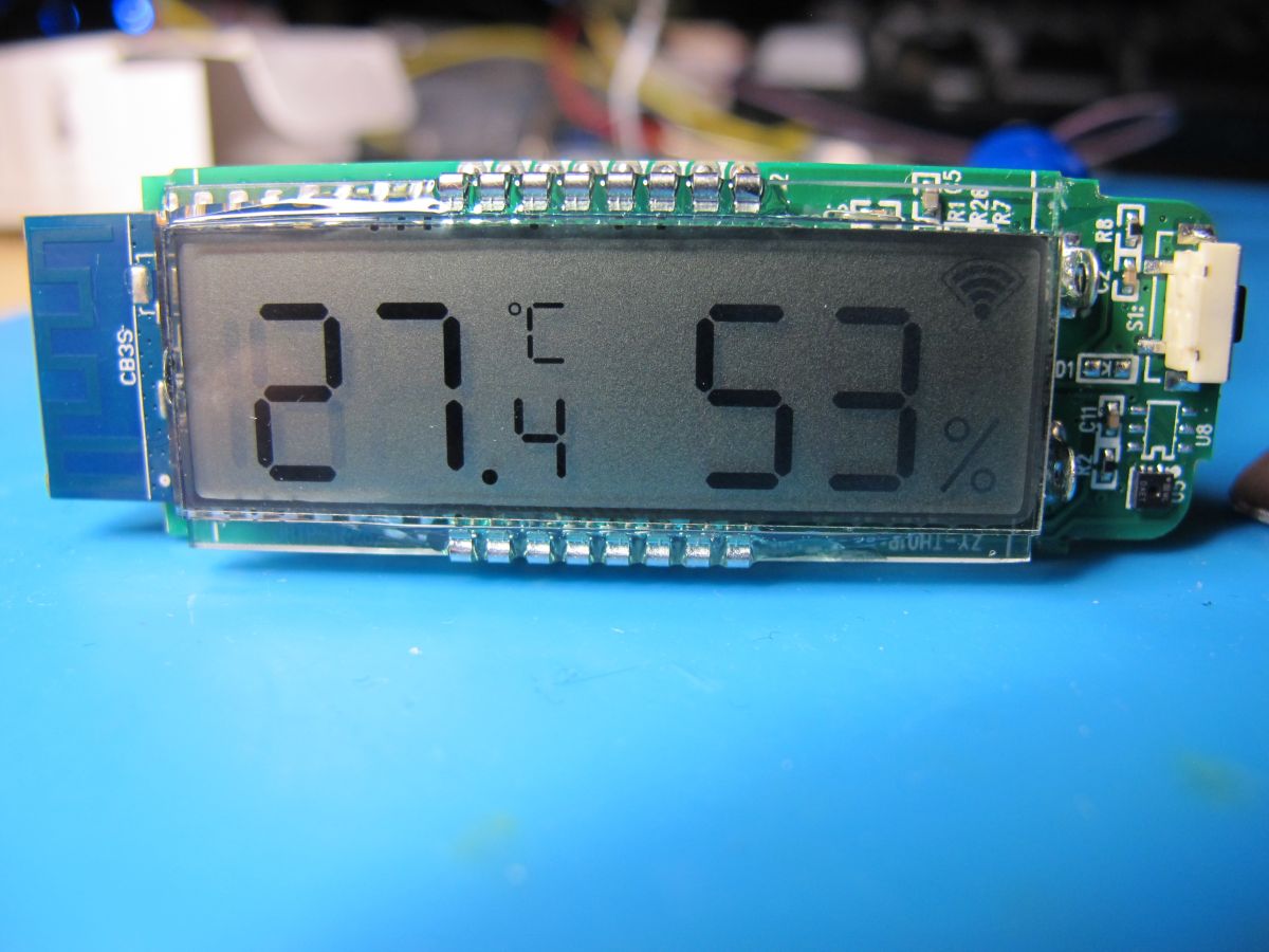

    First, here's a quick dump of some things relating to the device as a whole for context.

    Pin diagram of CHT8320 sensor

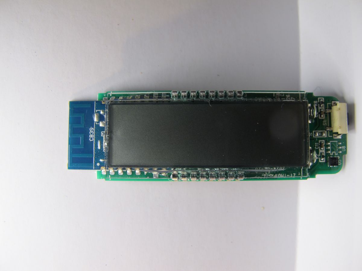

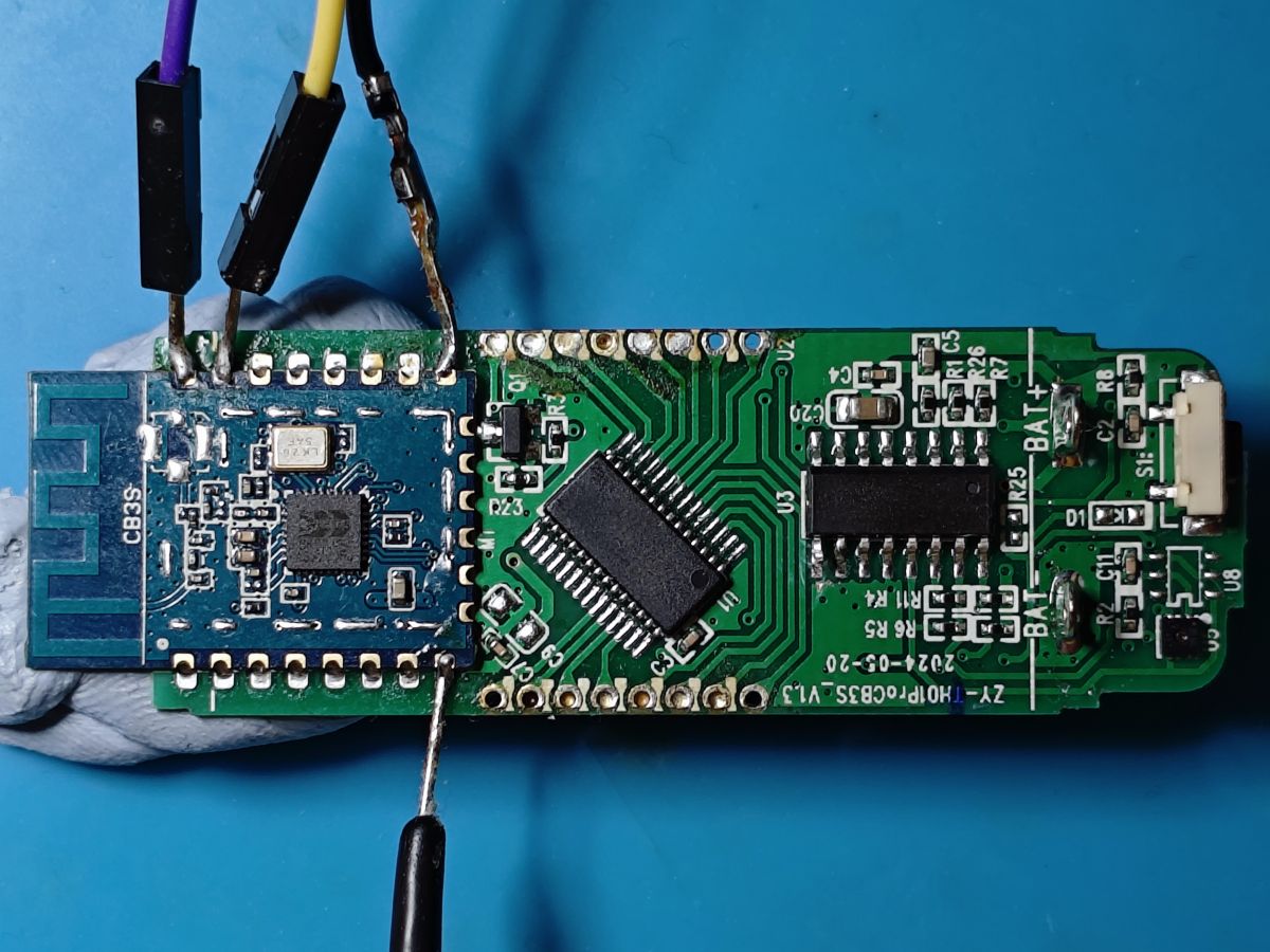

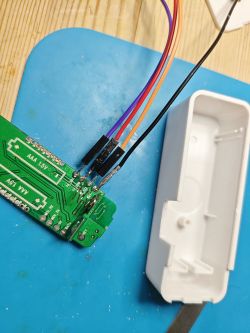

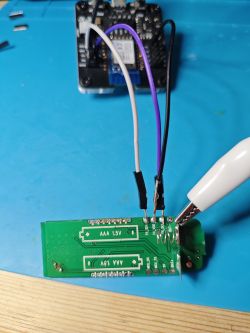

    With the TuyaMCU, LCD, LCD driver IC and CB3S removed the TH_SDA, TH_VDD and TH_SCL test pads can be used to give life to the CHT8320 - powered from CB3S/ESP universal adaptor 3V3:
    Prototype board assembly with connected wires to the sensor.
    and with
    we see the sensor I2C address detected with 'scani2c soft' command

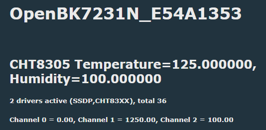

    and with the CHT83XX driver set
    Screenshot showing measurement results from CHT8305 sensor.
    Firmware was submitted to Cloudcutter team for profile creation https://github.com/tuya-cloudcutter/tuya-clou...erature-and-humidity-with-display-v2.1.8.json

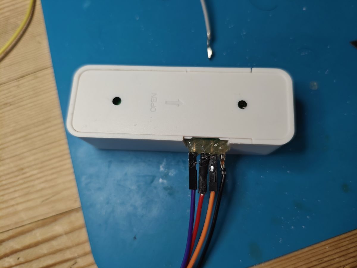

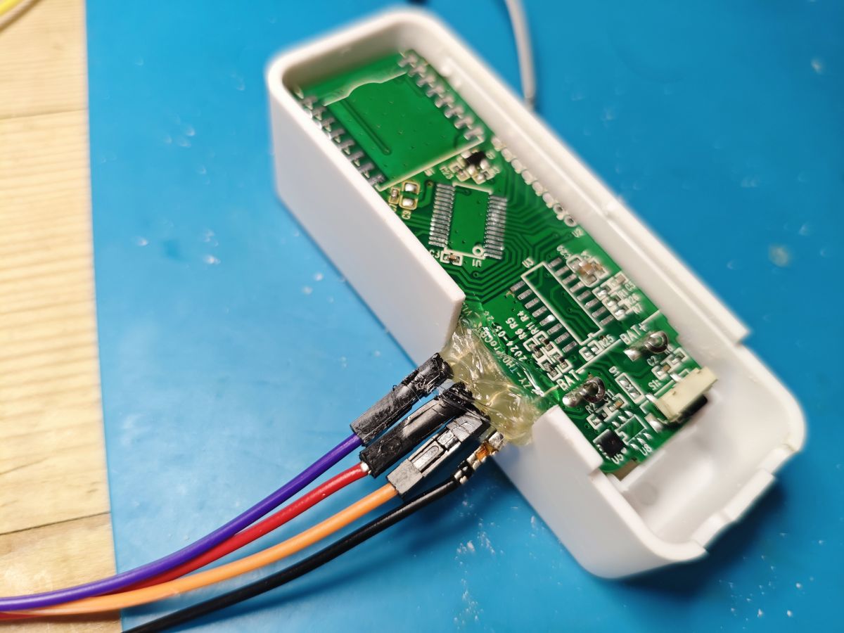

    and that's where I'm currently at. I guess the driver needs some work and I now need to permanently solder and route the 4 wires out of a case for a permanent sensor testing solution.

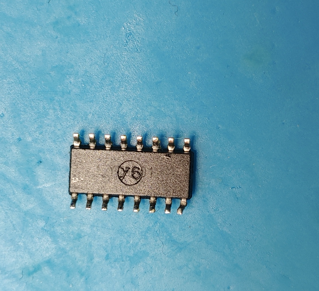

    on the underside of the SOIC-16 TuyaMCU - "Y6". But it looks like the Y6 is stamped on top of something else. Y46D01?
    Chip with marking Y6 on a blue background. SOIC-16 integrated circuit with markings on a wooden background.
    Added after 1 [hours] 29 [minutes]:

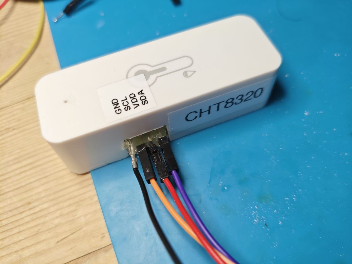

    soldered, rehoused in disused TH01 case, glued, labelled
    Plastic housing labeled CHT8320 with four copper wires on a blue background. Plastic enclosure with holes and attached wires on a blue background. Close-up of a circuit board with attached wires inside a white case. Circuit board with attached wires and white casing on a blue mat. Green printed circuit board with attached wires on a blue pad, next to a white plastic casing.

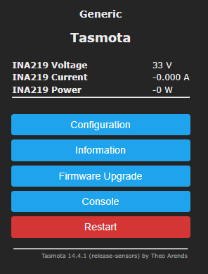

    not yet tested the actual sensor. Tasmota's Sensors firmware detects as
    Screenshot of Tasmota user interface with voltage, current, and power readings for INA219 sensor.

    #6 21457873
    Posts: 5202
    Help: 446
    Rate: 914

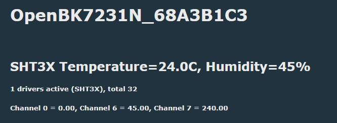

    TLDR:
    -my first stripped-down TH02Pro was too stripped and the sensor doesn't work as it is right now.
    -CHT832x is an SHT30 clone so the SHT3X driver works. My second TH02Pro works with SHT3X driver
    SHT3X sensor information panel with temperature 24.0°C and humidity 45%.
    see https://www.elektroda.com/rtvforum/topic4107989.html
    Added after 24 [minutes]:
    So we need to add CHT832X to OBK?
    I guess it could be listed as supported? Would you want to change driver to reference CHT832x or just leave it untouched?
    (Weird that SHT driver doesn't do decimal values on humidity)
