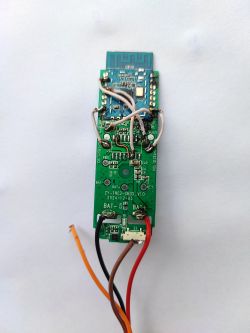

    Again ordered Temperature and Humidity sensor from Aliexpress. Actually two of them.
    I got one of this in ali. It is a device based on CB3S with a CHT8310? sensor and a Tuya chip.
    Model: TH01
    FCC ID: 2A8TU-TH01
    PCB: ZY-TH02-CB3S_V1.0 (2024-12-03)
    Disassembled temperature and humidity sensor with visible electronic board and casing.

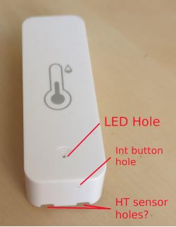

    Case holes detail:
    White rectangular sensor with labeled holes for LED, int button, and possible HT sensor.
    PCB detail:
    Printed circuit board with electronic components.

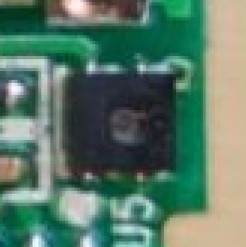

    HT Chip:
    Close-up of a chip labeled SML DPAT. Close-up of a microchip on a PCB.
    CB3S pinout for flashing:
    [BK7231N CB3S] Temperature and Humidity Sensor, TH01, PCB:ZY-TH02-CB3S, SHT3X
    Firmware: Official sensors release
    How it ended:

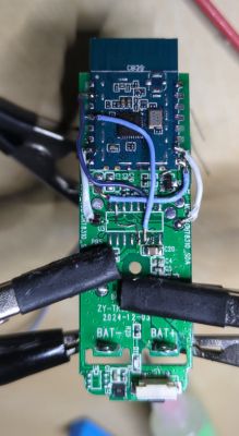

    Printed circuit board with connected wires.

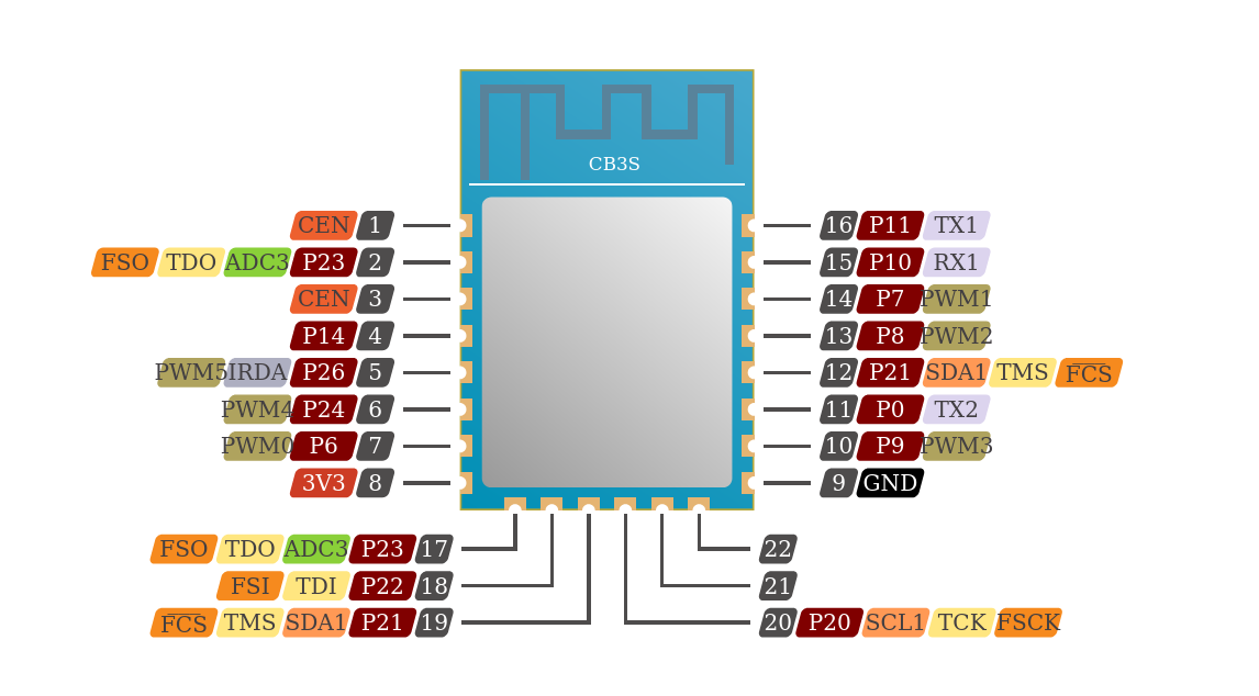

    I wasn't able to put OBK on it using bk7231flasher_1.3.3. No reboot or CEN allowed me. So, I needed to desolder something.
    For first device I tried desoldering the CB3S chip and my (lack of) soldering skills resulted in a lot of pads broken :P. But the CB3S survived and I was able to program OBK on it.
    For second device I tried desoldering the Tuya chip, this time pads survived but still wasn't able to program it, therefore I needed to desolder the CB3S, this time all the pads survived.
    Long story short, after several tries I decided to remove the Tuya chip and connect the CB3S directly to the supposed CHT8310. I assumed the PCB included a CHT8310 based on the picture of it and the fact the PCB literally has CHT8310 printed on it in some test points, specifically CHT8310_SDA, CHT8310_SCL and CHT8310_VDD.
    To leverage the configuration I made to some other device I wired the CHT8310 chip to P9 and P6 of CB3S as per the pinout Here
    When loading the driver I always get temp=125 hum=0, which means for me there is an issue with the communications.
    Therefore I loaded the I2C driver and when I ran scanI2C soft I got
     Info:I2C:Address 0x44 (dec 68)
    That is, as per my understanding the address of a SHT30 chip.
    When trying to load that driver I realized it is not included in the current standard release of OBK, where can I get a version including SHT30 to see if that driver is capable of handling the chip?.

    Looking at the pictures I would think it's no CHT8310 (the opening in the case is not centered as it seems on your sensor), so some SHT3x seems more likely.
    I'll try to build a firmware including the driver.
    Added after 14 [minutes]:
    Here you go. Only compiled, not tested...
    • OpenBK7231T_App_BekenSHT_4eead75a02c1_OpenBK7231N.zip (3.73 MB) You must be logged in to download this attachment.

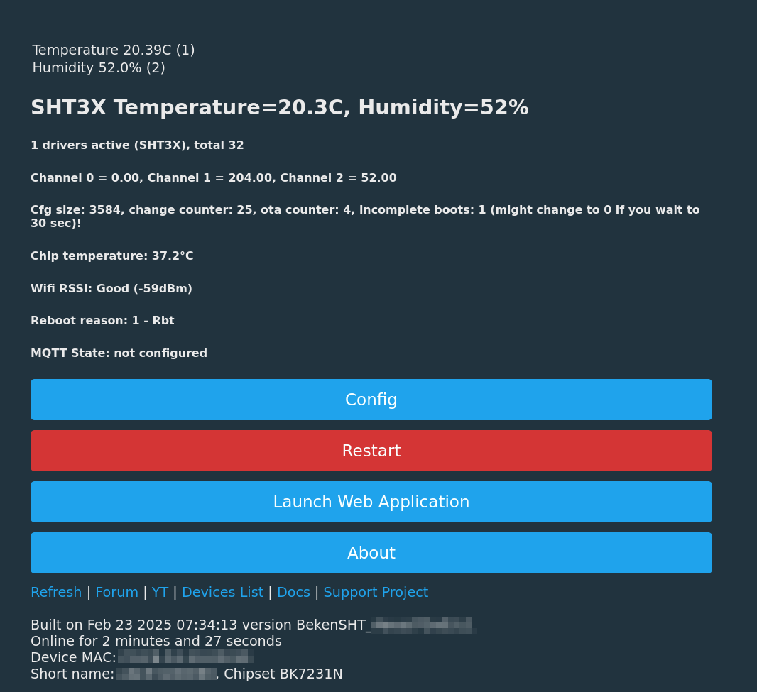

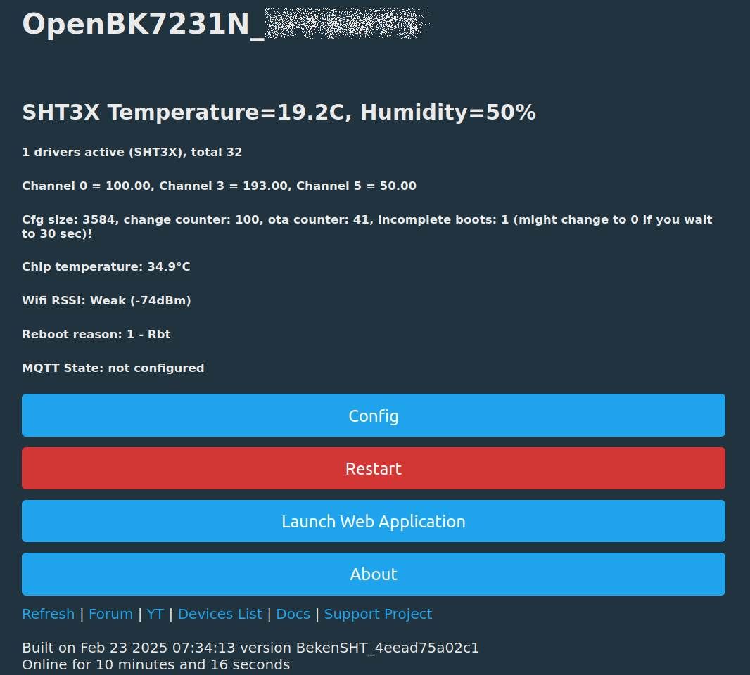

    I knew deep in my box with sensors there was an SHT31 ;-)
    Looks like it should work:
    Screenshot of OpenBK7231N interface showing temperature and humidity data.

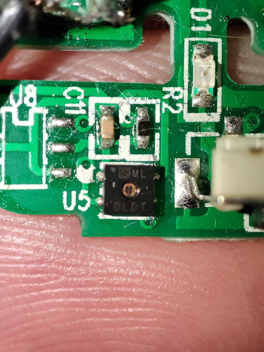

    Yes, a clear picture of the sensor would be great.
    While 0x44 is the default address for SHT3x, it's also possible on CHT8310:
    See e.g. https://github.com/RobTillaart/CHT8310 :
    The CHT8310 supports up to 4 devices on the I2C bus.
    AD0 Address Notes
    GND 0x40 CHT8310_DEFAULT_ADDRESS
    VCC 0x44
    SDA 0x48
    SCL 0x4C
  • #6 21452715
    Posts: 5201
    Help: 446
    Rate: 914
    yes and Info:I2C:Address 0x44 (dec 68) was the detection for my CHT8320

    >>21452650 I uploaded new images for the chip the best I could and I can confirm, only 4 legs.

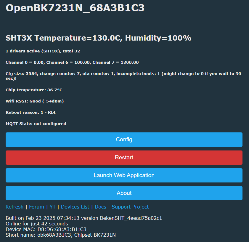

    >>21451932 Tried your firmware and got
    User interface showing temperature and humidity data with configuration options.

    So it seems it actually is an SHT3x sensor or a clone. Good to know, maybe @divadiow this will solve your non functional device, too?
    Added after 10 [minutes]:
    At least your sensor seems very much the same device like the image above

    But that's mad! Sensylink said it was a CHT8320...
  • #10 21454729
    max4elektroda
    Posts: 758
    Help: 49
    Rate: 189
    Yes, they should know.
    Maybe the protocol is kind of equal so it will give values if requested by the SHT protocol? The values at least look kind of sensible
  • #11 21454746
    Posts: 5201
    Help: 446
    Rate: 914
    weird. i must get to the bottom of this!
    User interface of the OpenBK7231N system displaying temperature and humidity information.
    pins are correct. I get expected address with soft scan
    Added after 27 [minutes]:
    also weird. Sensirion SHT3x has 8 legs I thought and the logo in the pic is of Sensylink

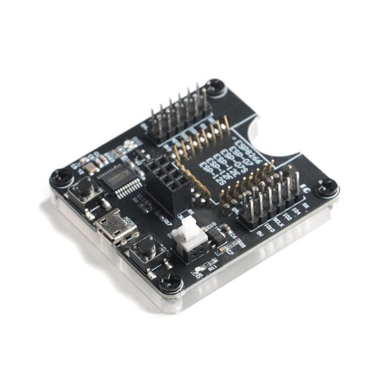

    1. Desolder CB3S from PCB (or cut RX/TX temporarily as noted and bridge Batt - (0V) to pin 9 GND)
    2. I used one of these flash boards for ESP-12x to flash the CB3S
    3. Use a BK7231GUIFlashTool to flash current OpenBeken firmware.

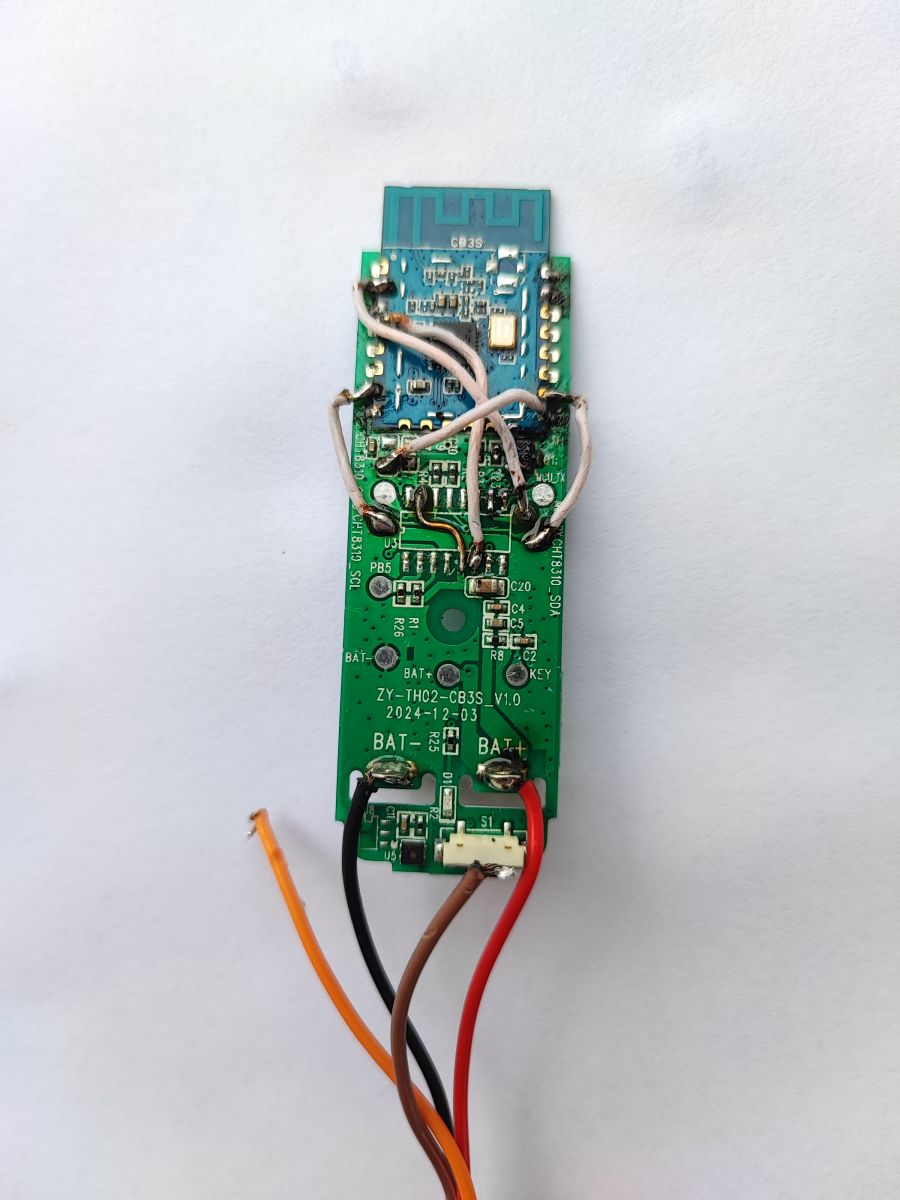

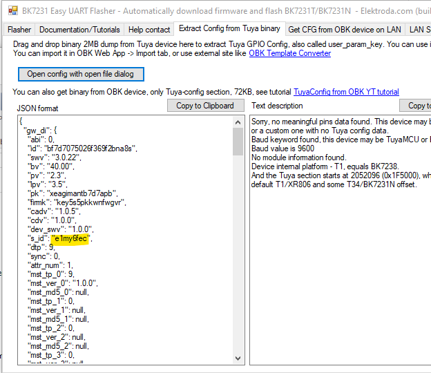

    @lktrdng Hi! I have exactly the same sensor, but I can't get it to work. I removed the Tuya chip and soldered it exactly like yours. I took the firmware from here, with SHT3x support. But I always have temperature=130 and humidity=100. Can you please tell me how you configured "Pin Settings" and what's in autoexec.bat?
  • #21 21621270
    rethink621
    Level 4  
    The autoexec.bat contains the text in the code box above. There aren't any other settings. Make sure your sensor is exactly the same. Make sure the PCB code is the same (date code may be different) and it looks the same. Post a photo here if you're unsure.
  • #22 21622043
    cobakind
    Level 4  
    Posts: 6

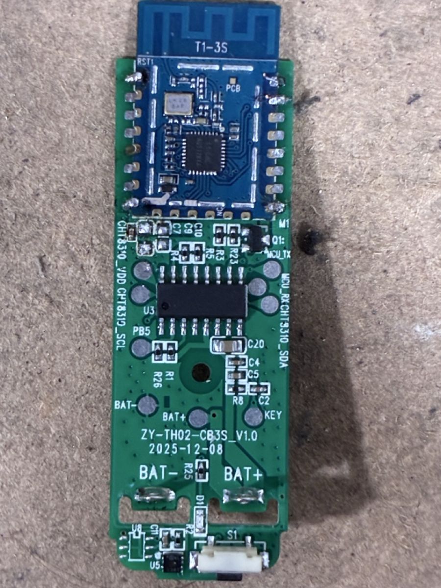

    >>21621270 Thanks for the quick reply! Yes, I have exactly the same PCB, the date code is the same (photo attached). I don't know if my "Pin Settings" are set up correctly. Can you tell me the correct "Pin Settings" for this PCB?
    ZY-TH02-CB3S board with CB3S module and connected wires
    Close-up of black SML DLD1 chip on green PCB with labeled components
  • #23 21633243
    rethink621
    Level 4  
    You've completely removed the TuyaMCU. The instructions are for leaving the PCB intact as it was originally, with both MCUs and everything else the same. The CB3S (ESP type MCU) just needs removing and then resoldering if you want to make reflashing it easier.

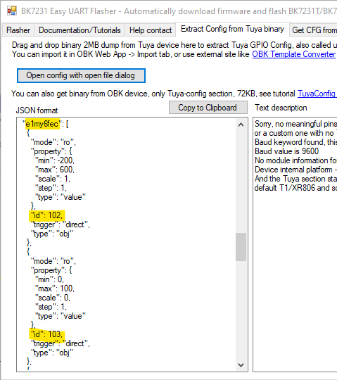

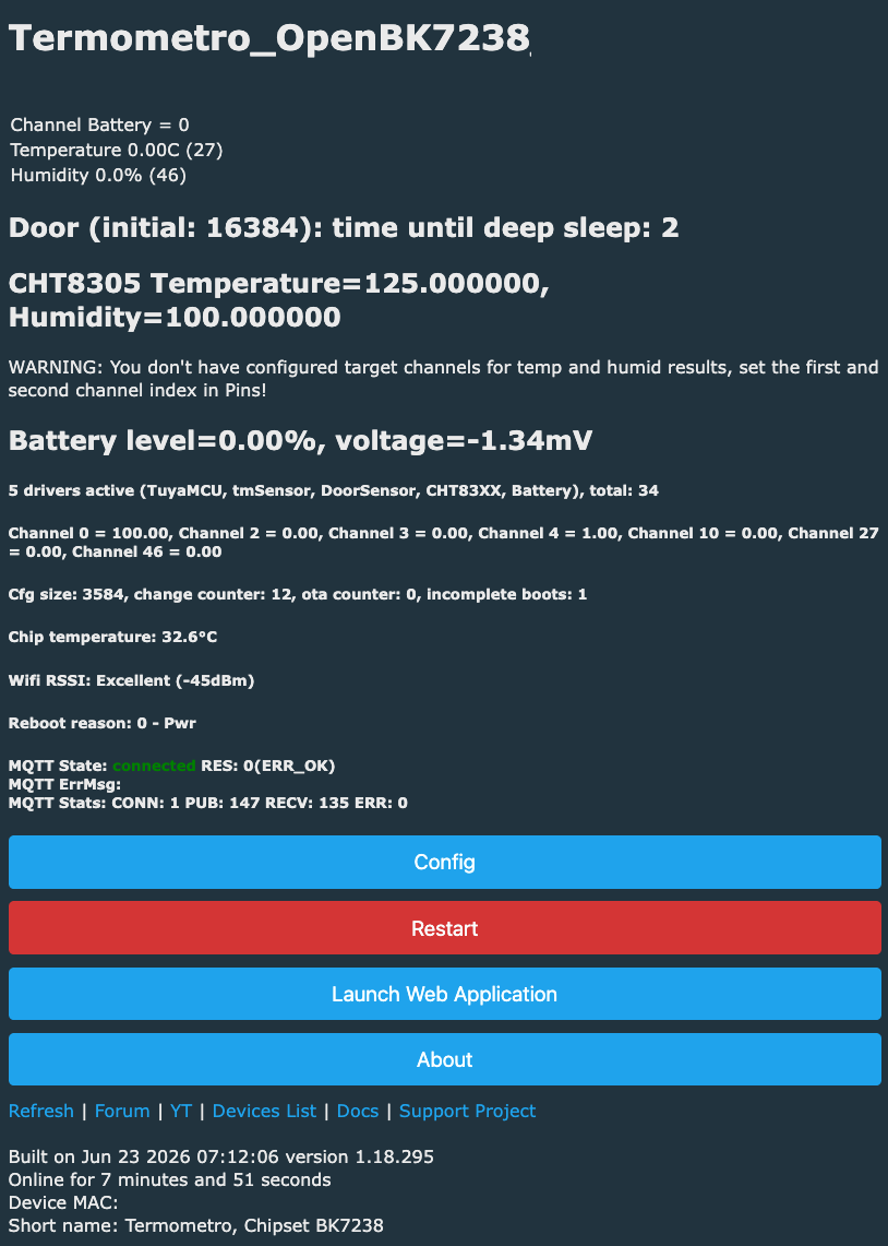

    Can somebody help me with my Tuya generic thermometer ZY-TH02 with BK7238?
    I have installed the OpenBK7238, configured the startup command, MQTT server, HomeAssistant, flags and pins, however I don't see the right temperature, humidity and battery level, in the index web or HomeAssistant.
    Screenshot of “Termometro_OpenBK7238” status page with temp, humidity, battery readouts and control buttons

    Pins:
        "8": "BAT_Relay;3",
        "14": "DoorSnsrWSleep;4",
        "16": "WifiLED_n;0",
        "20": "CHT83XX_SCK;0",
        "22": "CHT83XX_SDA;0",
        "23": "BAT_ADC;2"
    Startup command:
    backlog
    PowerSave 1
    startDriver battery
    startDriver CHT83XX
    startDriver TuyaMCU
    startDriver tmSensor
    // dpID 27 is temperature div 10
    setChannelType 27 temperature_div10
    linkTuyaMCUOutputToChannel 27 val 27
    // dpID 46 is % humidity
    setChannelType 46 Humidity
    linkTuyaMCUOutputToChannel 46 val 46
    // dpID 101 is battery state - low(0), mid(1) and high(2)
    setChannelType 10 ReadOnly
    linkTuyaMCUOutputToChannel 101 enum 10
    setChannelLabel 10 Battery

    We need a 'Where to Begin' guide that will help users identify what you have and how to configure it. A starting point for all devices that users can go to to begin their journey. Also a repo of all schemas/dpIDs.
    Your device is a TuyaMCU device that will not need the battery driver nor the CHT83XX driver running. It seems you know enough to have started the TuyaMCU driver and tmsensor. None of the pins probably need configuring either because the TuyaMCU usually takes care of the sensor, LED and button.
    The added complication is that newer T1 battery devices appear to use the v3 protocol and I don't believe the current TuyaMCU driver is in the best shape it could be to support that, even with
    tuyaMcu_batteryPoweredMode
    (see from this post onwards.)
    I've attempted to support the v3 protocol here, but I think it needs more work. See experiences with it in this thread https://www.elektroda.com/rtvforum/topic4163735.html
    I'm working on a revised driver.

    Added after 35 [minutes]:
    please ota to this release
    replace
    with
    tuyaMcu_v3LowPowerMode
    • OpenBK7231T_App_tuyamcu2_49e51be8cf71_OpenBK7238.zip (2.13 MB) You must be logged in to download this attachment.

    Level 4  
    Posts: 14
    >>21935060
    Thanks for the documentation.
    I have installed by OTA your firmware, replaced startDriver tmSensor with tuyaMcu_v3LowPowerMode on startup command, and unset any pin. However, the device's behavior is the same, it doesn't show the temperature, humidity or battery level.

    OK. do you know if these dpIDs are correct for your device?
    did you take a factory firmware backup?
    if you did and you paired with Tuya before dumping, open it in here in Easy Flasher then look for the s_id. what is the value?
    and you should also see the dpIDs listed. eg

    Posts: 5201
    Help: 446
    Rate: 914
    Tuya config might still be present. that can be downloaded and fed in instead.
